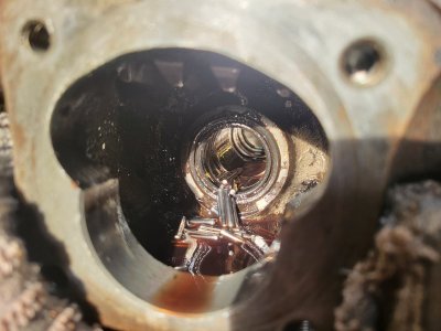

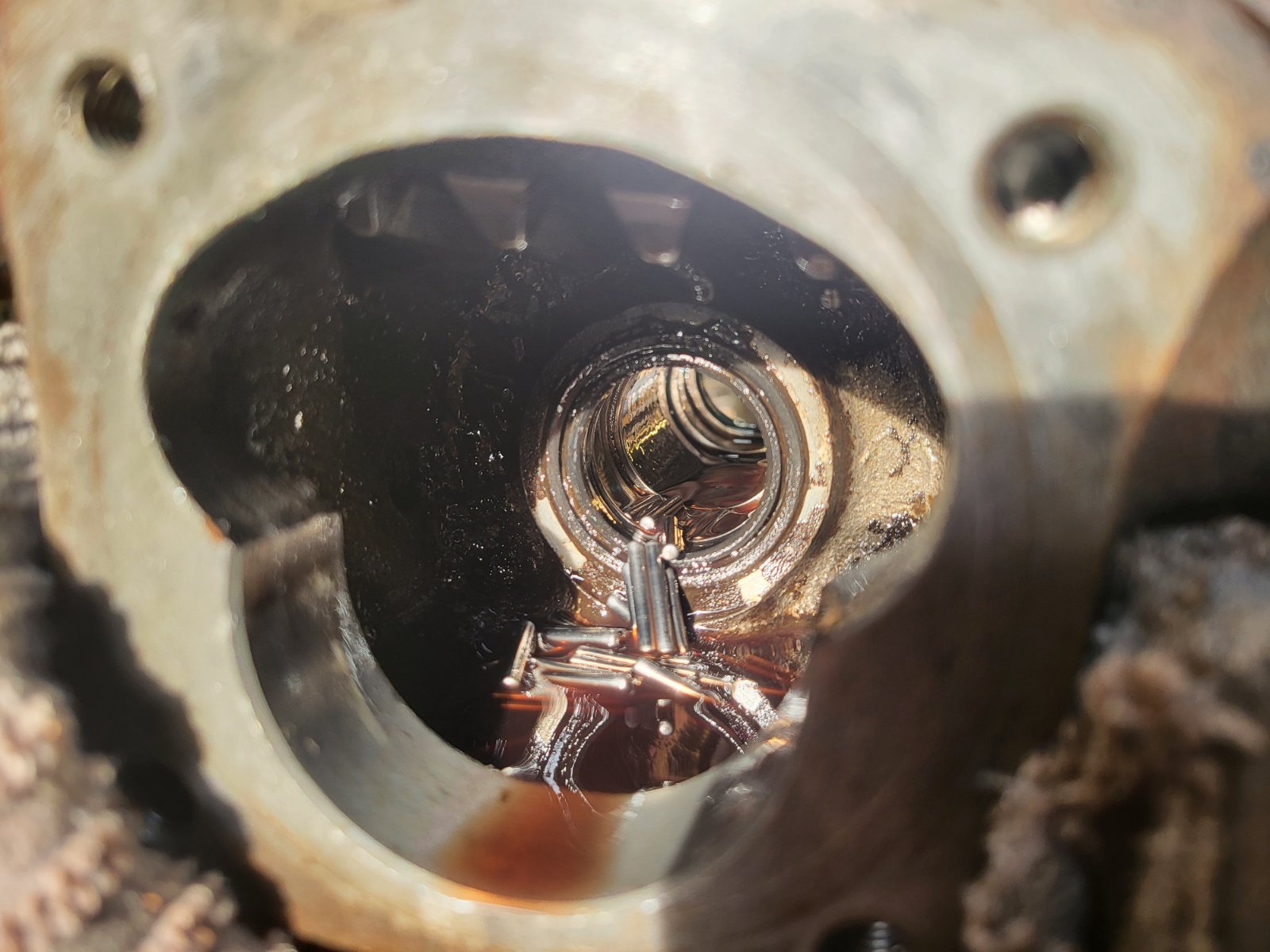

Hi Guys,
I'm re-building a manual ZF box. To my surprise when I pulled it down it's missing the top set of 2.48mm needle bearings. The bottom two sets are a different diameter. Anybody got a dead box I could rob them from?

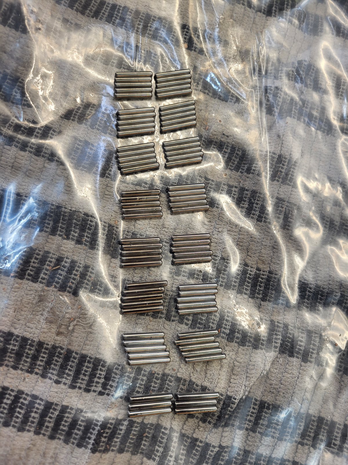

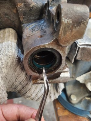

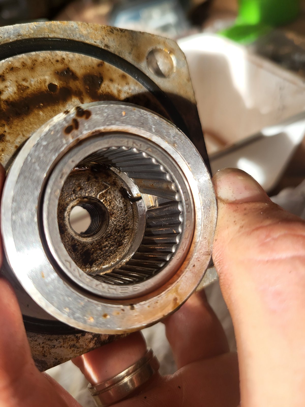

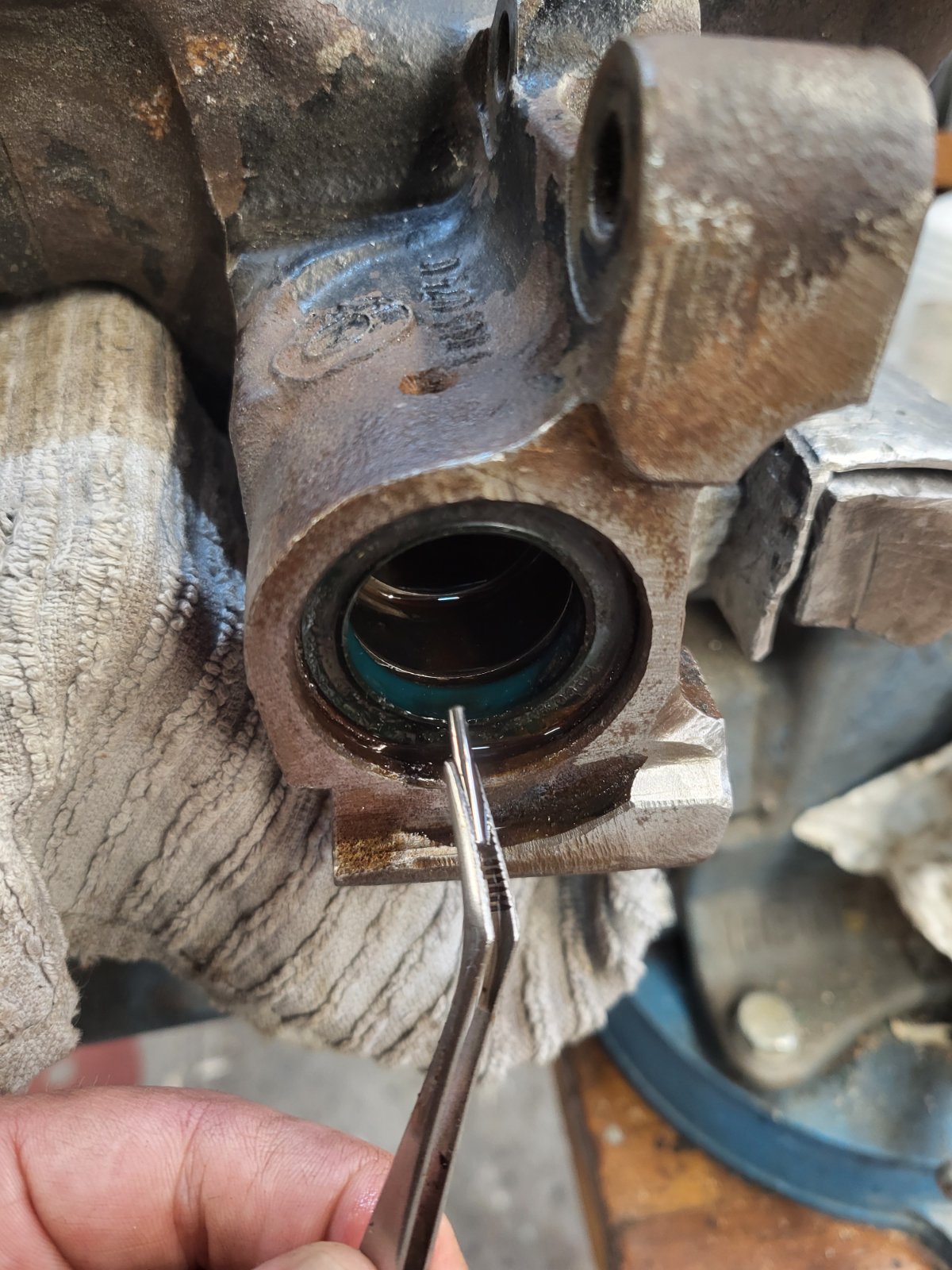

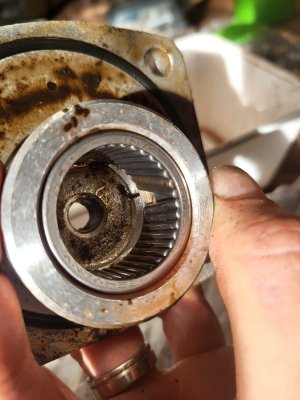

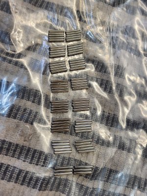

I've just opened up (partially) my power steering, pulling out the bearings requires special internal bearing pullers. Pressing new ones in requires a press of some sort, though a threaded rod e.g. M14 with two long nuts will also work.
(I've chosen to just clean and reinstall the original needles as I see no damage)
@Wes,
For a CSL steering box with the aluminum case, you can take a propane torch to
the case. The aluminum will expand faster than the steel and you can pull the bearings without a puller.
