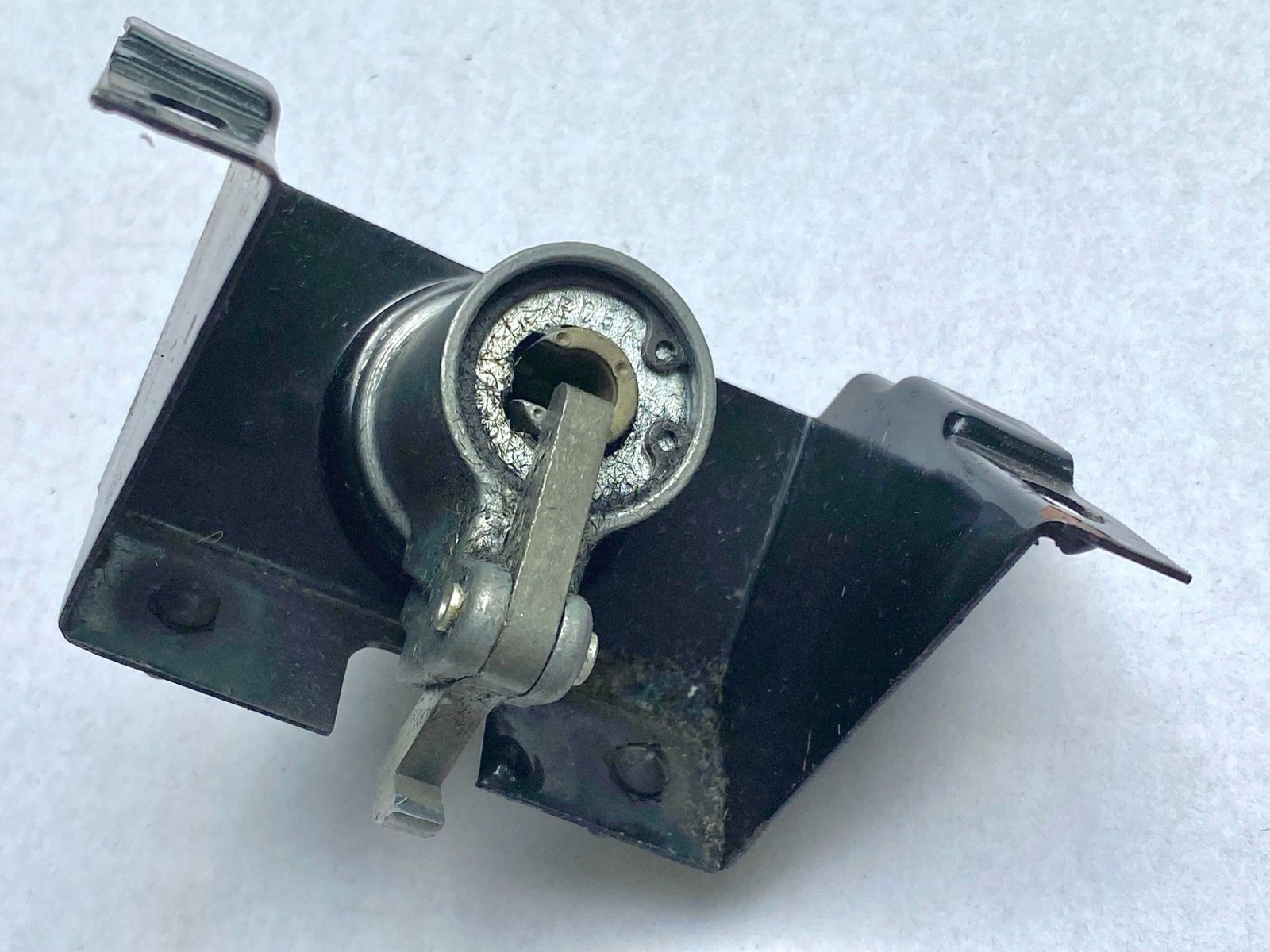

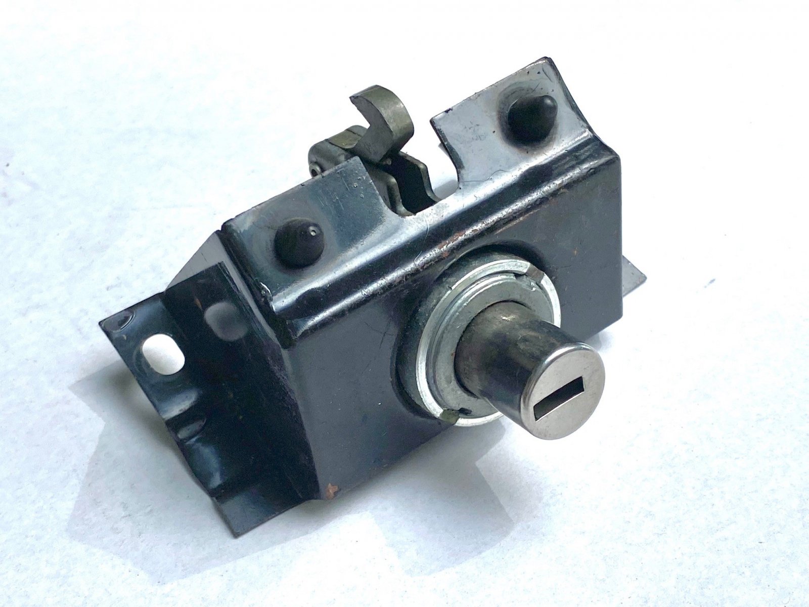

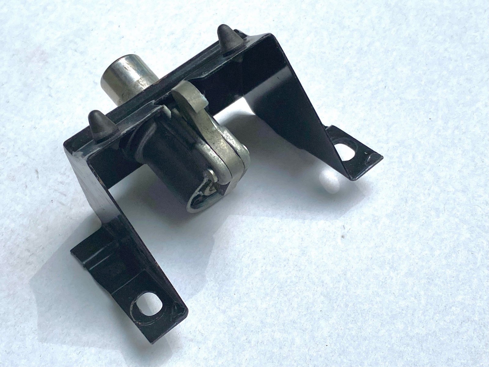

I does work and came out of a 73 I parted out.
Gary
