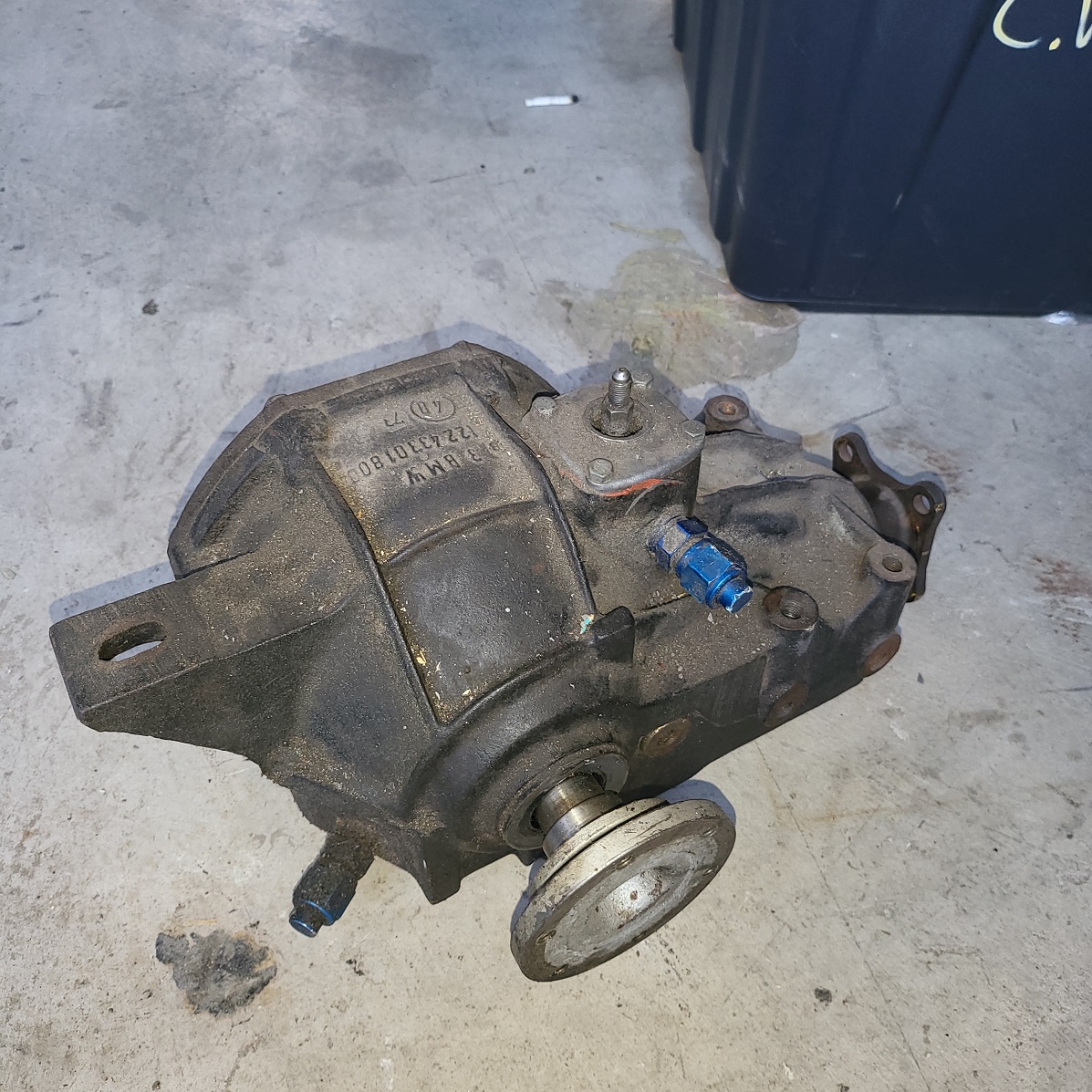

Hi Chris, will you please check this LSD, it came along with all parts that I won, I refresh the oil and I put it on my 3.0 and it runs very smooth compare to the original deferential.

Wladek
1,319
799
Gdansk, POLAND

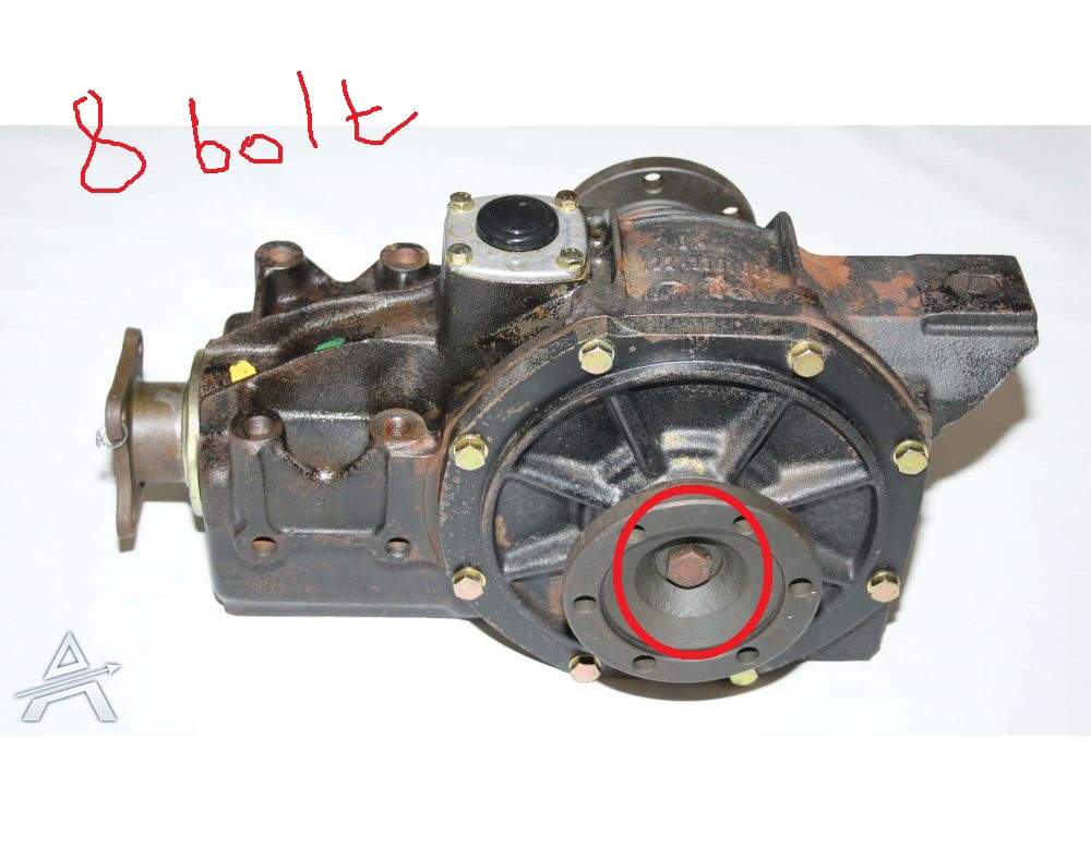

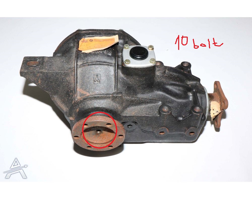

So 10 bolt is the later e12 ones , curious is there any fitment differences
Fitting of complete side-loader differential - no differences (if version without additional expansion tank),
But 10bolt vs 8bolt most of inside parts & case parts are not interchangeable.
On photo they might look the same, but side to side they are not.
