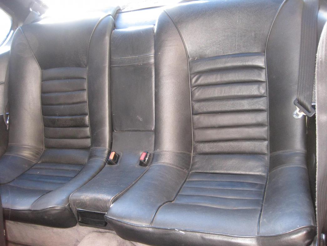

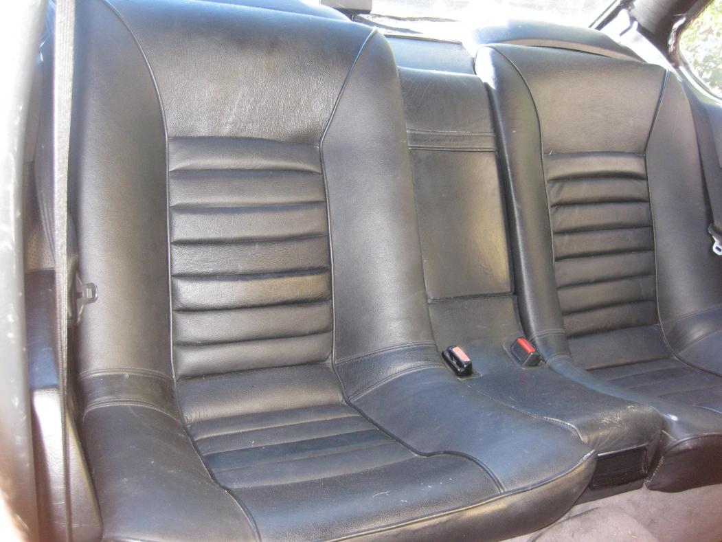

I have a 1981 BMW 633csi I am parting out and it does have the black interior some are looking for in this thread. See the attached photos and let me know if interested PM me. Thank you.
