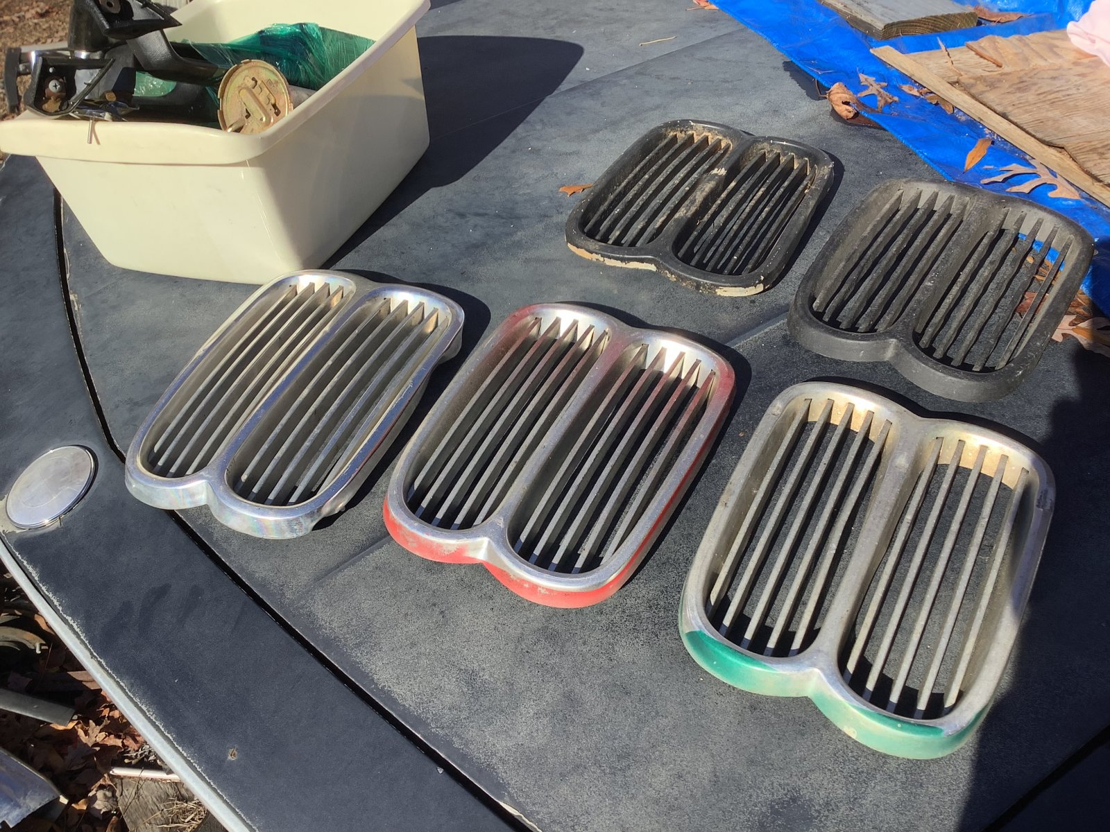

Headlamp Grills $50 each, the best of 10 sets..
center grill $200

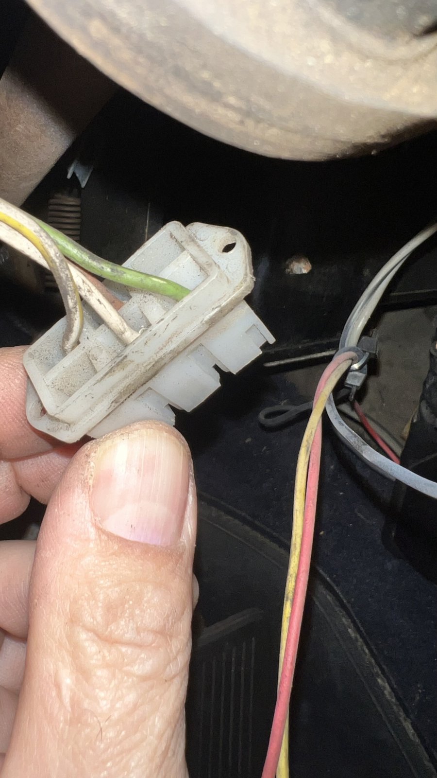

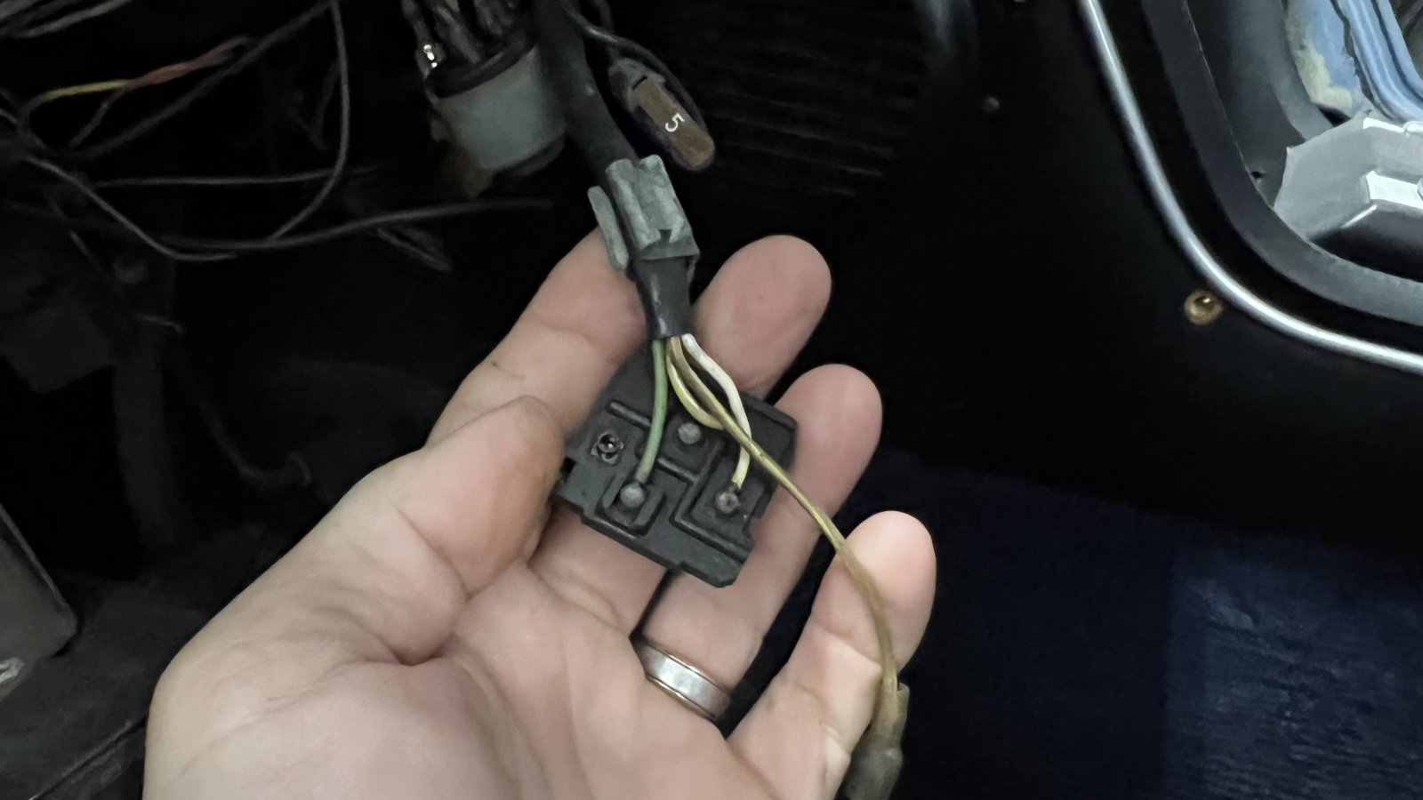

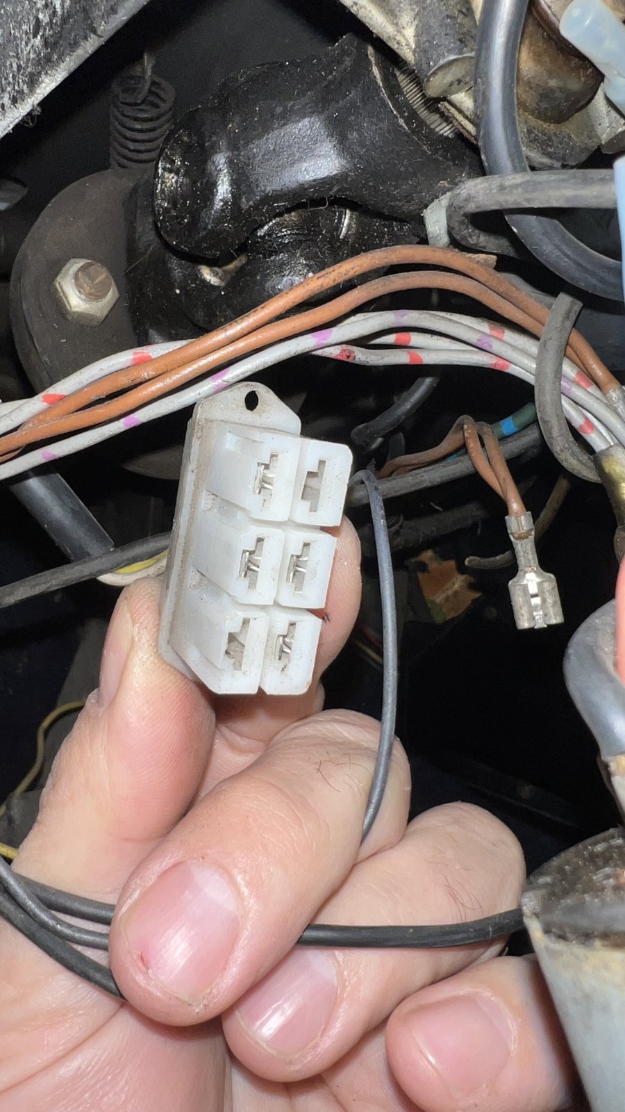

@RichenFamous - your stalks for wiper and turn signal are pre- or post-facelift?
I would assume with a '72 you have the earlier version:
-left side is high beam
-right side is wiper control and turn signal + knob in the center console for wiper speed
for the post-facelift cars the wiring harness and stalks are different:
-left side is high beam and indicator
-right side is wiper control and speed
Also guess early version as shown above.
There are these two versions, and both come either in aluminum or brass.
The ignition lock also comes in two versions, namely the early short one and the later longer one. Check which one is installed. You may determine with the lock still installed in the barrel by looking at the outer ring of the lock.
I believe this car should be the early style. Both are missing, so I’ll have to get pics and hope the plugs are different and I’ll be able to tell that way.
Thank you to everyone who has reached out this far! Truly appreciate it. I’ve sent replies to everyone and have a few deals underway. I’ll update my list as needs/wants are met.
Just so it is said, this is a car I am building back from the dead and will plan to remain in my garage until I pass it on to my son. I am not building for someone else or to flip. I absolutely love this car and have always had the hopes I would own a coupe one day. It will be right at home next to the 2002 and 2800 e3.
Concur - once you have confirmed your plugs you can determine which stalks you need, and get the right ones.
