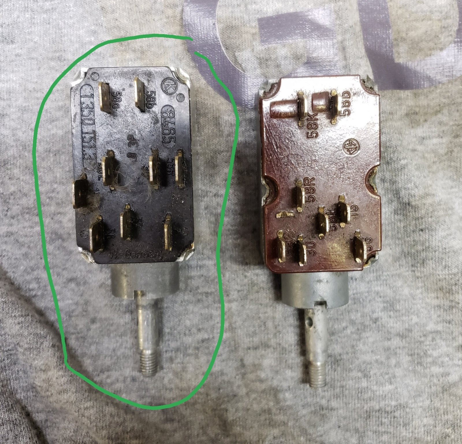

Hi everyone - I'm looking for the correct headlight switch for my 72 CSL (Nov 72 build date).
I bought what @sfdon and I thought would be the correct one but alas it's not.
The switch on the LEFT (circled in GREEN ) is the one in the car and what I'm looking to buy.
The one on the right is the one I bought and is now for sale for $85 bones which I think is what I paid Don for it. There's the same one on ebay right now for $175
Please let me know if you have an extra one of these "laying around". Mine turns on the headlights fine but doesn't activate the interior/dash lights.
You can bypass the rheostat to energize the dash lights, it’s the last two terminals on the switch. Who dims them anyway?
