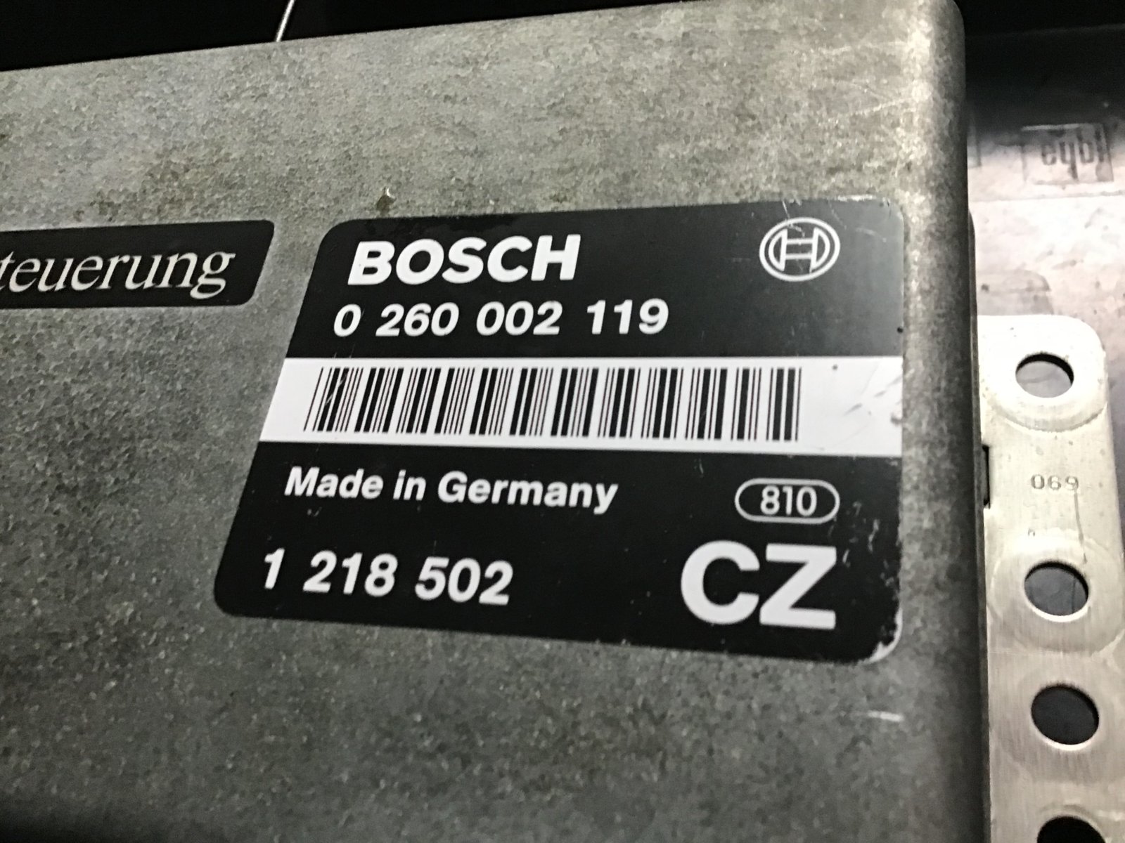

Is you unit tested/proven to be failed? They are quite durable. I would rather look for wiring/connector issue but after so many years it might be also problematic.
Which version You are looking for (CZ as on picture or other)?
Are you looking for specific number/letter? I'm sure for E30 it was specific type only as far as I remember.

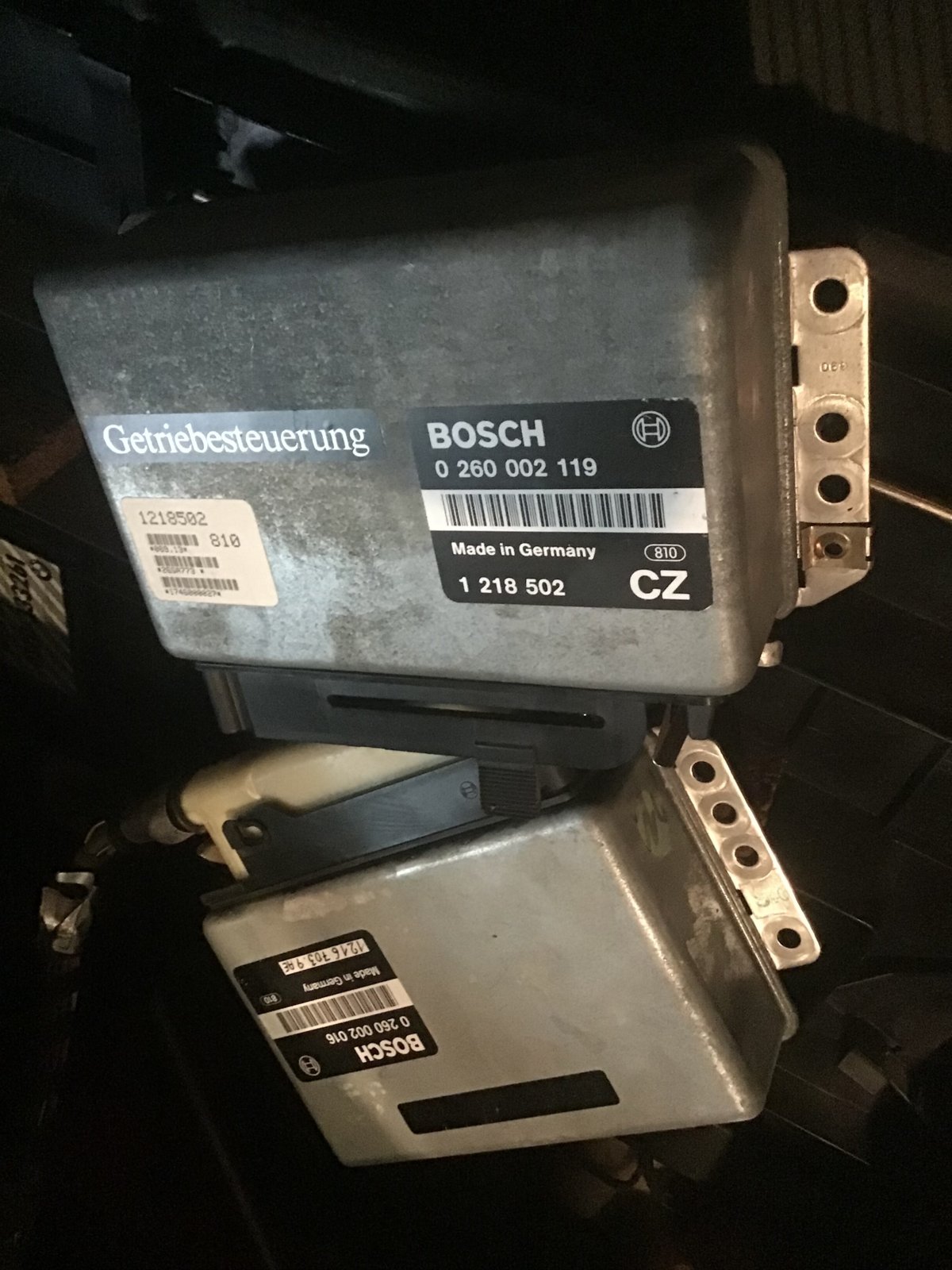

yes. the correct CZ unit is bad. I’ve run through all the zf Troubleshooting in the manual and the correct CZ is putting trans on FAIL mode.
I’m using an American version of the CZ but it doesn’t understand the 3 position rotary switch.

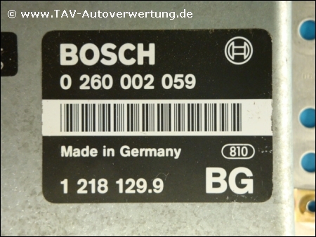

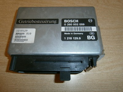

FWIW, as a data point….
The commonality being the 810 code just above the BG.
