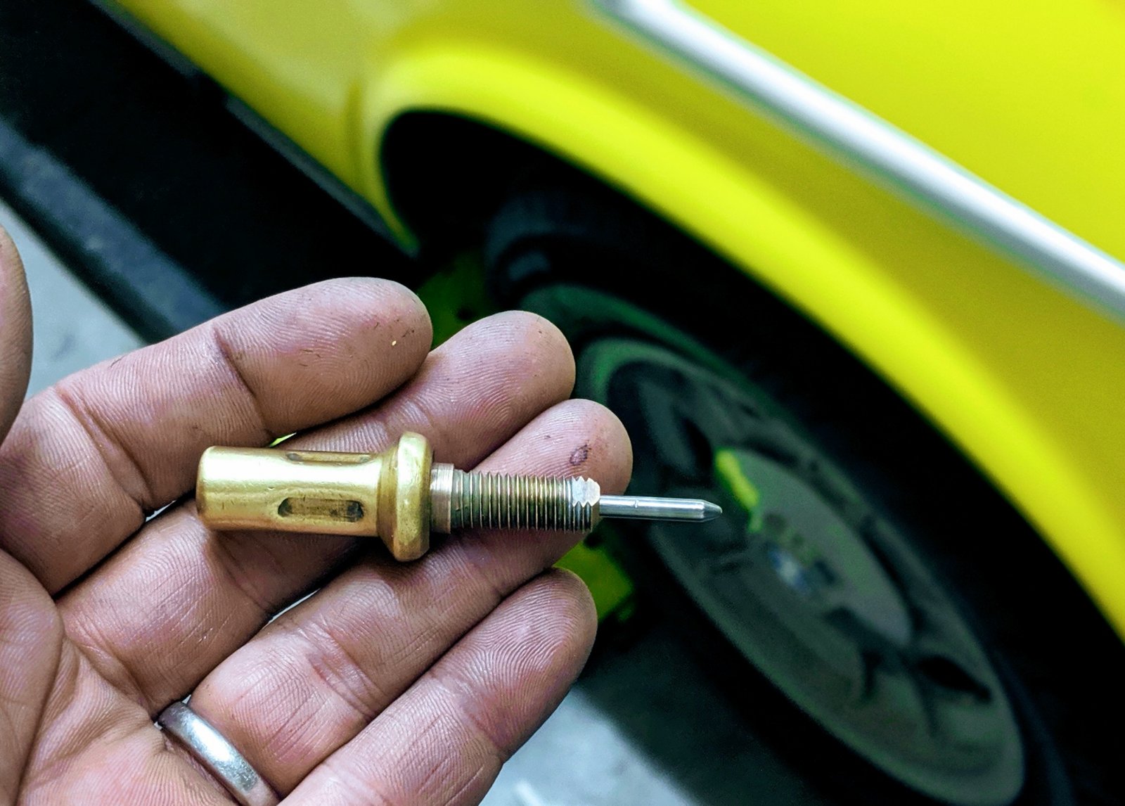

Looking for the expanding element for a 72 CS. Anyone have one or know where I can buy one online? I checked autohausaz, wallothnesch, ecs, eBay, Amazon but no luck.

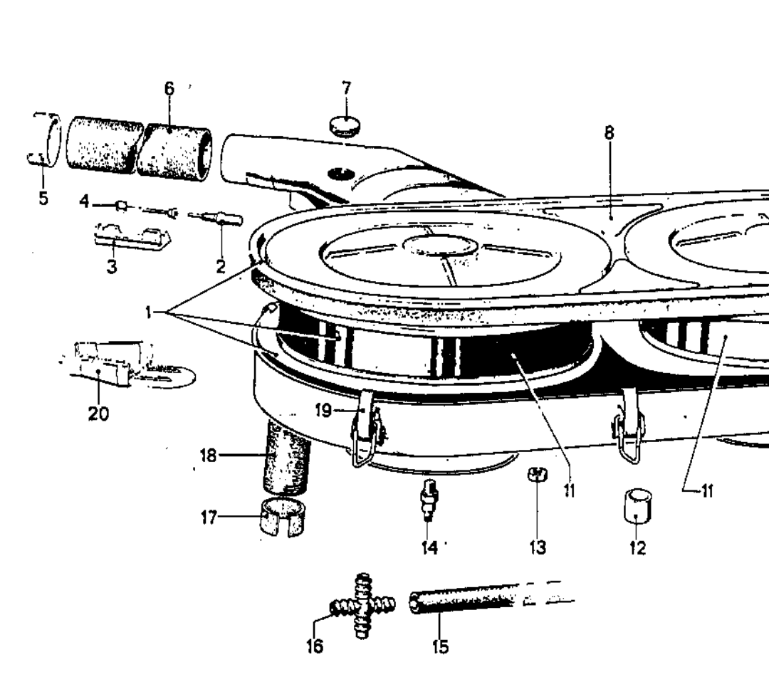

Part # 13-71-1-252-568
Item #2 shown in the schematic below

There's plenty of cold weather and snow here to flip the flap. But mainly it's for restoring the unit. Minine no longer expands because its leaking the thermal paste.
Doesn't need to be new. I'll buy an old used one if anyone has it.

Yeah, it's an emissions component. It redirects warm air to the engine until the expander reaches 25c. Then it opens the flap to ambient air. Cold start/idle emission rates for NOx +HC are 10x-100x higher than when at operating temp. Roughly ~1 min cold idle = ~100 miles of driving. Its a simple device but actually makes a huge impact on air quality. But I've rarely seen any that work properly. Mine did, until I cleaned it and punctured the bladder. :rolleyes:
