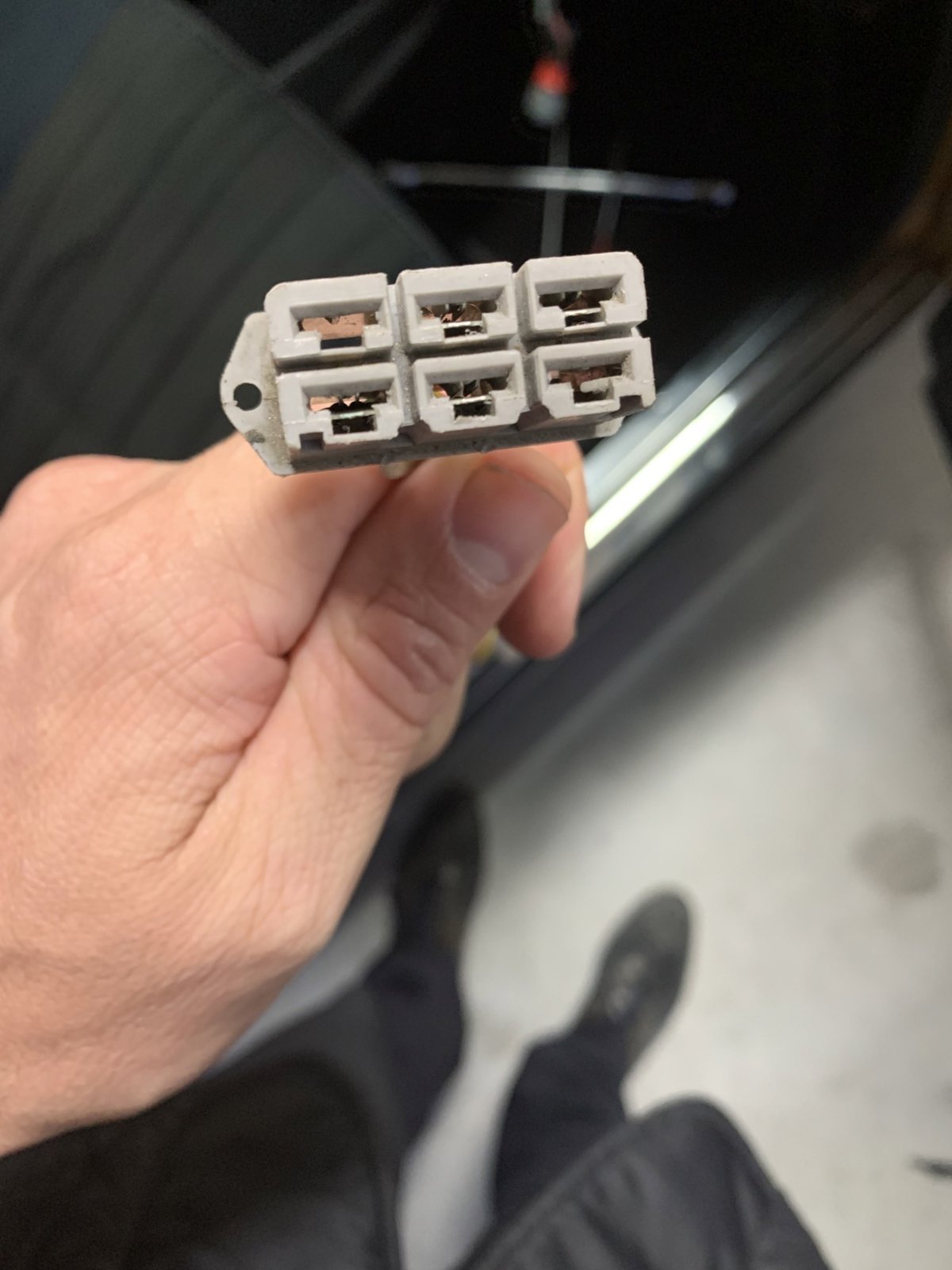

Seems to be some confusion here. Probably mostly on my part. This is the pin configuration I require.
This is from my RHD 72 CS. From memory the 72 CSL is the same.

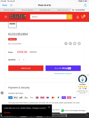

I have 3 csi’s to check for you.
keep in mind that part of getting a gray market car imported to USA was changing the lighting to USA rules.
the last price I see on those new stock was huge.
about AU 720.00

Last i saw…
