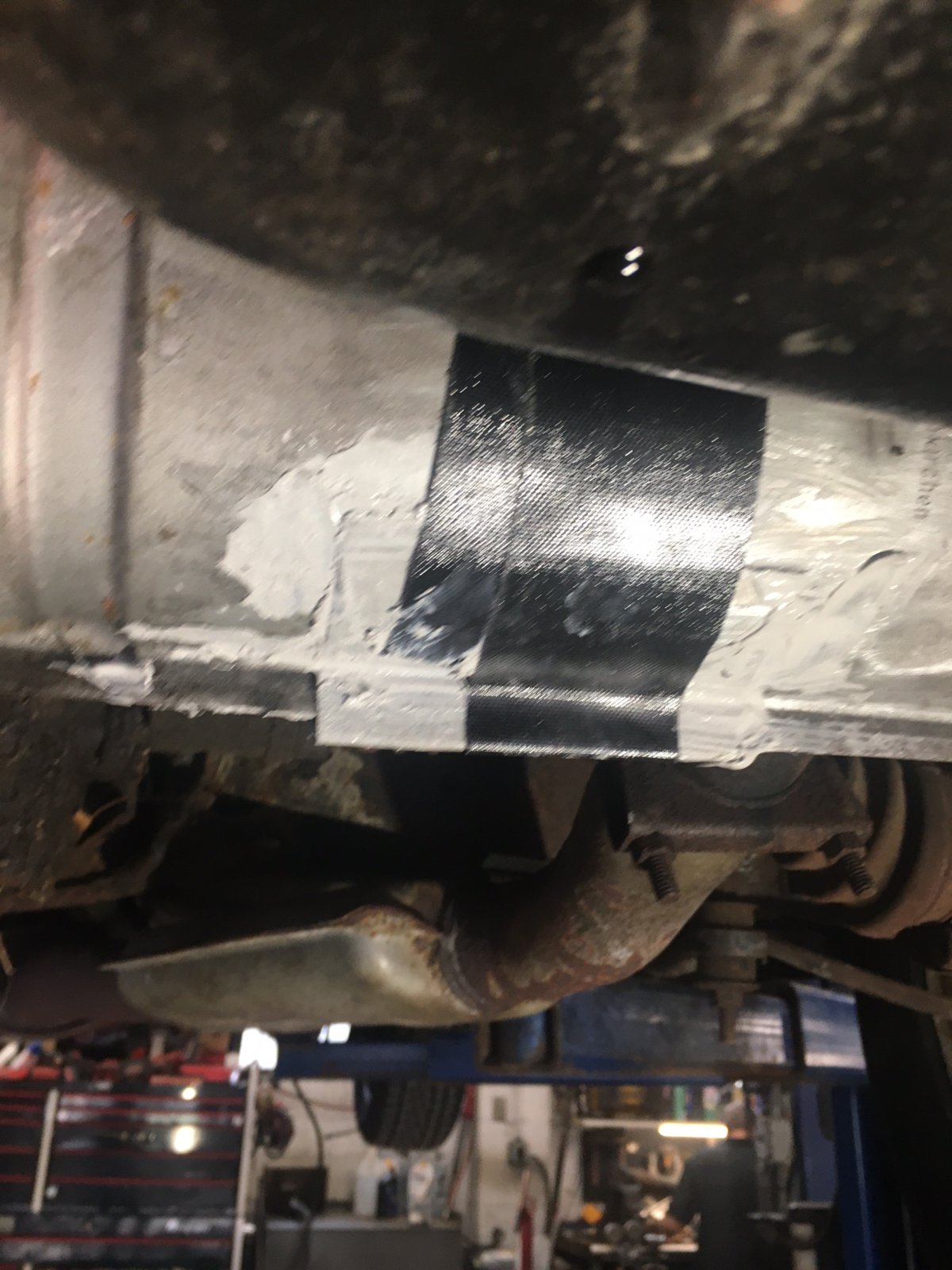

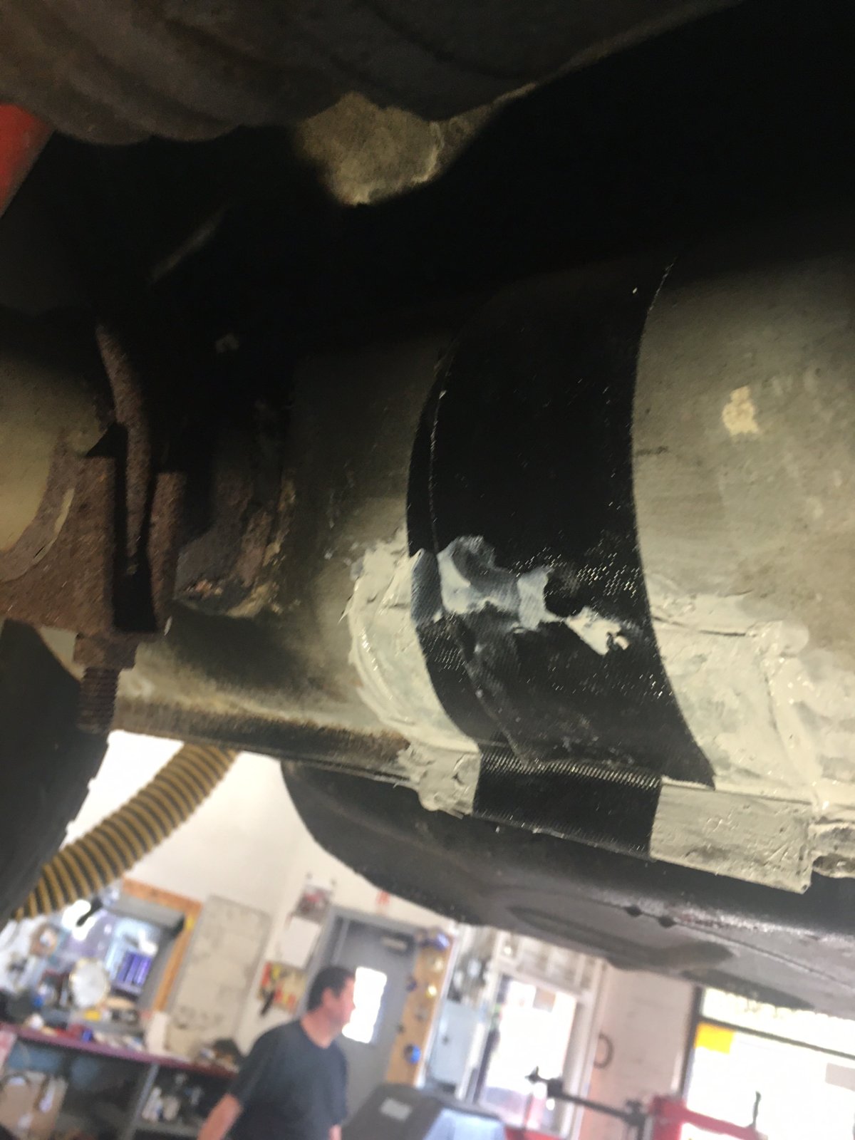

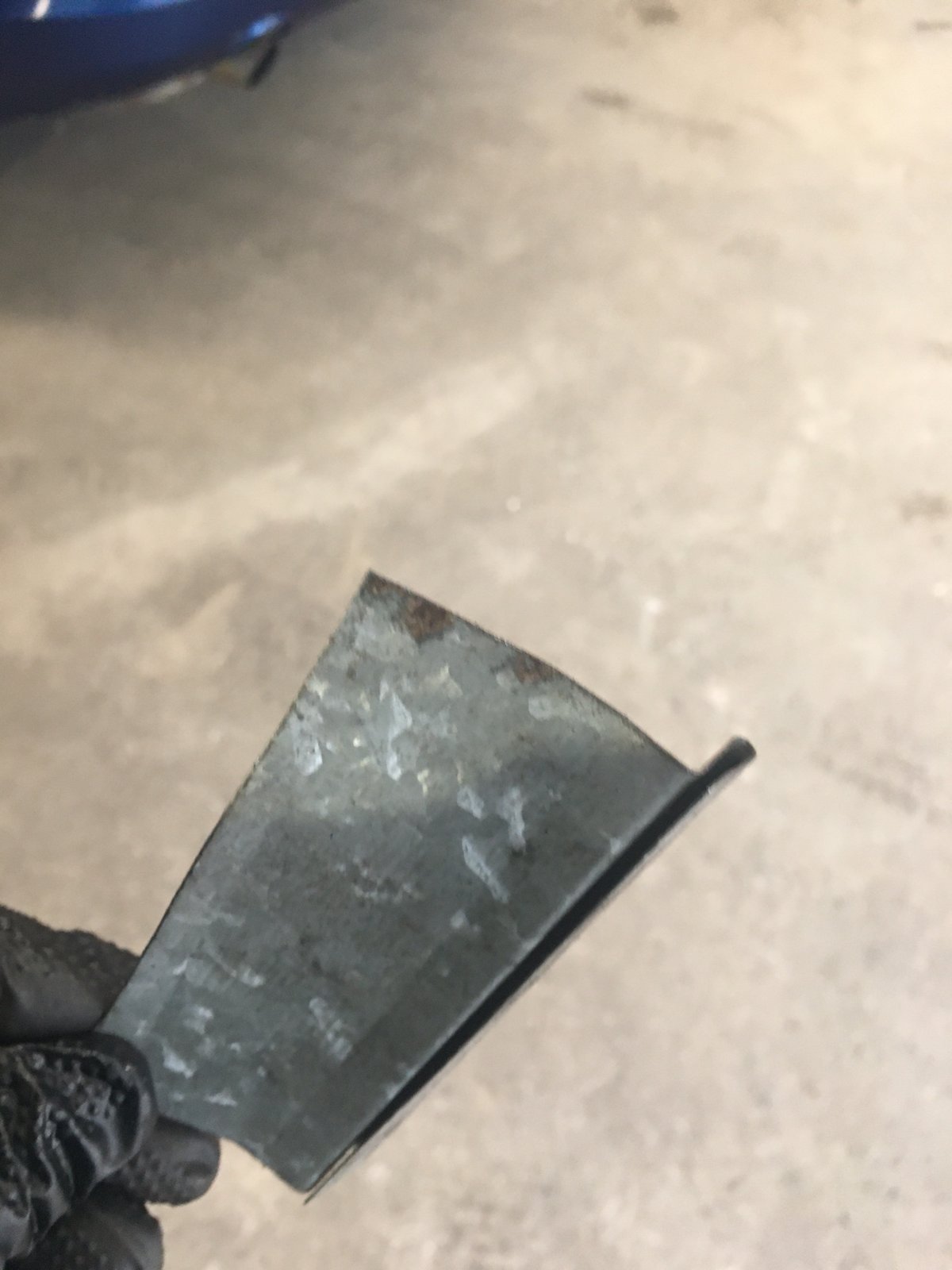

I ended up patching mine, using JB Weld, JB Tiger Patch, and a some sheet metal that I hemmed to clip in to the seam in the muffler.
It should hold until the spring when I'll address a more long-term solution. Maybe Stainless steel, depending on price and availability.
