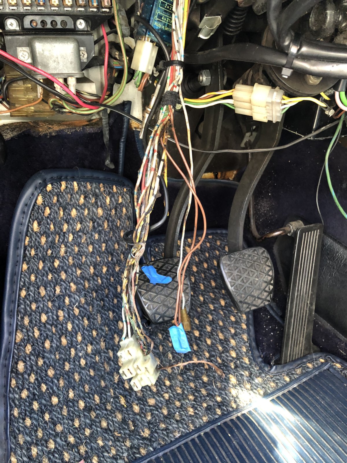

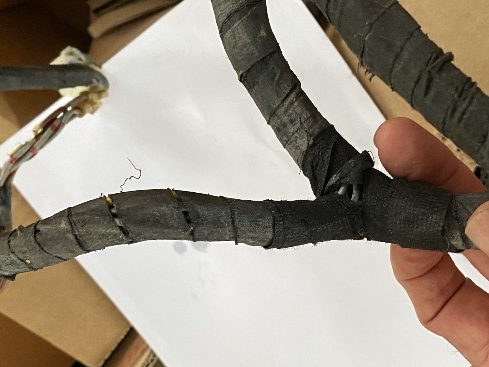

I am looking for a under dash electrical harness for a 1970 2800cs.
I had an electrical meltdown from the headlight switch wiring back to the harness. Damage is limited to approximately the first 12" from the light switch. Photo attached.
I will likely splice in the repair.
I am assuming the wiring is similar in early E9s and E3s.
Full under dash or partial.
Thanks!

I am currently during re-wiring the whole car electrical harness. I am not 100% sure if understood you well, but i can tell you that you can't replace partial underdash harness, some of cables from lights button go to fuse box, but some of them also go directly to front lights, speedo wiring etc., so if you don't want to disassemble the whole front harness with underhood part - in my opinion the easiest option will be to cut fried cables sections, replace this sections with new cables (aftermarket), solder them & protect with heat shrink sleeves. Or also pretty easy, little bit more work but better option - disassemble fried wires with connectors from lights button plug, replace them with new plugs & wires (aftermarket); new wires solder directly after fried area.

right, if the plug isn't melted, see if you can remove the spades in it and splice in new wires. Will be hard to get color-coded ones that match, but I guess, any will do since the runs won't be that long (12").

Thanks Waldek. That is the plan. Not intending to replace the entire harness but need the wires. Want to match the original.

Yes, thanks. Really want to try and match the original wiring color code if I can.

Can also hunt the junkyards and cut some wires off some old BMWs. I saved a bunch of it from the E21 and E34 I junked.

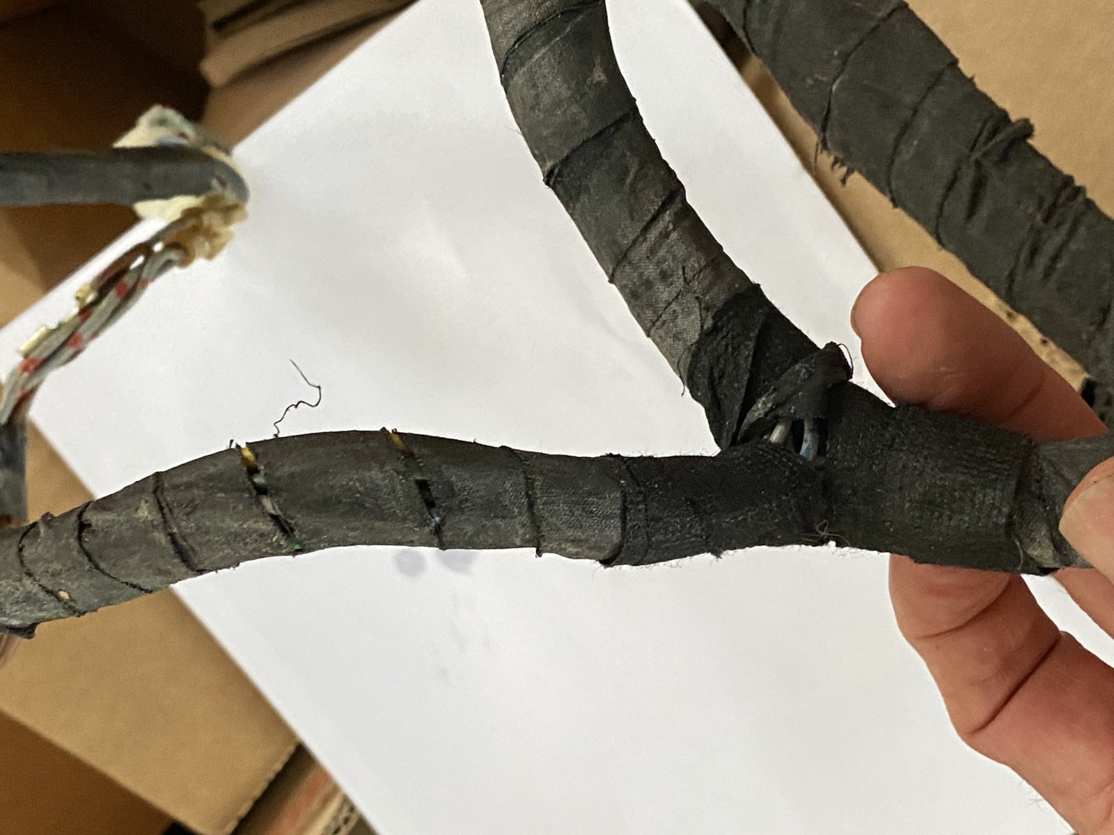

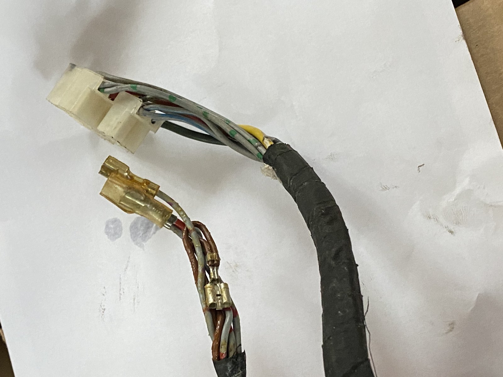

I have an extra harness from a 73 CS. I will try to look tomorrow and see if that section is still there.
Gary

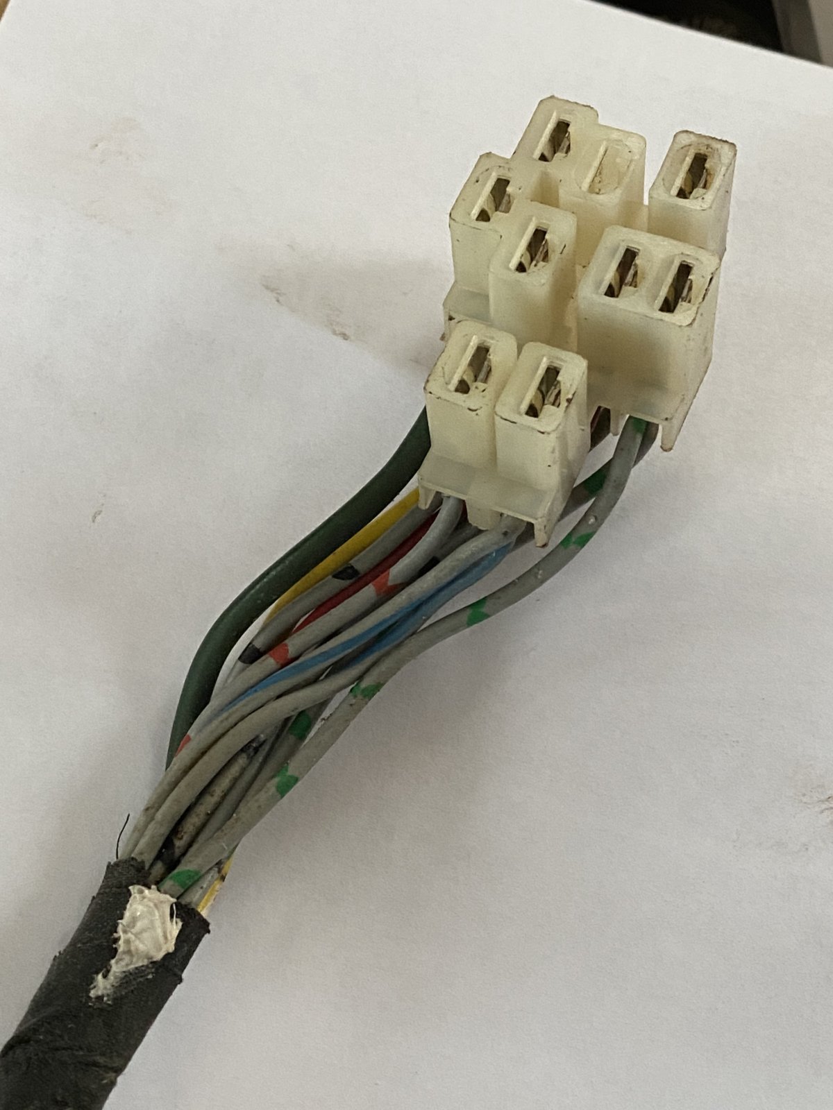

So is this the section you need that is in your photo?
I may have to unwrap some to look at it closer.
I think this harness came out of midyear 73 2250360.
Will look at it more carefully Monday. This may be stripes instead of barber pole.

I looked more carefully today and with your photo in hand I found this?
Does this look like what you need?
How far back?
Not excited about cutting up a perfectly good harness.
