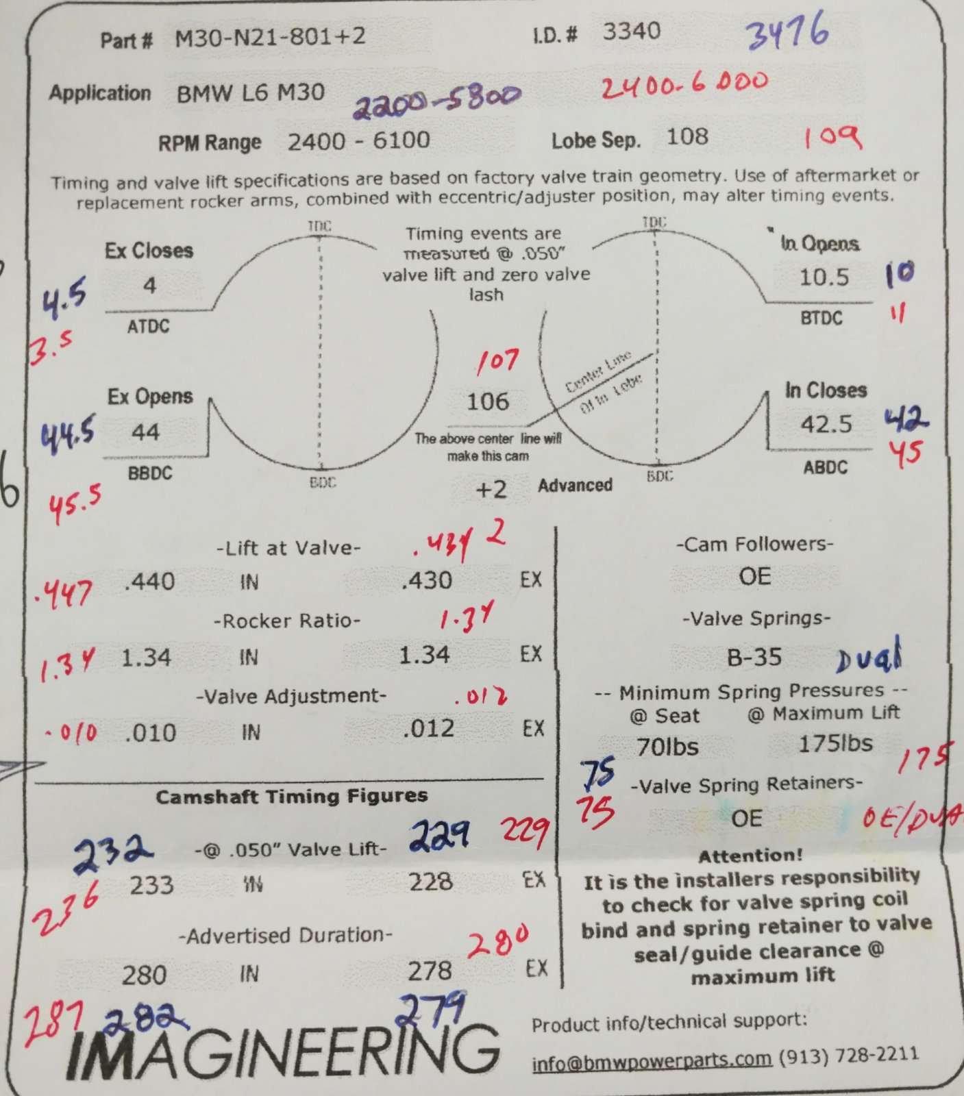

Here is a spec sheet for the n21 I have in my engine. I suspect it is similar to other n21's. Comparing cam specs is tricky. I think I will go for the 284/280 Shrick.
FWIW here is a slightly different spec N21. The paper has some of my writing on it but the original specs are clearly shown.

Chris - It is probably as close as you are going to get. If I remember correctly from the few, very long, conversations I have with Paul over the years (information overload). He spent considerable time designing a cam that would work better across the rpm range. Importantly, trying to get a flatter torque curve at the lower end of the range. He was after a nice street performance cam and not a racing cam.
