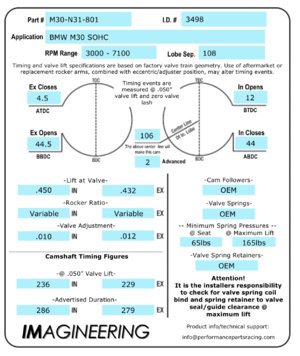

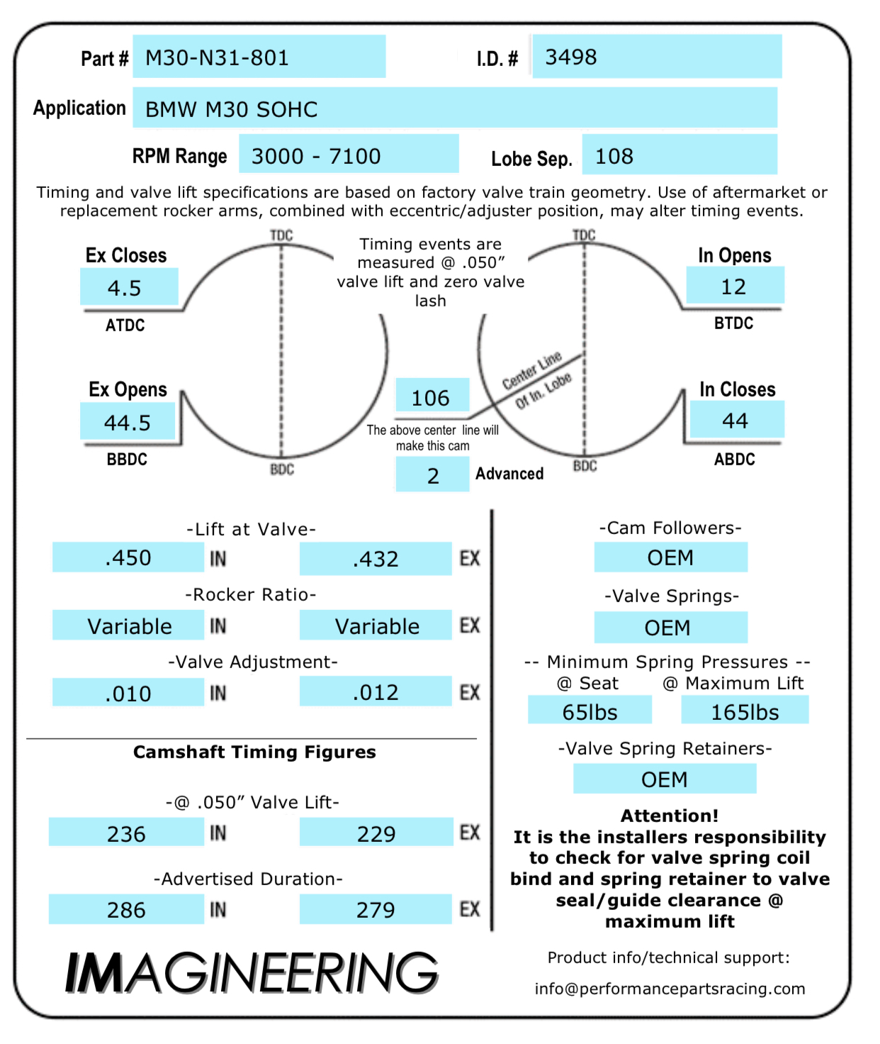

I ran the n31 in my 3.8 which I understood to be more of a hot rod cam vs the n21. I think the mega squirt, intake, head work, and headers contributed to it running smoothly. The engine pulled right up to redline which is also what I was looking for.

The cam is already installed in my M535i. My 10:1 engine I built for my other E28 with a Schrick Cam didn't seem to idle as low on the stock euro 061 DME comparatively. I can tune the chips though so I got it sorted out, but was just curious if this was something I should look deeper into. IIRC the reciepts are around 2013-2014 so I should be okay. This engine has never felt as torquey as with the Schrick but it pulls hard up top. The receipts from Paul said it had an adjustable cam gear. I embarrassingly haven't popped the valve cover yet to check to see if installed/where it is set.
Rotate your cam gear 1/2 tooth- you might end up with a more balanced output.
