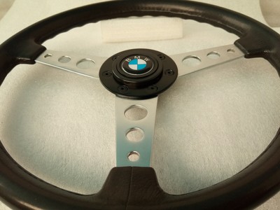

the black one isn't the same ... the e9 one - no hub / wrong horn button / looks like a 35 cm wheel.

That wheel -
www.ebay.it
BMW e9 Petri Steering Wheel new old stock Lenkrad e10 2002 alpina CSL | eBay
does look small.
