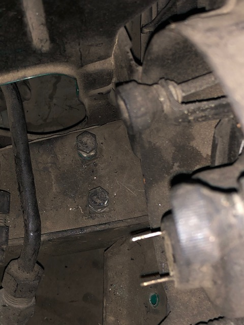

Apologies for the photo as it’s deceiving. I took another picture that didn’t save. The measurement is 5 cm precisely.
These pics are from the original mounts, but the conversation brackets should be the same size.

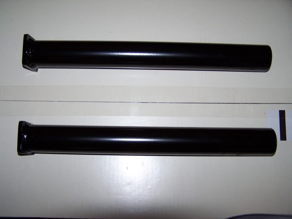

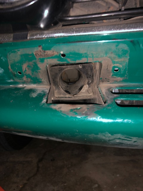

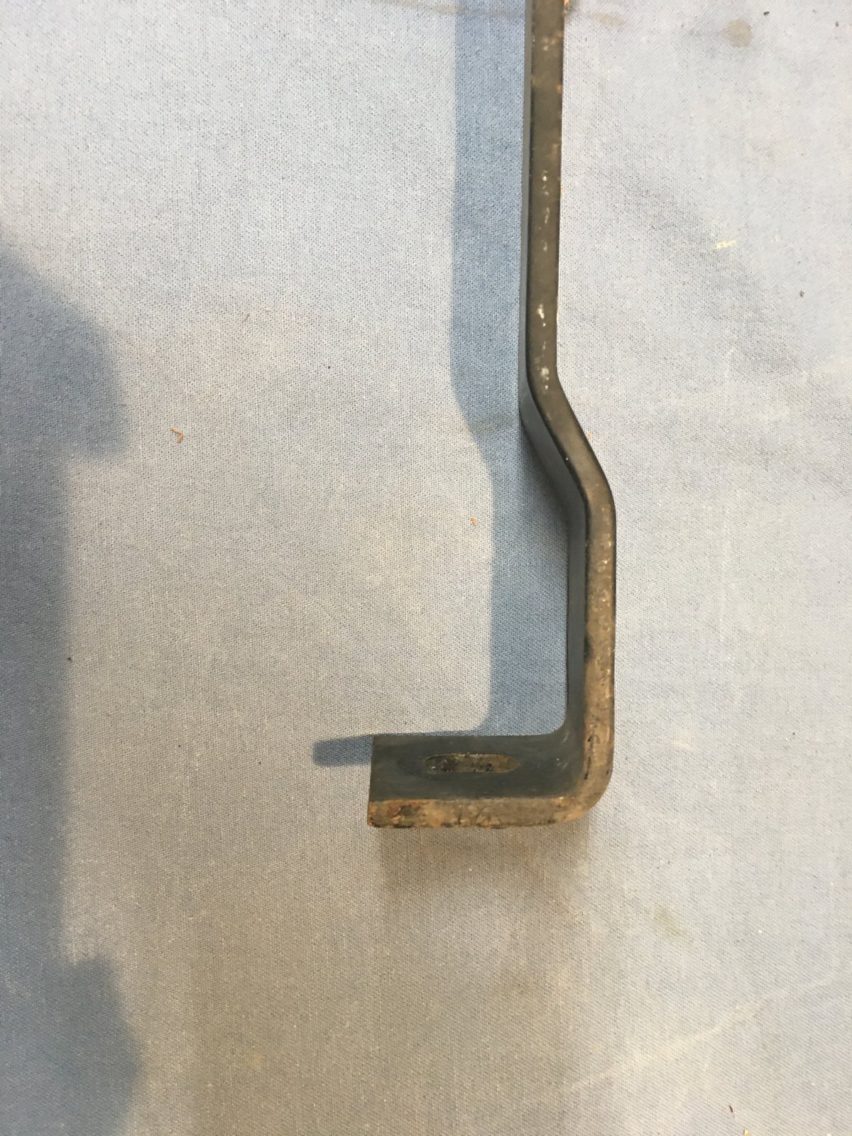

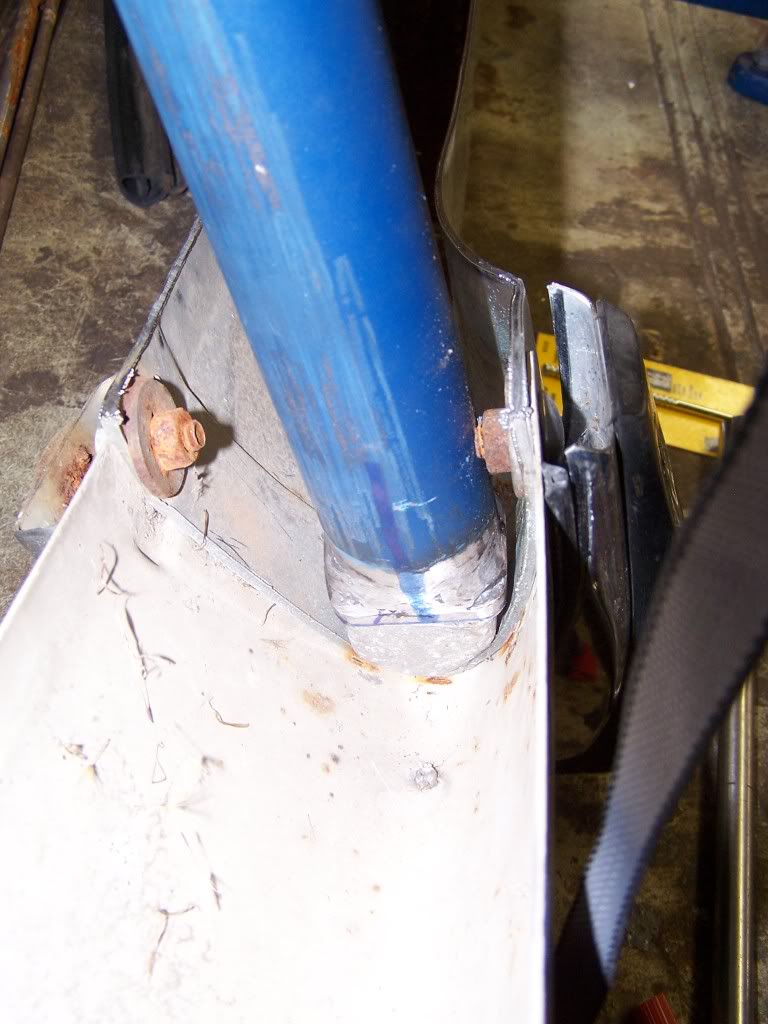

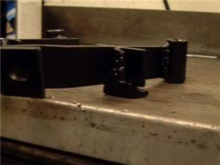

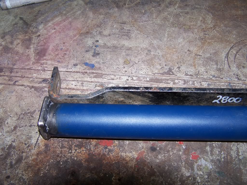

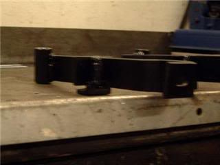

Found a set of the conversion tubes and, while remedial for some, I thought I’d show sizes I'm seeing for future reference. The actual OD of the pipe/tube is what counts, b/c the rubber receiving block gives a little & the tightening screws allow you to tighten the block over the tube a bit, but a larger diameter than original bumper shock may be too large.

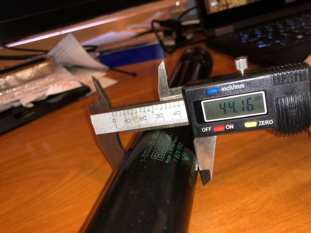

The original bumper shock is 44mm (1.73"), and they are a tight squeeze, so anything with an OD over 44mm might be a problem unless you shave down the rubber block hole. The most common plumbing pipes you can find at hardware/supply stores are 1 1/2” & 1 1/4”, which apparently have ODs of 1.900” (48.26mm) & 1.660” (42.164mm), respectively. So, the 1 1/2" pipe is out without adjusting the block.

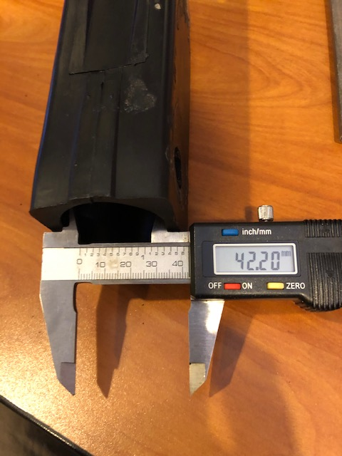

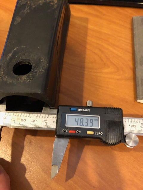

Here’s the block--becomes more oval with bumper shock removed. I had measurements between 42 & 48.5 mm on the openings, so not much guidance here:

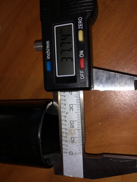

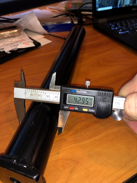

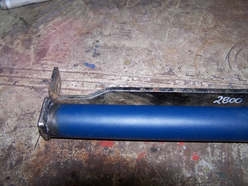

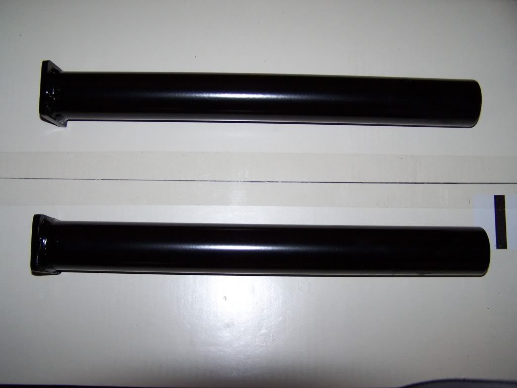

Here's the conversion tube bracket at 43mm OD & 37.75 ID (not perfectly round, so varies a bit):
There's a little play if you insert the conversion tube into the block outside of the car, but with the block fitted in the car, the tube is snug. And that should work fine, not only because of the big bolt in the back, but the two tightening bolts press on the block's steel plate giving extra pressure:
So, if you want to make some, you might try some 1 1/4" pipe. I'll add the angle of the front-facing brackets on the tube & total dimensions a bit later. I might give it a shot while we're shut in. All that said, I'm still on the fence whether to even use the conversion tubes.
