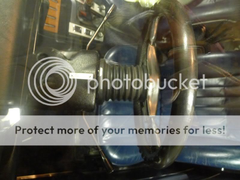

I installed my M1 steering wheel last night. While it feels quite nice, I noticed my hub appears to be quite long. Looking through forum photos, I see this Hub on this link is a little shorter than mine.

Now that I look again, maybe it is the same part at a different angle. Anyway, other than looking a little dorky, the fit is pretty good.

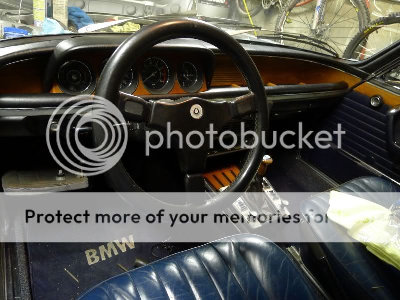

What you are showing us is a MOMO hub and those come in fact in different lenghts. A picture of your own wheel would help.
Gerrit
I didn't have a tape measure handy. Overall it is quite comfortable, so maybe I am jumping the gun, but it looks a little longer from the dash than a stock one would be.

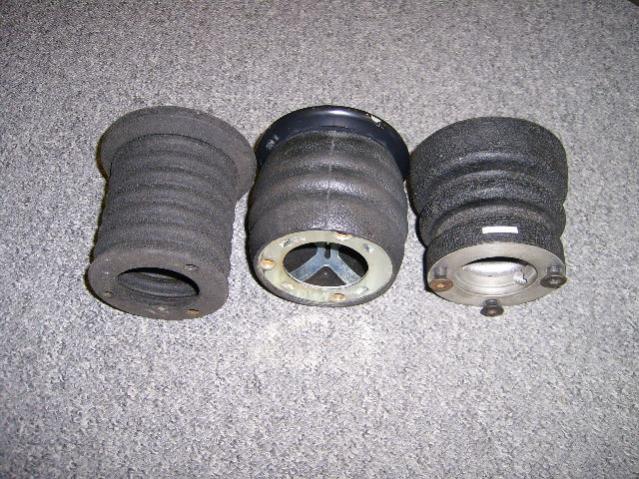

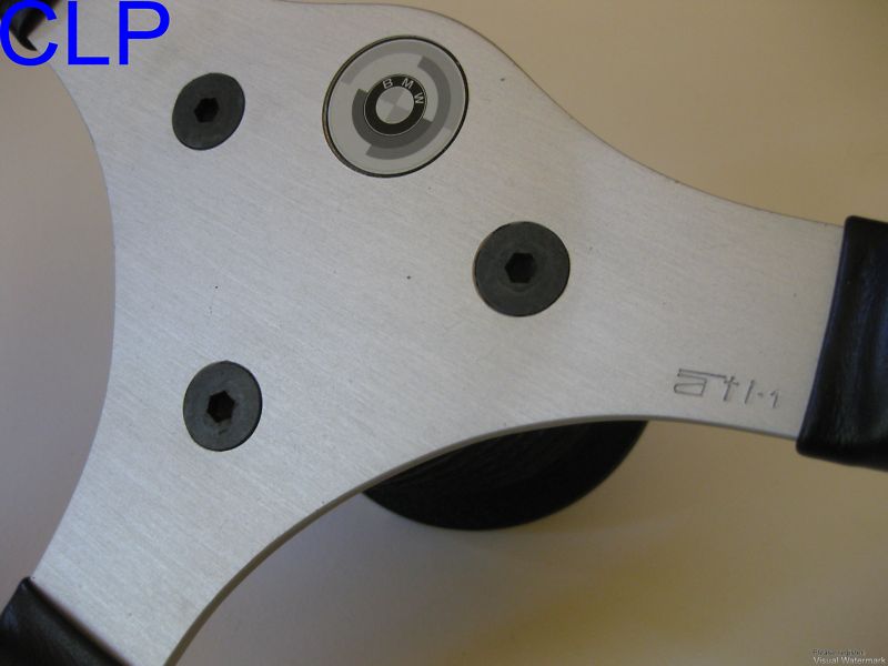

Looking at various pictures of how the Italvolanti wheel mounts to its hub, it appears that it is mounted with just 3 allen screws vs the 6 screws Momo style hubs and the Petri/CSL hubs. The Italvolanti hub does look longer than most standard hubs for BMWs. The Petri hub is approximately 3.75" long and I believe the Momo units are about the same length.
Hub
What you have in your car is an Italvolanti Ati3 from BMW Motorsport for the 6 cyl. cars, the hub should have the number 522. Those were available over the counter at BMW up to the early 80´s and although used also in race cars, those were not standard issue in the M1s.Here is a picture with the options for this wheel: Left to right: the 522 like in your car is 12 cm, the 520X 11cm, the 622 10 cm long.
