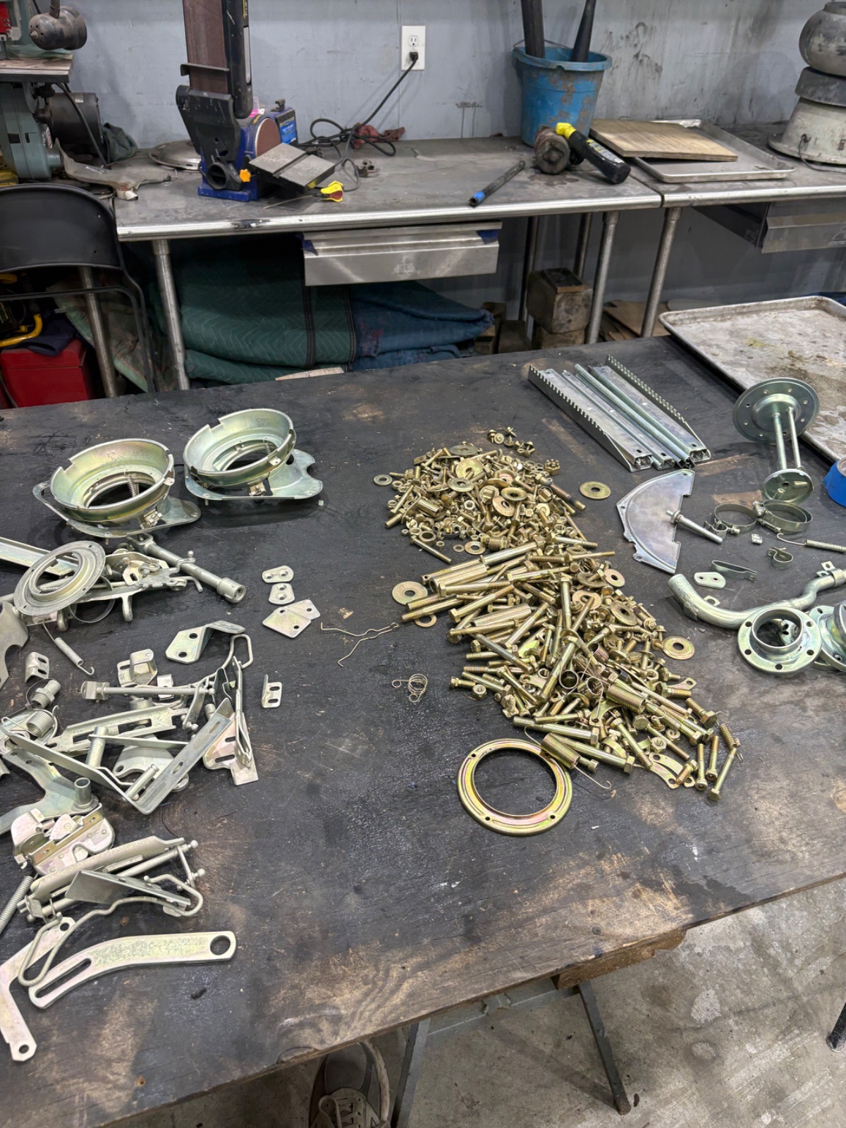

I just did about 10 lbs of fasteners other odd larger parts. I used Apex Anodizing & Metal Finishing in Sparks NV. They have 2 locations but the one in Sparks is the one you need. Their phone is 775-355-8121 and they will give you a quote. I used USPS small 2 day to ship there and they used the same to return. CA is pretty hard on this while NV is not. I talked with Jana getting the quote and they got the parts turned around in a week. I was happy with the results.
I know it's a long ways from where you are versus my location but the 2 day USPS may make it a reasonable solution.

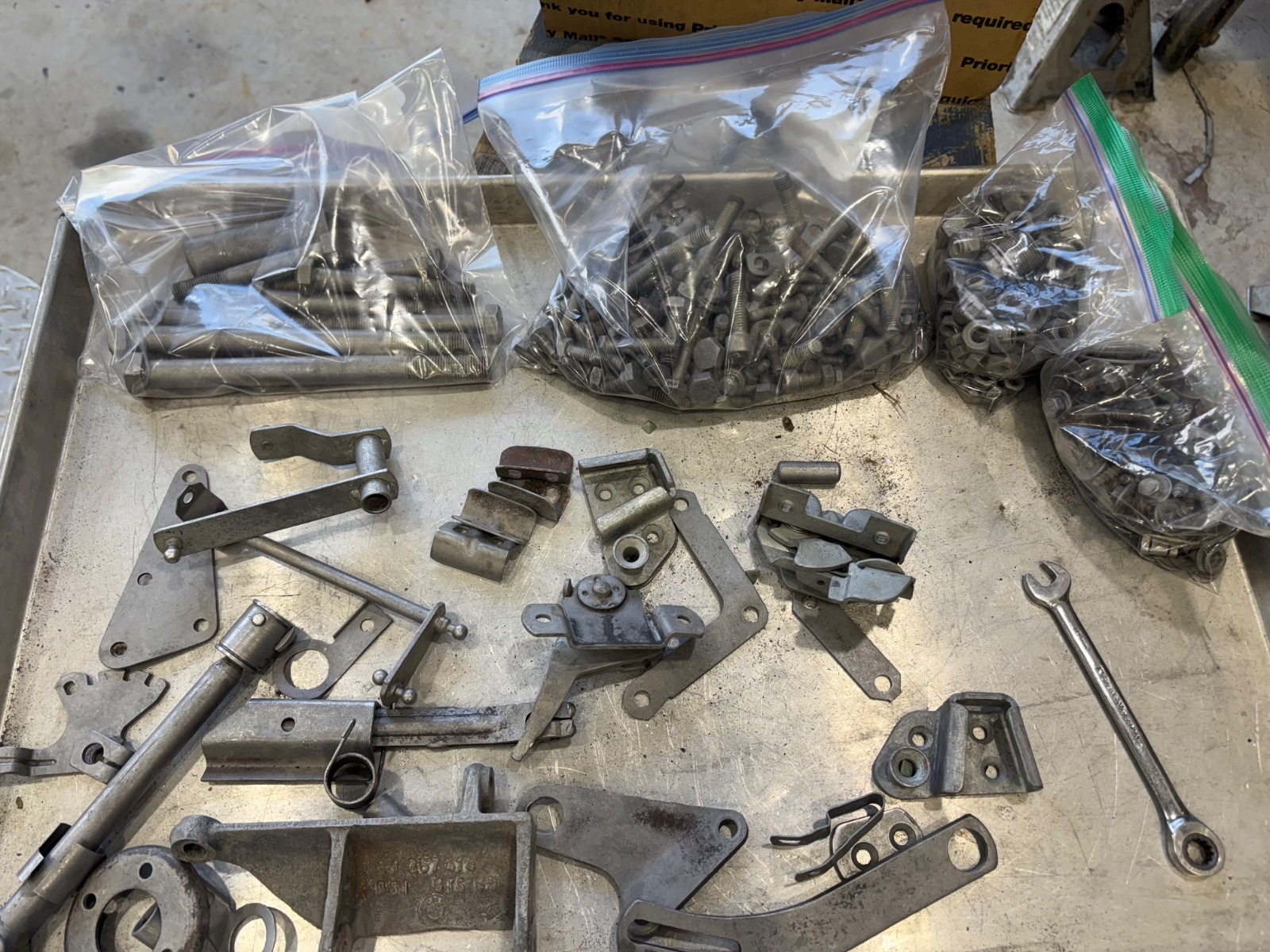

in my case, there was no rust. some of the parts had been painted ... so i had to get the paint off. some just had years of junk that was left on them - grease, dirt, etc.
i used the blasting media available in @bdigel's blaster ... it seems to be relatively fine. some of the items are things like the pushrods on the throttle linkage - just want them to look good (better than they did / better than they would painted ... maybe they would look better powder coated). some are things like the hood latches that the PO didn't remove when repainting the car black. the same thing happened to the trunk latches - they didn't get removed and had black paint on them.
so here's the follow up question - if they have been blasted, what is the best way to get them as smooth as possible? to get as good of a finish as possible ... i guess it could all be hit / polished up with 400 sandpaper
Yep, that'll do it. The finer you sand, the less visible the sanding lines will be.
I even spin the head of screws and bolts in a drill with some fine sandpaper. Mighty nice result.
