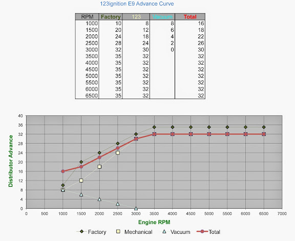

As a starter I based mine on having manifold vacuum increase advance at idle, drop off as throttle opens under acceleration, then mechanical is there to do its job, I have it all in at 3500 rpm at 32 degrees but I will likely lower this to 3000 rpm but need something to start with.
I made a spreadsheet to help set up curves, it has the Blue Book one, mechanical, vacuum, then plotted for total advance and comparison, then imported into the tune software:

Is there a particular reason why you use a vacuum advance curve based on rpm? I would think vacuum advance would be based on vacuum.

Only as a starting point to come up with a curve. I didn't know how much or if enough vacuum a single barrel will pull so I estimated based on how I thought it would go vs. rpm (High with throttle closed and dropping as throttle opened) to get started.

Only as a starting point to come up with a curve. I didn't know how much or if enough vacuum a single barrel will pull so I estimated based on how I thought it would go vs. rpm (High with throttle closed and dropping as throttle opened) to get started. Turned out I was wrong, my manifold vacuum curve looks like this:
Vacuum@RPM
-8@1000
-8.5@1500
-10@2000
-10@2500
-10@3000
-8@4000
-5@5000
Hardly linear like I expected. I am going to try tapping into the power brake vacuum which comes off the intake manifold and not so close to the butterflies and see if that makes a difference. Another option is to tee all the vac ports together to smooth out the pulse (which may be throwing the distributor off) but that may cause mixture issues with single intake per barrel.
If not I may just go straight mech advance but I was hoping to utilize vacuum for highway economy.

I haven't driven it yet so hope to this weekend. Readings were taken from the software in neutral.
There is some smoothing in the software but they say you may need to reduce pulses if it acts unusual. I bought an anti-pulse valve used on old Alfas from the uk but it isn't here yet. I may make a homemade version while i wait.

I love it. Before fiddling with advance curves at all I uploaded the basic one noted previously and took it for a drive. It ran great right away and after a while I realized I was now subconsciously shifting at a higher rpm, the engine is notably smoother and the howl from the Webers has a wonderful note.
I took some vacuum readings with my mechanical gauges to see how that behaves at speed and load from the three Webers. Vacuum from a single barrel seemed to be less accurate than hooking all 6 to a tube (smoother signal too) so I used that. Under this scenario though I think my engine runs a little richer because joining the barrels together effectively causes a leak (each barrel wants to suck mixture in from it's neighbors) so when my Alfa pulse eliminator arrives I will experiment again with a single barrel.
Since DCOE's typically don't have vacuum ports you'll just be running with the mechanical graph and leaving the vacuum graph at zero. This will work fine because you can set idle advance higher and then set the advance rate anyway you want up to the max very easilly. Essentially you can do in a minute what would take a distributor re-curve shop a couple hours to do with limited accuracy. This is the best feature of this distributor - dialing in an exact curve with no mechanical errors to worry about. You can watch how it behaves in real time with the dash display. One note about that-the optional USB cable from 123 is not long enough to reach from the distributor to the front seat so you'll need an extension cable. I have to give a shout out to Ed Madak from 123ignitiionUSA who has patiently answered several of my noob emails to help get me to this point.
The only advantage to me messing with the vacuum features of my model carbs is to try and get a little fuel economy at cruise on the highway. Here is the curves chart I settled on for now after today:
For the mechanical curve I set it to 15 at idle and max all in 34 at 3k rpm. The vacuum advance curve adds 6 degrees advance at idle and drops off as the load on the engine increases. The manifold vacuum drops to 0-2 Hg's under WOT/heavy acceleration so I want all vacuum advance gone during this. So since it adds another 6 degrees my total idle advance is 21. The engine loves this much idle advance and the acceleration from it is lively. Is this too much idle advance?
Here is my main question if the day, at light cruise load (65 mph), the timing is all in at 34 and the vacuum advance adds another 5 or so to max at 39. If I accelerate quickly I can see the manifold vacuum drop out and the advance goes back to 34. Pretty cool.
Is 39 too much advance for light load cruising? Other sources say engines can take much higher than this for light loads (like mid 40's and up) and it really helps fuel economy but I can't find anything specific to the M30. What is the max advance allowed under this scenario?
Under load the advance does not go above 34 and I have no pinging at all. It feels like the engine could go with more but I don't want to risk anything.
Any ideas on max advance at cruise loads?
Once I feel comfortable with this it's off to the dyno to dial it in for real.
