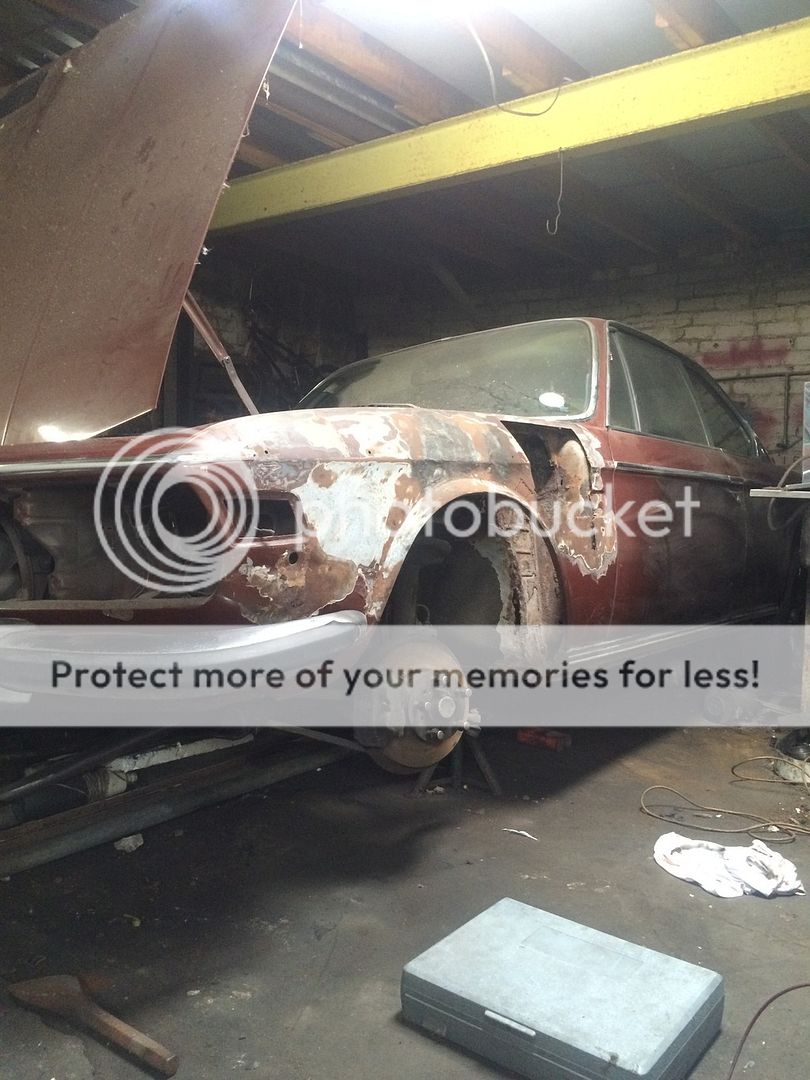

Hey chaps, been around for a while so thought I'd post up a restoration thread for the old girl.
I have a feeling this project is going to take most of my time and steal whatever cash is leftover from the mk1. It's been sitting in the lock up since 1987/8 alongside the mk1 rusting away. It's all complete, original M30 and has been converted to a 4 speed manual. Body is in pretty bad shape, majority of the work needed is in the front bulkhead and wings, as well as the floor on the drivers side although the passenger side could do with replacing. Thankfully the more expensive trim pieces are ok with the exception of the drivers side door handle (although it is my understanding that this is common due to the lack of reinforcement) . I found an e28 528i clyinder head/manifolds for going fuel injection, but I'll be probably going with some porting, a hotter cam, tubular manifold and megasquirt and a slightly higher CR which I hope should see me to 230-240bhp coupled to a getrag 265.
This is when I first started unearthing all the gubbins that was surrounding it.
Put some fuel in her and it fired right up. Idles great, seems responsive, but the clutch is seized.
I'll have to get some better pics and go into more detail when I'm on a PC.

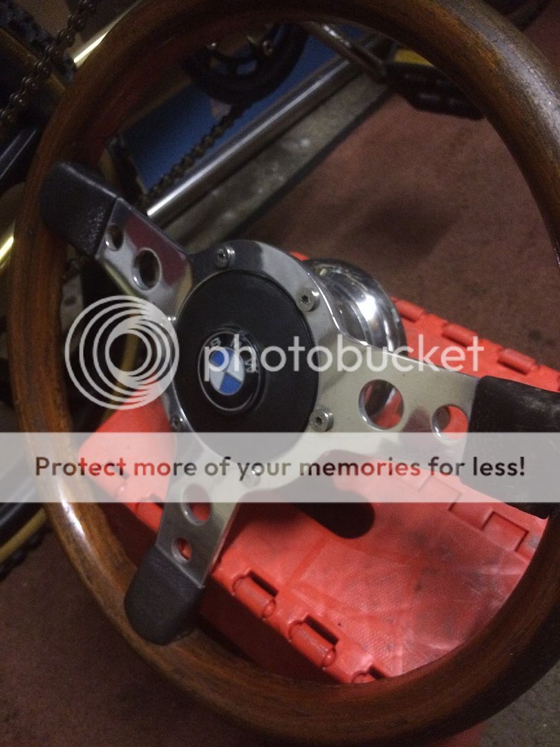

Started polishing the wheel i found, wood decent to be sanded down and re varnished but it should compliment the interior wood nicely.

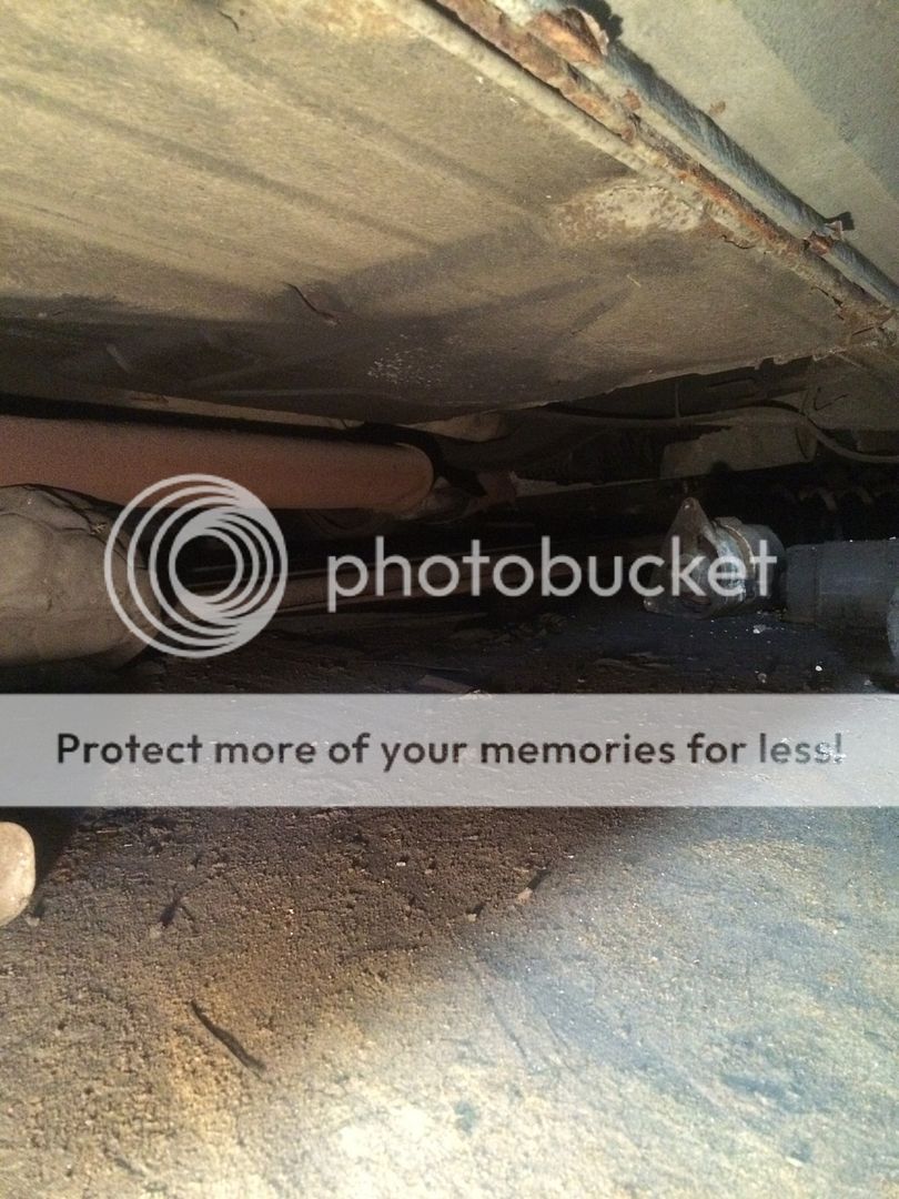

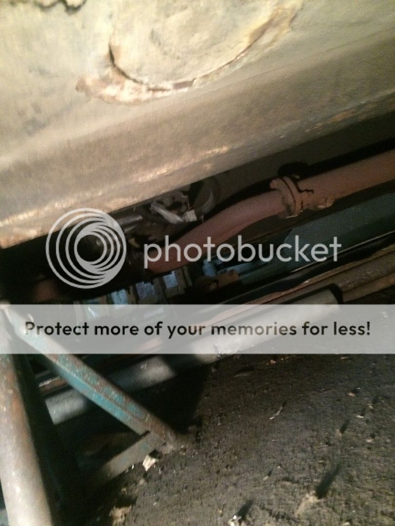

So i've started to clear out all the the rubbish underneath the car in preparation to get it back on 4 wheels. I was a bit worried that being jacked up on one corner for so long would have distorted the chassis but the shut lines on the car are perfect. The clutch pedal was not moving, initial thoughts were master cylinder was seized as there was absolutely zero movement. Removed it and after applying a small amount of pressure to the rod end that connects to the pedal it squirted fluid across the garage! Reinstalled it but it was not building any pressure whatsoever in the system. Thought a line may have been blocked so attempted to purge the system with a compressor from the slave cylinder, however the master cylinder had been incorrectly repaired at some point and the small washer was incorrectly installed allowing for the metal pin to pop out of its socket, reapplying the pedal promptly broke both pin and master cylinder. These have now been repaired and are ready to install!
Just a matter of getting the clutch to work and it should be ready to move under it's own power.
Also, had a chance to look underneath the car, the floorpan seems solid (with the except of the O/S which I knew was rotten), Both inner sills are gone at the front, but for peace of mine all 6 sills will be replaced.
Awful photos I know, but not long until I can really get started on the old girl!
