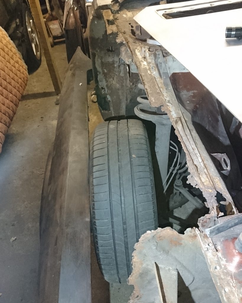

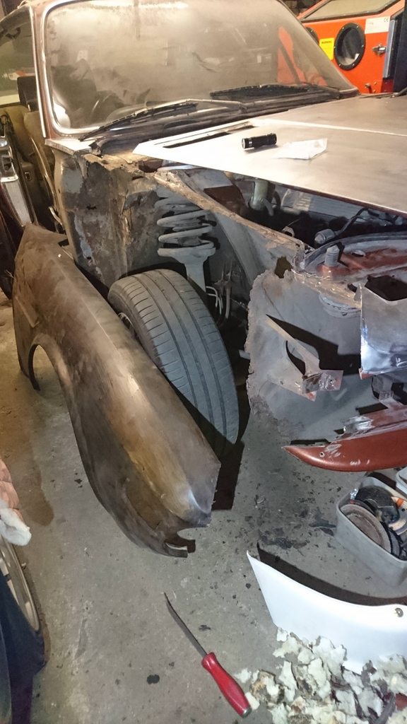

More importantly, made a start on the bodywork. Wing separated at the front and spot welds all drilled out on the top. Door and bonnet off, need to drill the spot welds off inside the door shut and then separate the wing from the top and bottom by the a pillar.

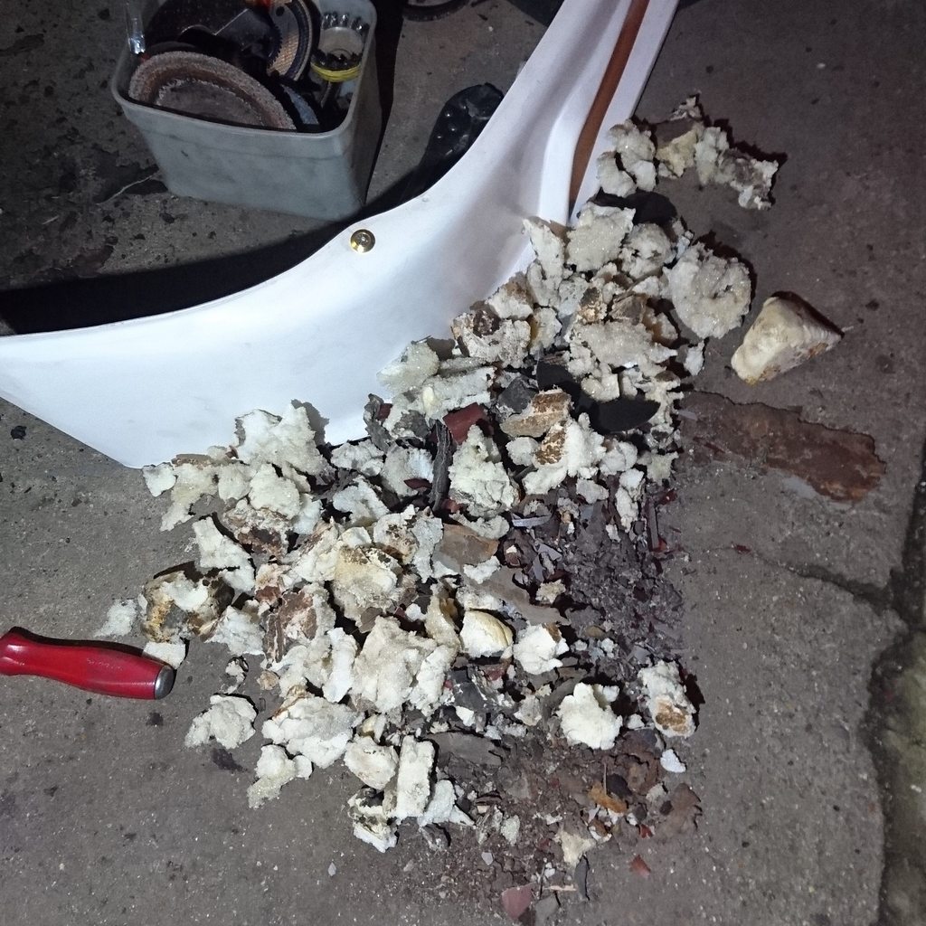

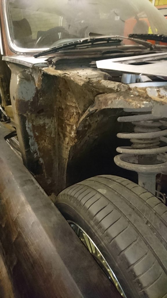

Well....thats a surprise.
This is about half the expanding foam I found in the inner wing.
Oh, that's horrible.
Bet it trapped the moisture in as well, which is what you want.
This sort of stuff keeps me awake at night as I'm going to tear down my CS for a respray in a year or so.
I' guessing you had a bit of an idea there was rust in there from looking in the wheel well?
If its not rusting or bubbling, I assume it's filler or fibreglass.
At least that way if there is good metal underneath I get a pleasant surprise
This is interesting. The previous owners must have put the expanding foam in there to keep the water out. Given that the rust on your car has not turned the inner wings to lace, like on most UK cars it might have had an effect.
Most modern cars use expanding foam for NVH and in some cases to increase structural rigidity. I was wondering whether some of this tech could be used on an older car.
