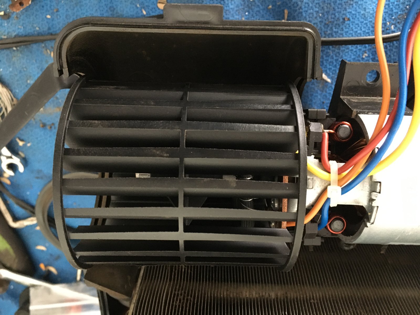

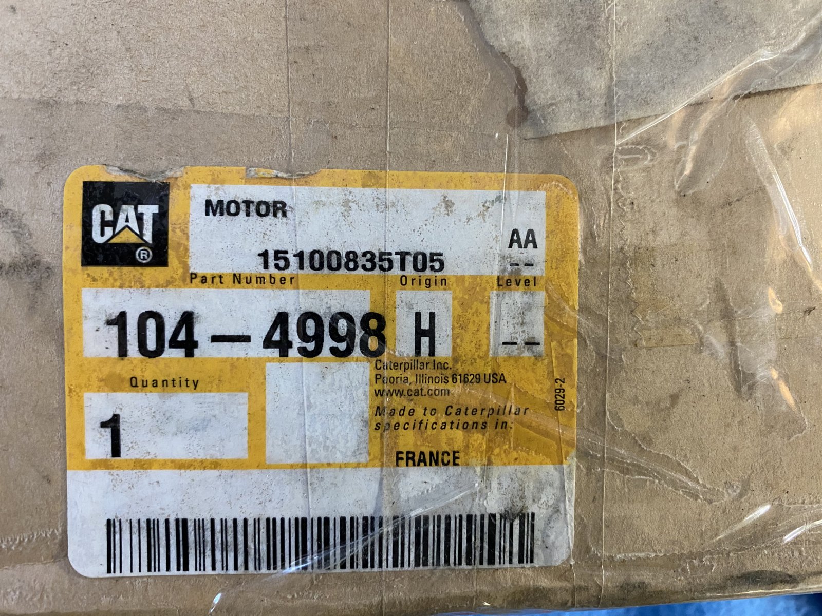

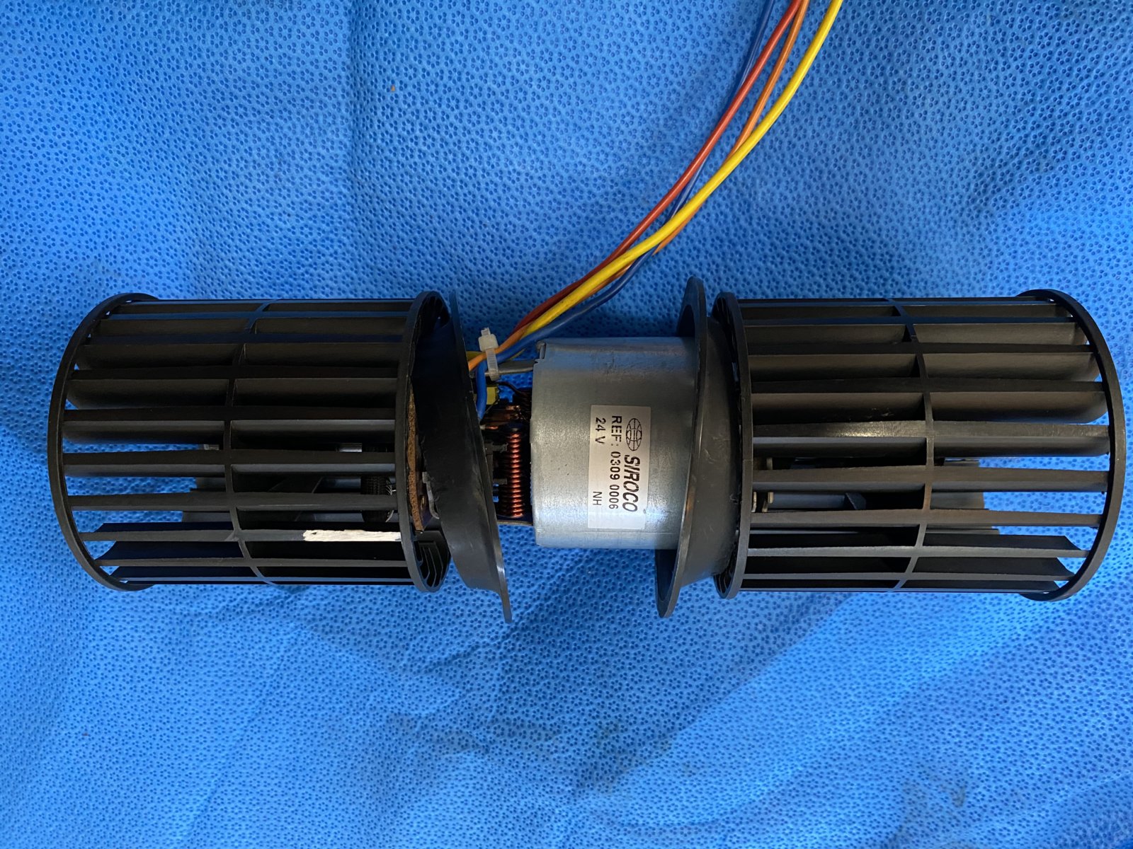

Here's the Caterpillar 24 Volt blower fan. This version came with plastic fans but the Behr/Bosch metal fans can be retrofitted. The only modification needed to fit the assembly is to slide one of the plastic fans further inboard.

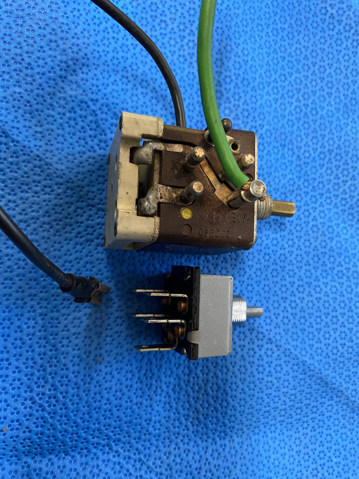

You'll notice the fan has 4 wires. This is because it has built-in resistors to vary the speed. What this means is that we can ditch the problem-prone switch and go to a simple 3 speed fan switch as seen below, next to the original switch. This switch is easier to fit and one more weak link in the system is removed. The replacement switch is Four Seasons 35702

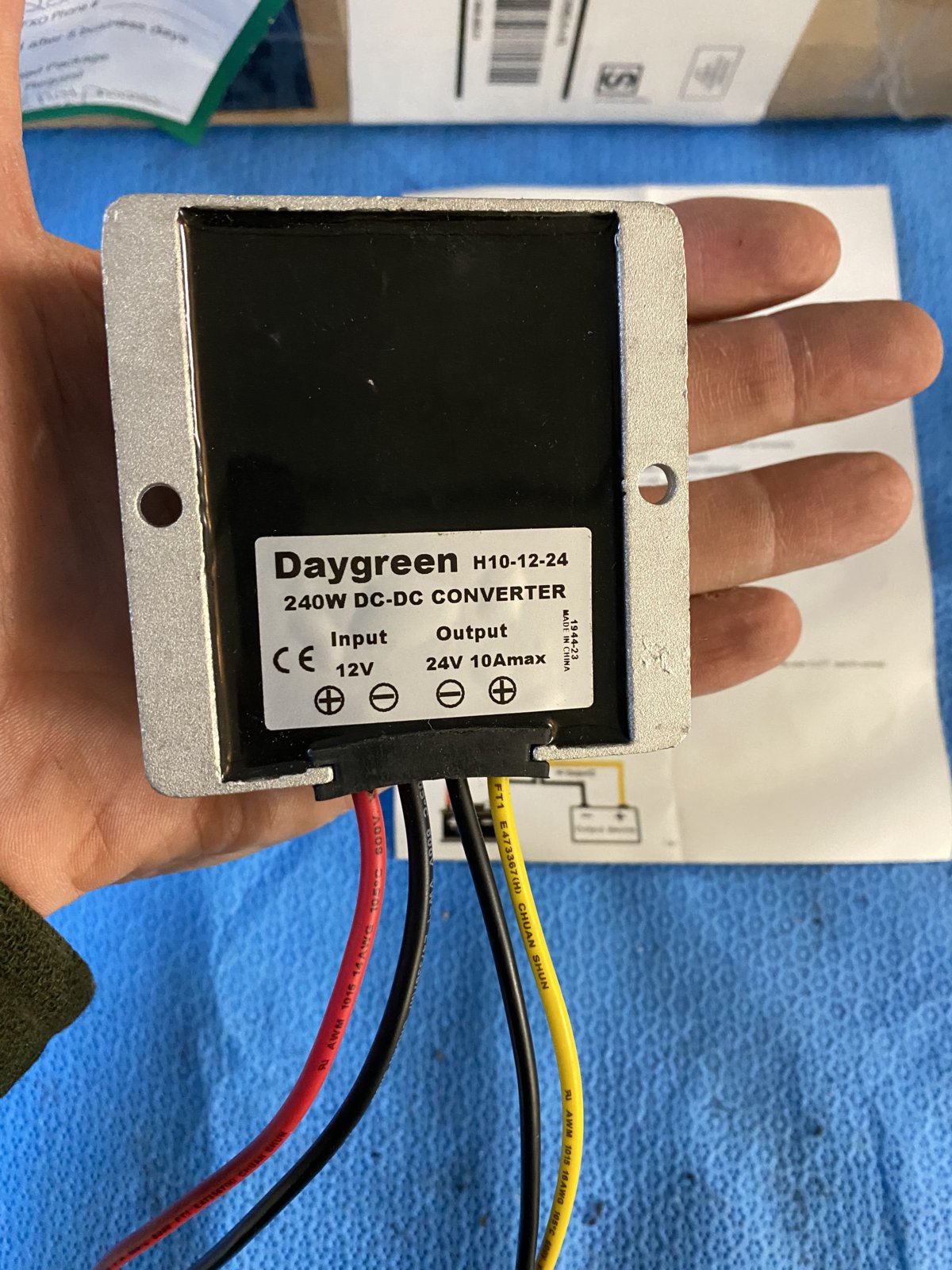

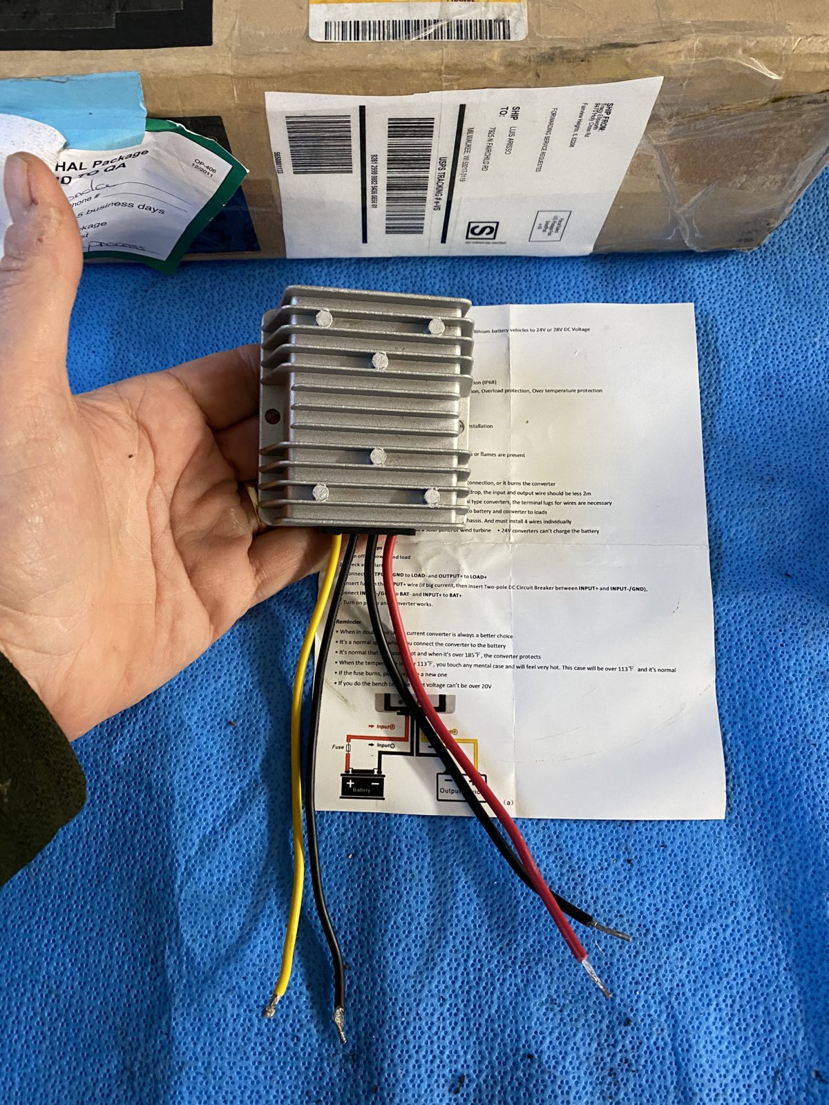

In order to run the fan a step-up converter is necessary. These things have gotten very cheap, small and efficient in recent years. This is one is very small, >95% efficient and consumes under 10 milliamps when idle, which is negligible. Full specs here: https://www.daygreen.com/products/12v-to-24v-10a-240w-dc-dc-step-up-converter-voltage-regulator

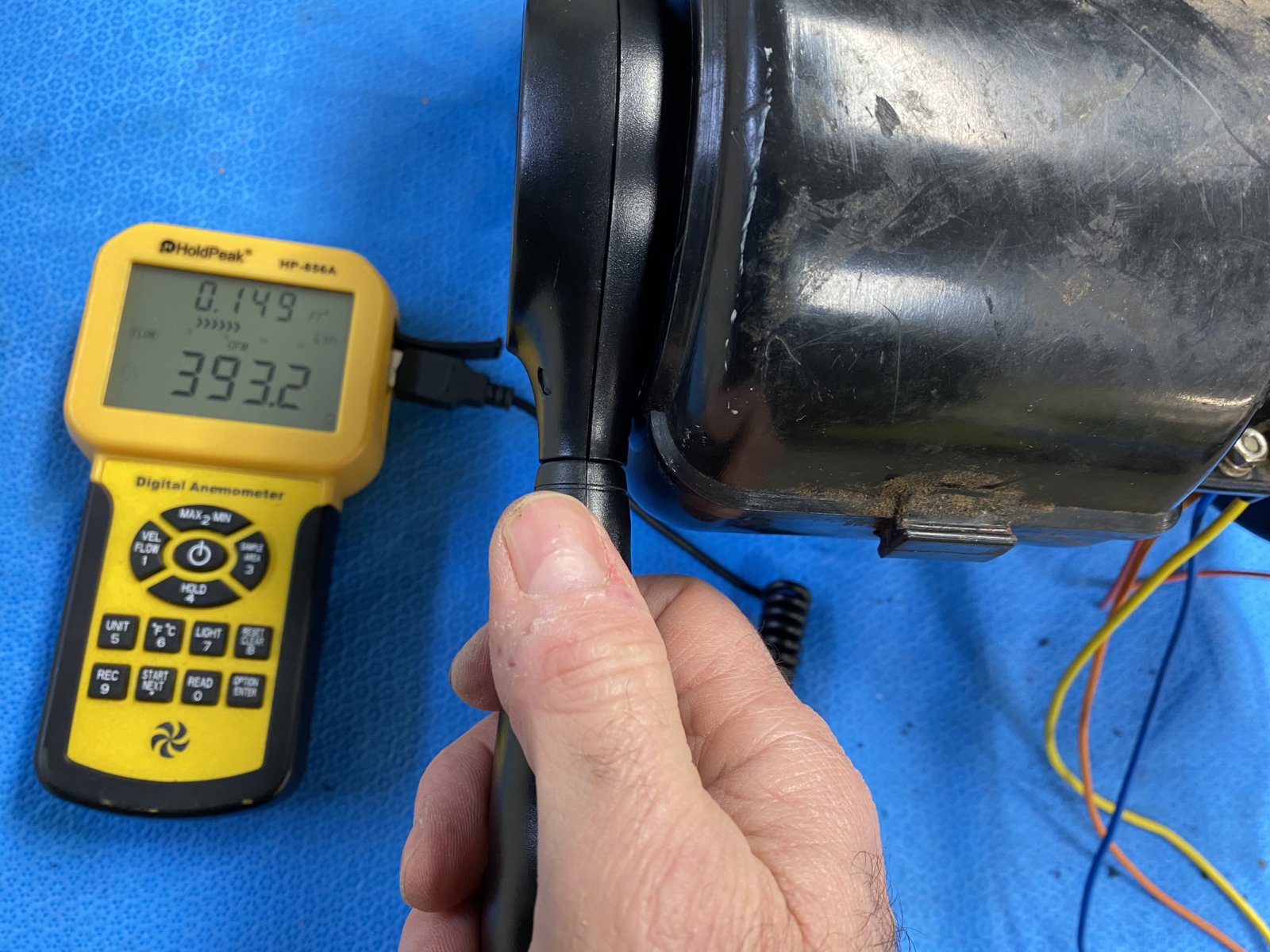

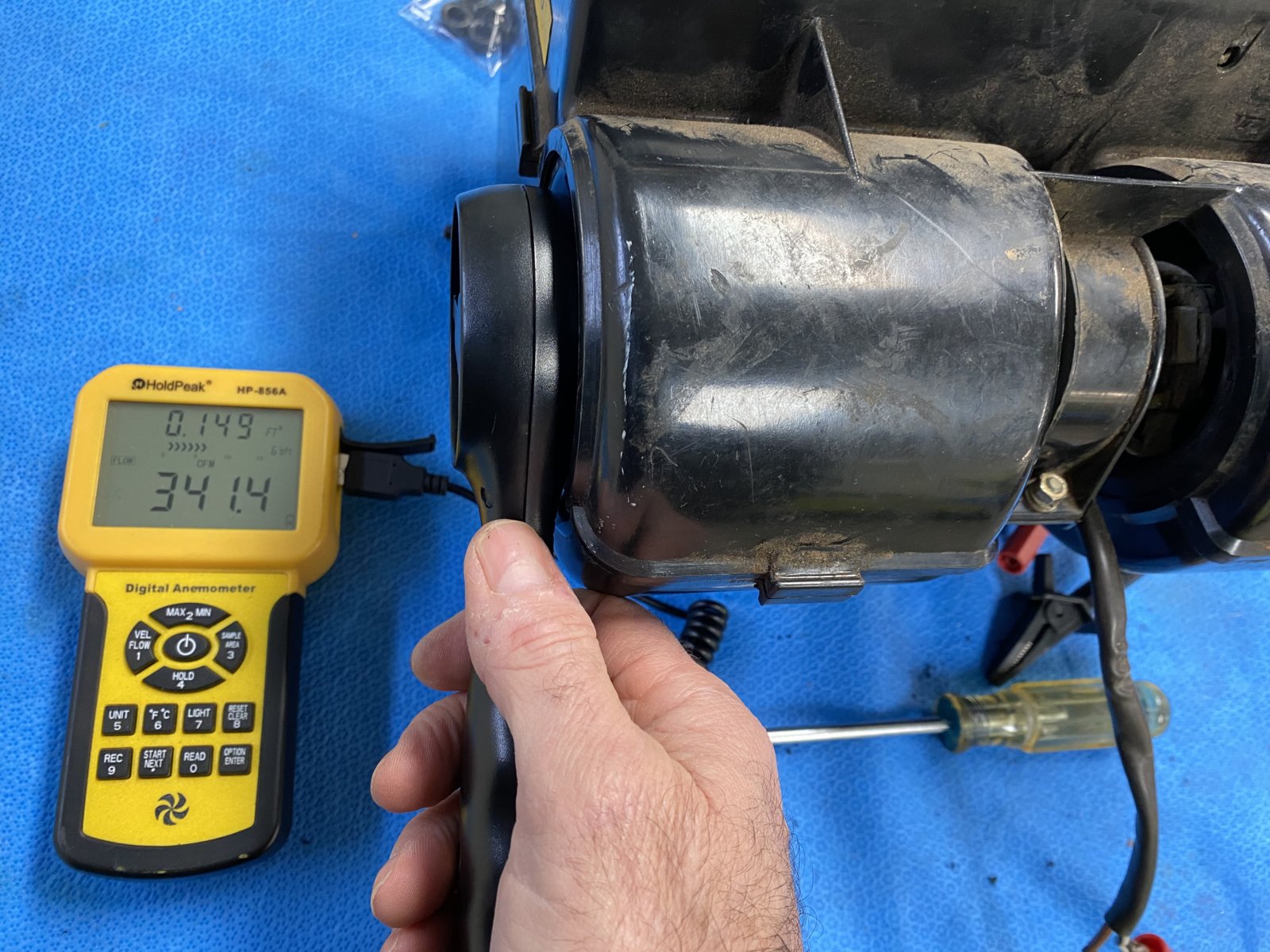

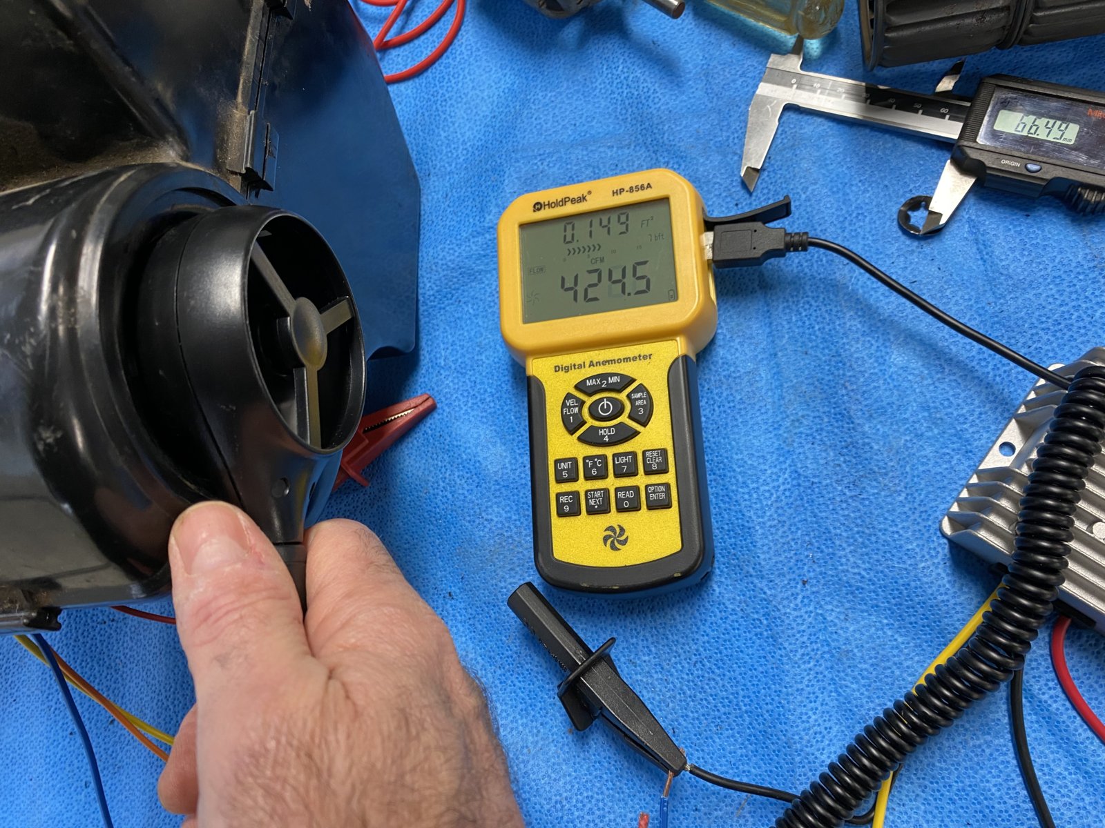

So how much more air volume does it provide? I ran a test set up with a loaner evaporator box courtesy of Stevehose (thanks!) and measured wind speeds and given the air outlet area teh anemometer calculates the volume in CFM. The voltage was around 13.4 volts from a running (modern)vehicle alternator so current supply was not a limiting factor.

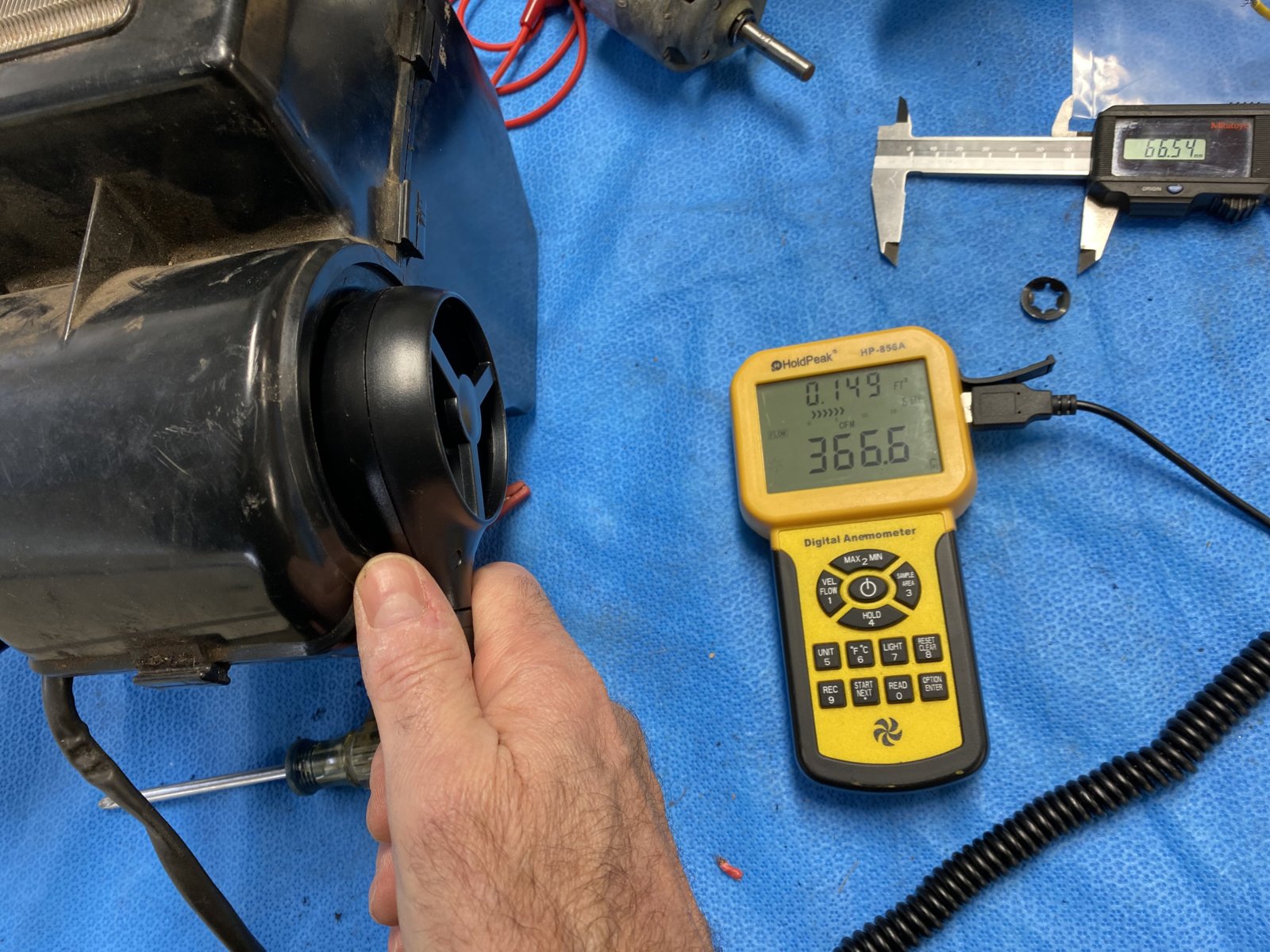

I found it most meaningful to measure the airflow into the unit, left and right. Interestingly, the air draw is not symmetric, it pulls more air from the right side.
The average measurement with the Bosch fan on the left side was 340 CFM and with the Cat, 390. On the right side, 367 CFM Bosch, Cat, 420. So an improvement of nearly 15%. Since this is air volume, I think it's pretty significant. An automotive HVAC expert on Quora claims 1,100-1,500 CFM is what modern auto ACs provide. Besides the improvement, it helps me lose the difficult-to-source Bosch fan and fan switch.

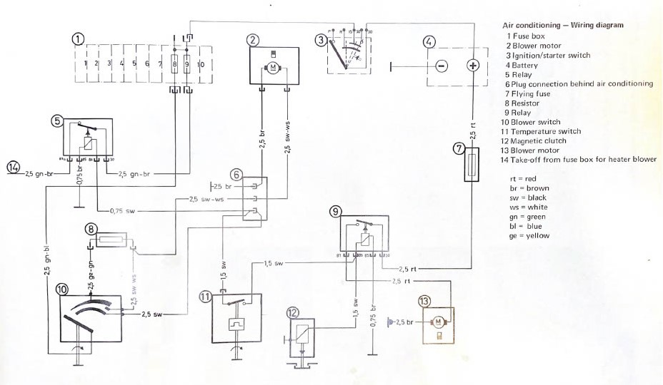

Blow is the stock wiring diagram for this section of the car and the modifications needed to incorporate this. I have not yet implemented this as I have zero desire to pull the console for a 3rd time but I see no reason why it wouldn't work, but please feel free to critique.

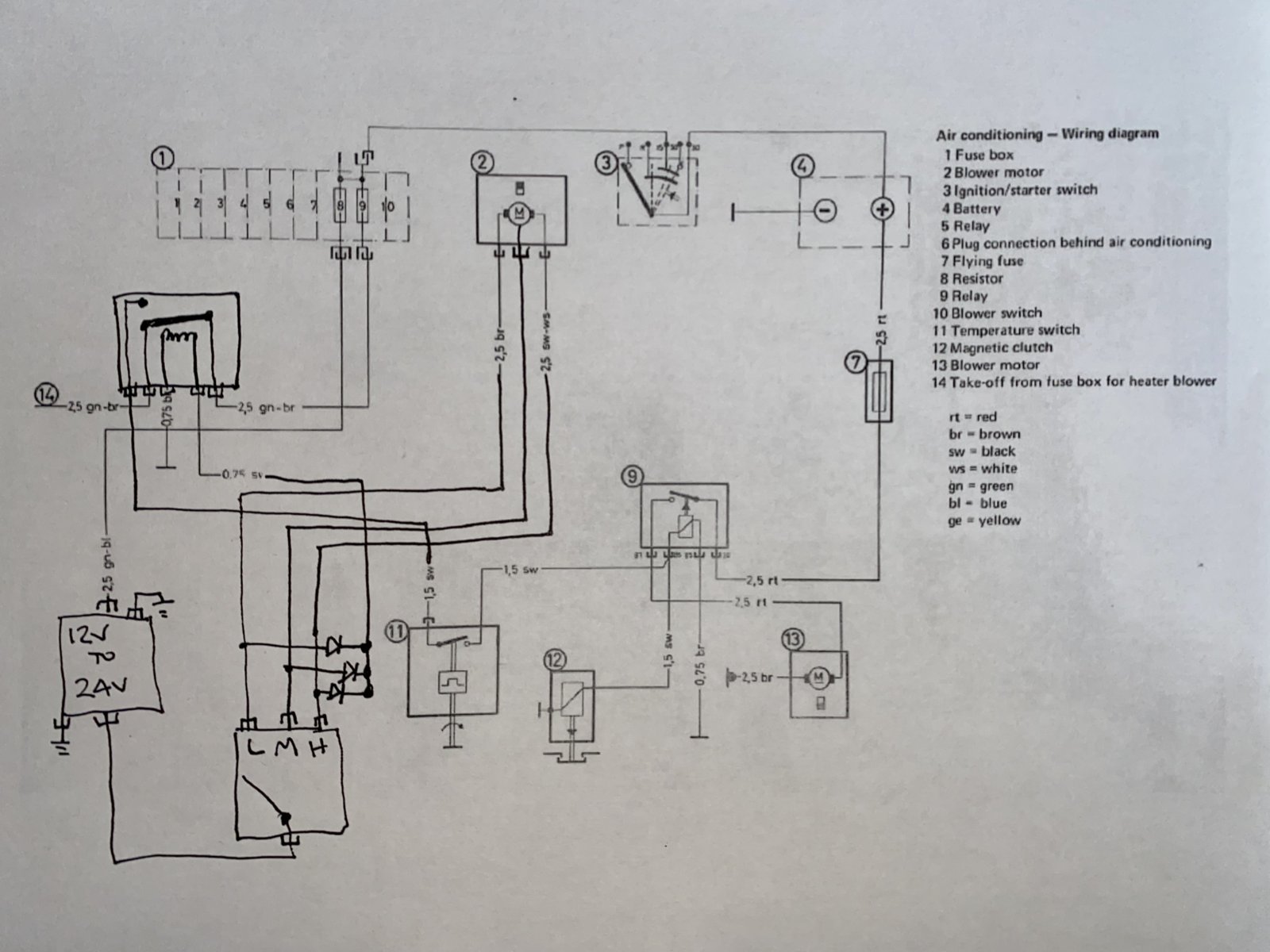

Essentially the 24V converter intercepts the 12V supply it feeds the new switch, which is wired with each of the speeds/colors coming from the fan motor. Each of the 3 ON positions on the switch also feeds a new 24V relay (with 87 and 87a [normally closed] output terminals) which then shuts down the heating system blower fan and sends 12V power to the thermostat switch and onwards to the AC compressor clutch and condenser fan relay.
Stock:
Modified:

Is more current going into the DC-DC converter than went into the original fan (implying a higher power output)? I know it’s not easy measuring DC current above 10 amps.

hey Luis, wondering if you can label your new 5-pin relay? E.g. 30, 87, 86, 87a, 85
This is what I'm thinking:
87A - Normally closed circuit to the heater blower motor
87 - NOrmally open, but Closed going to the temp switch when relay is triggered (via when 86 is powered)
86 - Normally closed, but power goes through to the relay when AC fan is switched on
85 - ground
30 - Constant power, feeding power to the heater motor normally, until AC fan is switched on. Then it turns off power to the heater motor.
no?
Good questions but not relevant. The new motor isn't the same motor used for 12V that we are now feeding 24V into it. The physical and electrical characteristics of the 24V motor are different so therefore we can't draw any conclusions regarding its performance relative to the current consumption compared to the Bosch 12V. Still, adjacent to your question is the fact that the converter has a max output of 10 Amps @24V which translates to 20 Amps @12V and for sure the Bosch motor doesn't consume 20 Amps. So the converter has the ability to supply at least the same, but very likely, more power than the Bosch motor consumed. I'll get around to measuring it sometime soon.
Luis - where is the ground for the blower motor in your circuit?
Forgot to draw the little path to ground for the blower motor as I did for the 12-24 converter. The motor has a blue wire which is ground and would simply get grounded anywhere nearby that is convenient.
85 - ground
no?
Ding, ding, ding! You got it. Attached is a pic of the relay with Bosch PN. Nuance: My high-tech drawing of the relay is not physically realistic as the coil would attract the hinged armature to itself when the coil is energized, not when it is normally open as it is shown on the diagram.
