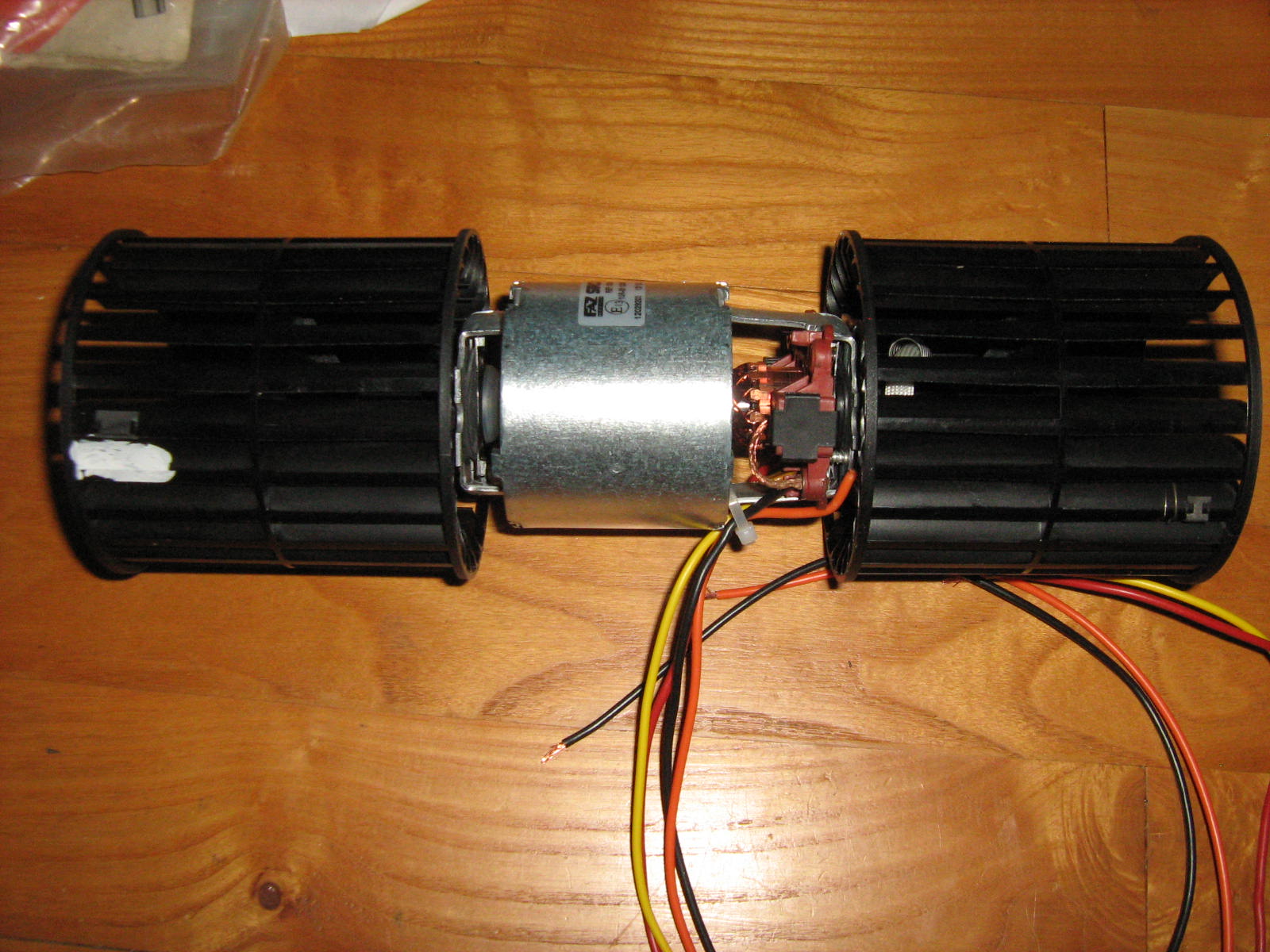

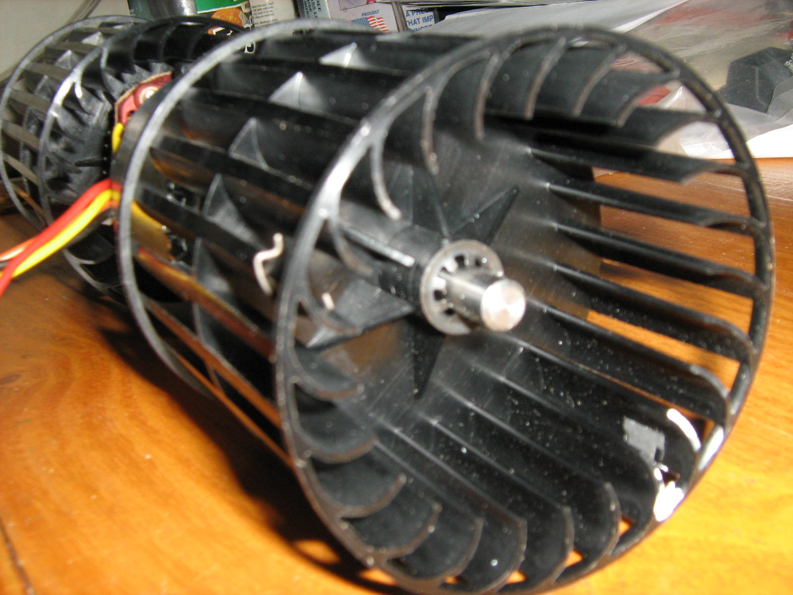

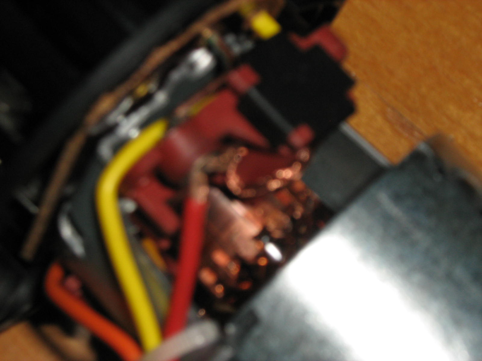

I have located the manufacturer of the "CAT" entire blower/motor assembly discussed here, except in 12V so no step-up required. As noted above, the motor is a 3-speed unit. That means you don't have to use a rheostat switch (which tends to fail) or buy an (expensive) bolt-on resistor/regulator circa $125 for that. With the 3 speed motor, you just need a 3 position switch. The company is located in France. In order to defray the freight charges and get a good price, I need to import a bunch of these. Price is $150 delivered lower 48, paypal F&F
I was able to obtain a couple of these but in 12V config with 3 speed motor .. see photos.
