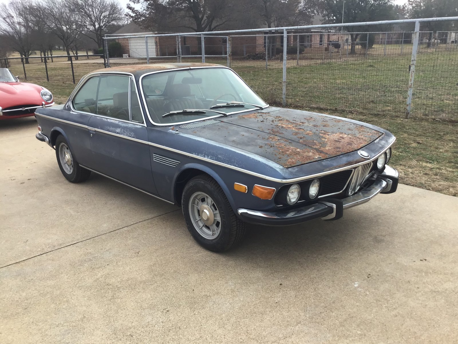

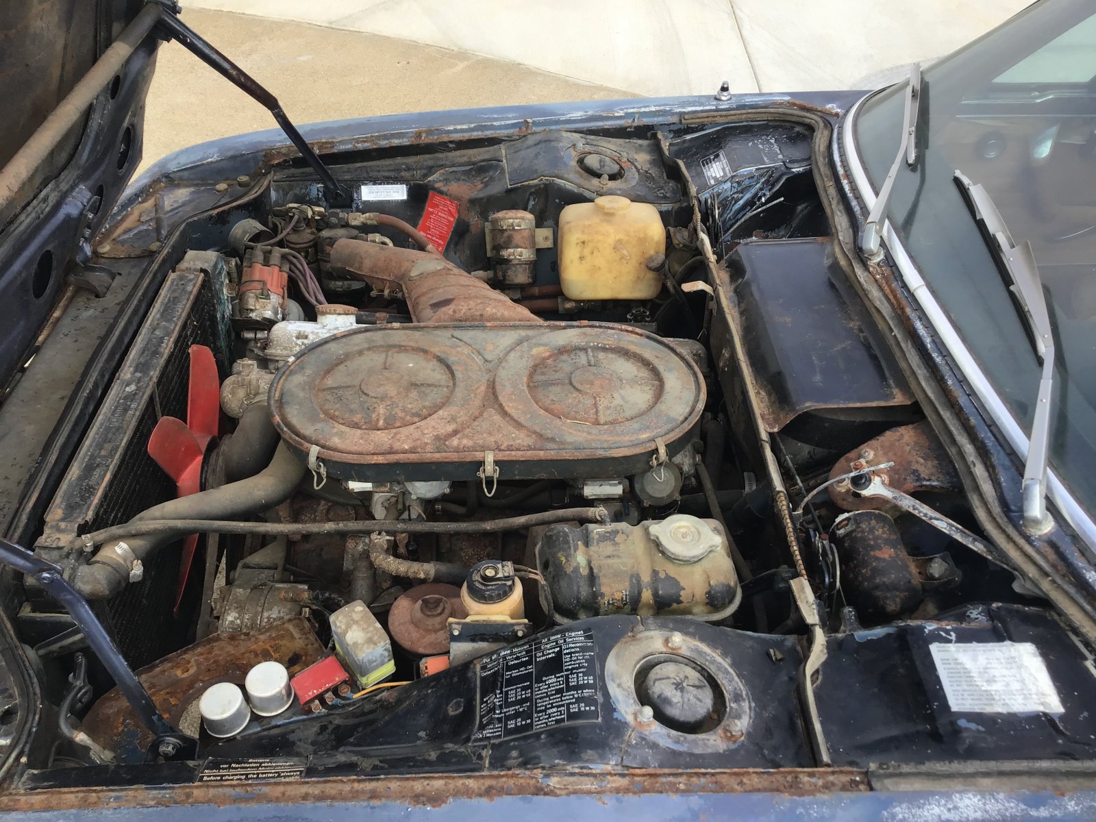

After my welcome post, I thought I’d start another post about the build so over time I have a thread going with good Q&As to reference. Anyway, here’s my car:

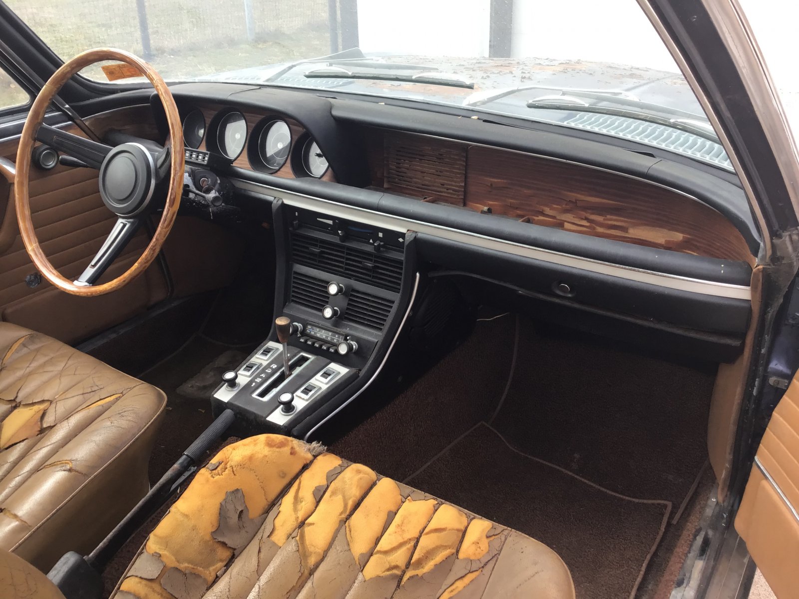

1971 2800 CSA #520 which appears to be the 6th from the last one built (#526) for US in Automatic form. It’s PS, PB, full power windows, AC, AM/FM rear defroster. Baikal Blue, tan leather interior. Parked in 1987 due to a blown head gasket, and minimal rot (luckily). Original engine and transmission and all numbers match up on the body.
What’s the plans? Don’t really know just yet. I’m going to pull the head off and see what the deal is as far as the rest of the motor. I’d love a later model swap, but then again, would love to keep this like it is and maybe just add FAST EFI or something. Time to decide since I need to research all the parts and such for these as it’s something I am just getting into. Looks to be a fun one though and I’m excited to learn more.

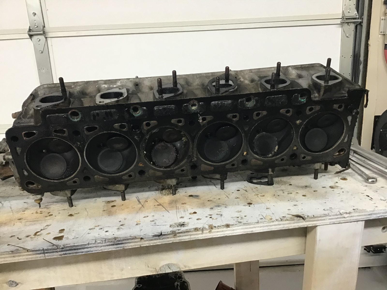

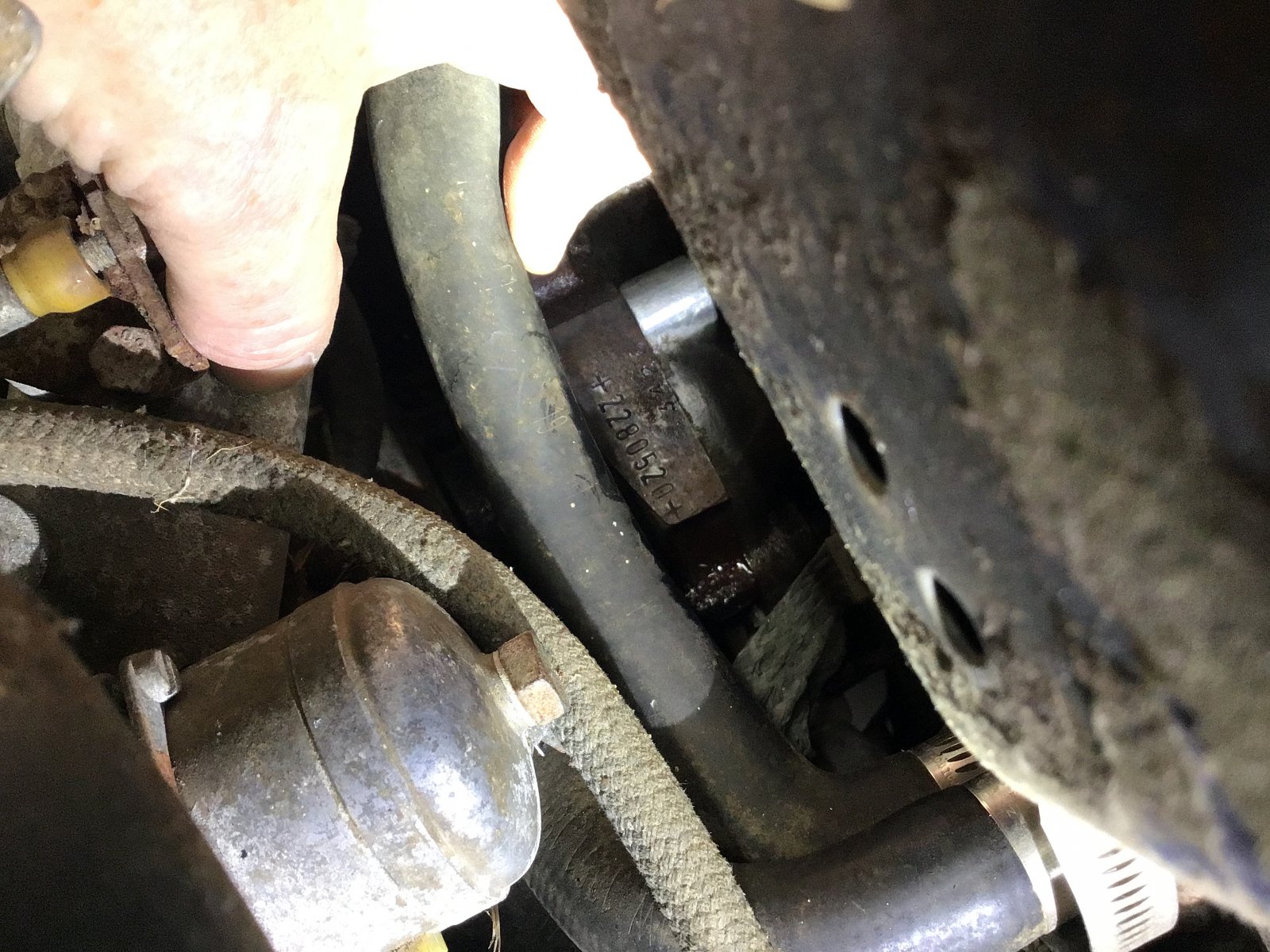

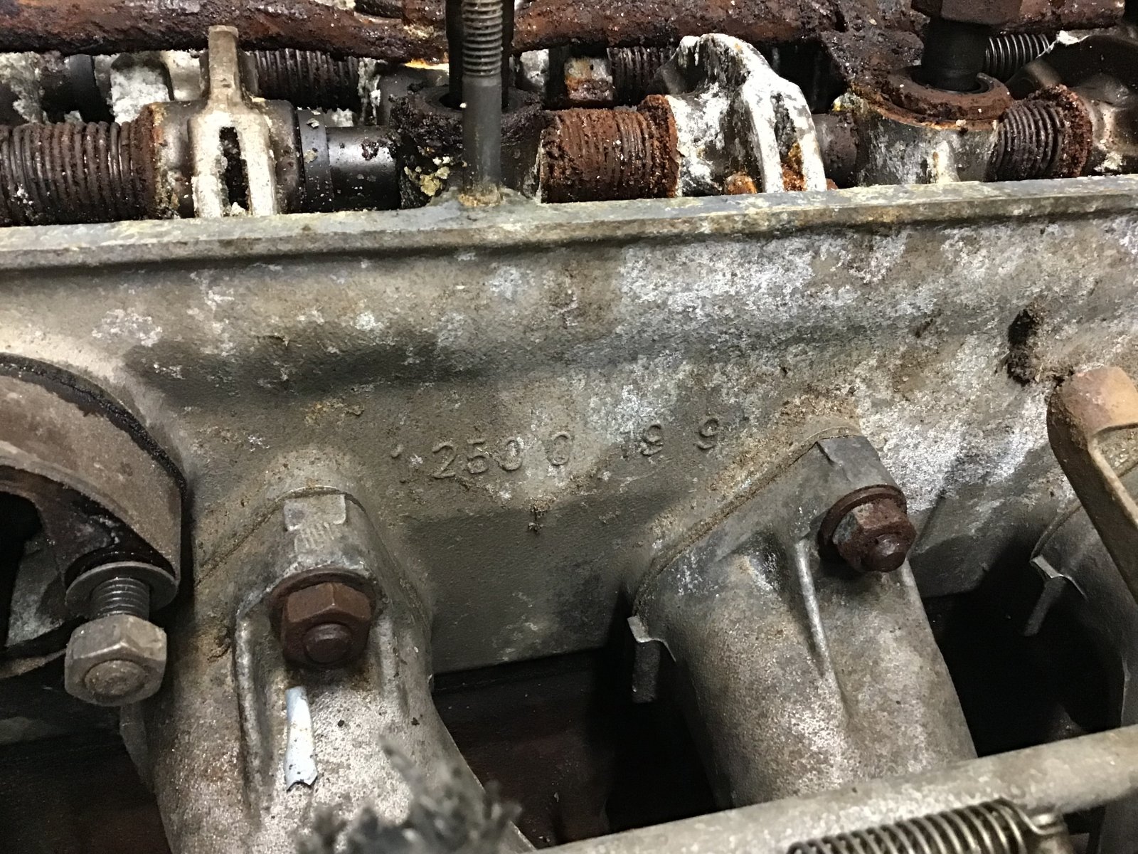

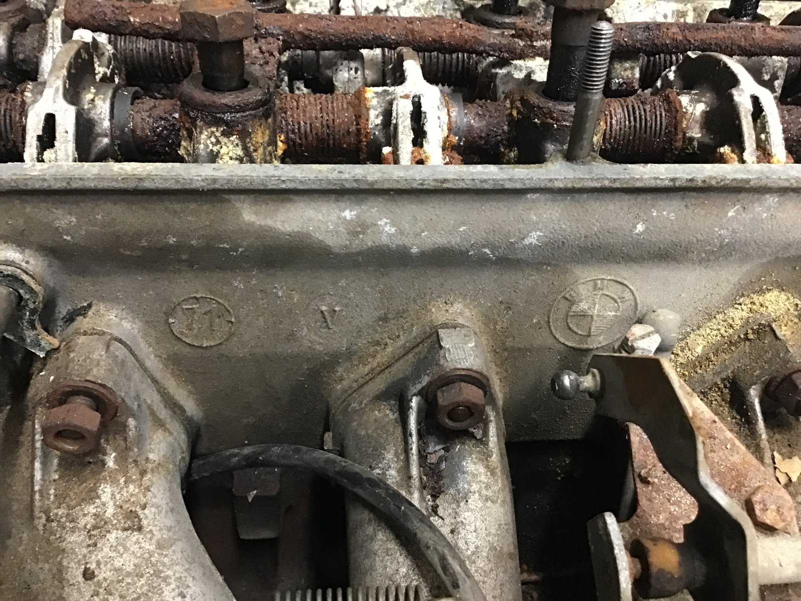

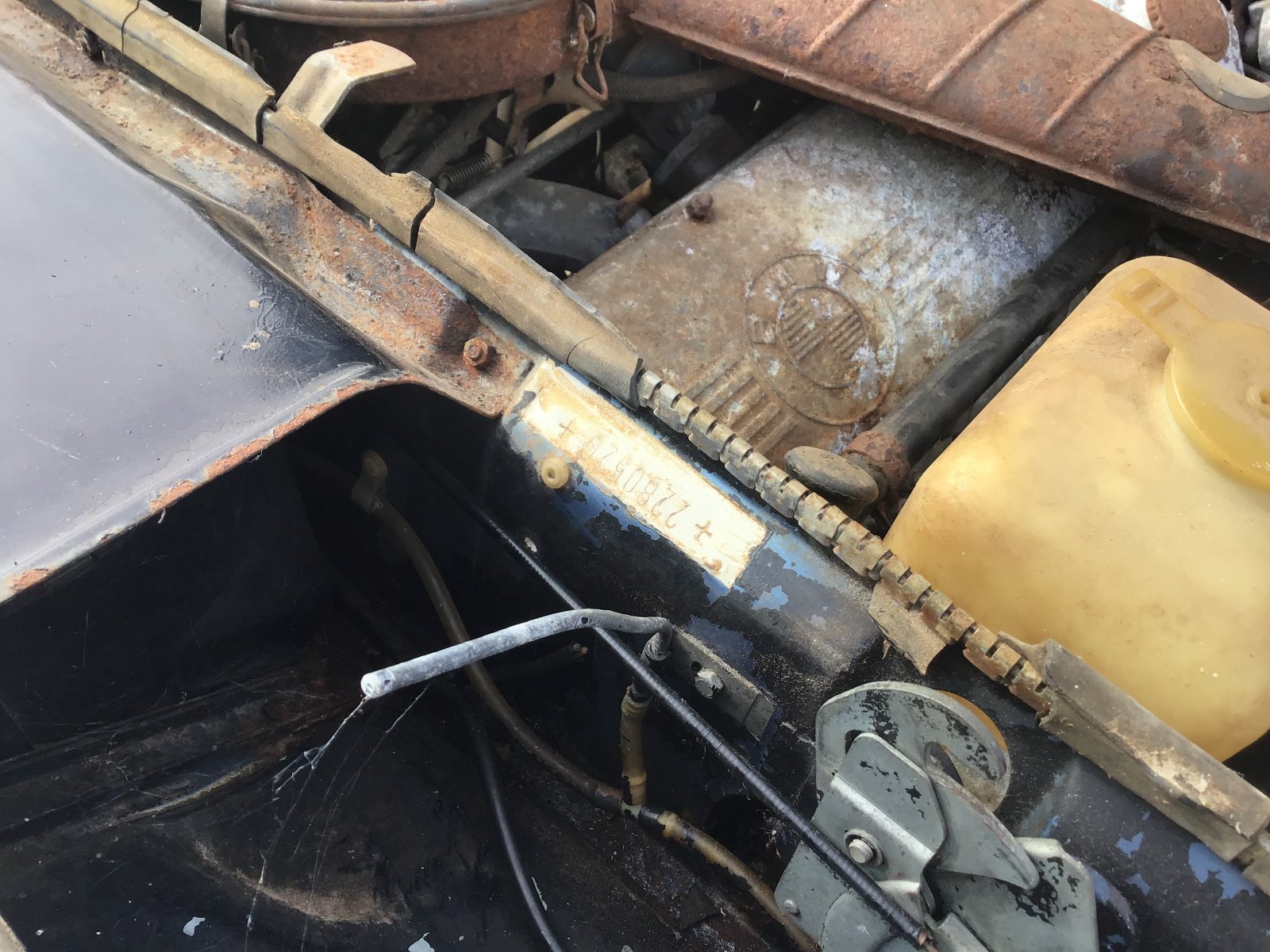

A few more showing the numbers…
Cylinder head number and date

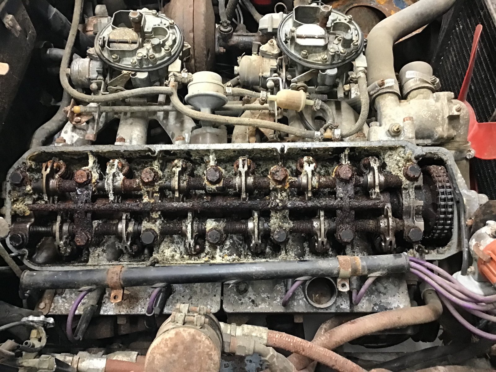

…and the internal mess!
So that begs the question if the head can even be rebuilt. Do I even want to? I’ll pull it just to see the cylinders.
cheers
dave

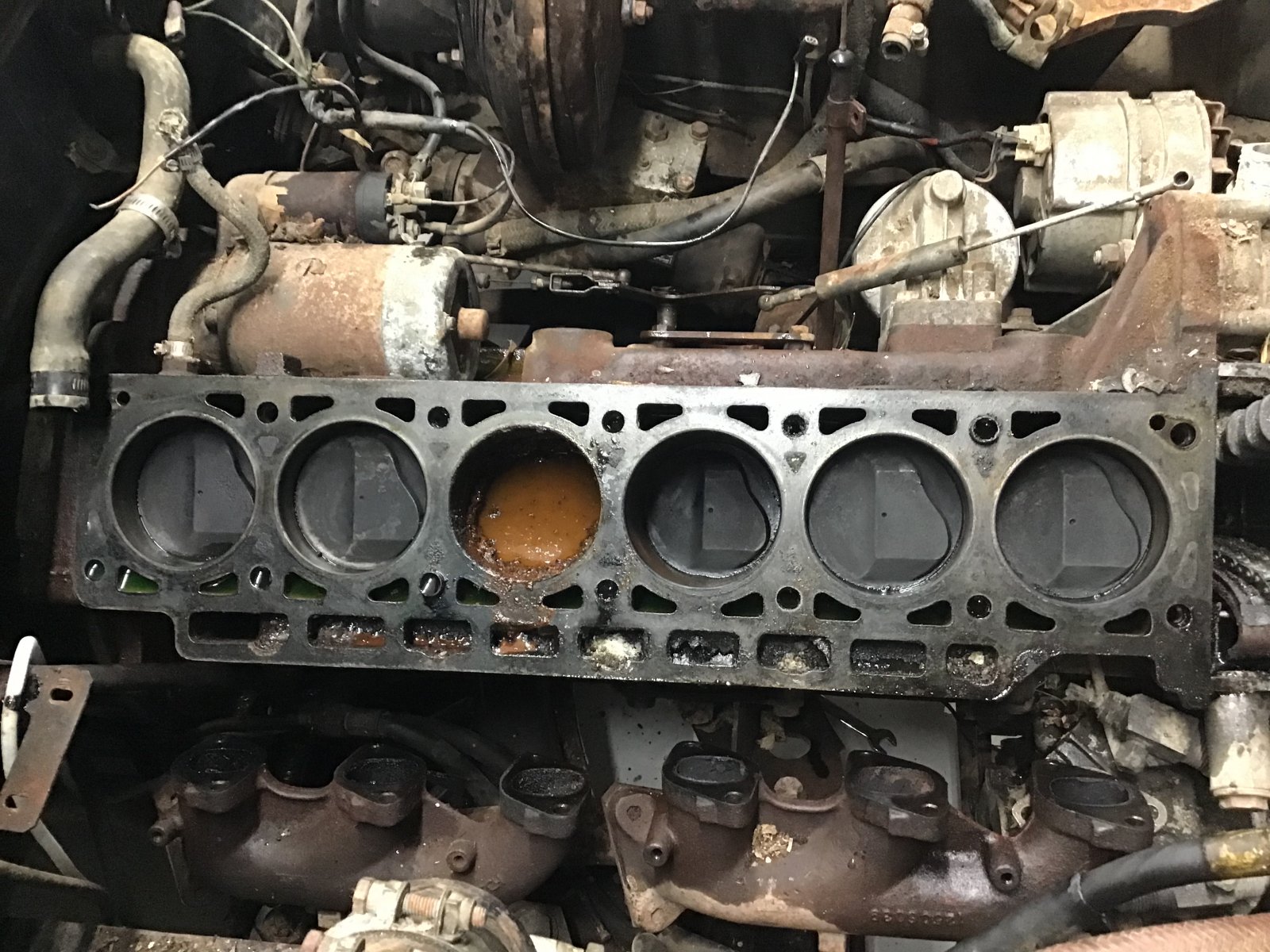

I’ve never seen a head that bad, wow! I would find a used head, even an early one, and the later heads are 1981 I think. I would make sure parts are available first like rocker shafts for one, they are NLA for the m10 motor. The 2.8 motor is smoother than the 3.0 believe it or not and with 9.0:1 vs. 8.0:1 it is a great motor. If want more power then it needs to be an m90 or b35.

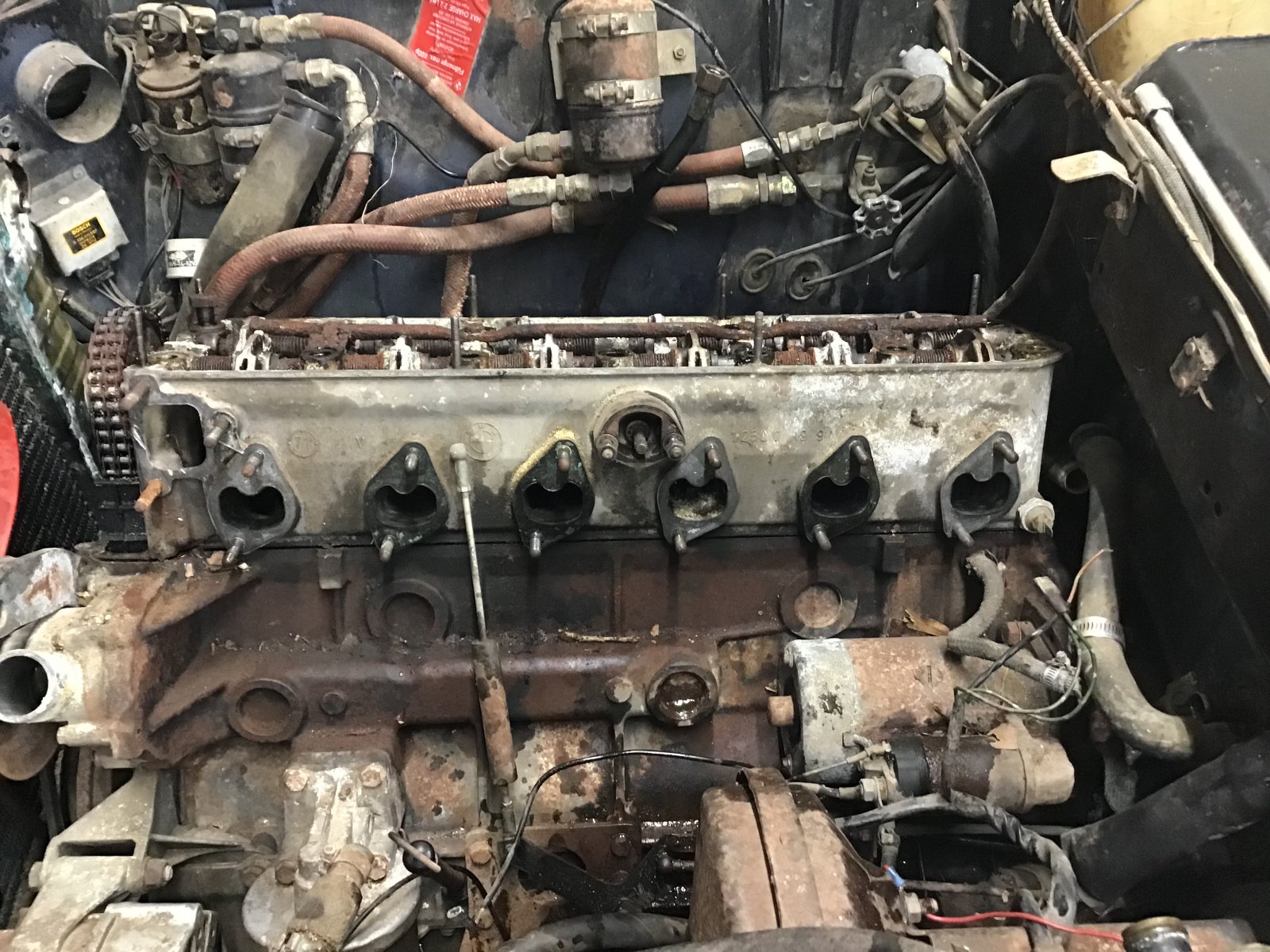

Yeah, it’s bad. Got the head off and you can clearly see the bad one!
I‘ll eventually pull the rest of everything. I know I’m planning a 5spd swap, but the motor? Not sure just yet. Been looking at donor cars to use and many threads on here about what motors to use and to stay away from.
Fun taking it apart thought!
