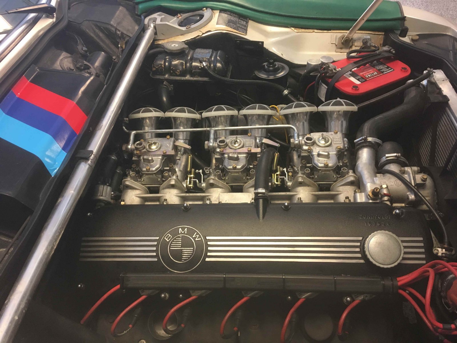

Ummmm.....I like. What's going on there? A thread link?
Dave
What's going on is that I often post in favor of carburetors when the topic of changing to fuel injection arises. I know I am giving up fuel economy and perhaps a little horsepower, and as with many analog things, periodic adjustments are required, but I like them as part of the classic car experience.
I gotcha. Thought that might have been a stealth EFI kit or something.

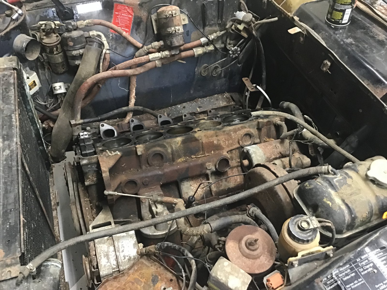

Good debate, and everyone has their own thoughts. I shouId Have the engine out next week or so.
dave

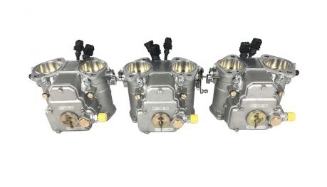

There are EFI kits that look like carbs. Of course you'd have to roll your own FI system to work with them.
Here are two different links for products that might fit the bill.

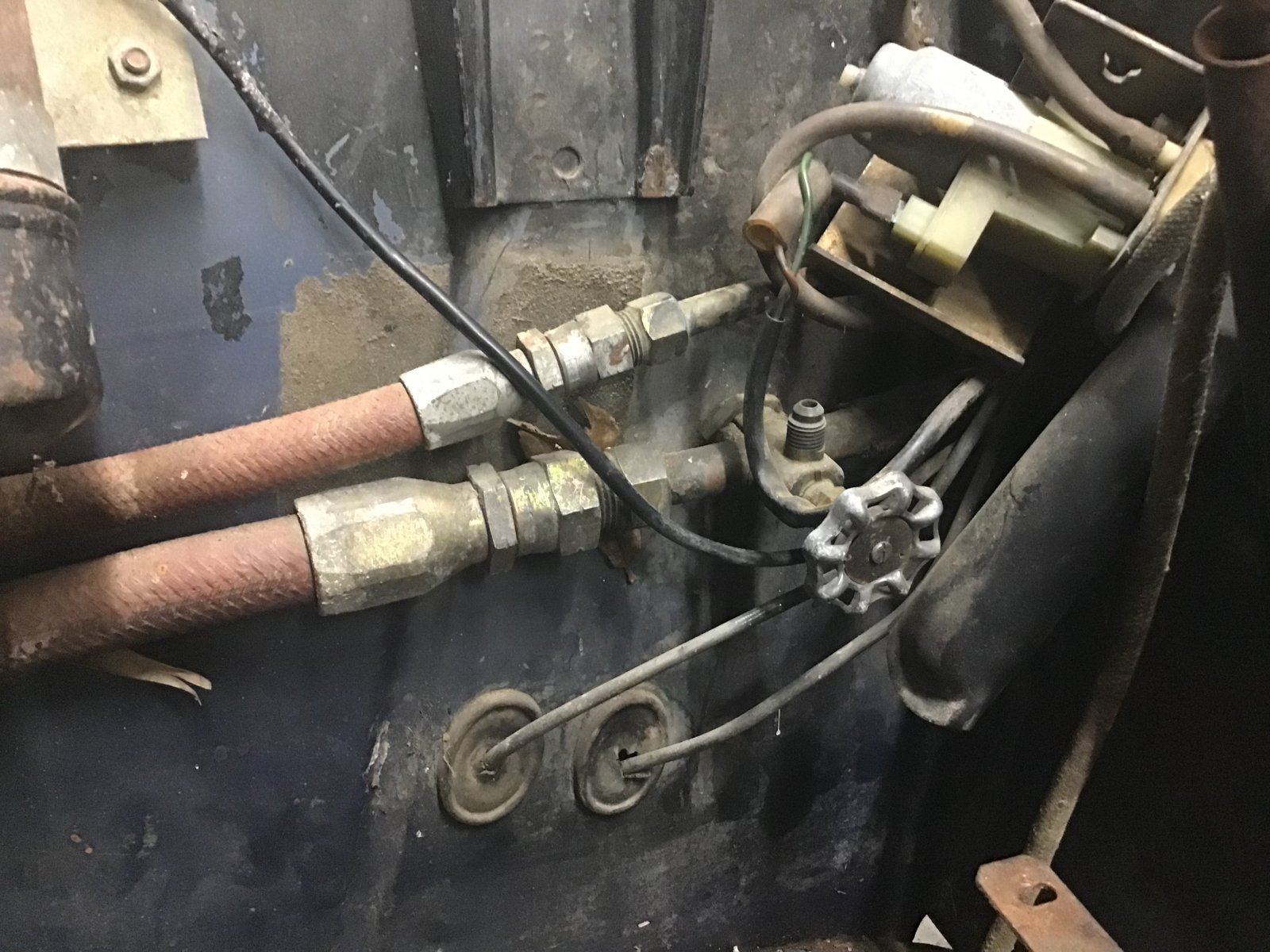

so, does anyone know why there’s a water shutoff valve on the AC line? I’m going out on a limb to say this isn’t stock.

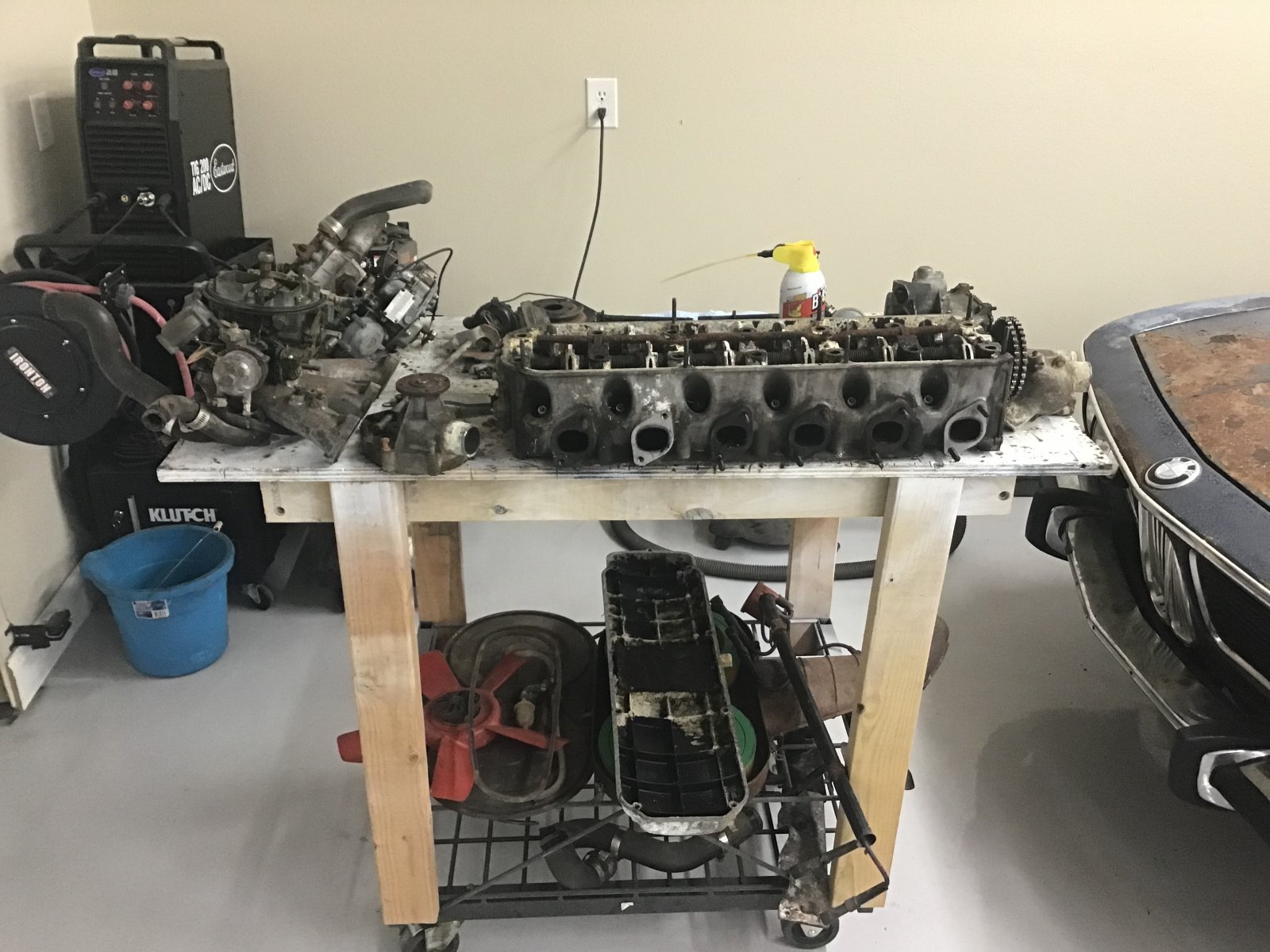

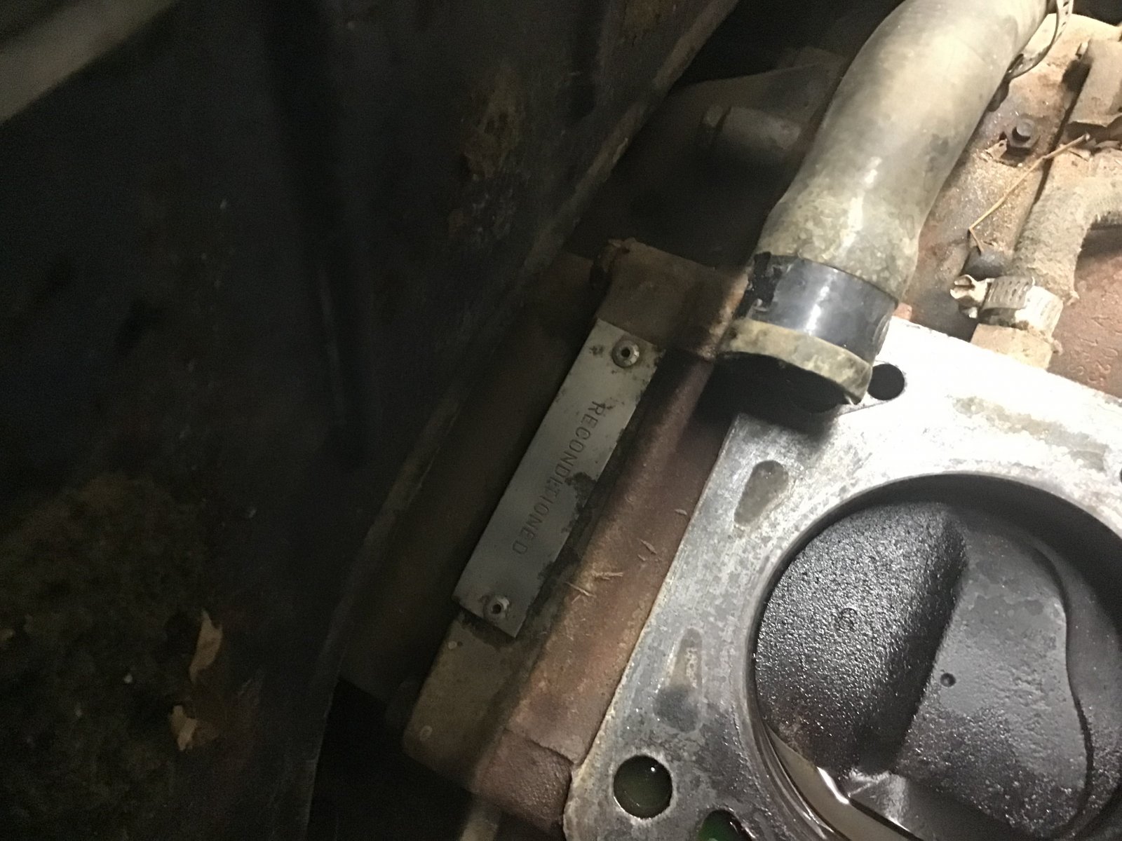

top of the motor off. I also found this tag on the transmission..
I don’t think I’ve seen that before and obviously the transmission has been “reconditioned” but whether it is the original one I have yet to tell. Did they stamp them or is it just a date thing?
Once I get the motor pulled I‘ll figure out a plan.
dave

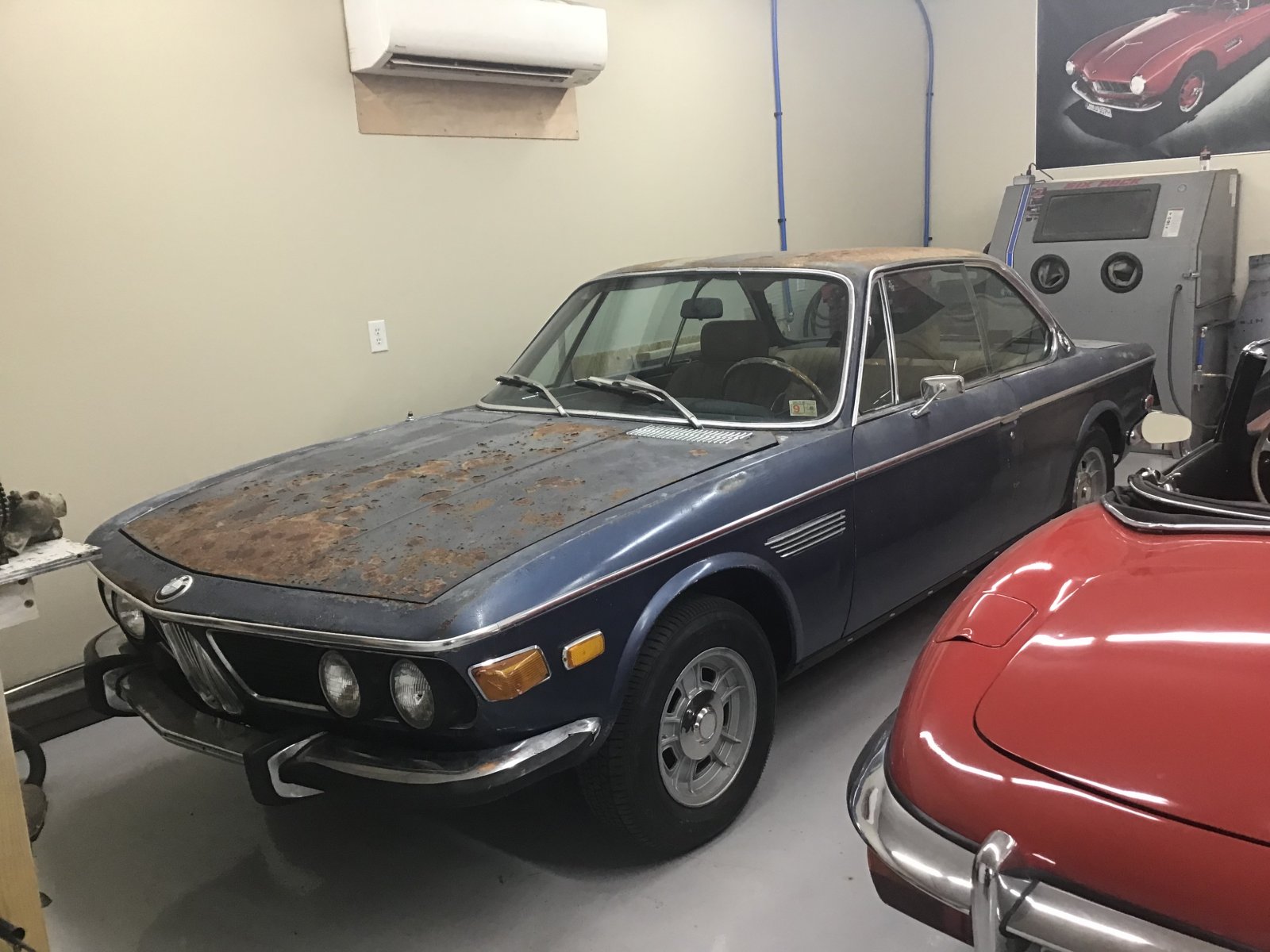

I did polish the glass and stainless, sat in the seat and made engine noises. Can’t wait to get it driving!
dave
