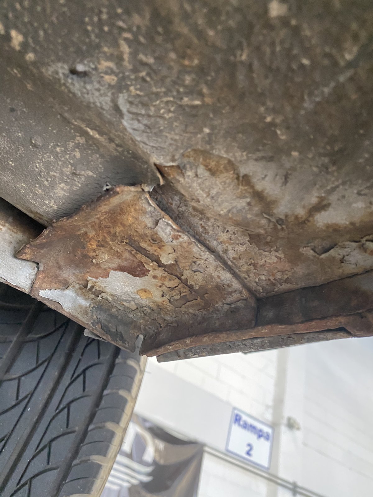

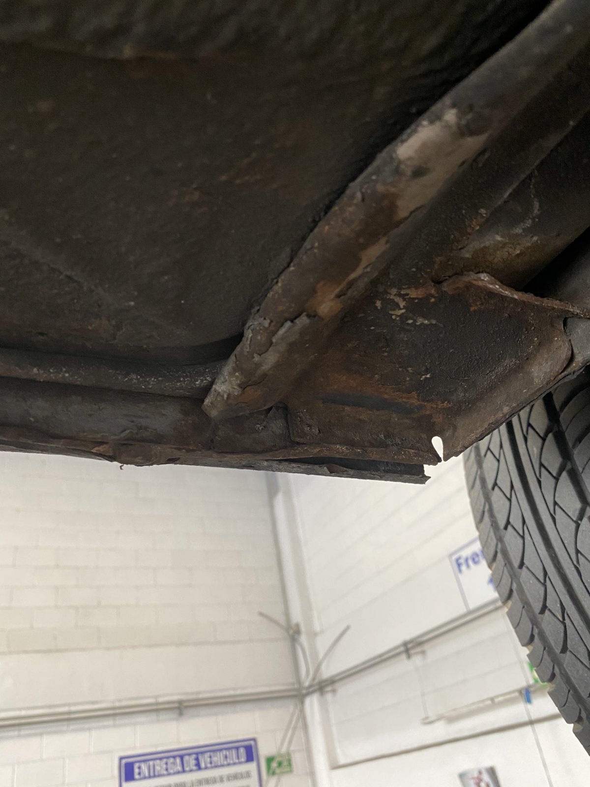

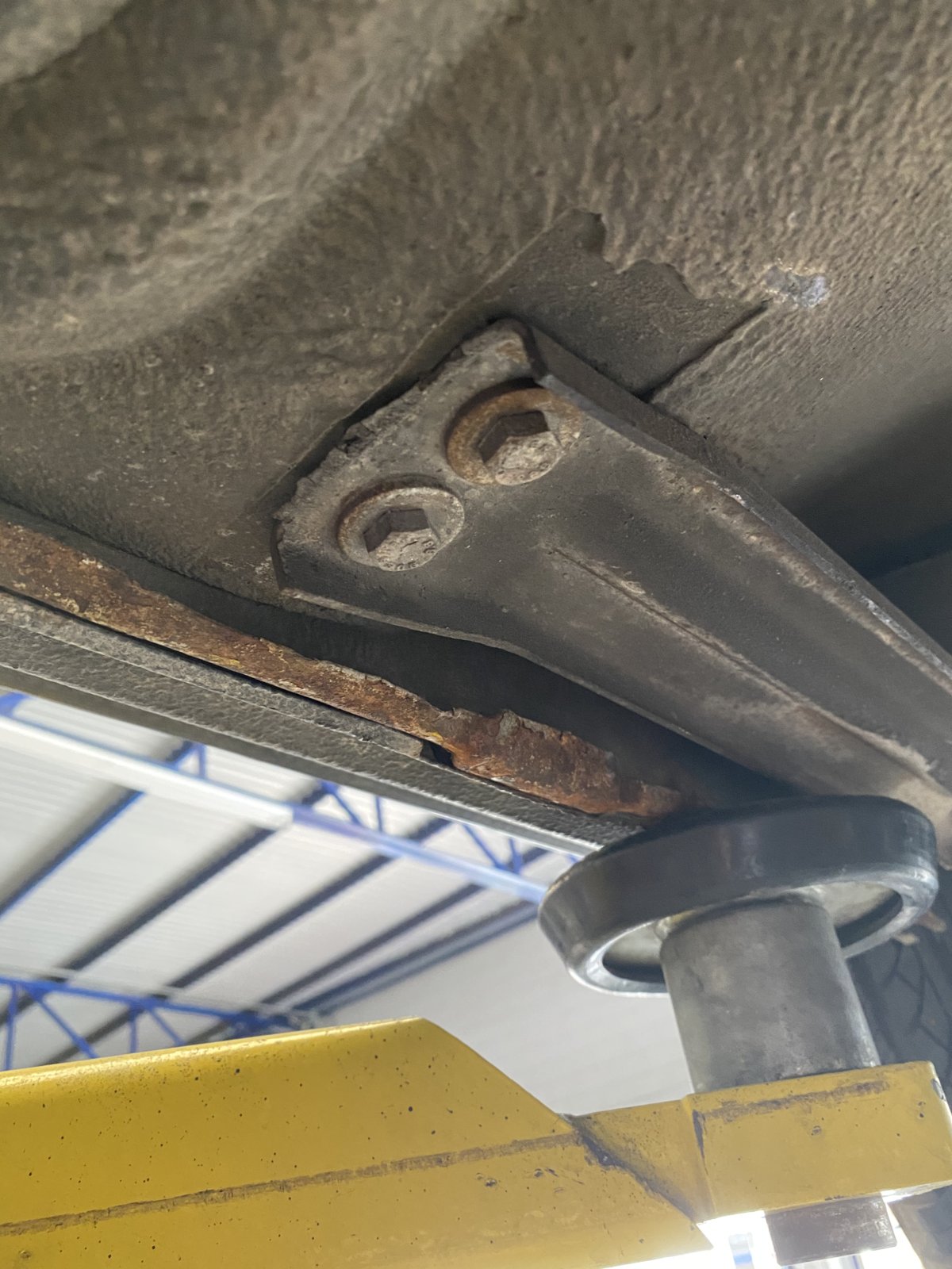

taking off the rocker moulding soon, but looks like there’s definitely some rust on the rocker panels but seems localized to around wheel wells.
