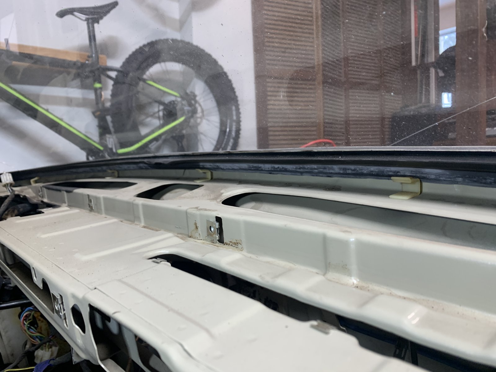

Great to watch. Thanks for documenting. You got the dash out without removing the windshield?
Yes, no problem. Was not aware it might be an issue.
Likely, stupid is as stupid does. :oops:
But looking at it now, can't see how the windshield would be involved. But assuredly, I am no expert and defer to those with superior skill and knowledge. This is my first rodeo. Nevertheless, I am not removing the windshield just yet.

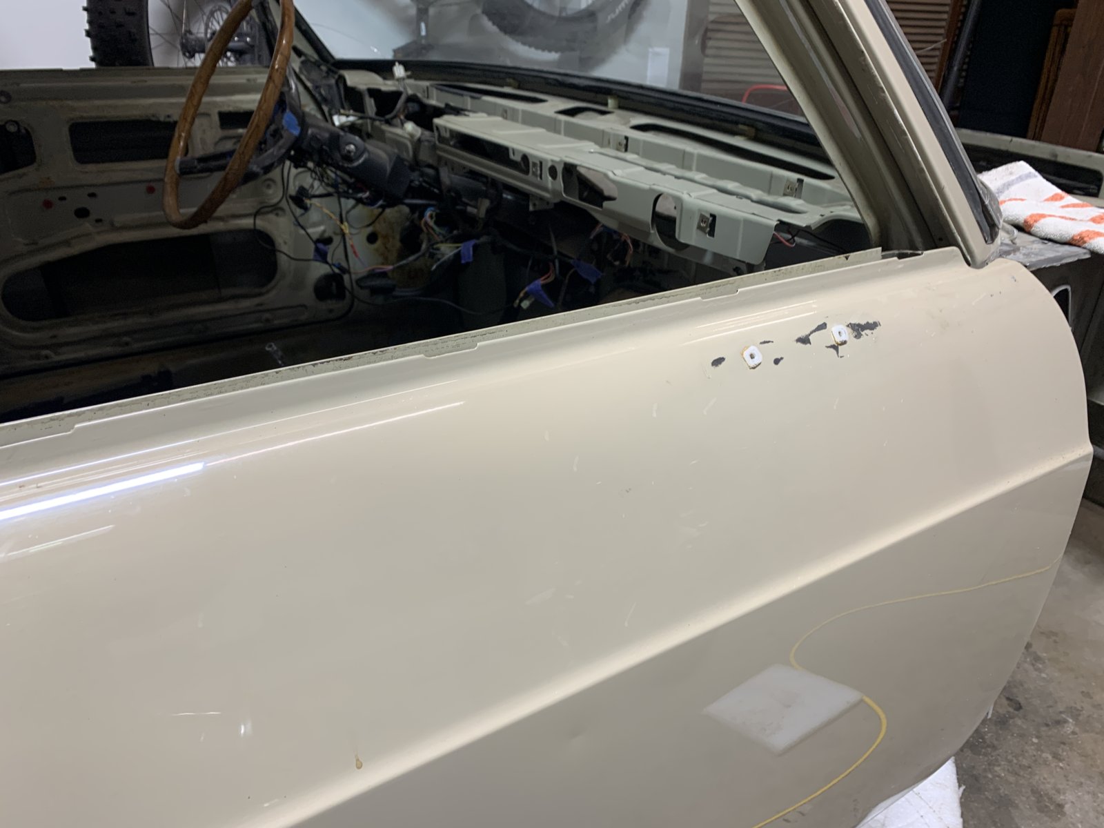

Your under dash color is original but I can't tell what it is. Looks Chamonix.

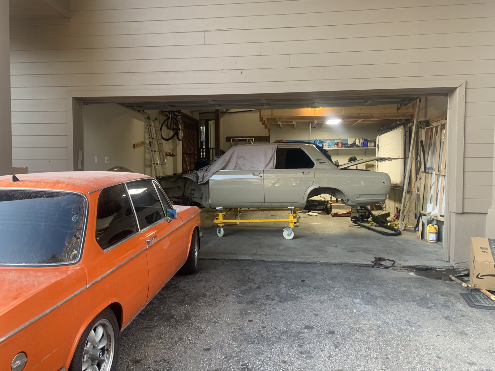

BACK ON FOUR WHEELS!

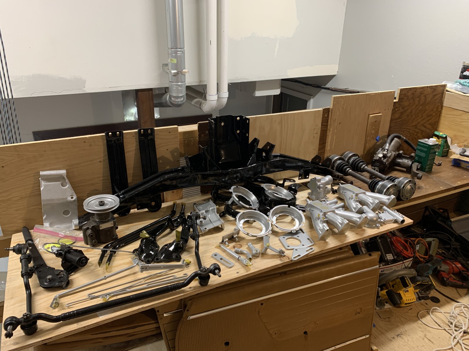

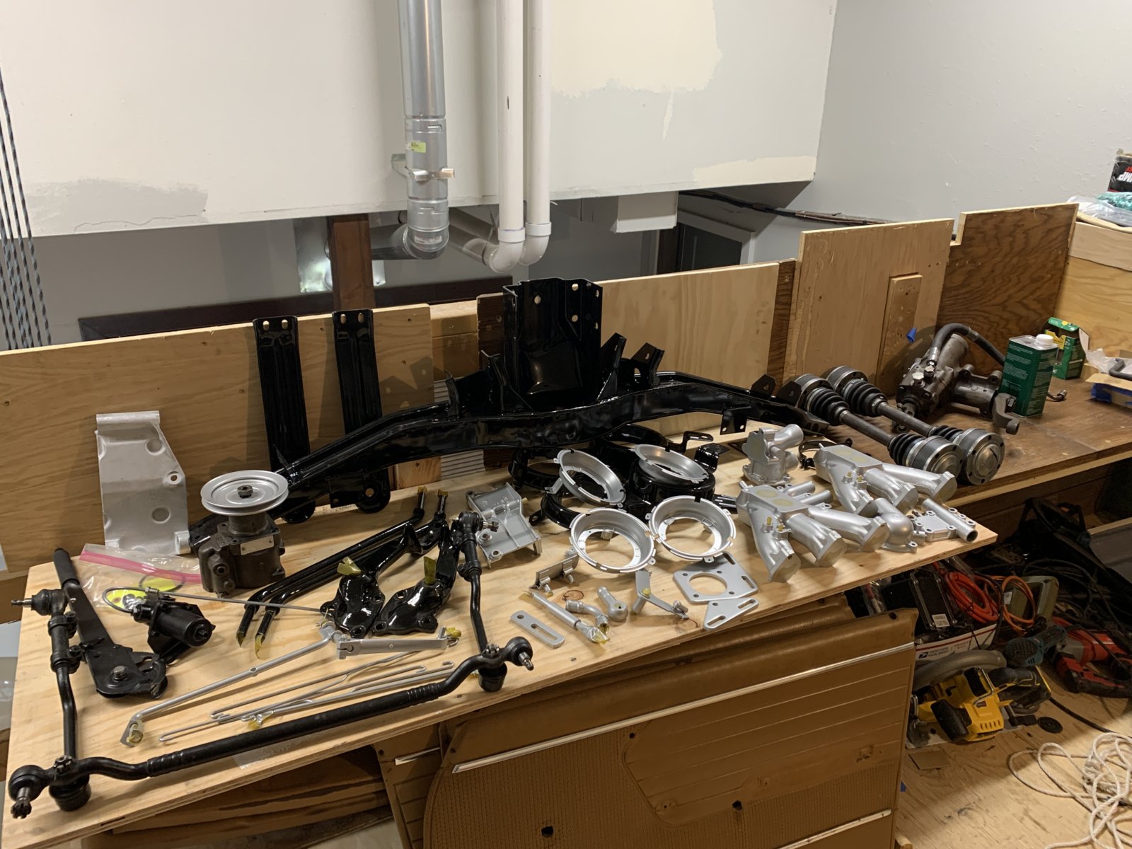

Making progress. Motor is out. Front sub-frame out and going to meet its rear end at the Powder Keg in Salt Lake.
Most of the shiny stuff is at the polisher. If not mistaken, only the bumpers are “chrome.” Everything else polished and “anodized”
stainless steel, aluminum or pot metal.
The Jegs rolling jack works great. But was a bear to get under the car and adjusted. By myself, really only one jack, and OH,
after you have removed all this stuff from under the car, and have it on jack stands, “jack points” become scarce.

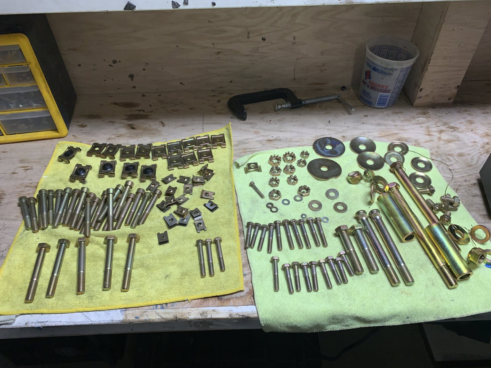

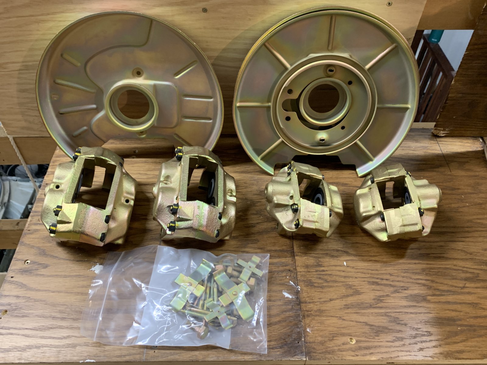

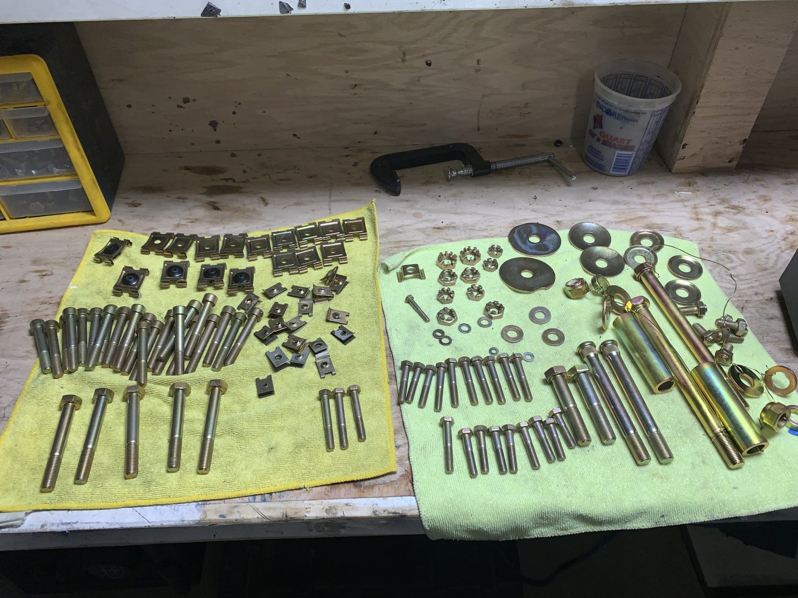

Got brakes back from PMB Performane. Cant recommend them to highly. Nice people, great work and “timely.” ( which is not easy to find nowadays)
They also zinc plate and did a half gallon bucket of bolts for ender $200. Have nothing to compare to but I thought it was a good price. PMG
will also do the struts and maybe paint. (They are the “Coupe King of Porsche 914’s) They must have 30 of them in various stages. Did not know they had that many left.
Could use some input on the front and rear struts, shocks, springs. I have a set of billstein‘s for the rear that came with the car. I think I may go with
IE’s coil over for the rear and I have been recommended billstein‘s and E9 Front springs. So I’ll be looking for a set of those. Unless I’m incorrect.

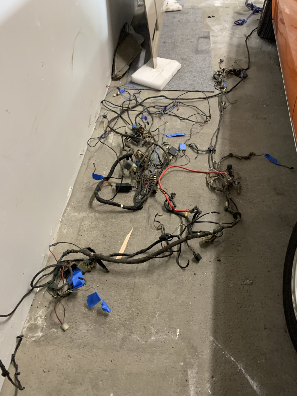

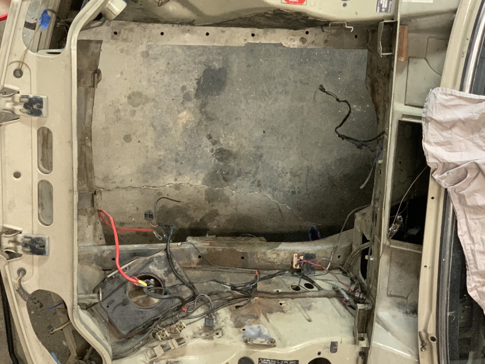

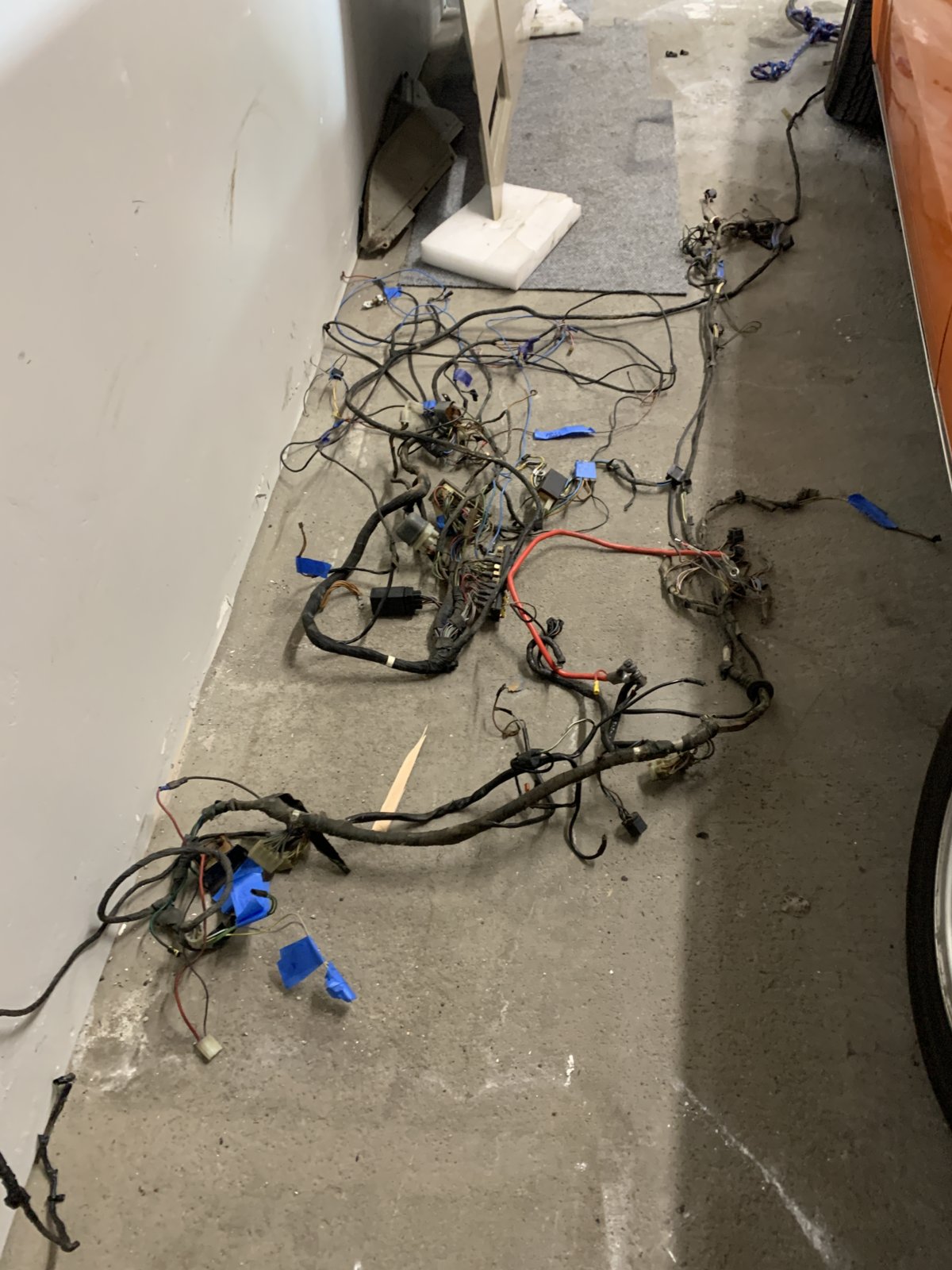

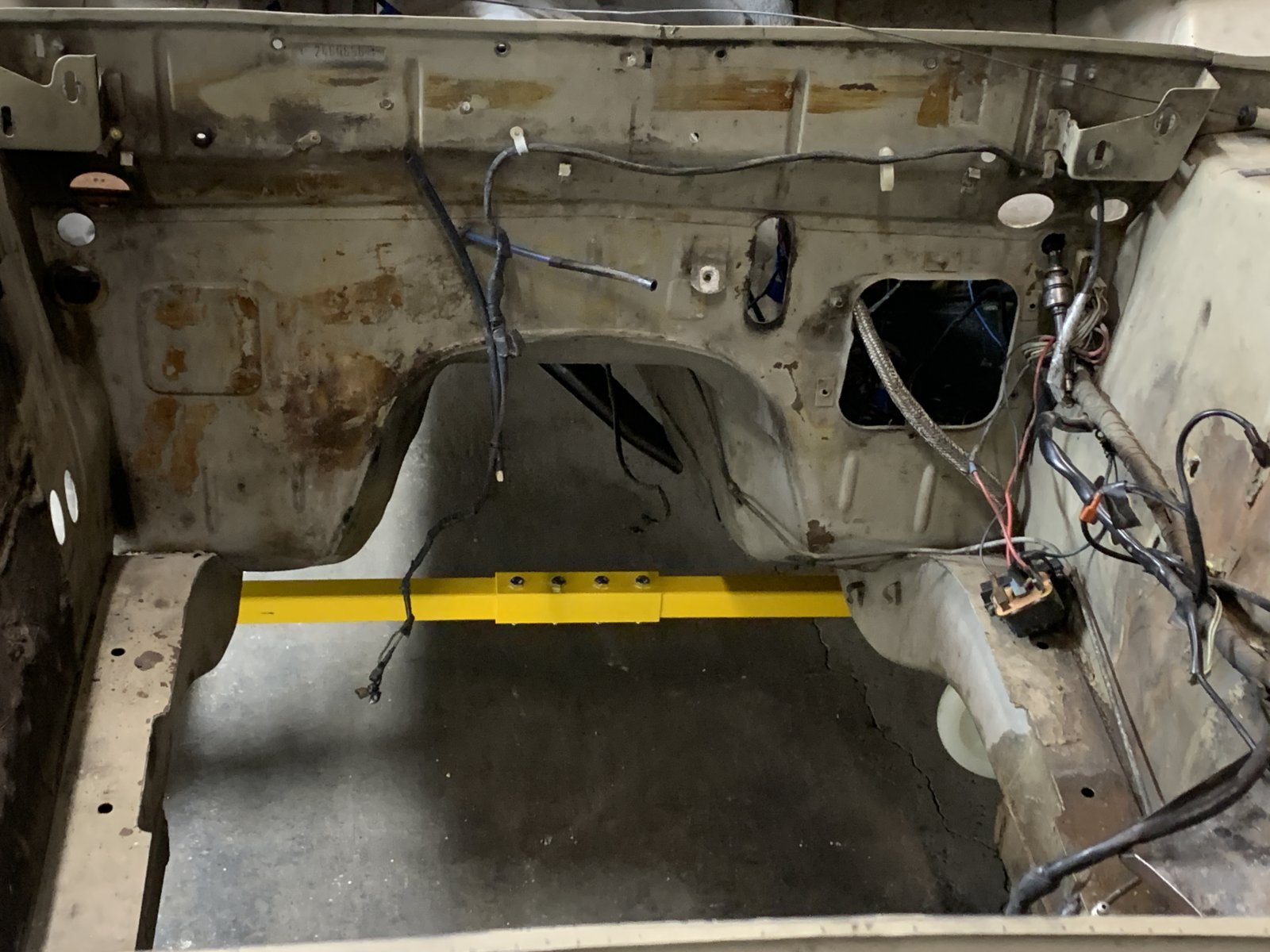

Well the 2800 is officially stripped. Pulled the wiring harnesses and some small bits. It is the first thing I have done that really scares me.What a mess!!
Seems like some "J boxes" could have been utilized but perhaps this is not done in cars.
Also collecting parts and cataloging.
Not sure what to do next. Get it Blasted and do the underside?

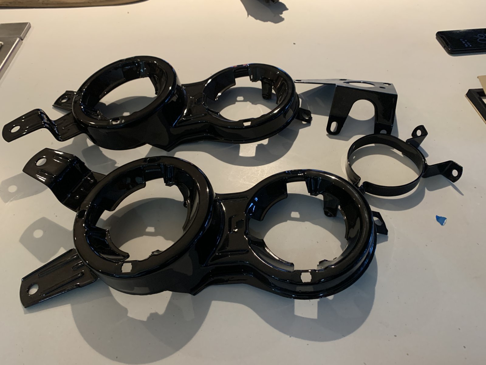

If you need any help with lighting, I'd be glad to offer my support, suggestions, and work.
I am busy doing restorations on the internals of rear lights of this era BMW, and have new headlights you would be happy with. Looks like it had sealed beams when you got hold of it, I have a set of four new Halogens that will serve you well. They are returns, available at a good-guy discount; with all this on your plate, you deserve one!

You are correct,came with four sealed beams. send me a pic and price for the Halogens. Any wiring upgrade necessary?

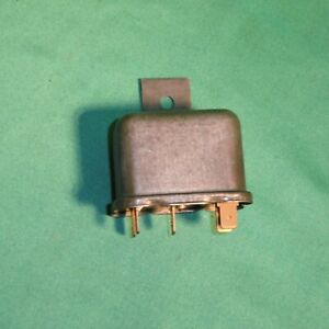

Doing fairly well on the wiring harness.HOWEVER, can not identify this Bosch relay? Best I can tell, # 0 332 003 014. Tentatively identified as “fuel pump relay.”
Not on wiring diagram for BMW e3 71/73. It did have a fuel pump, but unrelated to this . It was found connected to top of steering column in engine compartment.
Big red and green wires and a black.
Found this one on eBay. Car came with zeniths but had webers when I got it. Very basic car, no electric peripherals.
Wondering if it is functional, what it does and why it is there.?
Per usual, any and all assistance is appreciated.
