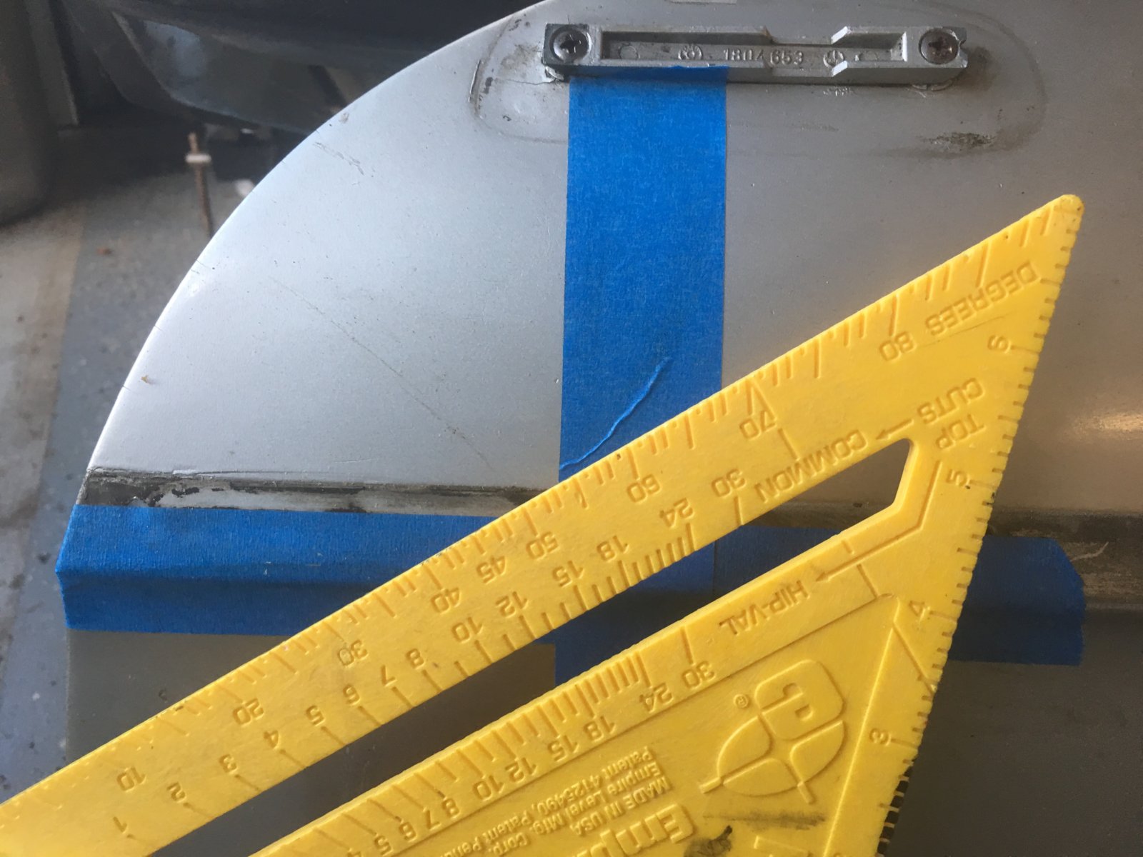

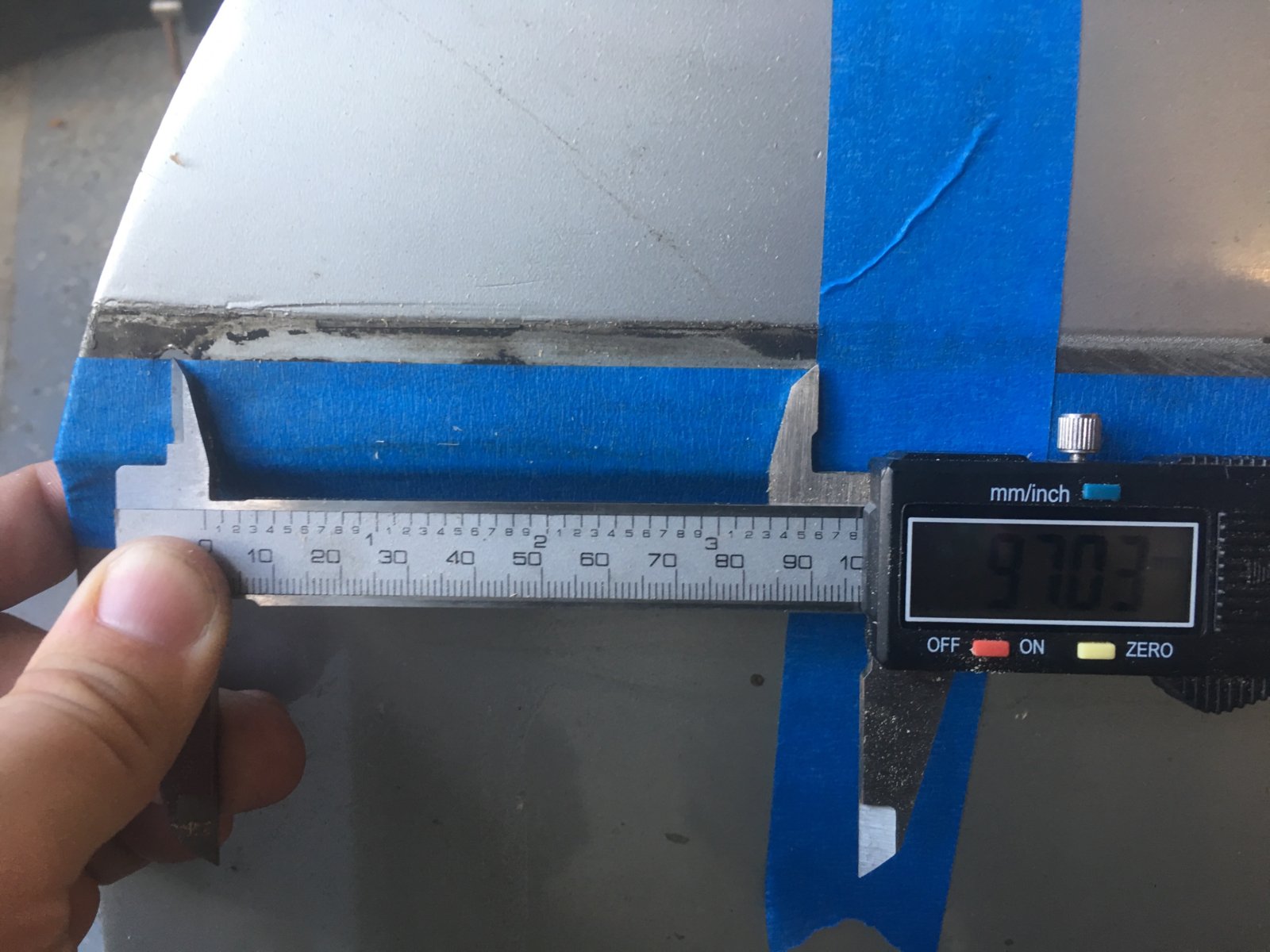

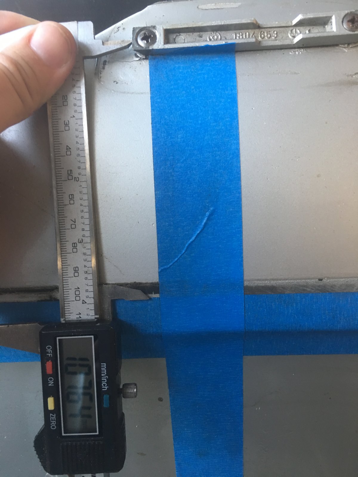

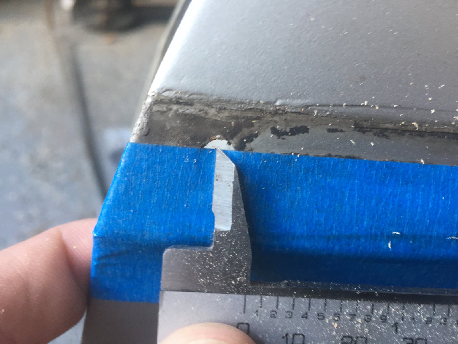

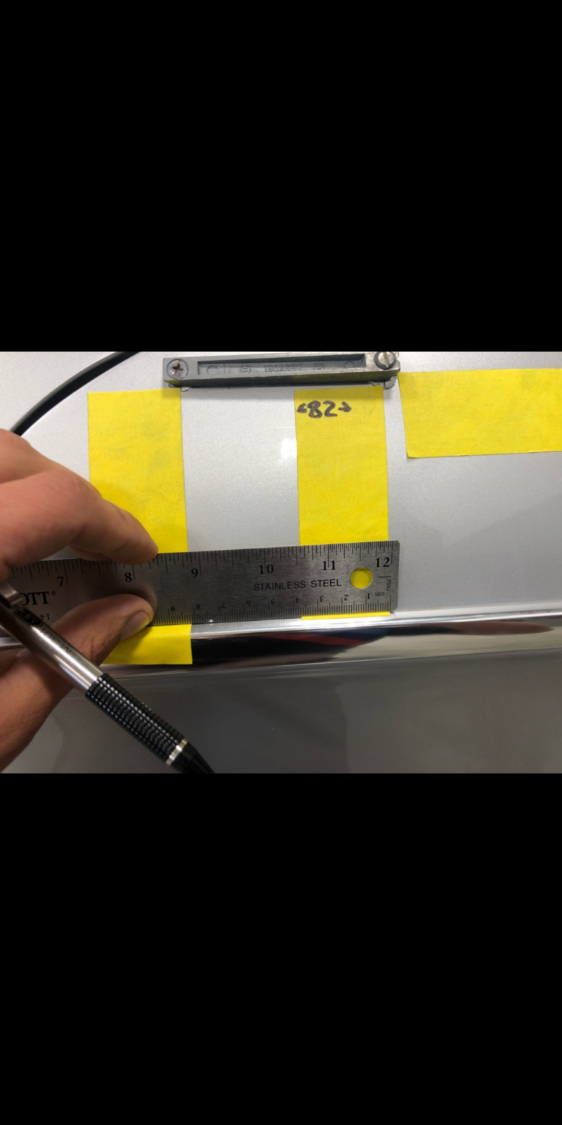

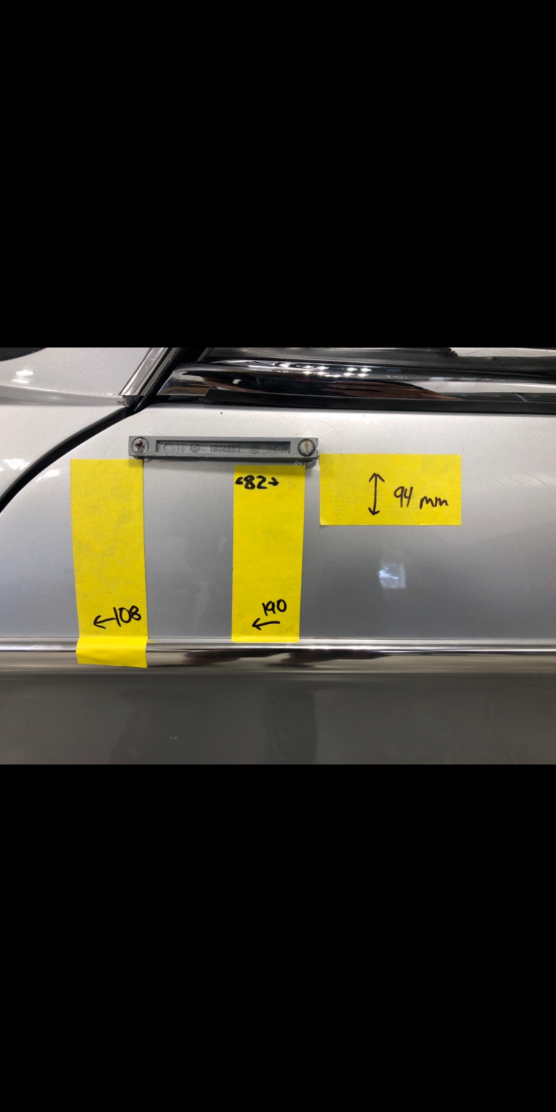

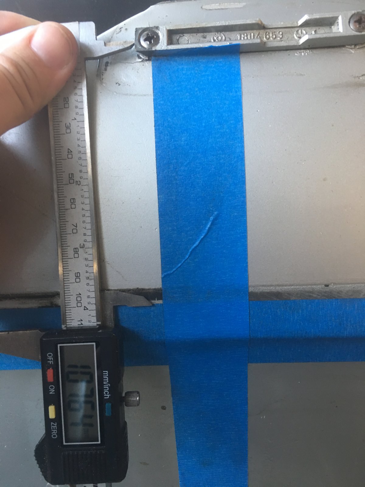

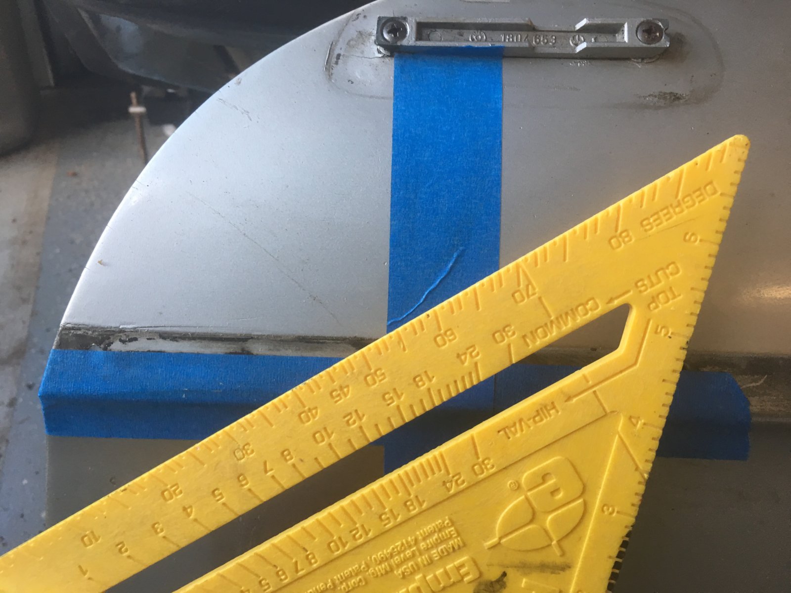

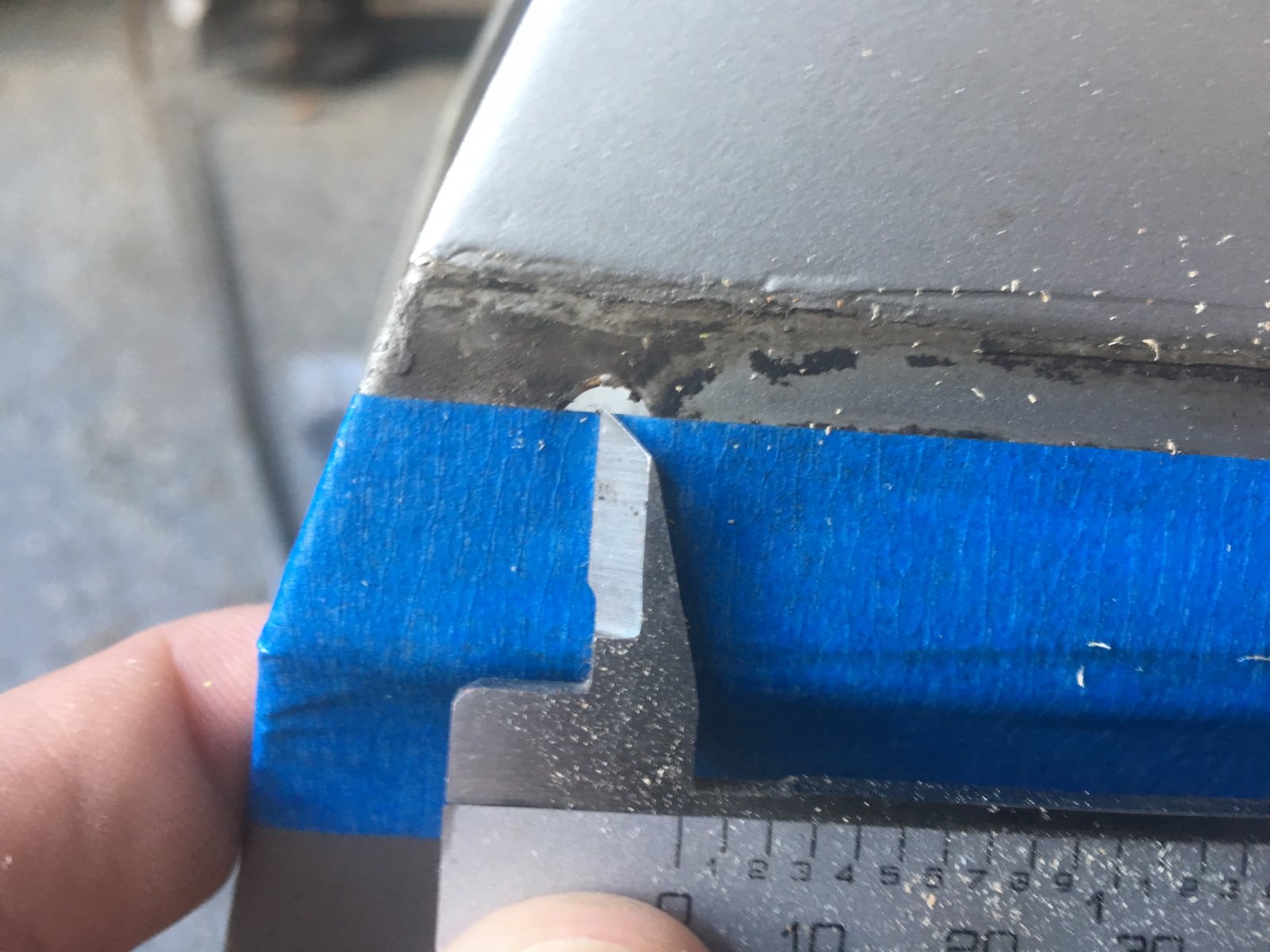

This is a CSI, so likely factory placement.
Note that I didn’t center the tape perfectly over the holes, but the tape line is pretty level. The vertical tape is square to the horizontal. I gave the caliper a little bit extra on the vertical measurement to account for the horizontal tape placement.
Disclaimer: get a second opinion.

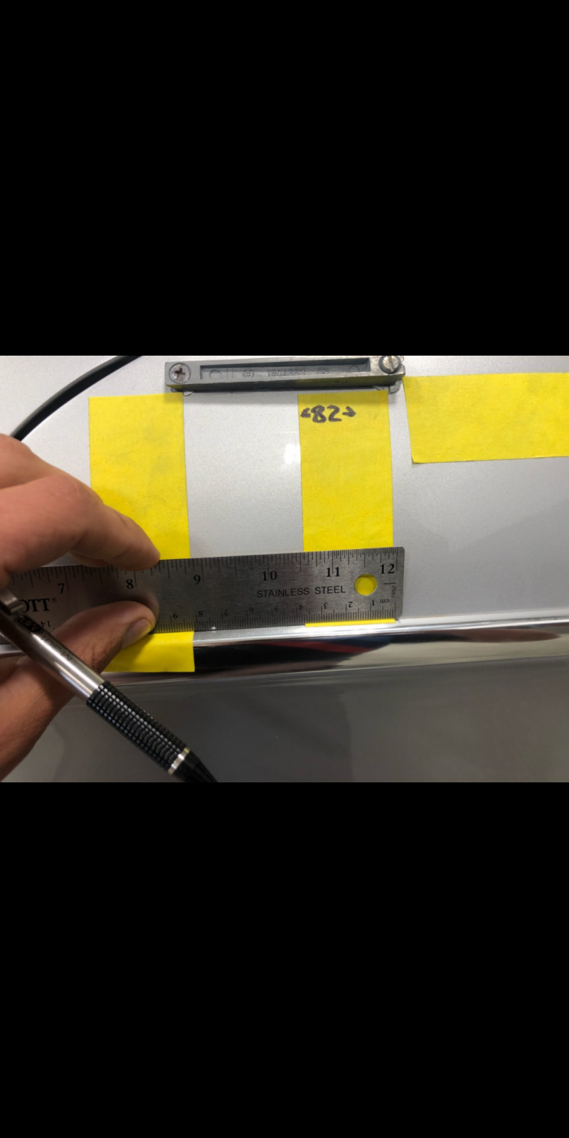

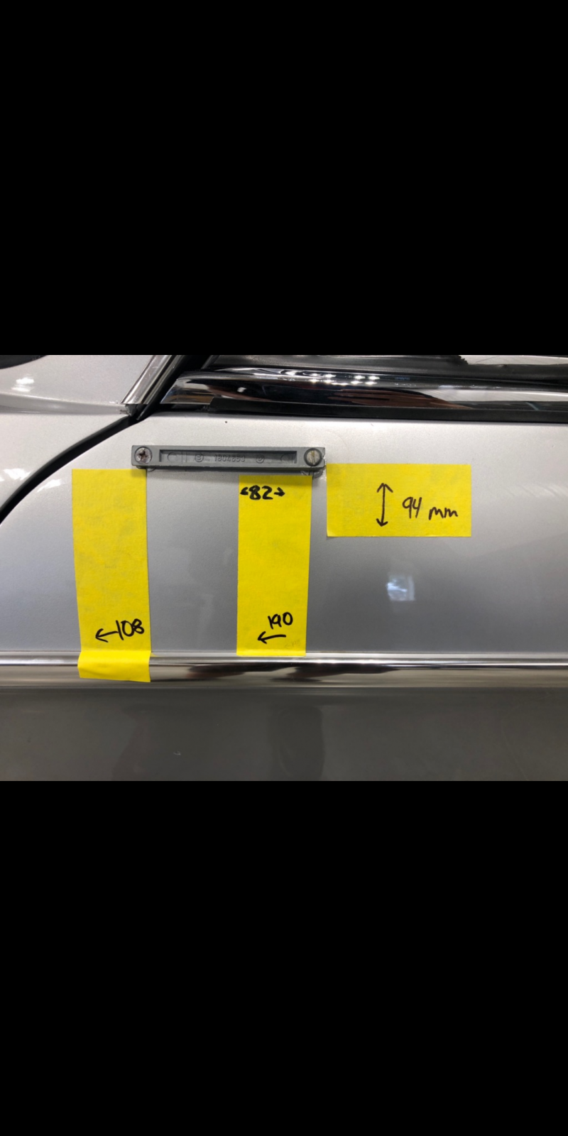

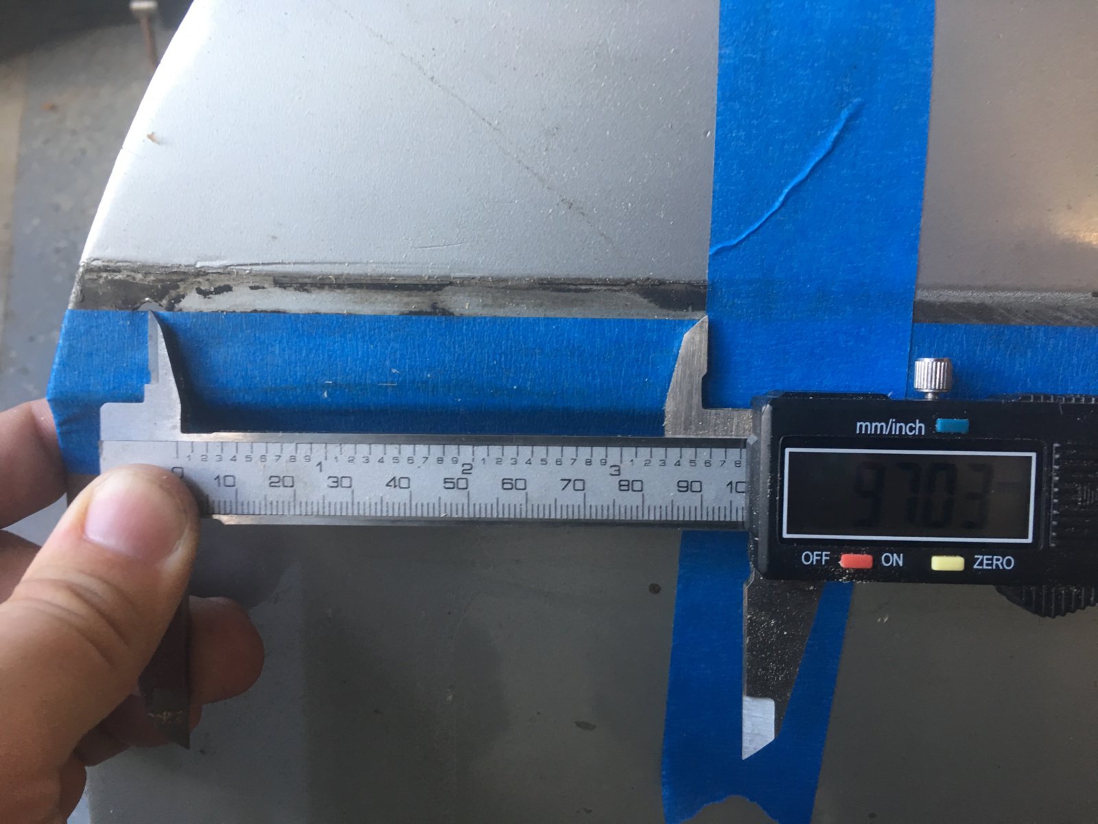

Second Opinion:
I got measurements for euro positioning from a local euro 3.0cs owner so I might use that as I hear that it is more useful than North American placement. For those following along here are the measurements I have.
Great Info on this thread; I have a 1973 (as it turns out) 3.0CSa (2232124). By mirrors are perfectly located to completely prevent the 1/4 window from opening. We are about to strip it and full repaint and thought now would a good time to reposition them. I assume these dims are good for mine.
