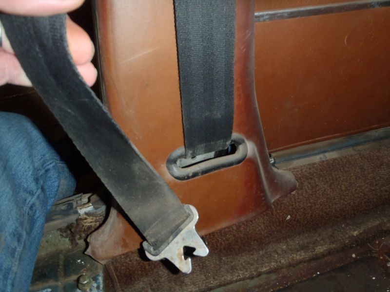

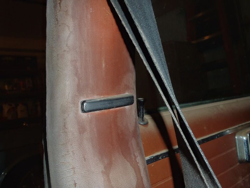

Jeff,

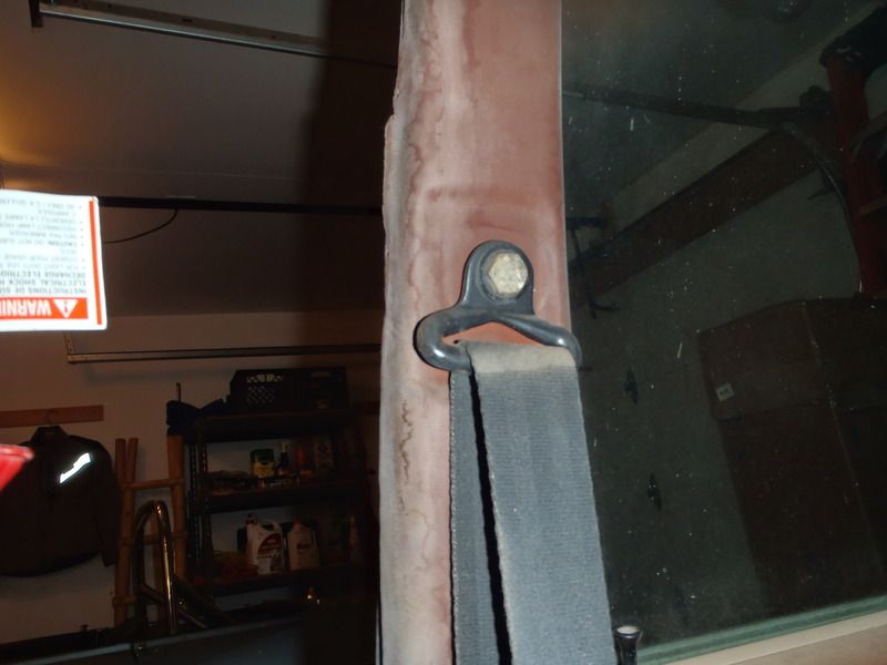

I would love a pic or two of the B pillar with cover removed to see how the retractable belt mounts if possible. And if you're going to flare fenders I could use the chrome trim on left front arch but only if in VG condition. I would give the whole seat to the upholstery guy and let him decide what to do. You've got quite a project there!
Bwana
1,203
84
Santa Fe, NM

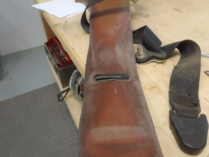

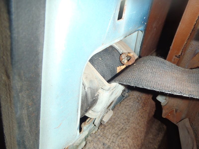

Shots of the shoulder strap mounting including the made-next-to-the-hen's-tooth-factory B-pillar clip. Oddly, it's only on the passenger side, not on the driver's sde. I wouder why?

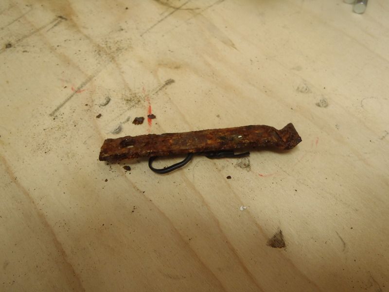

Any idea what this used to be? Looks like some kind of mounting bracket that is indespencible but unobtainable.

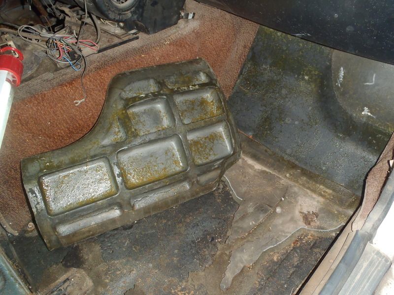

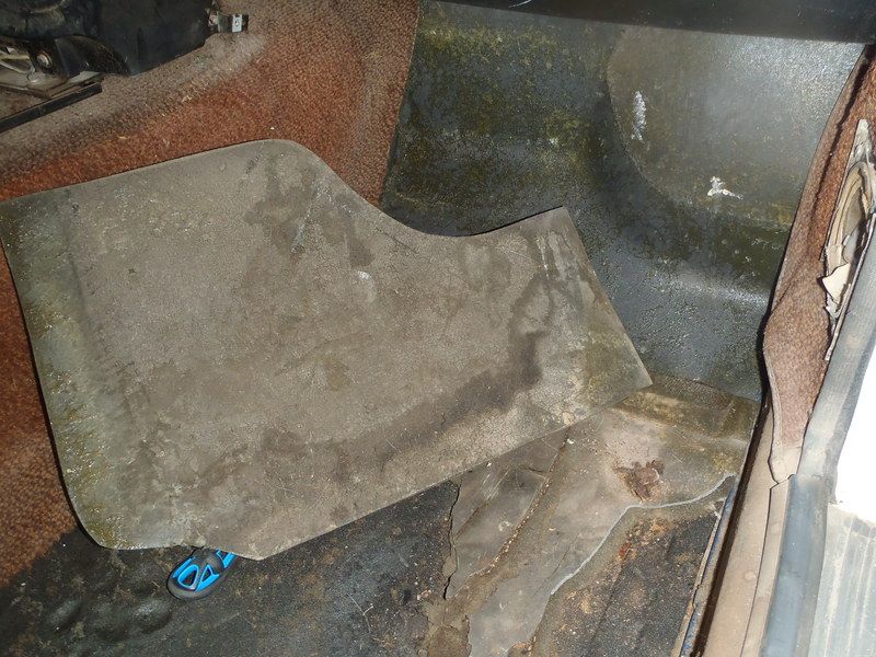

An interesting find in the footwell. A big pad of sorts under the carpet and floor pad. Also, there appears to be an extremely hard final floor covering. There "doesn't" seem to be any rust in the floors, even when viewed from below, is it worth while to try and remove the hard padding?

If you plan on redoing the seats, just take the b pillars with you. I just finished redoing my entire interior (dash, center console, seats, carpet, mats, rear deck)

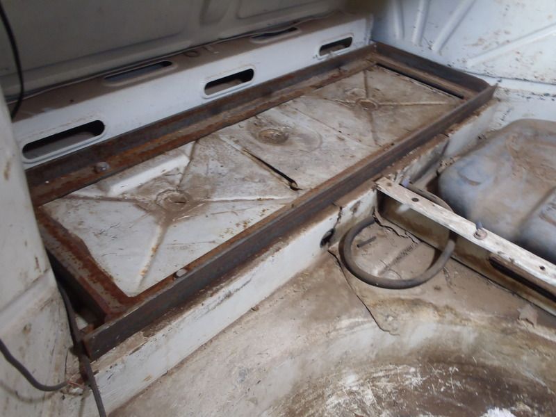

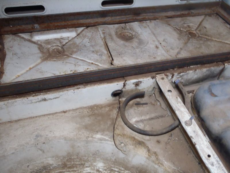

Meanwhile, I cleaned all the junk out of the trunk and holy $hit Batman. Crack City! The crack/tear on the left side of the cross member goes all the way from the bracket down into the wheel well. Must be 18" long or so.
You can see the tear on the right side of the crossmember right behind the gas tank
When I first saw the angle iron frame, I just thought is was the PO's feeble attempt at a structural brace of sorts or a battery bracket. Now it looks like he was attempting to hold the rear of the car together. I didn't get any shots from underneath, will do so in a couple of weeks.
Anybody ever seen this on an e3 before? What could he have possibly done to rip the floor like this? I'm assuming I can weld it back up unless the differential brackets are toast too. Ugh!

E911
1,192
155
Frozen Tundra
This brings up a side question; should the E3 chassis get the E9 diff mount treatment when increasing torque and horsepower?
E911
1,192
155
Frozen Tundra
Same diffs, not sure about the structure but this splitting/cracking is why it was developed and might be part of your repair solution. Check out Coupe Kings website for a description. Others here can provide more insight.
