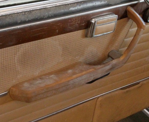

I think that photo shows the sellers are being honest by not hiding one of the drawbacks of this car. They could have done a quick cleaning of the arm rests, but instead left them as is as an indicator of what lurks in this car. The buyer will need something like the MaxBlaster and a lot of elbow grease.
yes Mark, you got it in one. the problem with this is that as Peter can tell you, its not just a surface thing ... it gets into the padding of all of the upholstery. you can clean it off of the surface, but you have some serious taking things apart ... and the seats are really fun to do. i didn't go crawling around inside the car too much because i am a bit allergic to mold and its intoxicating aroma.

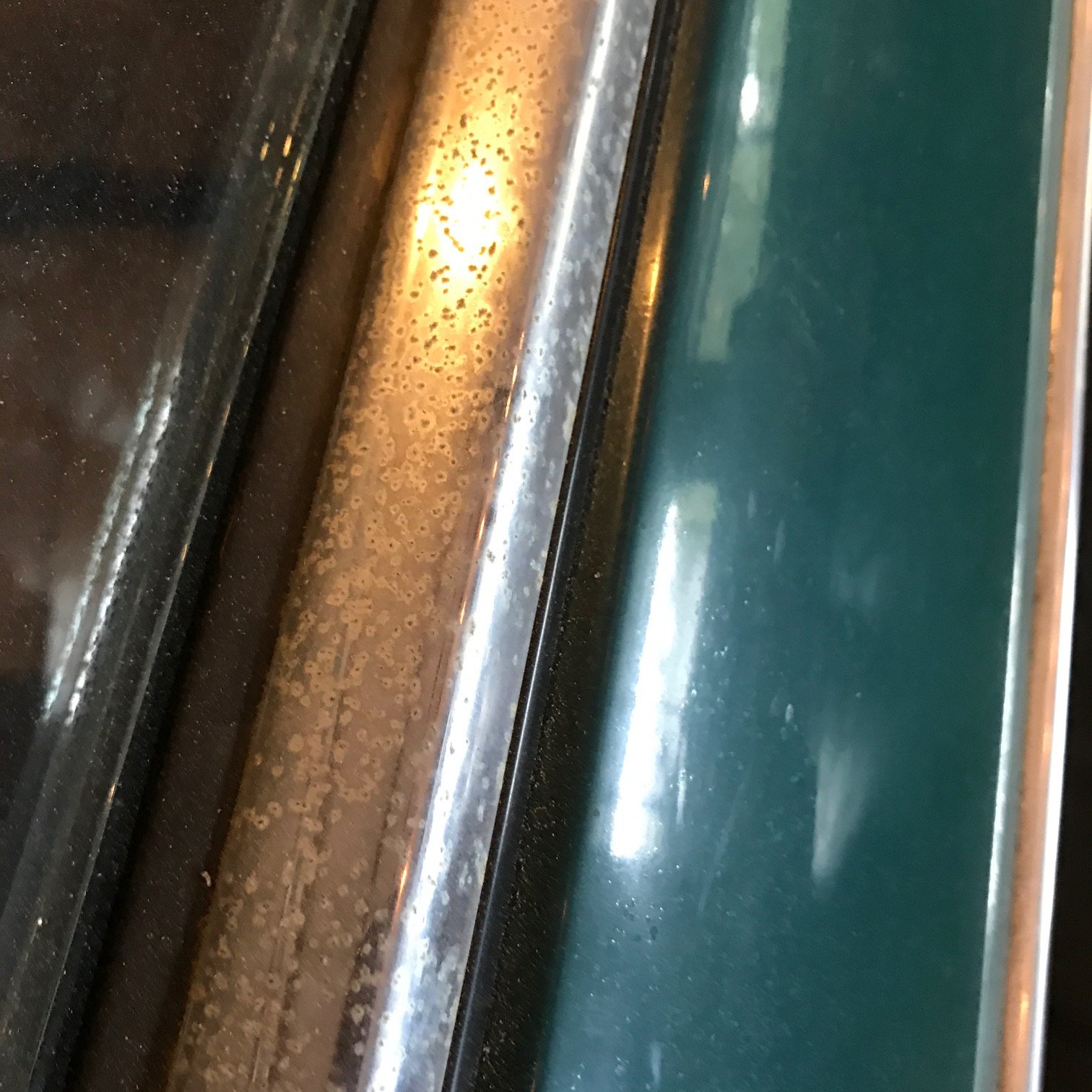

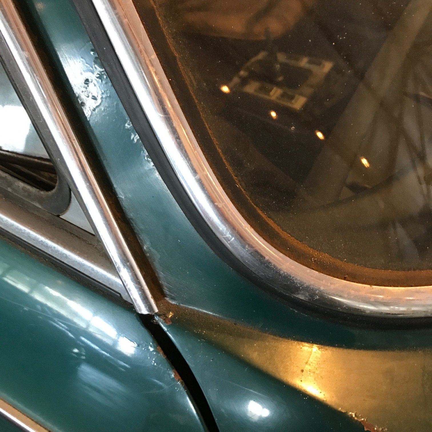

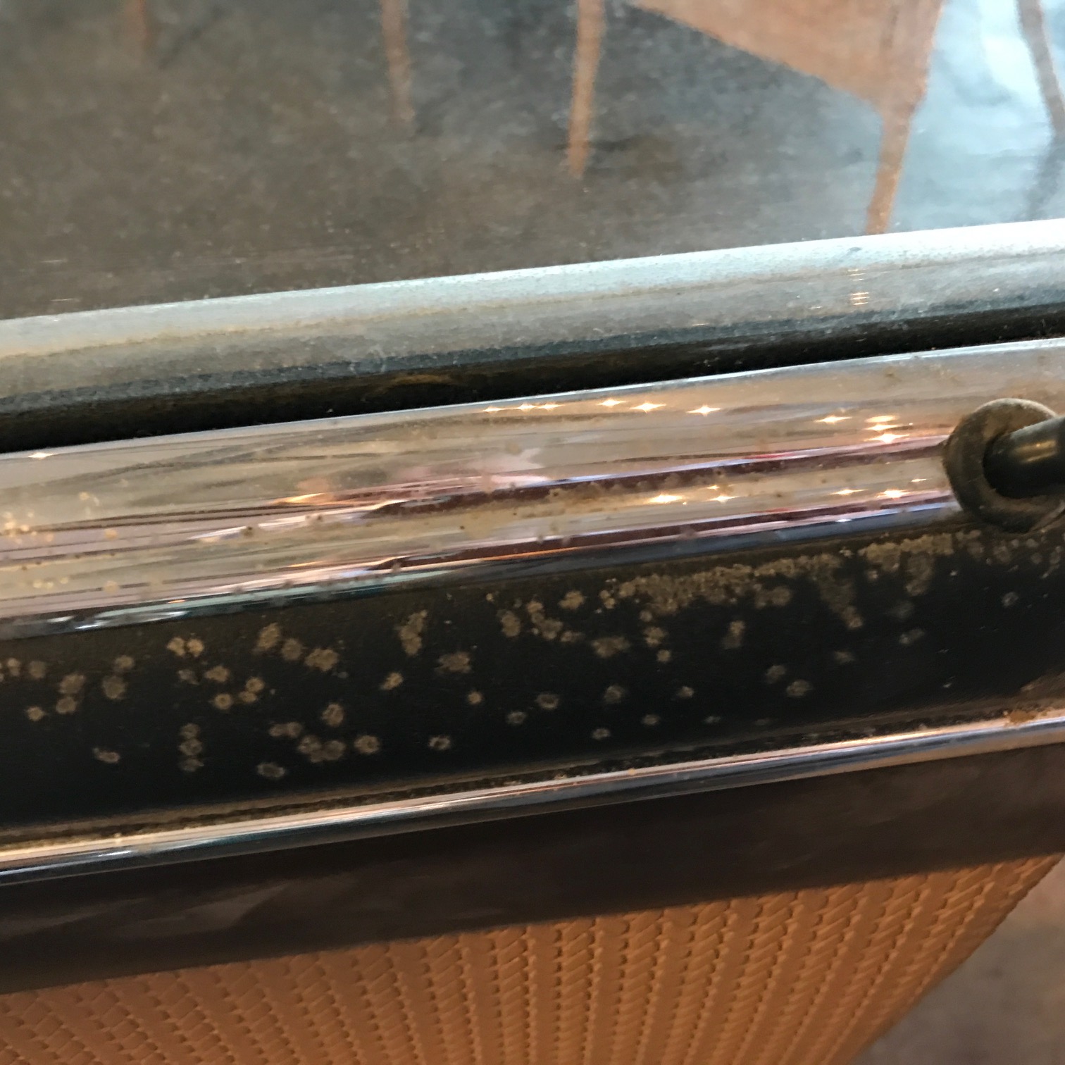

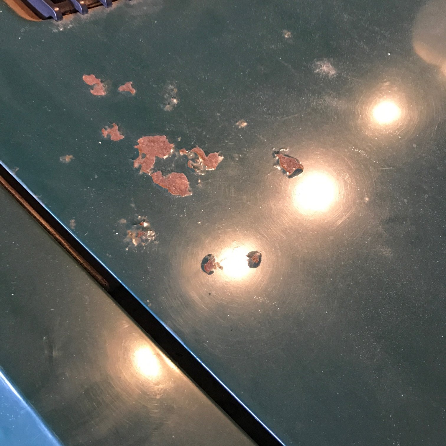

here is a close up of the hood. then look at the passenger A pillar and the rust caused from the tear in the windshield gasket above. then the window trim pitting ... then the mold on the top of the door panel.
