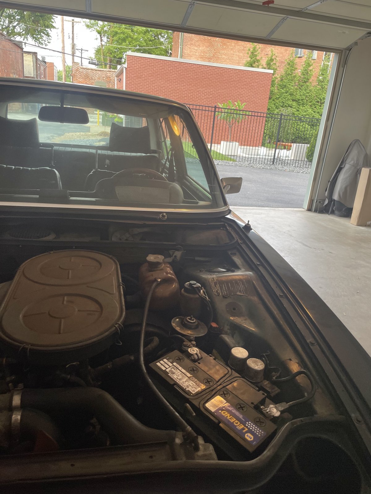

When I replaced my ground cable, I added another ground from the bolt on the body where the (new) battery terminal was grounded, which went from there to the block. Cheap insurance.
Battery connections, fence, and neighbor‘s pool… :)

It's a manual transmission. I didn't really find any troublesome wires. The issue as I understand it is that all of the wires that feed from the positive battery terminal had a poor connection to the terminal. This includes the big wire (or wires) that go to the starter. So cleaning up the connection to the positive battery terminal resolved my issue.
