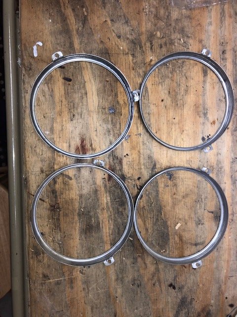

i have an extra set of perfect chrome rings id you need them
thats all you need and go to h1 hella i used both high beam
as they are flat and u just need to notch the low beam bracket as the notchs are different on high and low
as you see thay are both solid flat
the low beam headlight model has a projection that sticks out
lookin ugly

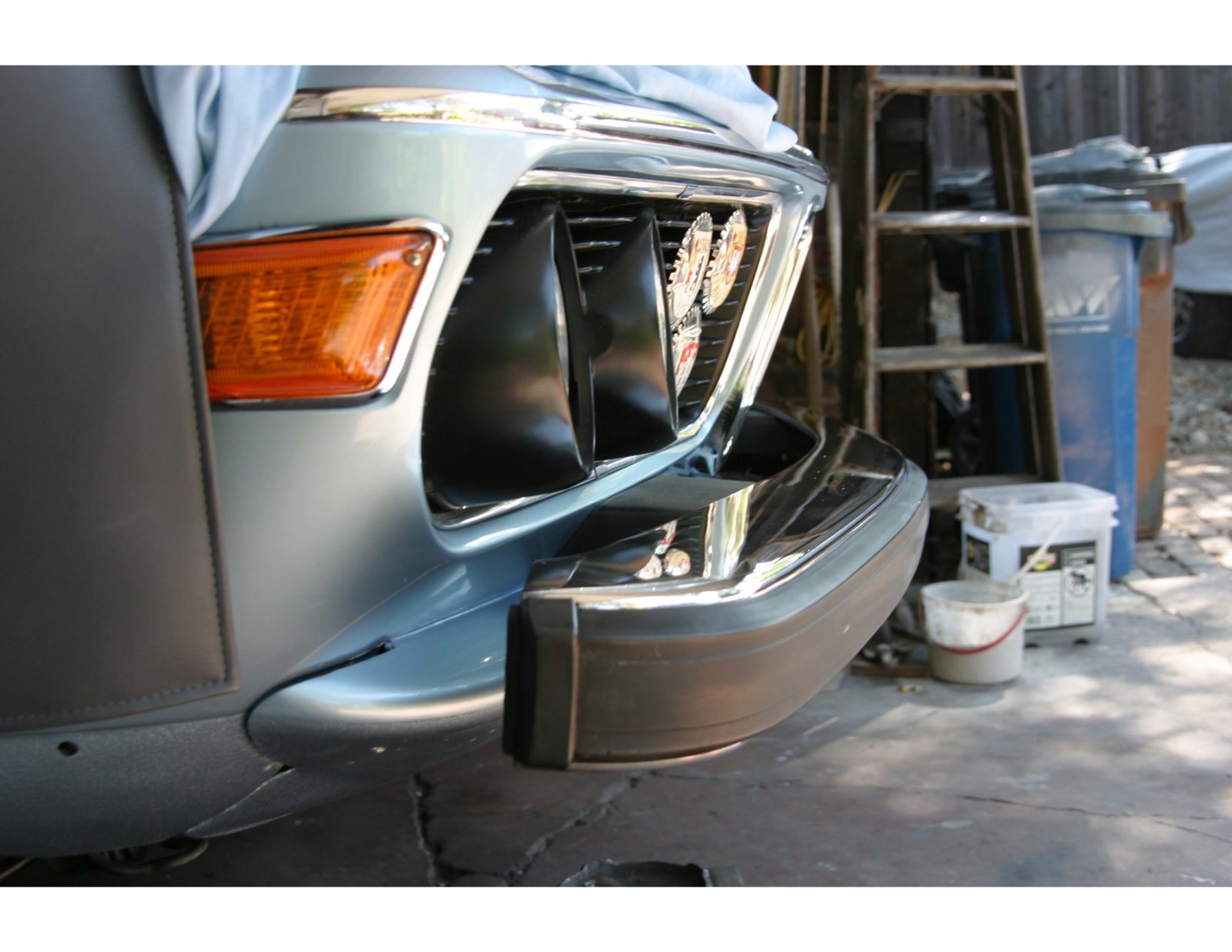

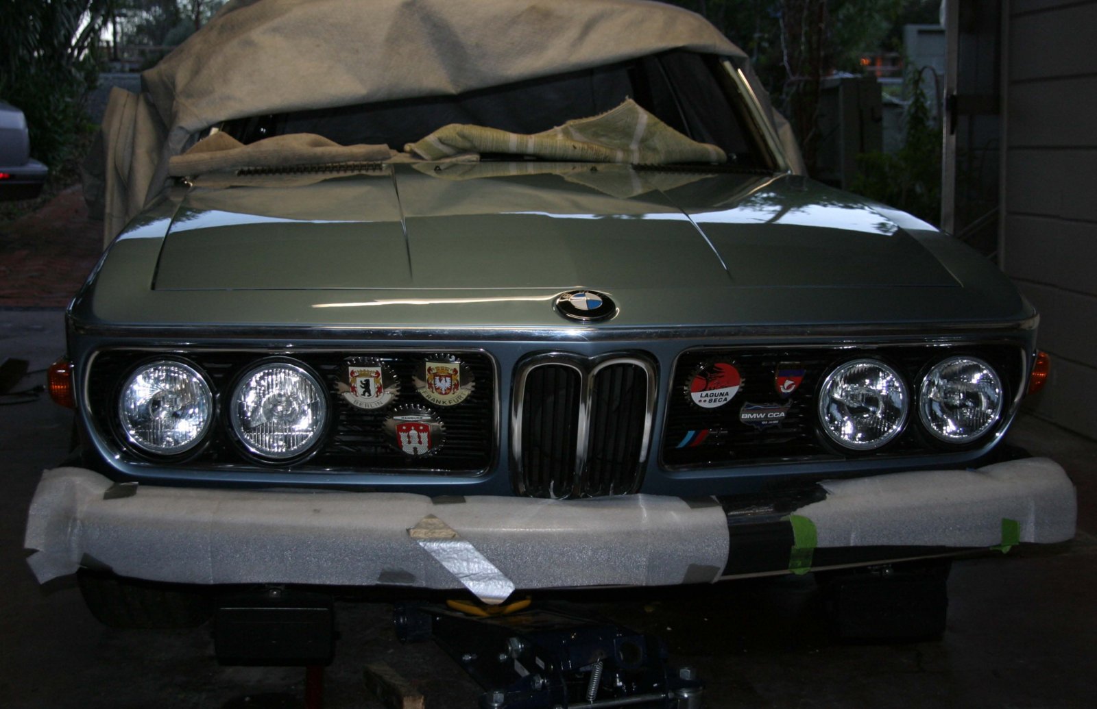

I'm with Arde, use the original original. Two Hella/BMW H1 lamps on each side --one low beam, one high beam (don't listen to aearch...), with those unique low beams with the black insert that give off that 70's blacked-out purposeful, badass look on the low beams. Plus, the glass is truly flush unlike the H4's taller, stepped-up glass. And... you only need to carry one type of bulb spare: H1.
As far as I've been able to ascertain, those original-style low beams with the blackout look are only available from BMW, or Walloth with a better price when they go on sale every so many months.

HEY THIS IS JUST A COMMENT
WHATS UP WITH THIS "DONT LISTEN TO ARCH NONSENCE"
NO THEY ARE INSERT HALOGENS
YOU CHANGE THE BULB WATTS TO 55 NOT 100
LOOKS GOOD
MINE ARE HIS -JUST PLAIN HELLAS
NOT BLACKED OUT
JUST PREFERENCE
HIS CAR IS NOT A CSL OR BATMOBILE SO THOSE WOULD NOT BE ORIGINAL RIGHT

View attachment 62188 View attachment 62190 i have an extra set of perfect chrome rings id you need them
lookin ugly
Looks like I will need the rings if available.
