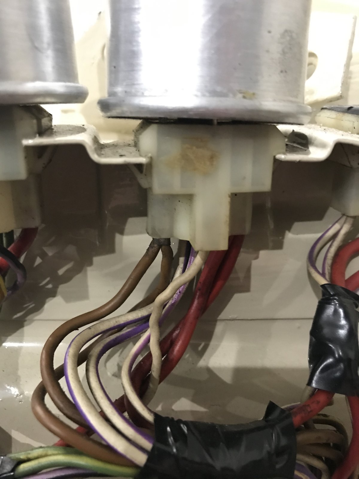

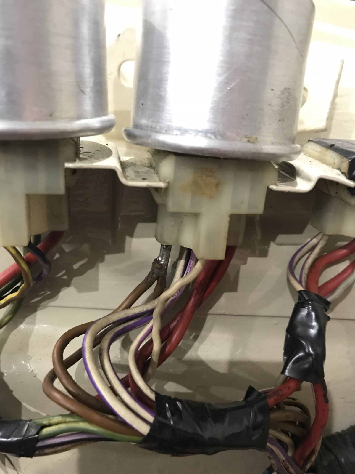

Bill - Yes, there are more current (recently made) relays that handle more CURRENT (higher amps capacity), so the answer to both is YES, and generally they are square (cubical) in shape, not that it matters what the shape is... the key is the terminal wiring. The small numbers on the bottom or side show how to wire them for the desired operation. 30, 85, 86, 87/87a, etc. all have specfic meaning the DIN world of wiring designation.Thank you!
I think I may have a relay issue. I will check the circuit as it worked before resto began. However, is there a more current relay that works in place of the original cylindrical relay?
