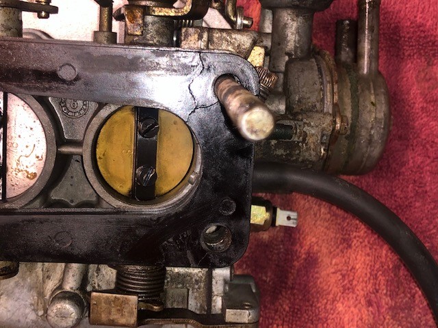

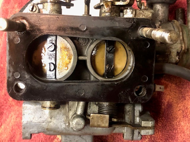

The photos are of the front carb the plastic plate is cracked the gasket under has some cracks.

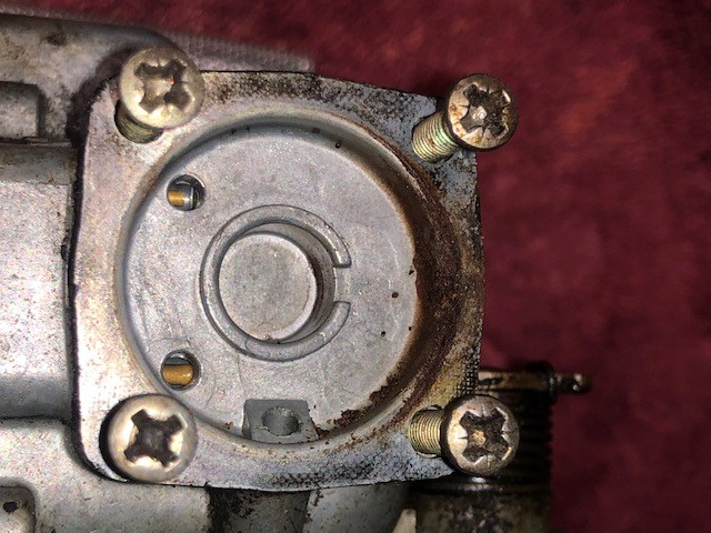

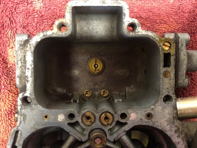

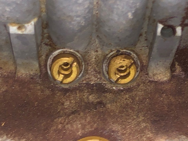

The front carb is partially disassembled it shows a lot of residue -dirt see attached. The larger barrel jet looks like 175 and the smaller is 170 as this is for a 3.5 L do these look correct?

When you speak of rebuilding, did you remove all the calibrated parts and soak the carb bodies in some type of carb cleaner (then dry and blow out the air passages with compressed air) so as to remove all the grime shown in your prior pictures. If not, this needs to be done. And your calibrated parts need to be clean too. Given the amount of grime showing in the bottom of the bowl, it is possible that some of the passageways inside the carb are clogged up. This would inhibit the carb's ability to use differential air pressure to create a fuel mixture, and could well explain your backfiring problem as fuel is flowing but air is not. If you cannot get the carbs really clean, they need to be replaced.
Once we get past cleanliness, I need ask about a comment you made. When you say "electric idle jets not working properly and the liquid chokes marginal," I find this confusing.
I am not familiar with electric idle jets. My understanding is that idle jets operate off of engine vacuum. Can you post a picture of the electric part you tested that is not working properly, and describe what happens when this part doesn't work properly?
Also, when you say that the liquid chokes are marginal, what exactly are they doing? If they do not operate so as to close off the throats at all, you may be able to put this aside for now and live with the fact that your car will not run well until it warms up. On the other hand, if they marginally operate so as to effect the movement of the throttle plates when the engine is warm, you cannot tune around this and they must be addressed before you forge ahead.
The carbs were completely dis-assembled the calibrated parts soaked in carb. cleaner and tooth brushed and blown off. The die cast bodies were cleaned with carb. cleaner and then soaked in pine-sol for a couple days and scrubbed with tooth and other brushes. Blow out with air. The liquid chokes were very corroded and required a lot of rework to get the calibrated parts functioning. I'll take a photo of the electric jets and post. There were definite vacuum leaks at the bases the base of the carbs had been leaking for some time and had a large build up of carbon and corrosion - which required 1000 grit sand paper on a flat plate to get them smooth again. With new phenolic plates and gaskets - and new plugs all my issues are resolved. The forum advice was correct the vacuum leaks were 90% of the issue. I have a very nice idle at about 700 RPM all advice appreciated - I now have some carb experience.
