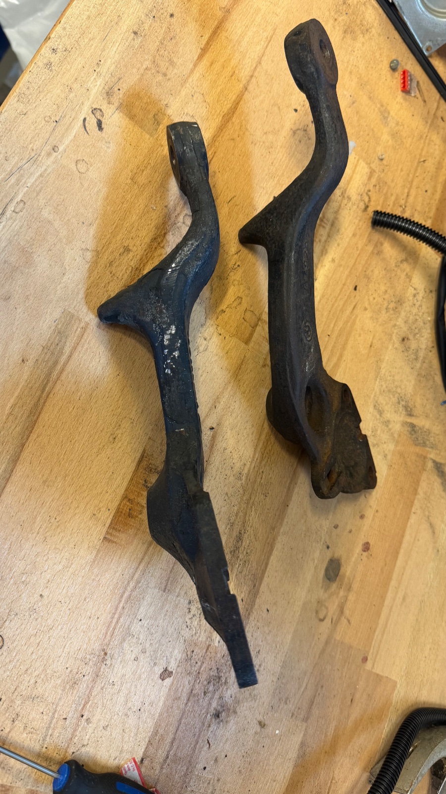

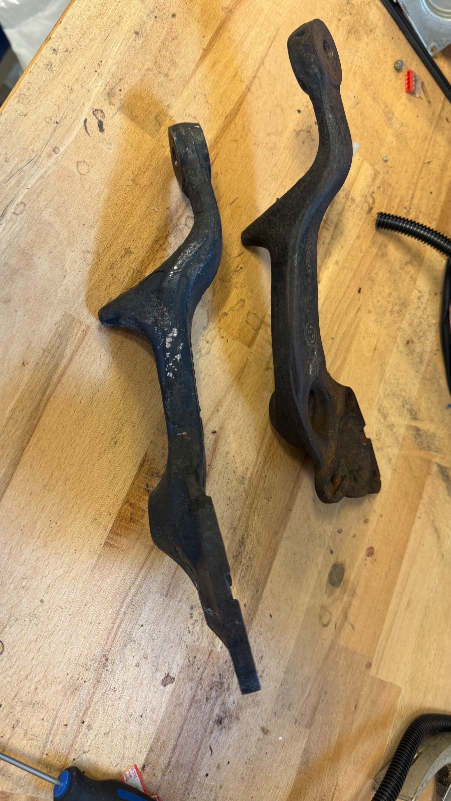

Steering issue is still there, but there has been some progress. Found out that u joints were clocked to the maximum worst position which caused very stiff steering. Sorting that out first, it started to return a bit. Then discovered that guys did chop a piece off from steering arm strut. Actually like half of it. So the force to return the steering is very small! Bought original struts and next up, is fitting those and trying to adjust the rack position to match. I think this combined with badly clocked u joints is the issue. Attached the picture of the chipped strut and the originals that I bought.
