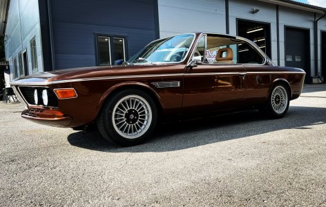

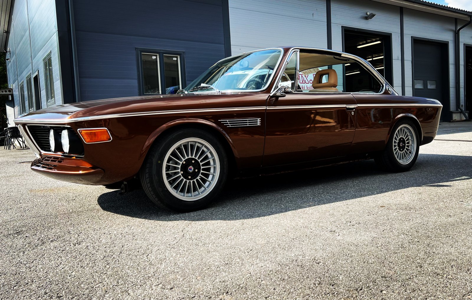

After last update here, which was about battery box and air suspension install.. and problems with Citroen C2 electric power steering.. they have all been sorted out and much more has happened. Oh yeah, and car is drivable! Just missing the dash and some cosmetic parts like Alpina front lip, side rocker covers .. and maybe putting the rear bumper back.

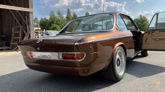

Paint job looks so good, and pretty close to original. This is modern BMW Chestnut Bronze paint.

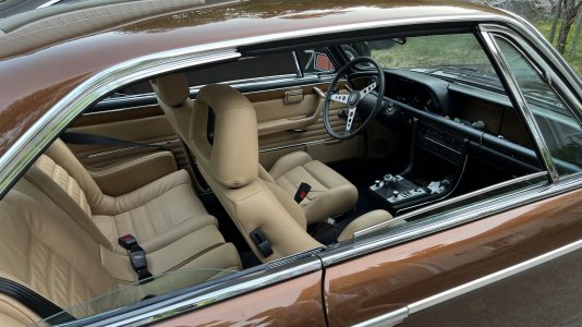

New interior is perfect. Leather is super nice and seats support well, while still retaining the look of that era. Seats have electric height adjustment :)
Car drives very nicely. Suspension works well and car is super stable. Steering is very direct and sharp. Power is limited to original power, to get it inspected for road use. Haven’t yet tried how that 300kW to rear wheels feel like :)

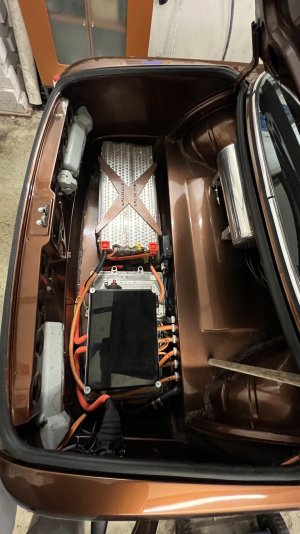

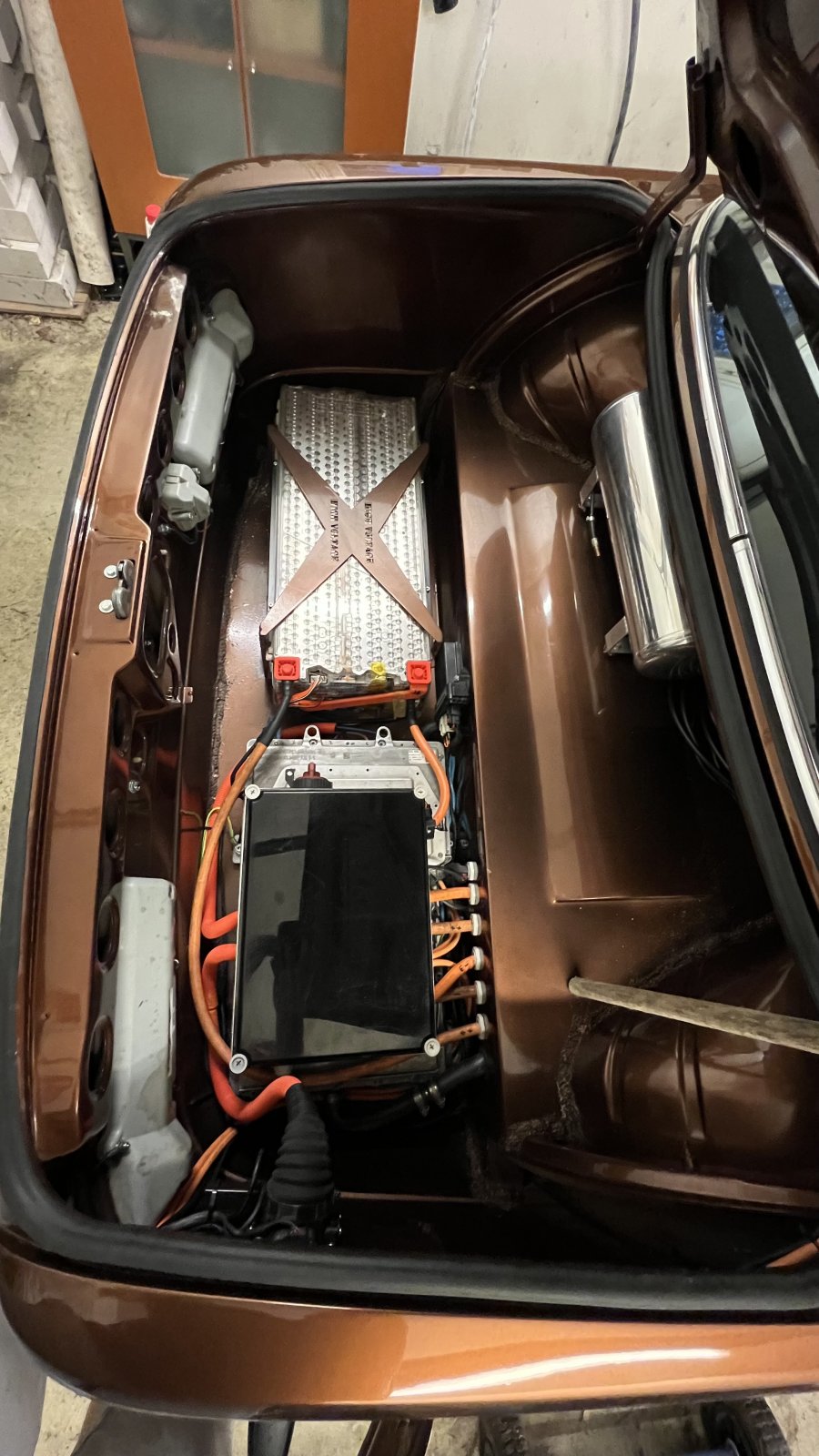

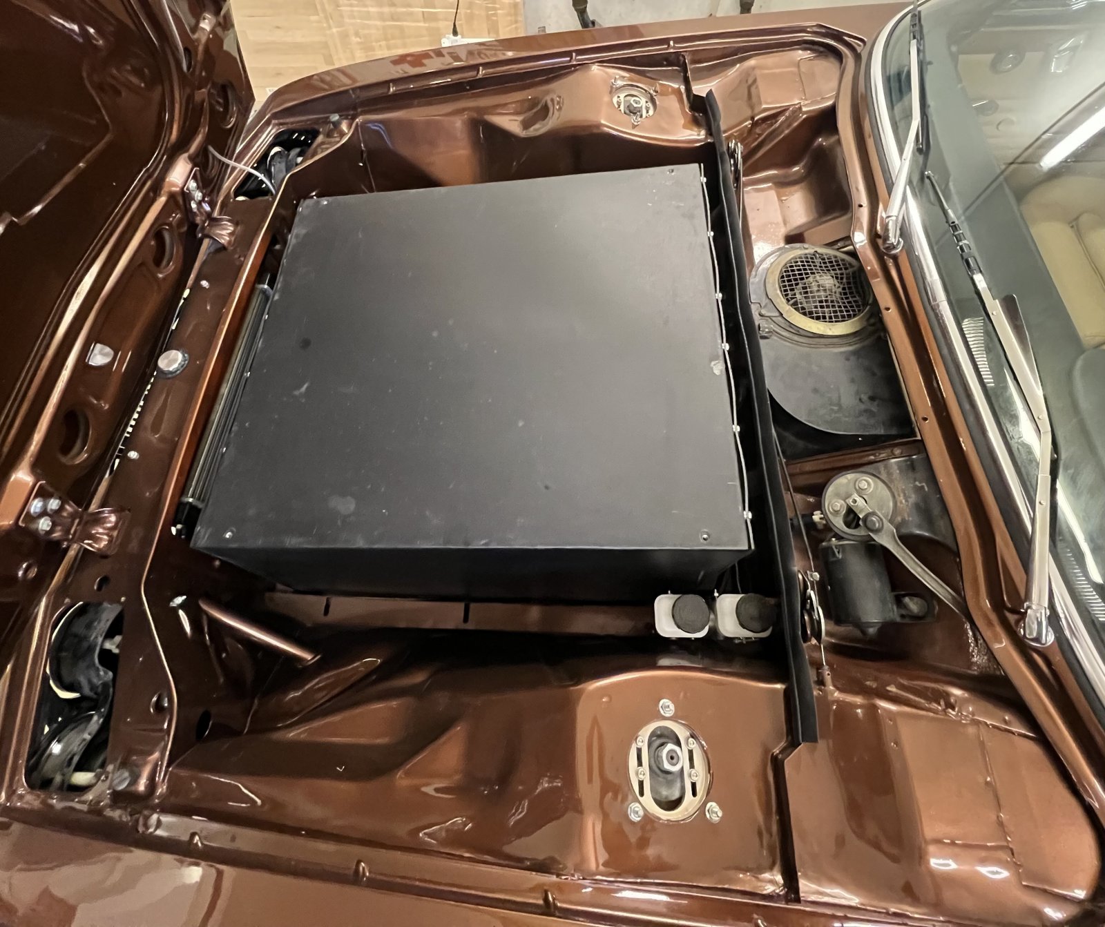

Looks great. Super clean trunk. I'm sure we could swap some stories.... Post some pics of your final steering and front battery box setups. You appear to have two modules stacked in the trunk. And how many up front, 12 (a previous photo showed 10)? If only 12 total then how's that working because voltage would be awfully low. Or did you hide two more elsewhere? Your original trunk floor looked flat but now I see a bump above the motor. What happened? What did you do for instrumentation? (forgive me, I'm not on IG).

Yep, only 12 modules. So roughly 220v - 302v. Haven't seen any problems with that yet. Currently output current is restricted to 400A, so giving out roughly that 130kW. It's snappy and fun to drive even with that.
I don't have good picture of front, but there is basically one black box. Nothing else to see. Or well, you can see oem airbox and wiper motor. Original airbox has electric heater element in it and micro switches for cool / neutral / hot air. Control switches are original inside. AC compressor is on cardan tunnel, so is the front junction box. Wiper fluids are next to headlights (bag type). I'll grab a pic tomorrow.

Floor was flat in one pic, before putting the motor back. After putting it back, we realized it won't fit with the new floor, so we did this "power" hump :)

I drove about 180km with that last week when I transferred it home. Battery went from 75% -> 28% .. I calculated that I can do around 400km with one charge :) More than enough for this cars needs. I think even 200km would have been enough for this type of car. Consumption was about 15-16kWh per 100km. Battery is total about 63,6kWh.
If I would do it again, I would use smaller capacity battery modules to get voltage up to 400V. More voltage, more power .. and less weight.
Current weight is about 1370kg. Dry weight of E9 in registration says 1440kg and max loaded weight 1750. So it's under the original weight still, even though it carries almost full battery pack of Model S 75D. 75D has 14 modules, this has 12.

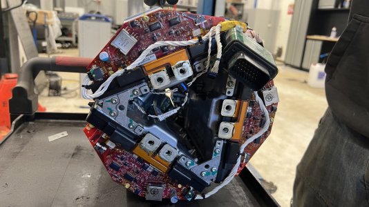

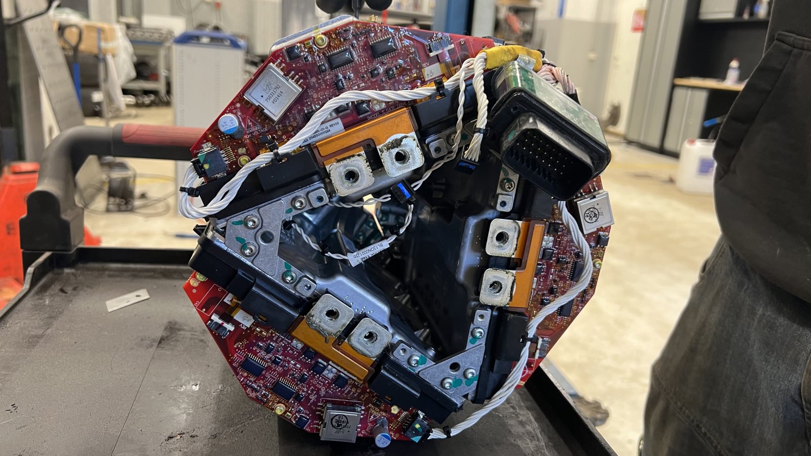

Got the car inspected and road legal! But after couple days of tweaking, I blew the inverter due bad setting on BMS. New one is already installed and car is back on streets. Blown inverter pic below.
