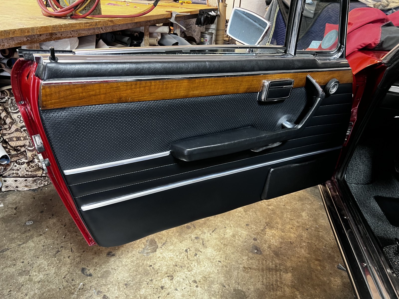

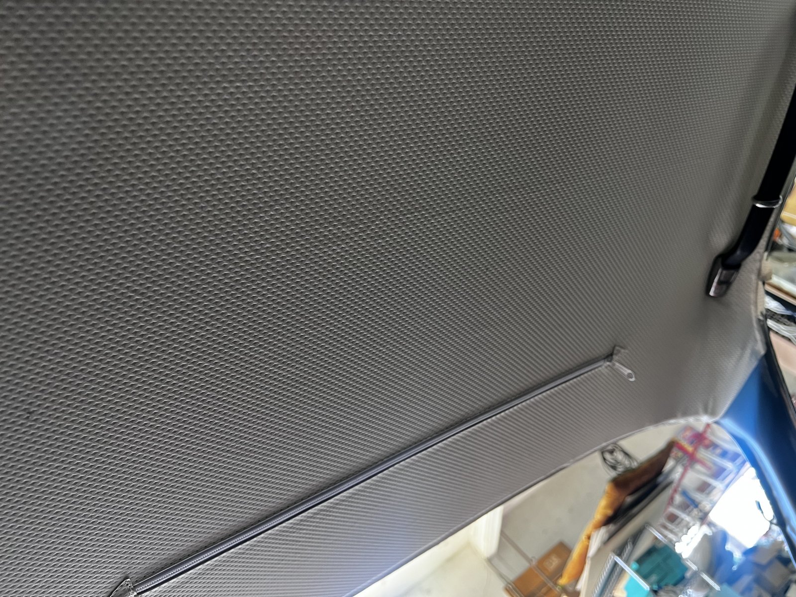

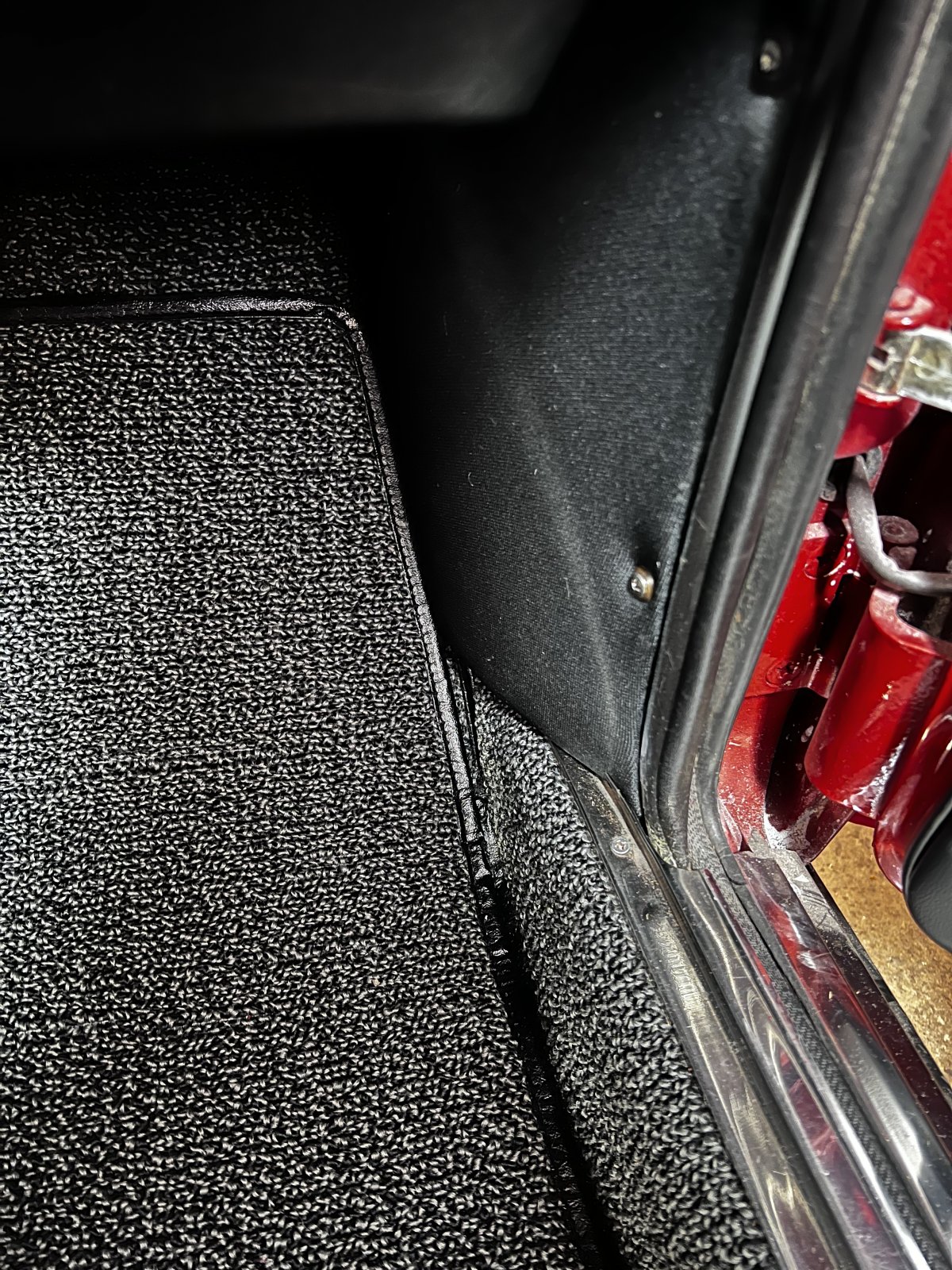

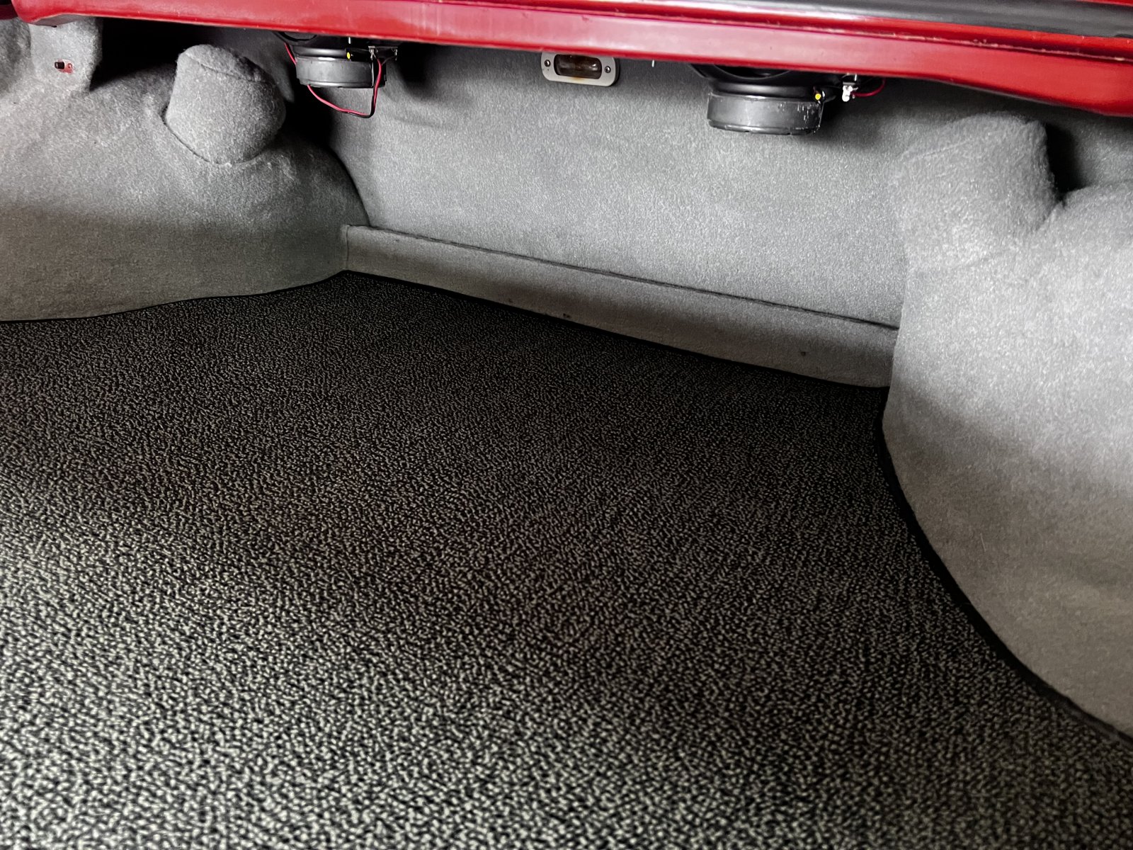

Some random pics from the buttoning up stage. New carpet, new door panels, new center console wrap in pleather, new headliner. It’s all nice. The trunk is decent. If I had it to do over again, I think I’d use a darker felt (I know, it’s all non-standard) and do the wheel arches with Wiola’s repro parts. Gotta get new sunroof cables from rogerstii, and install that thing, and then I think we can get outta pit lane for now.

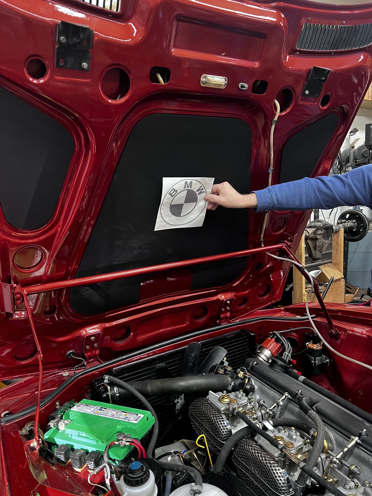

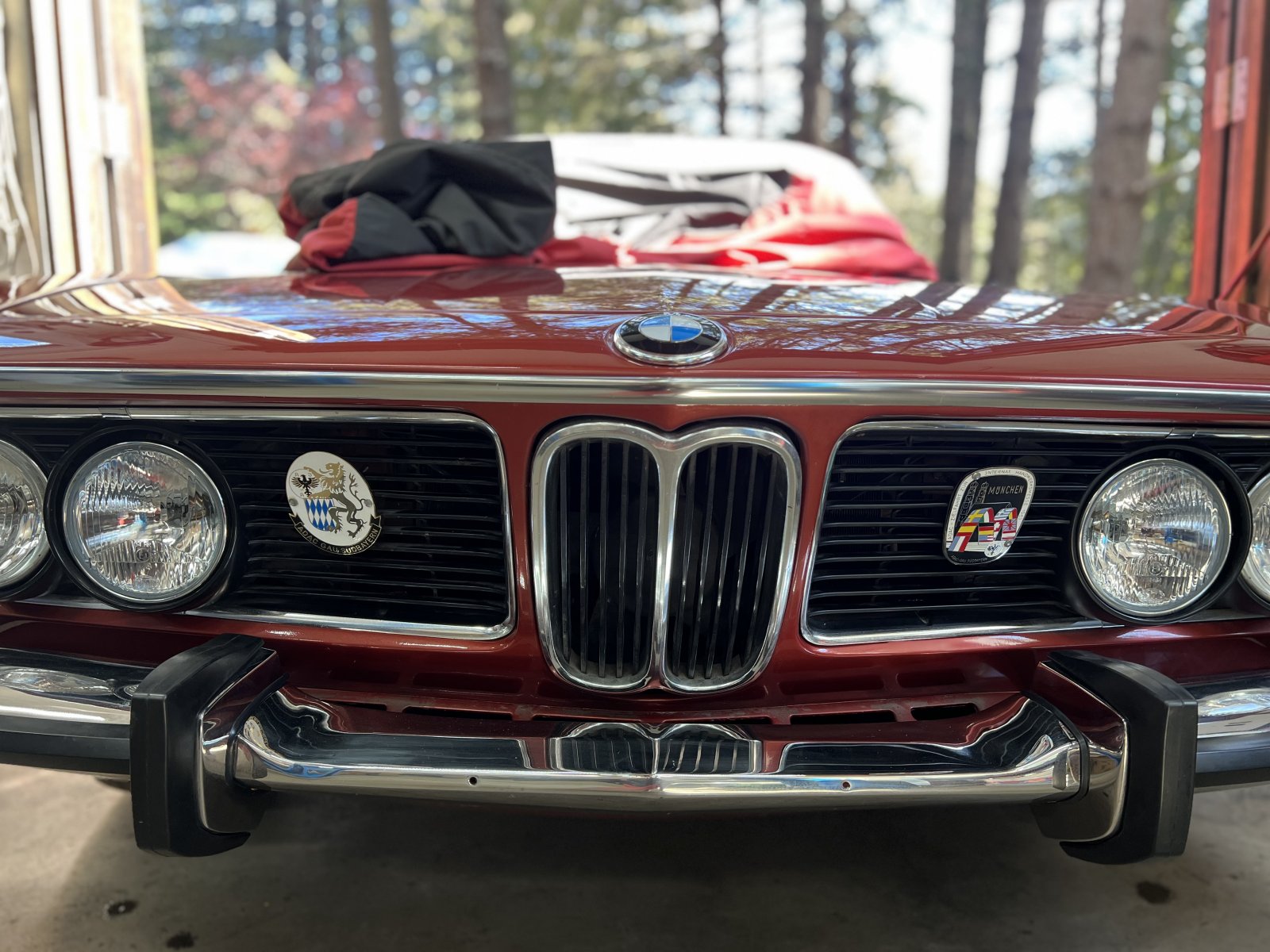

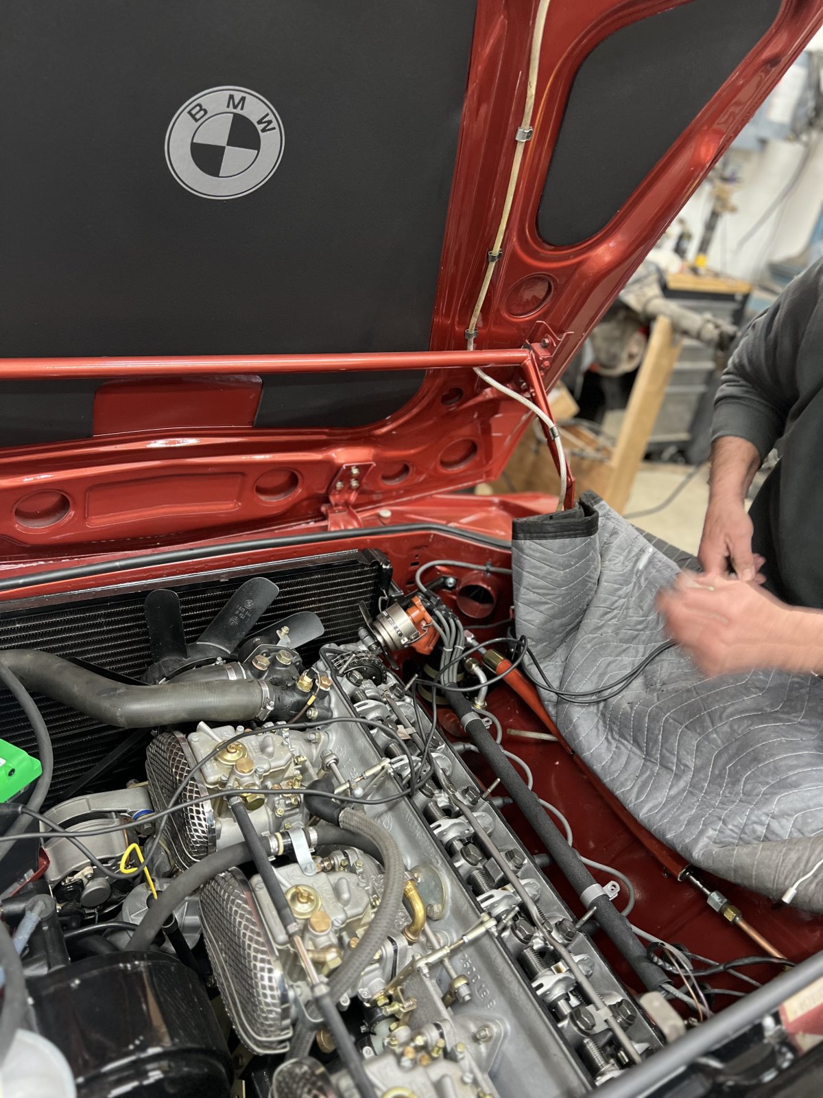

500 mile check up. Adjust valves, change oil, retorque head, fit AC system. And add bling to the hood. I like that logo. Wasn’t sure what that would look like.
Love the motor. Not nearly the low end loss of torque I thought might happen, and very nice giddy up on the high end. The thing is a joy to drive.

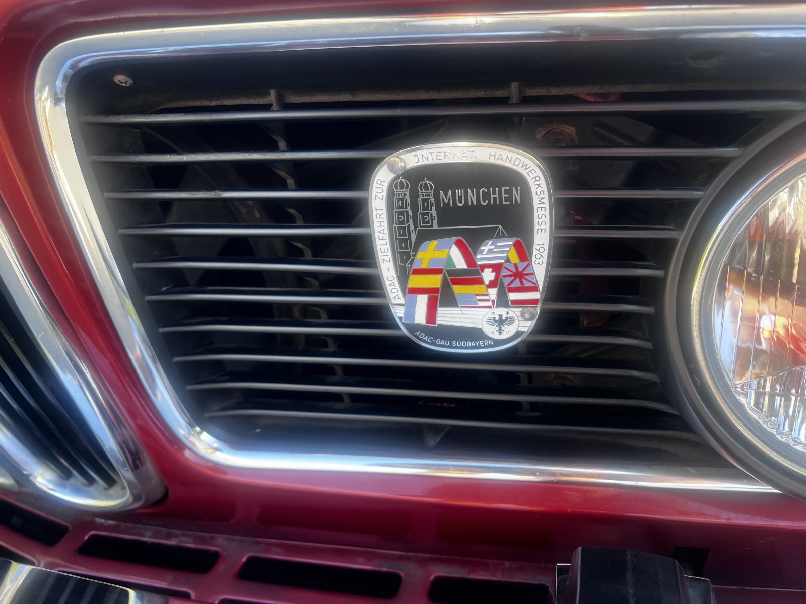

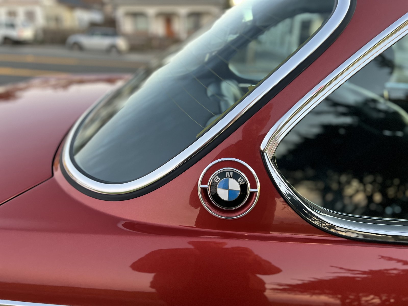

I need one of them fancy photographers. I’m no good at this. But I put this bling on there. It’s not terribly noticeable, but it looks good if you search it out.

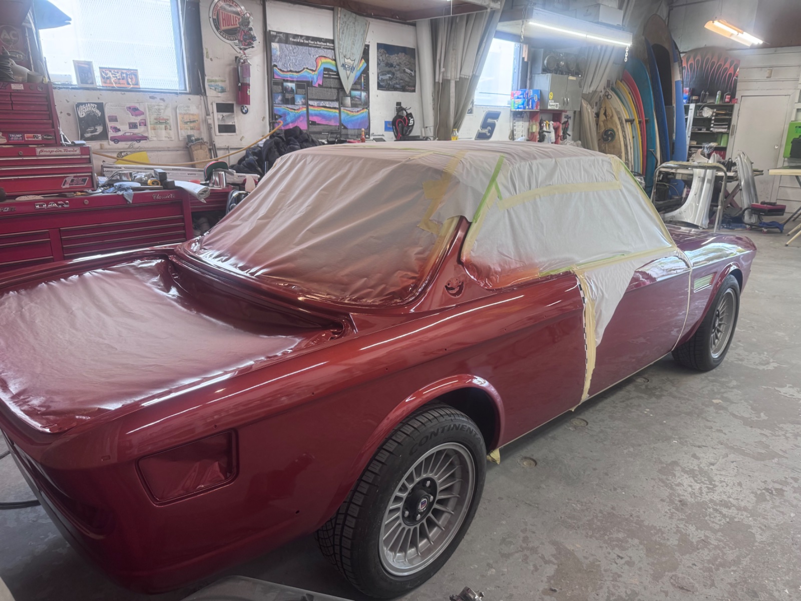

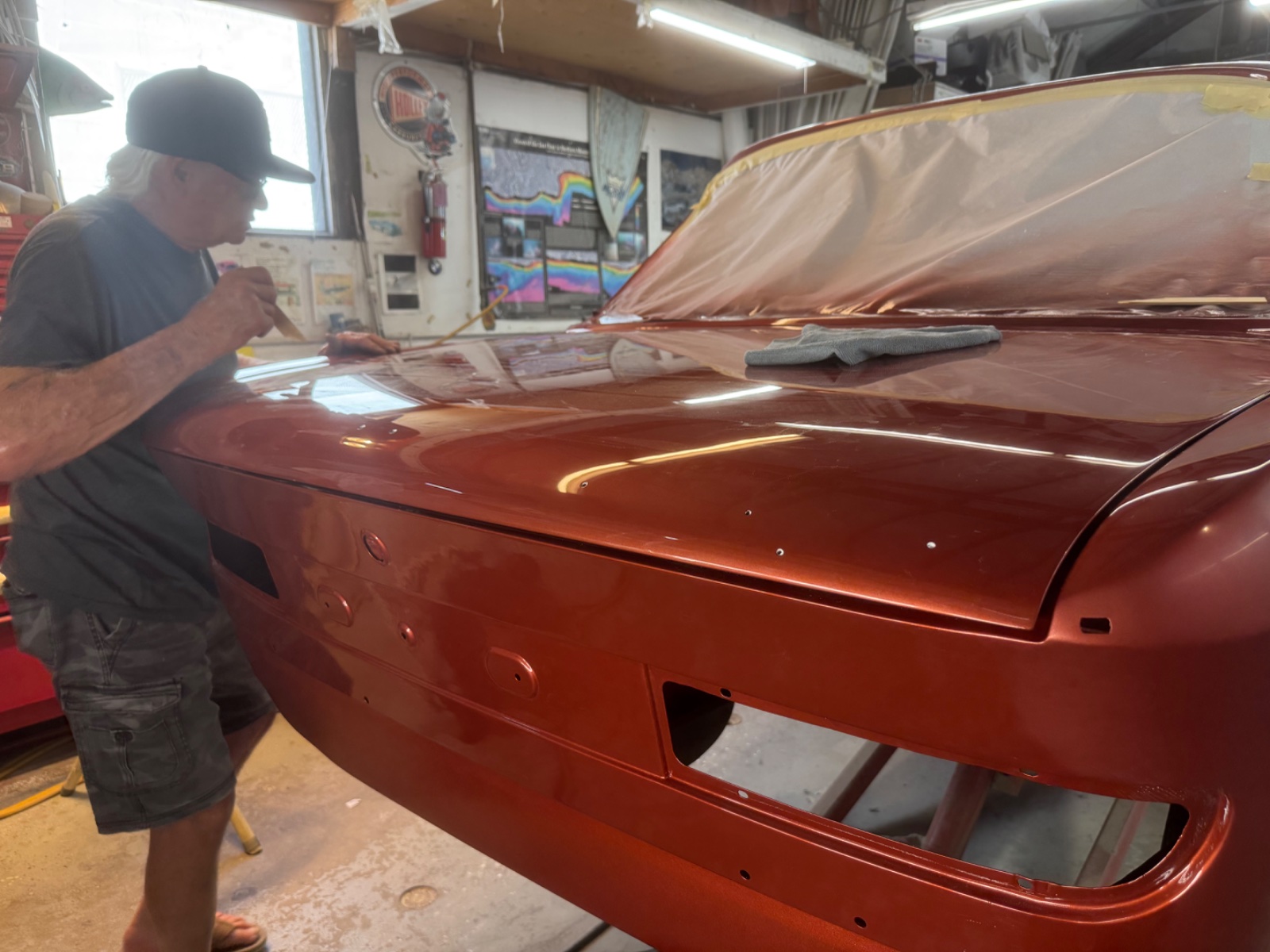

This thing should be back in mid-season form in late fall. Just in time to not drive it in the rain. Yay.
Seriously though, it’s going to be as good as it ever was. A sorted car, if ever there was one.

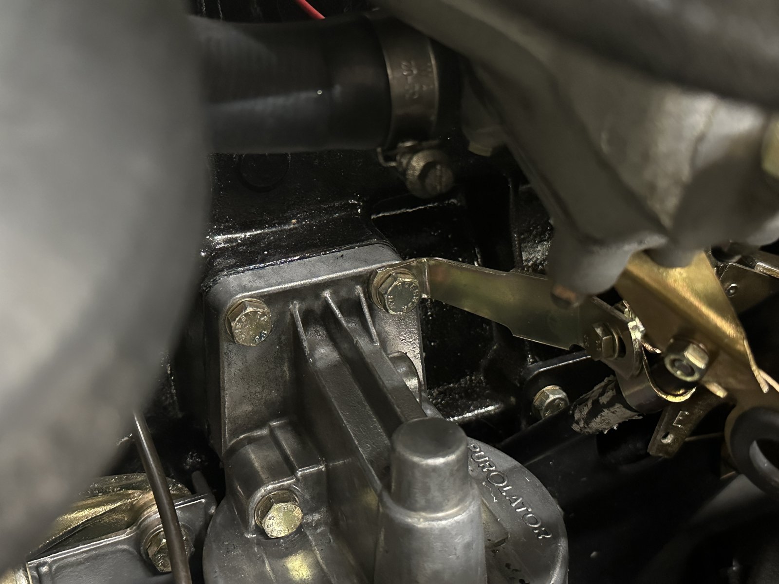

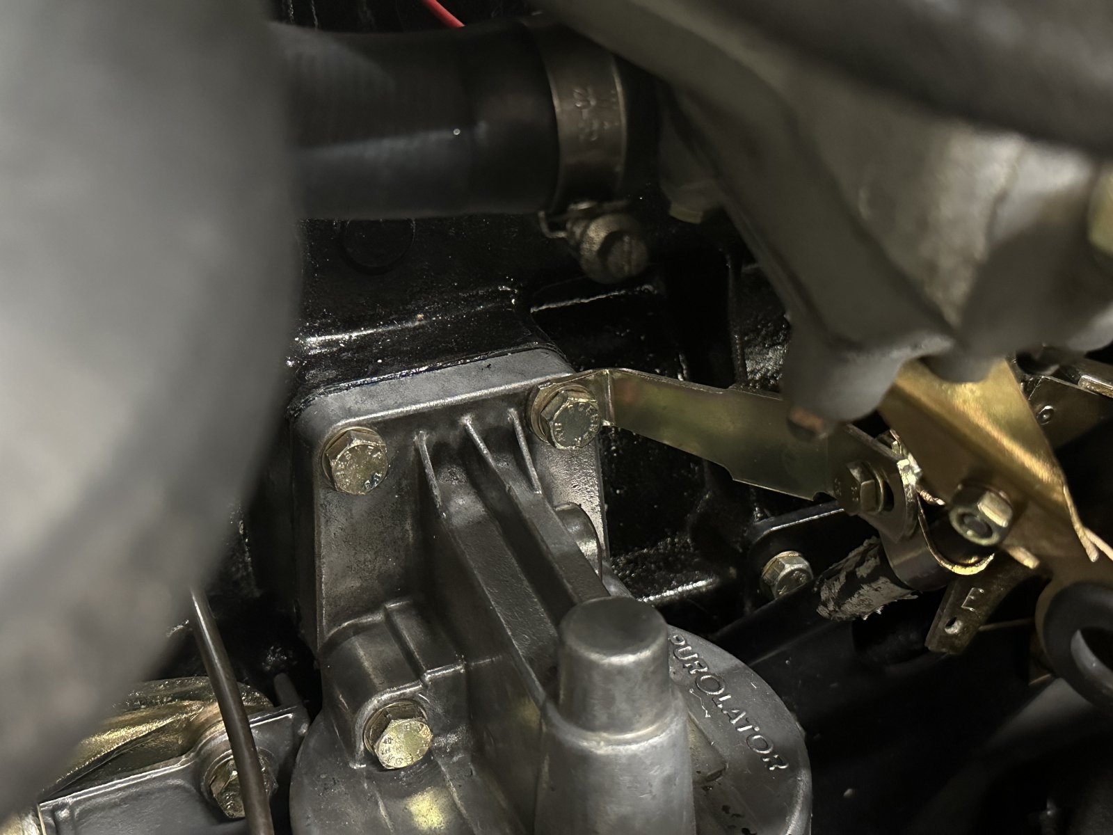

I notice on post # 109 pic #21, and post # 97 pic # 49 that your oil-fill indicator tube has a collar that might be a bracket attached somewhere to the engine block. My triple carb setup is similiar to yours,but does not have that collar. Could you take a photo showing how the tube is attached? My tube has no bracket and is loose. I need to secure it.
Thanks, Drew
Here is the drawing of the tube, collar and bracket.
I was searching high and low as I put the coupe back together and could not find my stand-off for the dipstick. I ended up grabbing one from a newer engine 3.4L that I have on a pallet/dolly that I know has very low miles. It stands between the dipstick tube and the oil filter housing.
Just today I discovered where the original was. It was attached to some bit of metal smog tube (original to 1972) that crossed under the engine and had flared ends. I believe that the original for my car was attached to that tube rather than the later version that stands off from the oil filter housing.
I will grab a picture of my current installation when I get the coupe back from the alignment shop.
Thanks, Drew
It attaches to the oil filter bolt, did I forget to send you a pic of mine?
