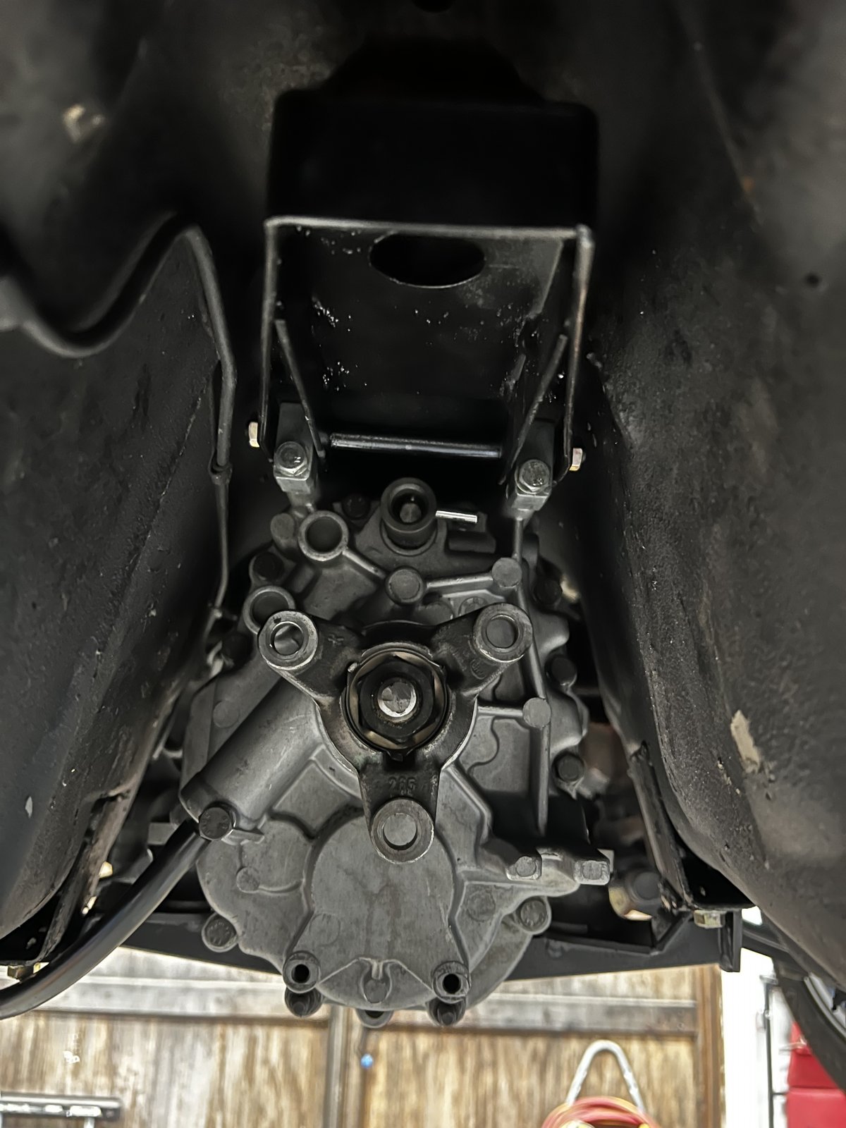

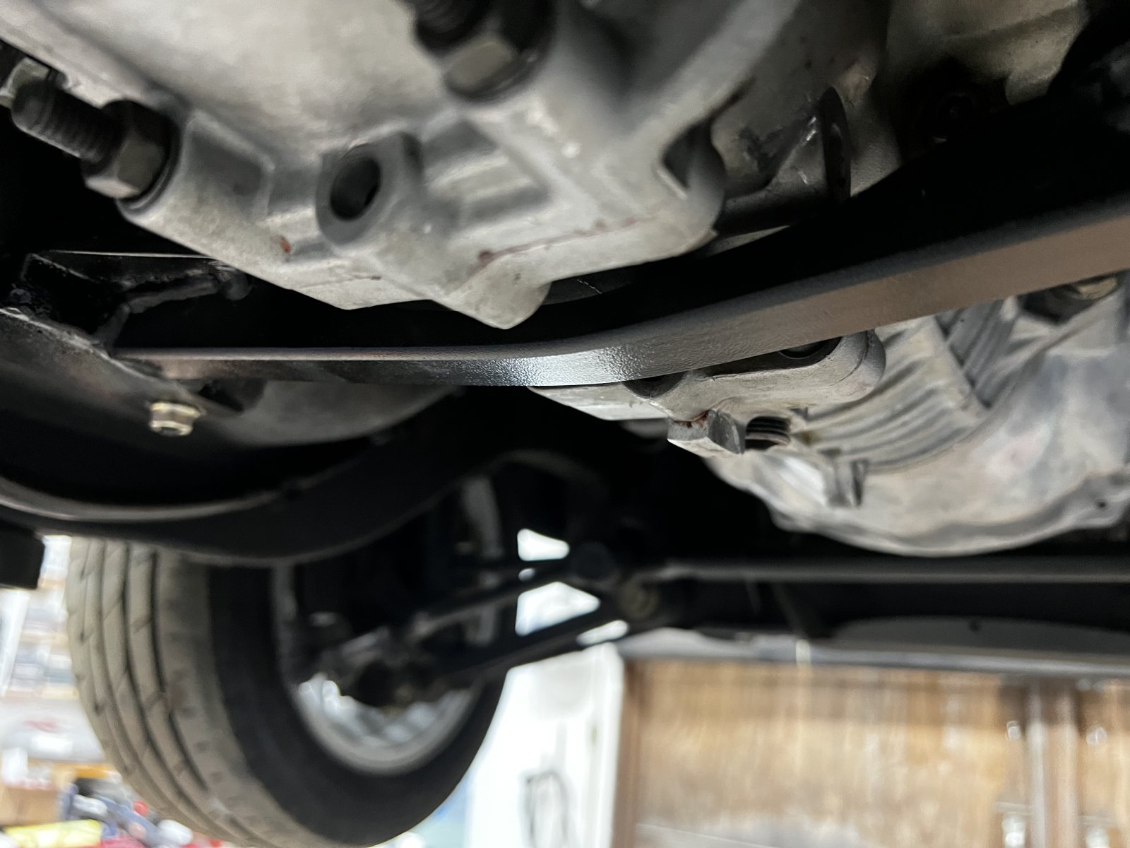

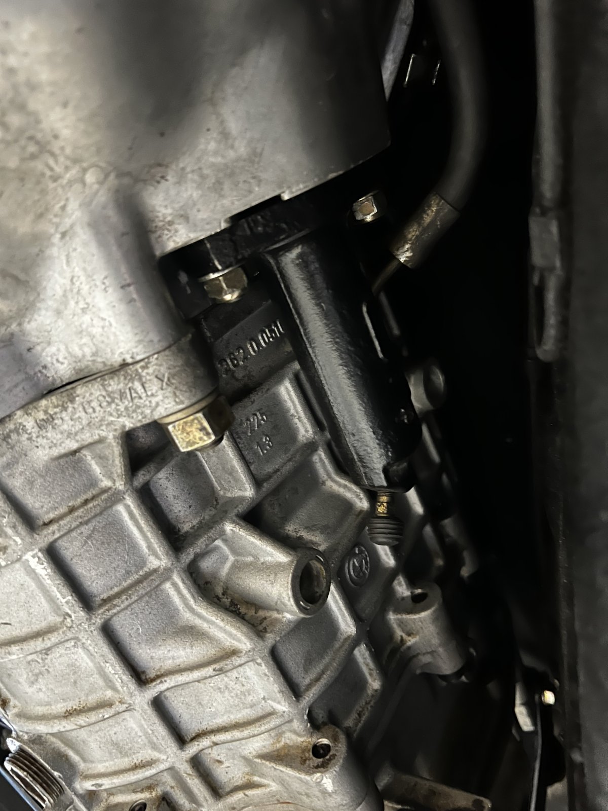

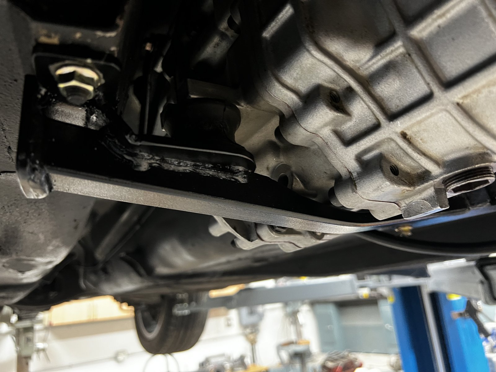

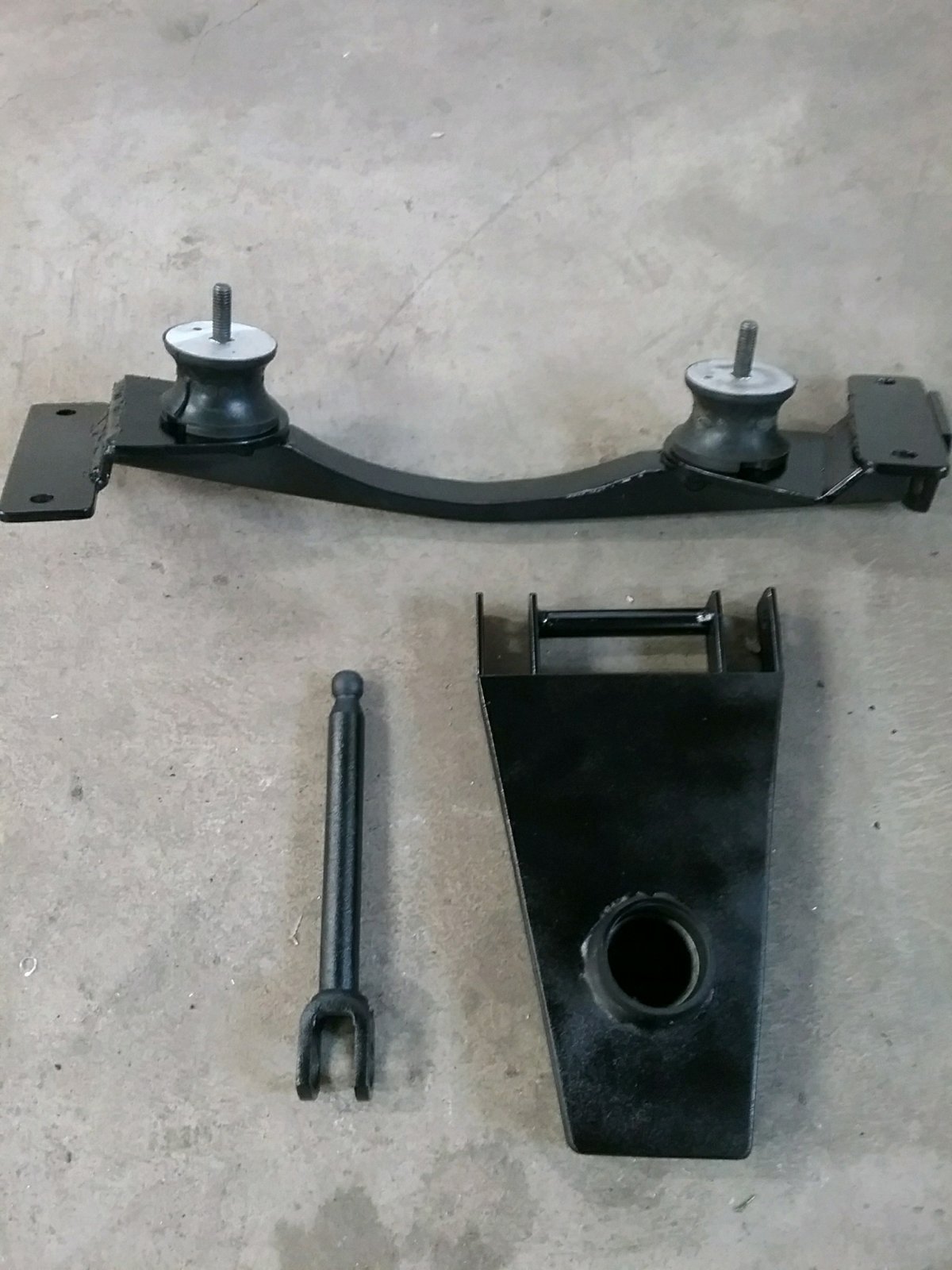

Transmission swap almost done. That new bracket fabrication is very nice, better than factory in terms of precision workmanship and finish, as is that custom bracket for the shorter linkage. There’s a lot of machine work in this.

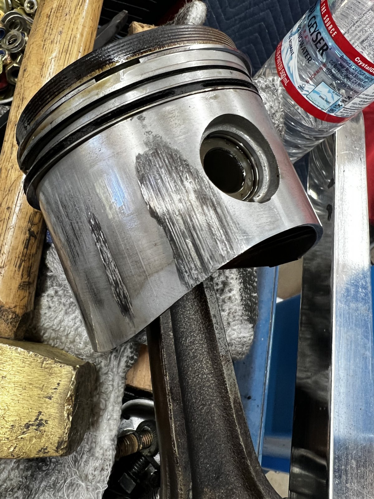

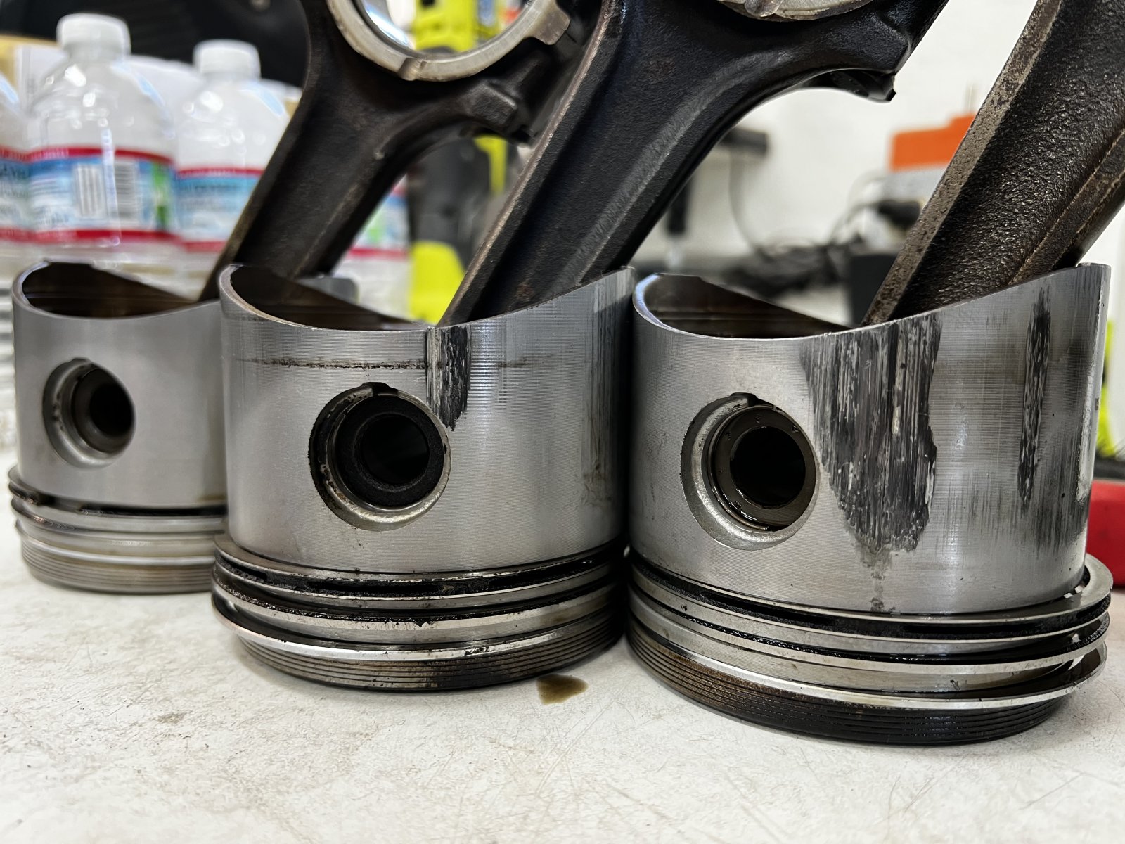

Ha. That explains much. And I thought we were going in to do a ring and valve job. New pistons and an overbore coming up, it seems.

Those pistons are newer than the block BTW. The engine seized up at at some point, and it appears to me that new pistons were put in without cleaning up the cylinders. I can’t imagine why.
I’ve owned the car for around three years, and I’ve put some 17,000 miles on it. The car has actually been down for upgrades at least half the time I’ve owned it, so it’s been driven quite a bit when it’s been on the road. I’m starting to think those pistons may have been new when I received the car, put in just for the sale. Presumably then, the seized engine had just happened, and had triggered the sale.
What is the condition of the affected bores? Have you decided to rebuild or replace the engine? If the former, do you have a lead on a machine shop?
Not certain yet, but our guess is the block is good. One visible score is present where a piston looks to have gotten stuck. Other than that, a visual inspection doesn’t yield much. We’re going to magnaflux the block, and if that goes well, bore it out a half to a full mm, and go from there. Crank also looks to be fine.
Don’t want to replace the numbers-matching block. If I do have to do that, it’ll become a different deal, crossing over into restomod territory, as I see it. At that point, I’d be looking at a later M30 and a B35 crank, etcetera. Or an M90. But really not what I want to do.
My mechanic, Wayne (who’s officially retired :)), has a boring machine and a magnaflux setup in his home shop. He rebuilds motors from the ground up. My project is actually interrupting one he’s trying to get going for himself. So we’re not shipping anything out, as things stand.

I actually just got confirmation that the magnaflux showed no cracks, and the crank and bores are standard size, so we’ll put it on the boring machine tomorrow, and look into getting new pistons shipped Monday. Fingers crossed that they’re readily available.

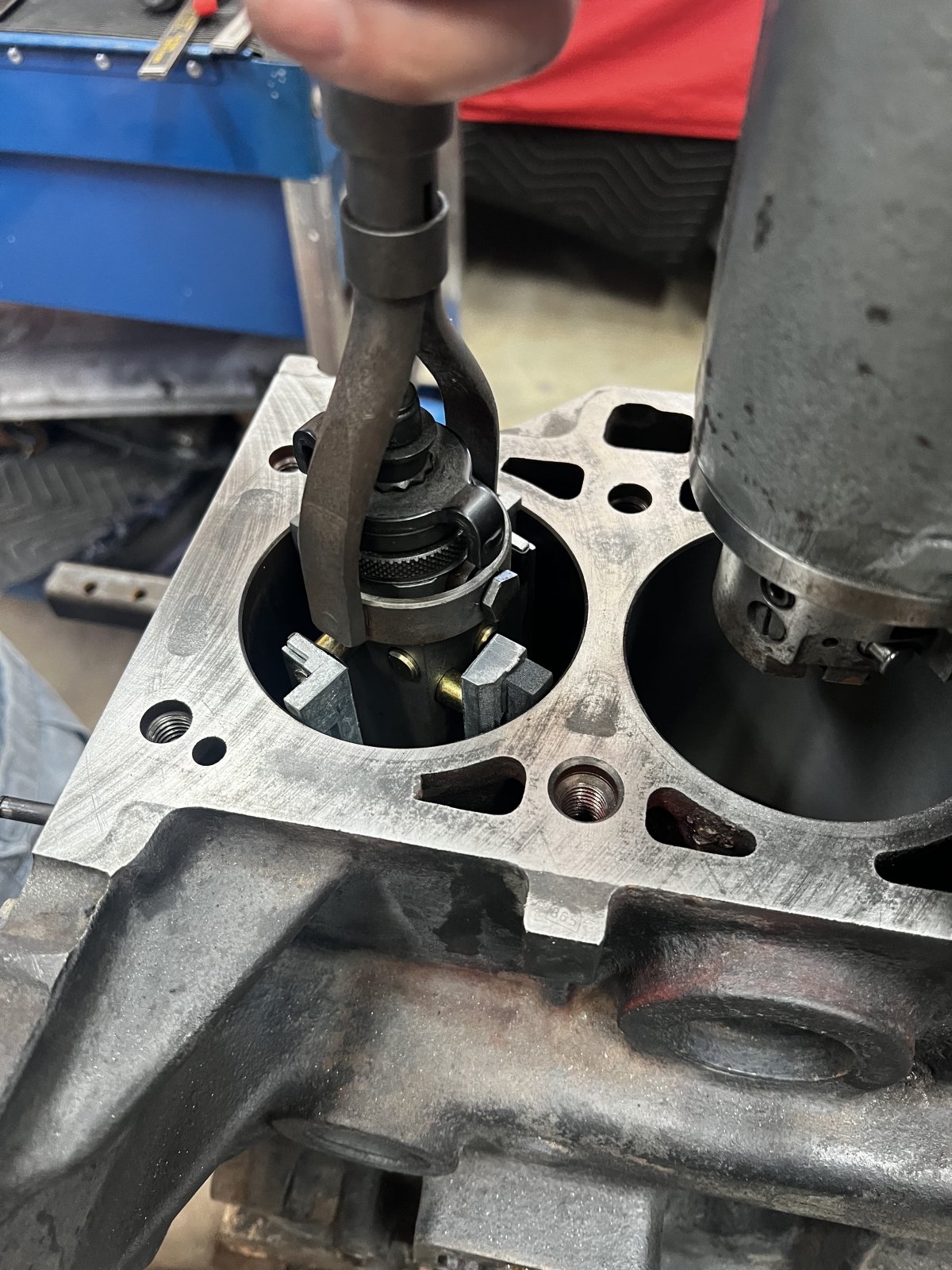

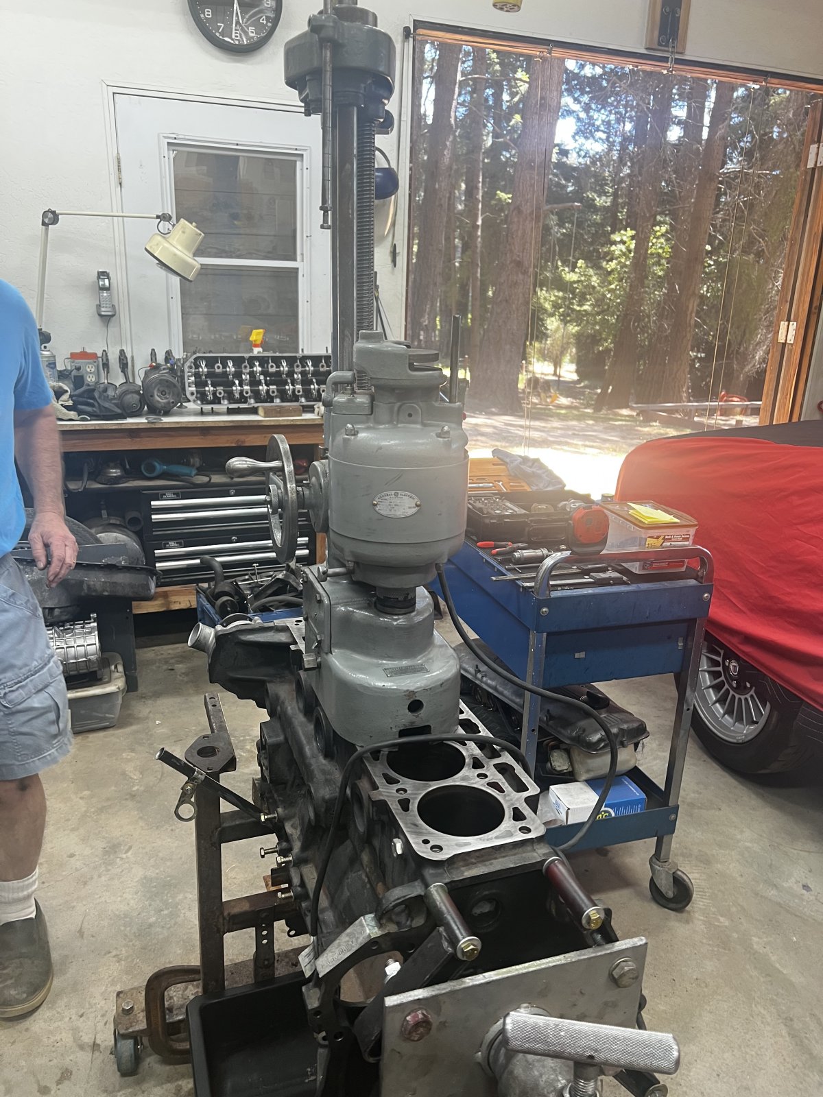

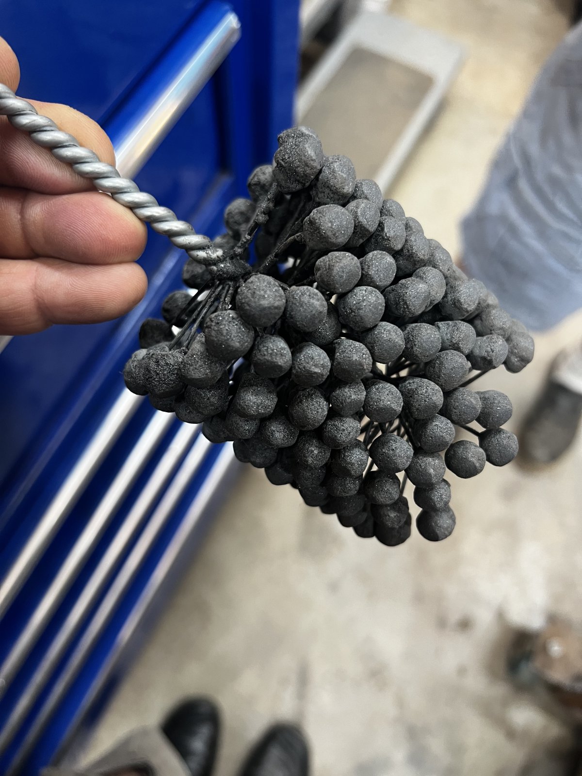

Getting ready to do some engine boring in the redwoods on a 1938 Kwik-Way boring bar. Shaved off 10/1000ths of an inch and got the biggest score mark out. 20/1000ths takes us to the first overbore size piston, 89.5, so that’s what we’re gonna shoot for.

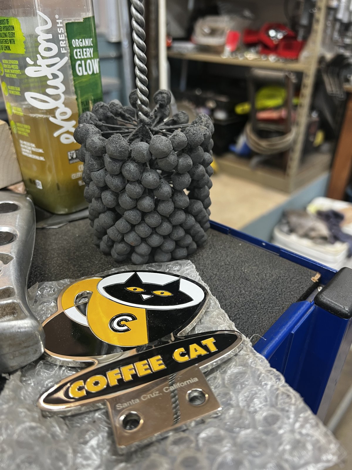

Some honing and polishing tools. It was all new to me, but presumably many folks here are familiar with all this equipment. Pretty cool.

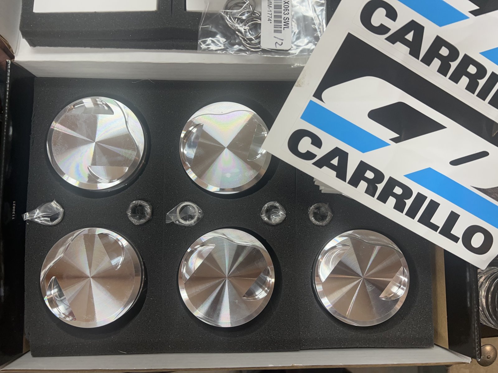

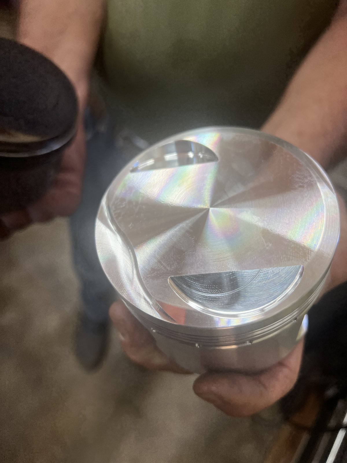

These things arrived boxed like an iPhone LOL. Never seen that before. 9.5:1, because that’s all that was on the shelf. Really nice pistons. Really nice.
