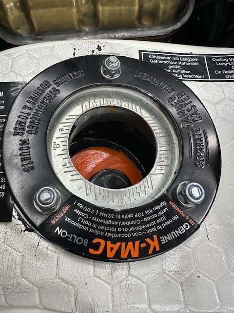

I checked with Koni about rebuilding the units that I had taken off (part number was slightly different: 82P-1667 stamped as heavy turn) and they referred me to their approved re-builder. The re-builder in Sonoma CA quoted $450 per unit, plus any hard parts that might be damaged or too heavily worn. Unfortunately it just does not make sense to go that route.
Bilsteins ordered for the front, will worry about the back when I do the full tear-down. Meanwhile I pulled the driver's side (side with the problem apart and removed the strut.
I did reach out to Koni again this morning and this time they responded quickly. Their reply:
"Thank you for contacting us here at KONI NA. Unfortunately, the KONI Sport shocks for the BMW 3.0cs are no longer available as they have been discontinued for several years now. The old part numbers were 86 1667 for the front strut inserts, and 80 2092 for the rear shocks. "
@Breiti, did you buy them new recently? If so, were these the part numbers?
I bought them newly last year, but that source isn't available.
Breiti
Thanks guys, I received the Bilstein struts yesterday and started to fit today and will stick with them.
The blue books say to add 50ml of oil to the tubes to aid in heat dissipation. I did add the oil with the last set of inserts and I drained the oil and re-filled before inserting the Bilstein inserts and found that I was unable to bottom out the struts with the oil in place due to the flat bottom construction of the struts (hydro-lock). I was able to install the struts with the collar nut at the proper torque without oil in the tubes.
I imagine that strut construction has evolved sufficiently that oil is no longer needed.
I finally took the coupe out for a test drive with the new Billstein strut inserts. I am very pleased with the ride quality and the noise (banging on the left front) is gone.
