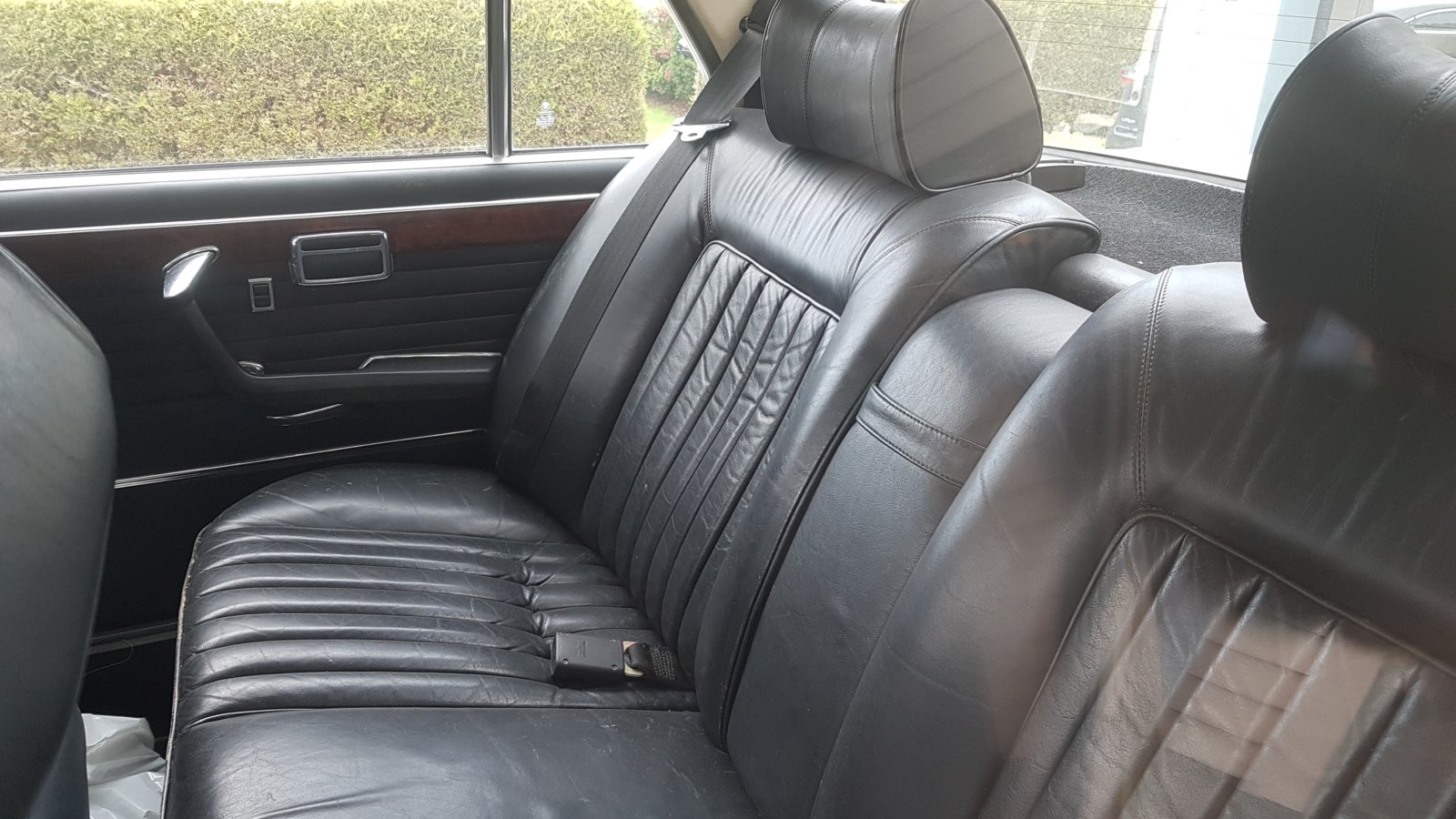

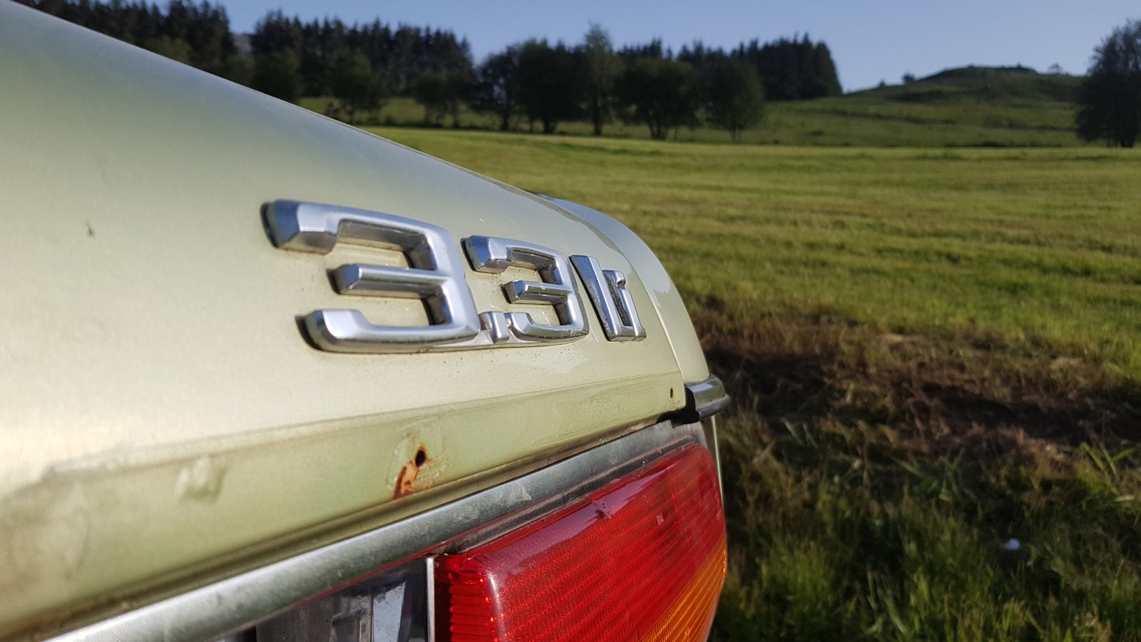

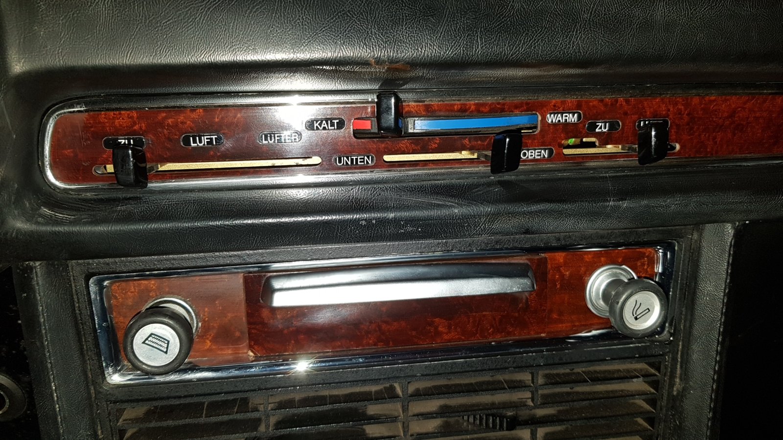

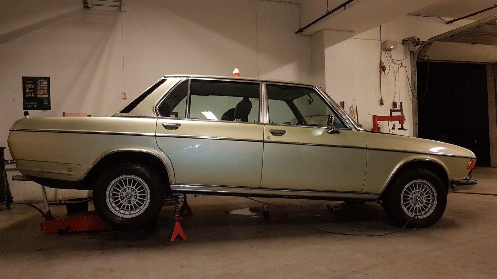

I am in the early phase of restoring a 1977 Reseda green 3,3Li. Black leather. Has been left in a garage for 15yrs.
Status:
-Almost complete
-Seized engine
-Body rust of course
-Paint is cracking
-Seats reasonably good
Will post more info later

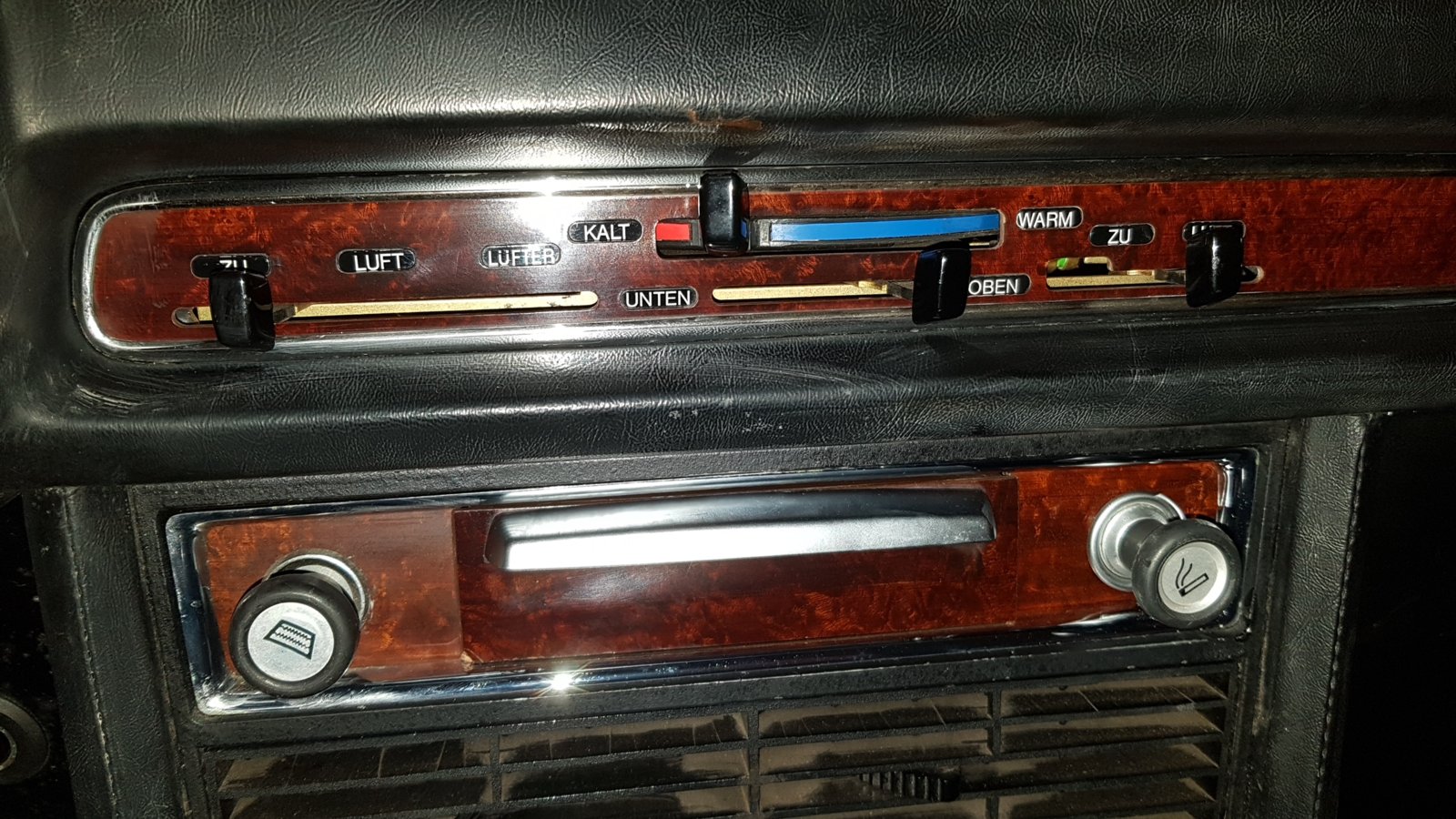

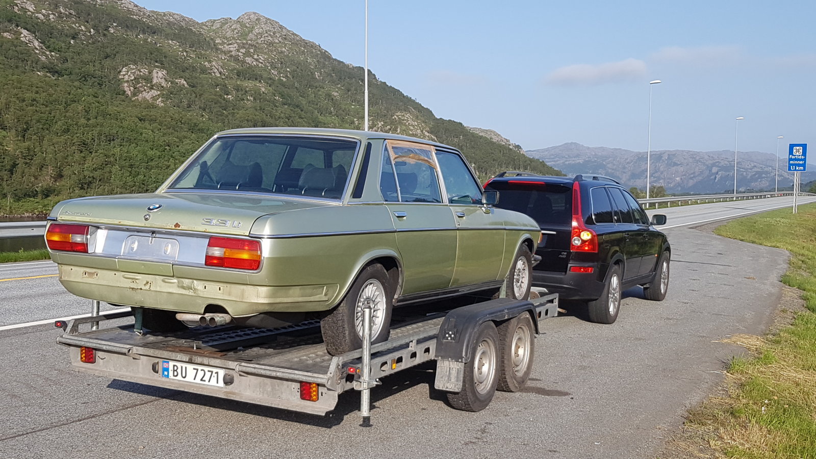

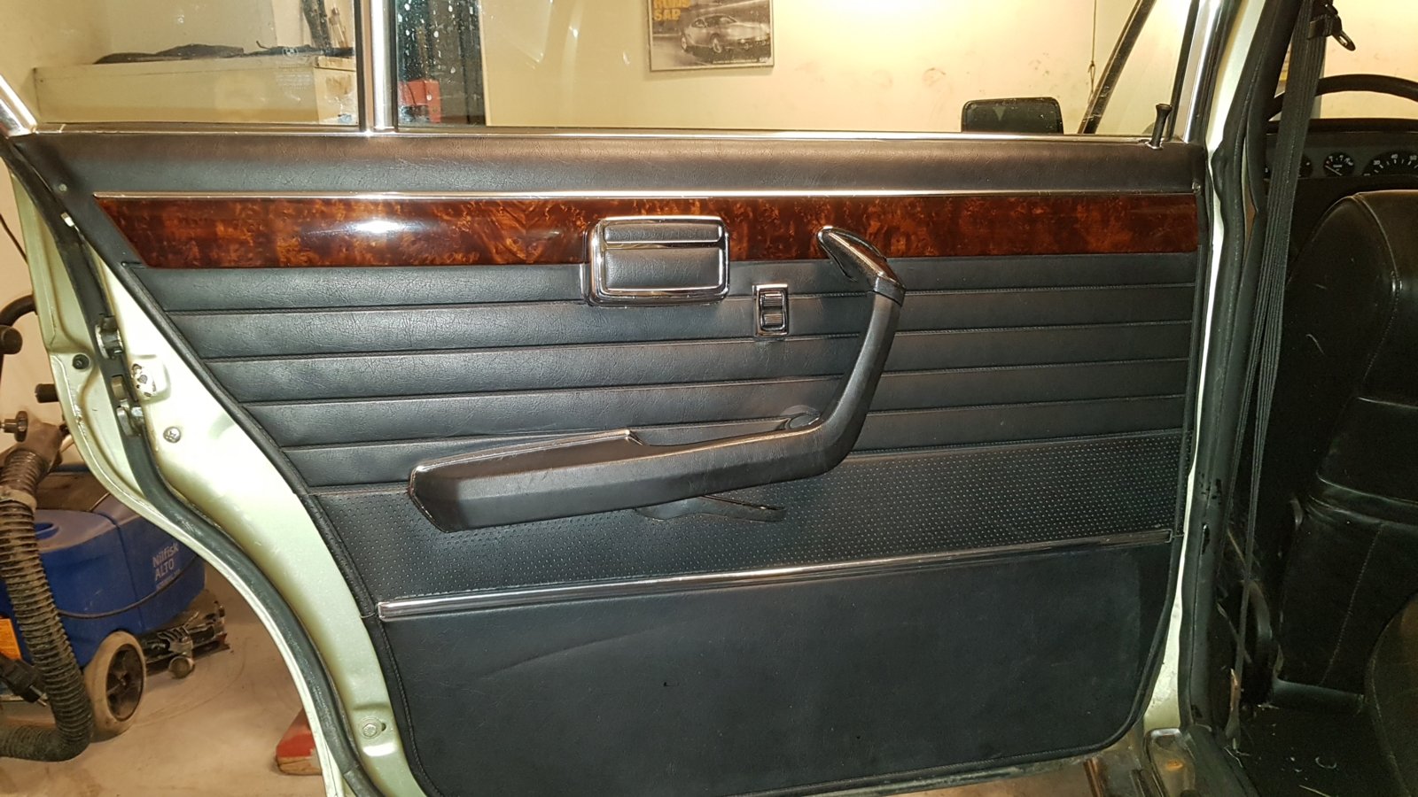

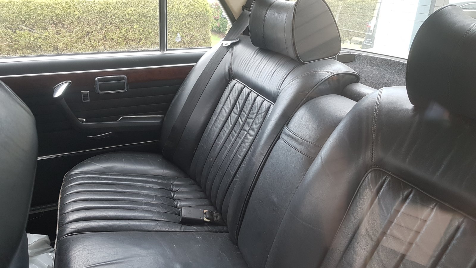

Some pictures
