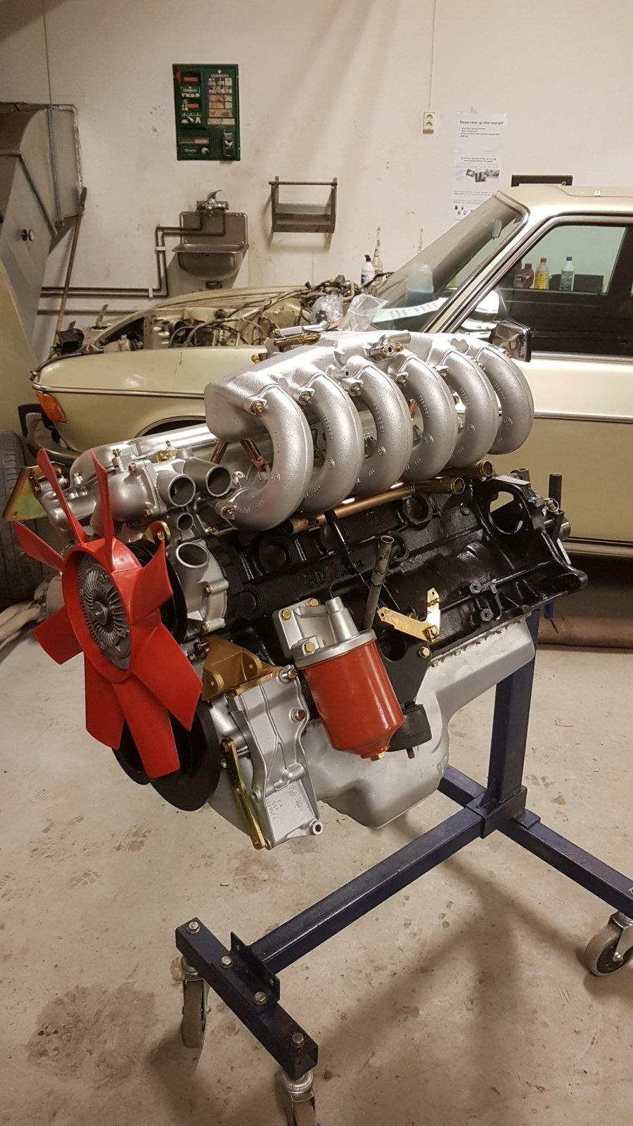

Some more engine work. Too many engines and too little time.

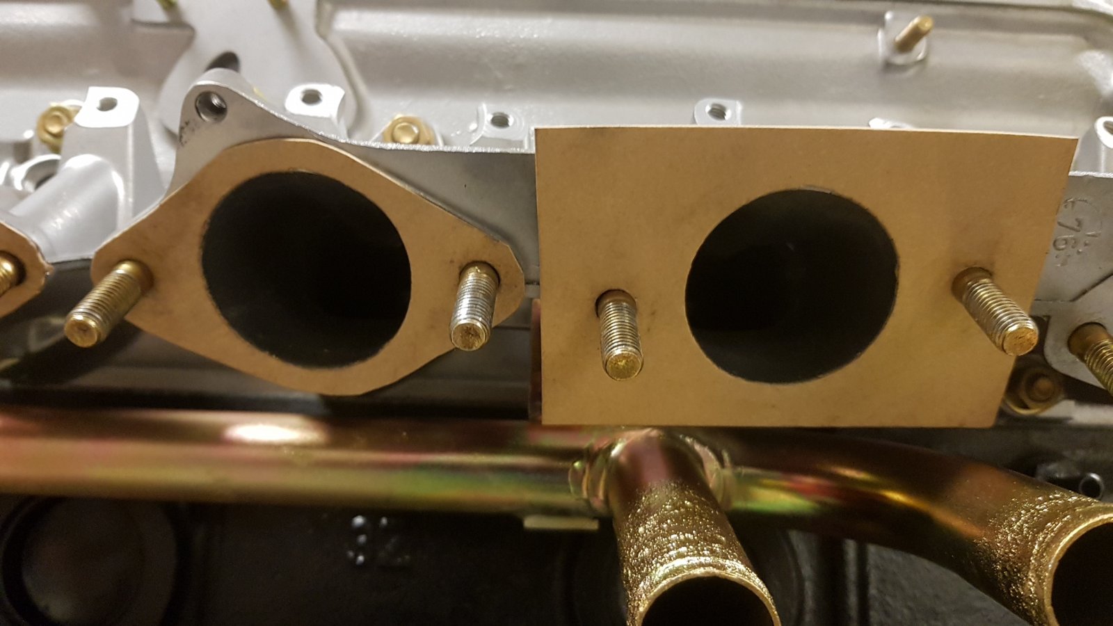

43 years old screws, replated and looking like a golden necklace. I love the old-style look of yellow Zink.
Test-assembly of cooling fan. Looks like a war bird just missing the wings.

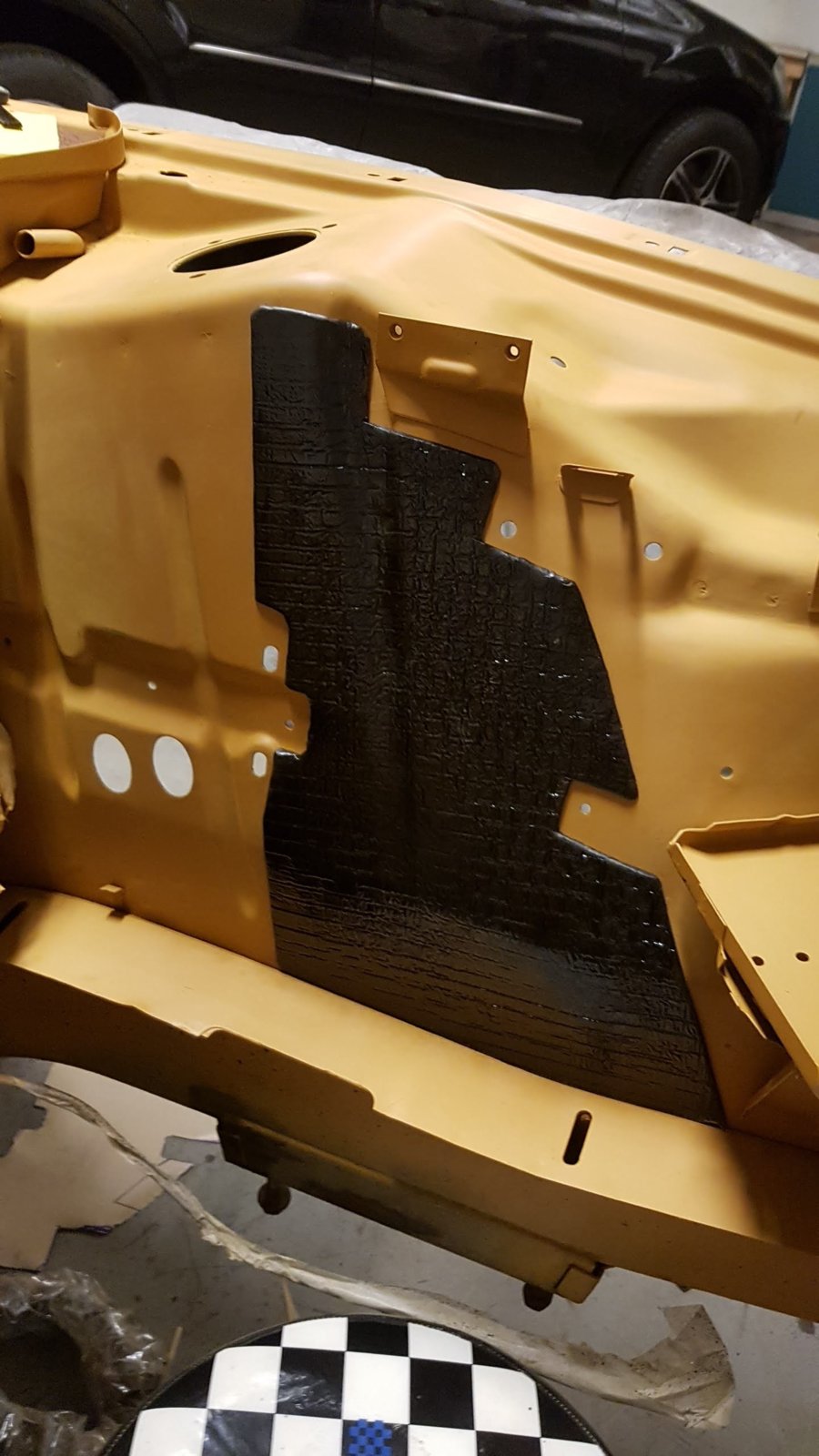

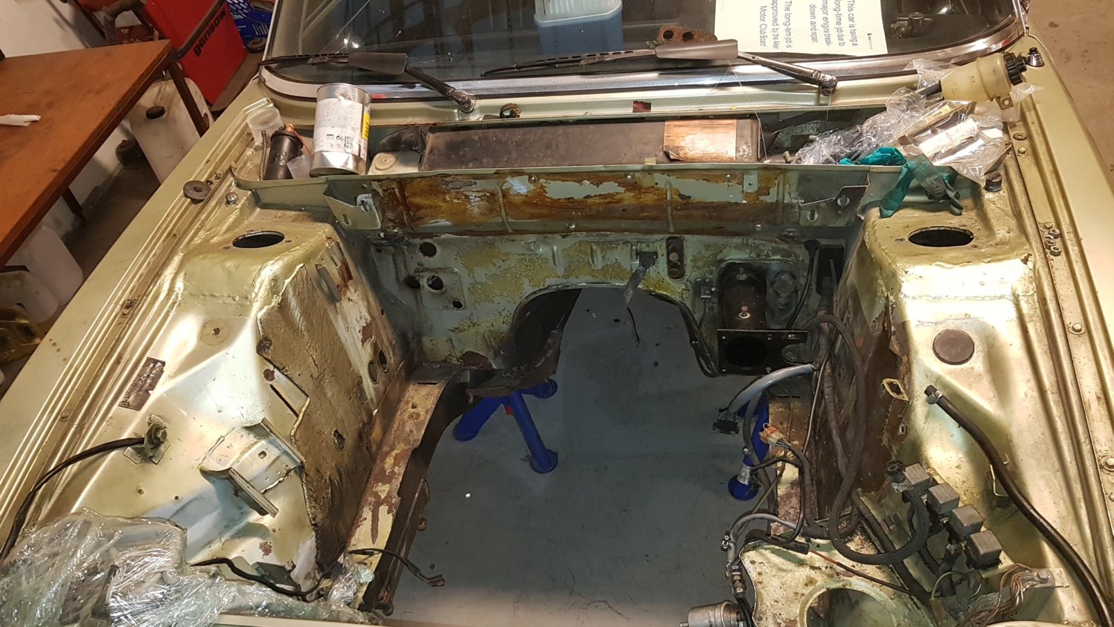

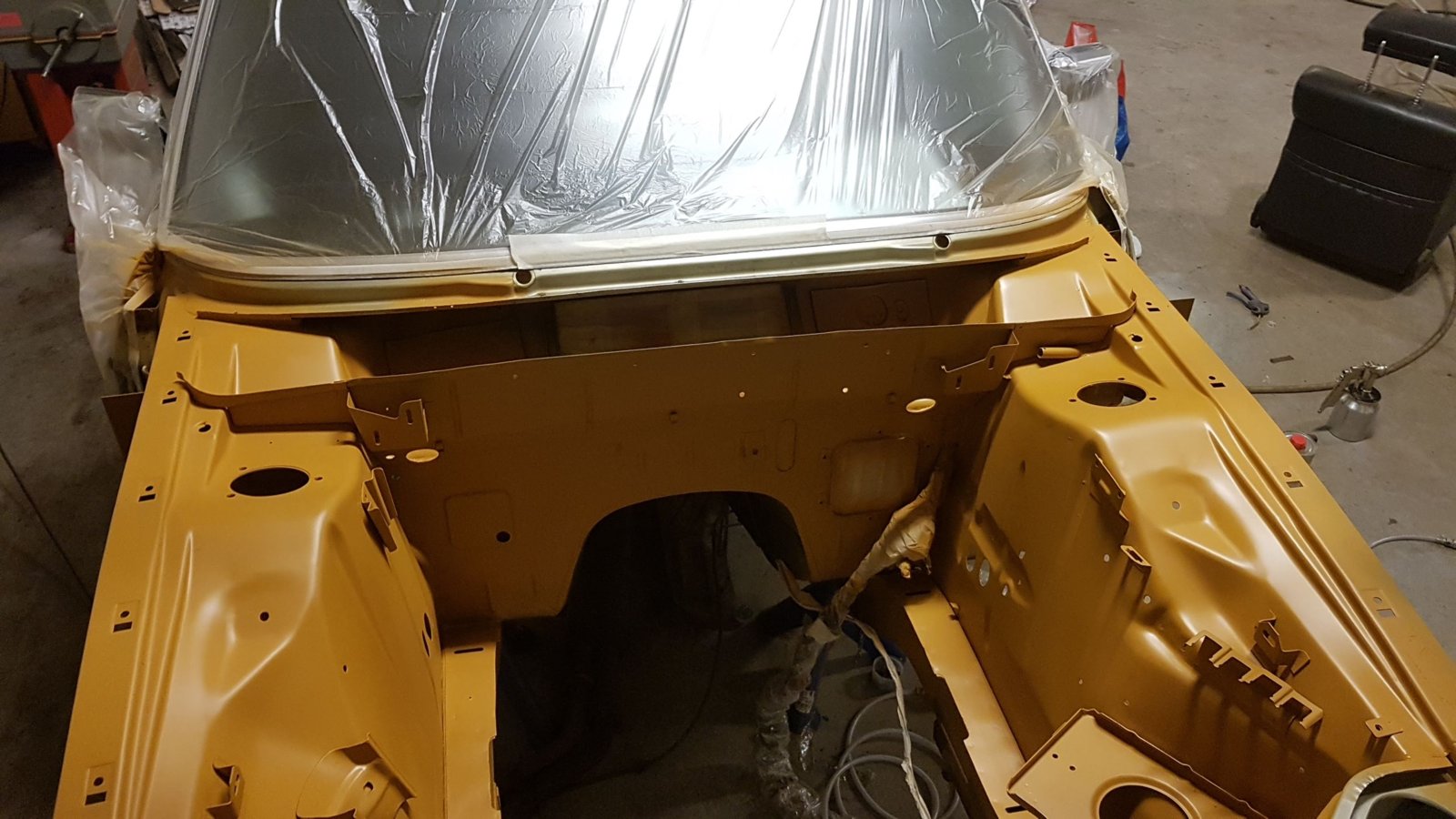

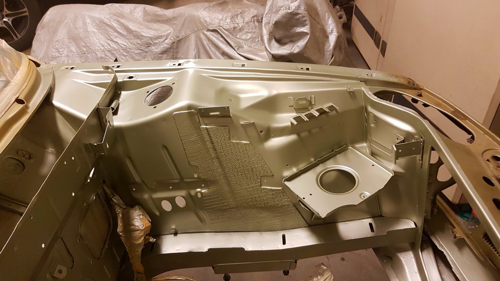

I have spent a lot of time lately on preparing the engine bay for the shiny restored engine.
Before:
During work:

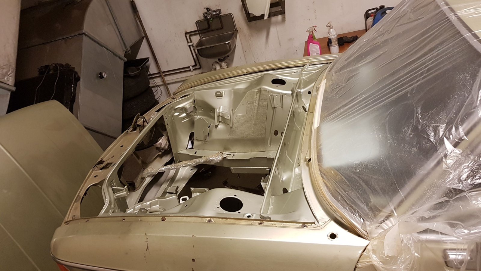

Primed with epoxy primer

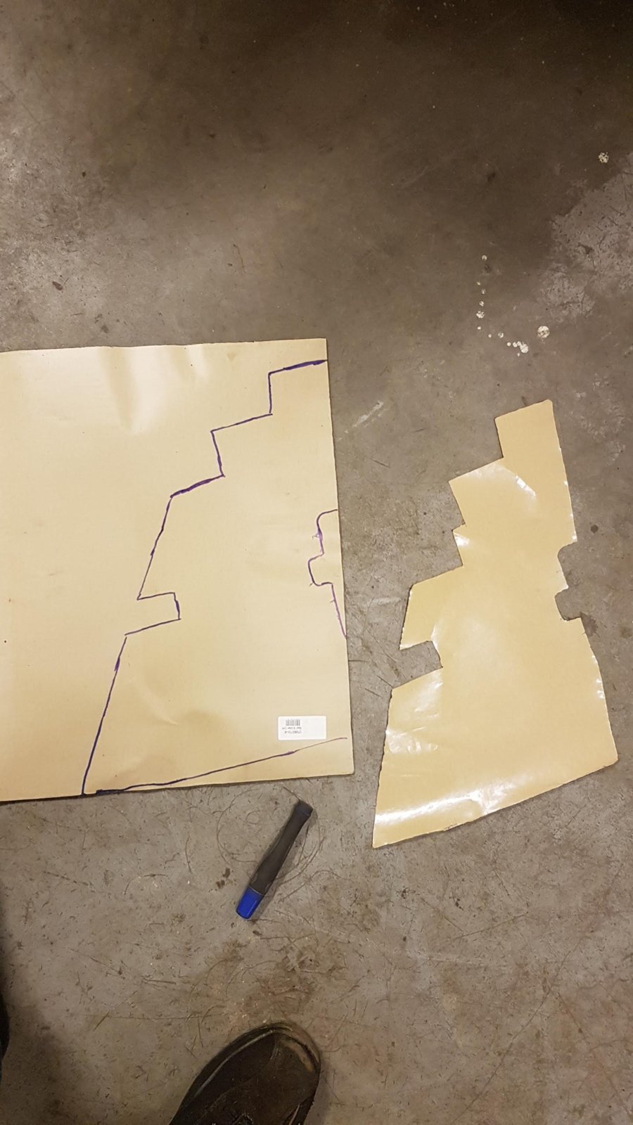

Cutting some vibration-damping mats.
Painted.
As you can see, the rest of the car paint is both dirty and yellowed by age, so it does not match very well. It will need a total repaint later, so I do not care so much about this right now. The important part was to fix the places that cannot be painted later when the engine is back in place.

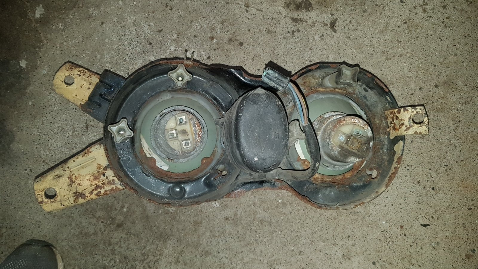

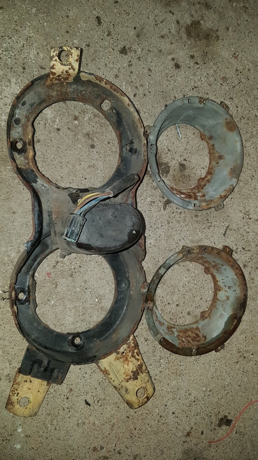

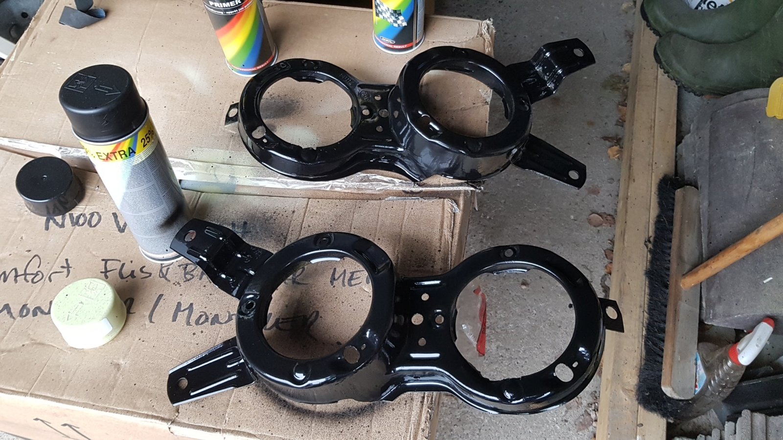

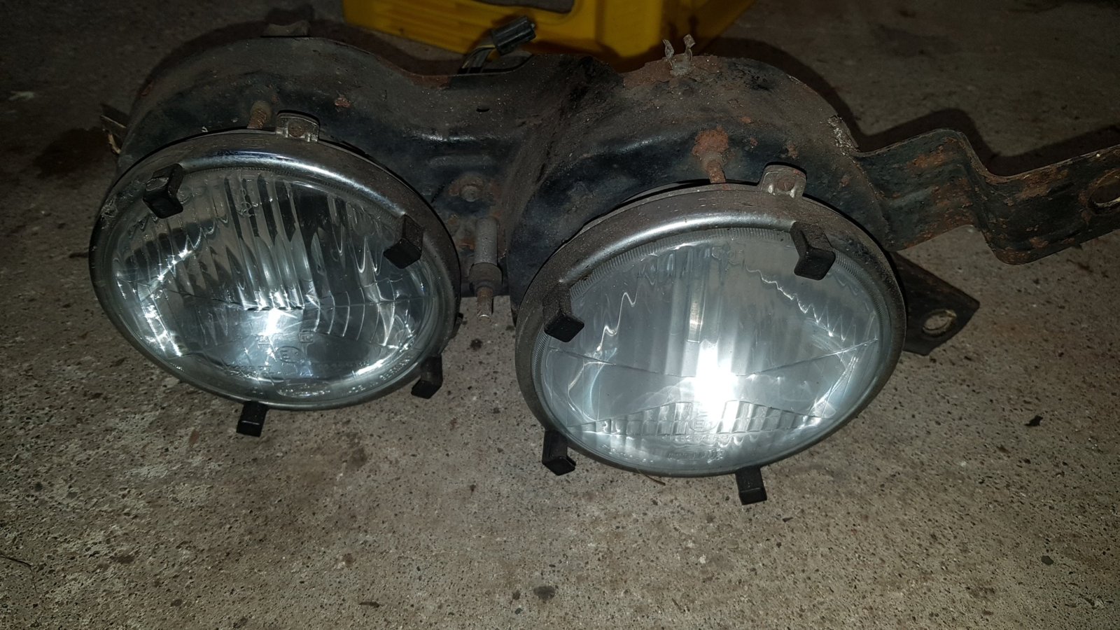

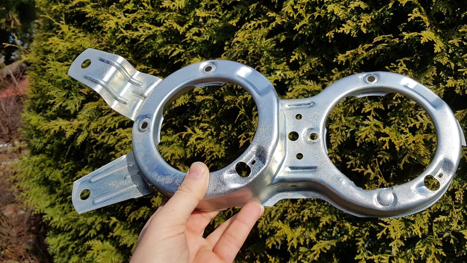

Now I have started restoring the headlamps. They were in typical bad condition with rusty frames and fittings.

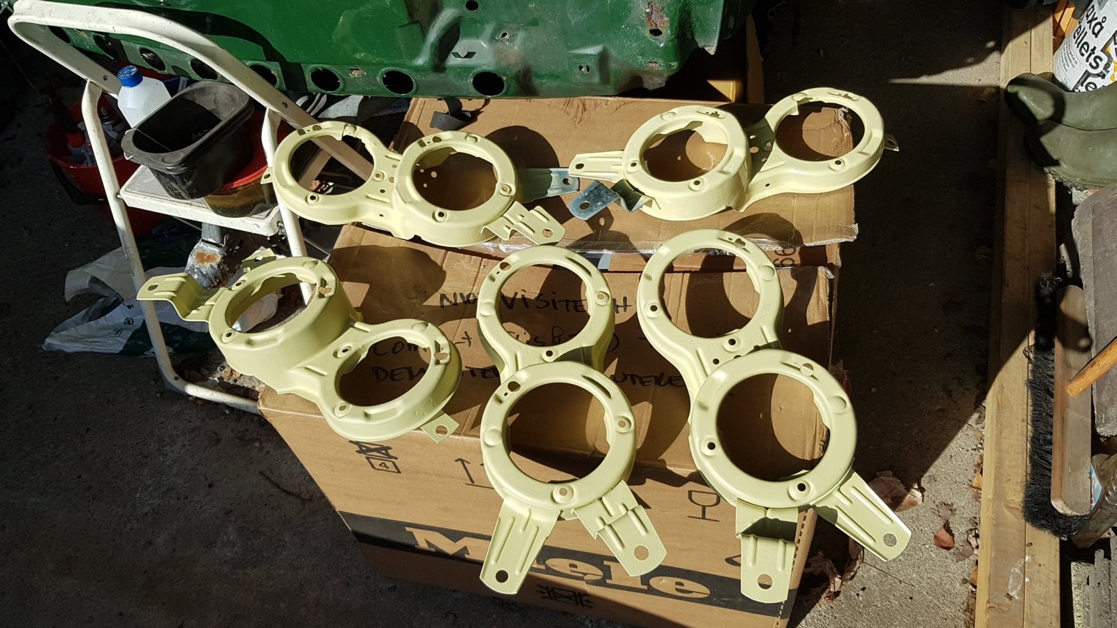

The frames and reflector cups were all blasted and then electro-zinked.

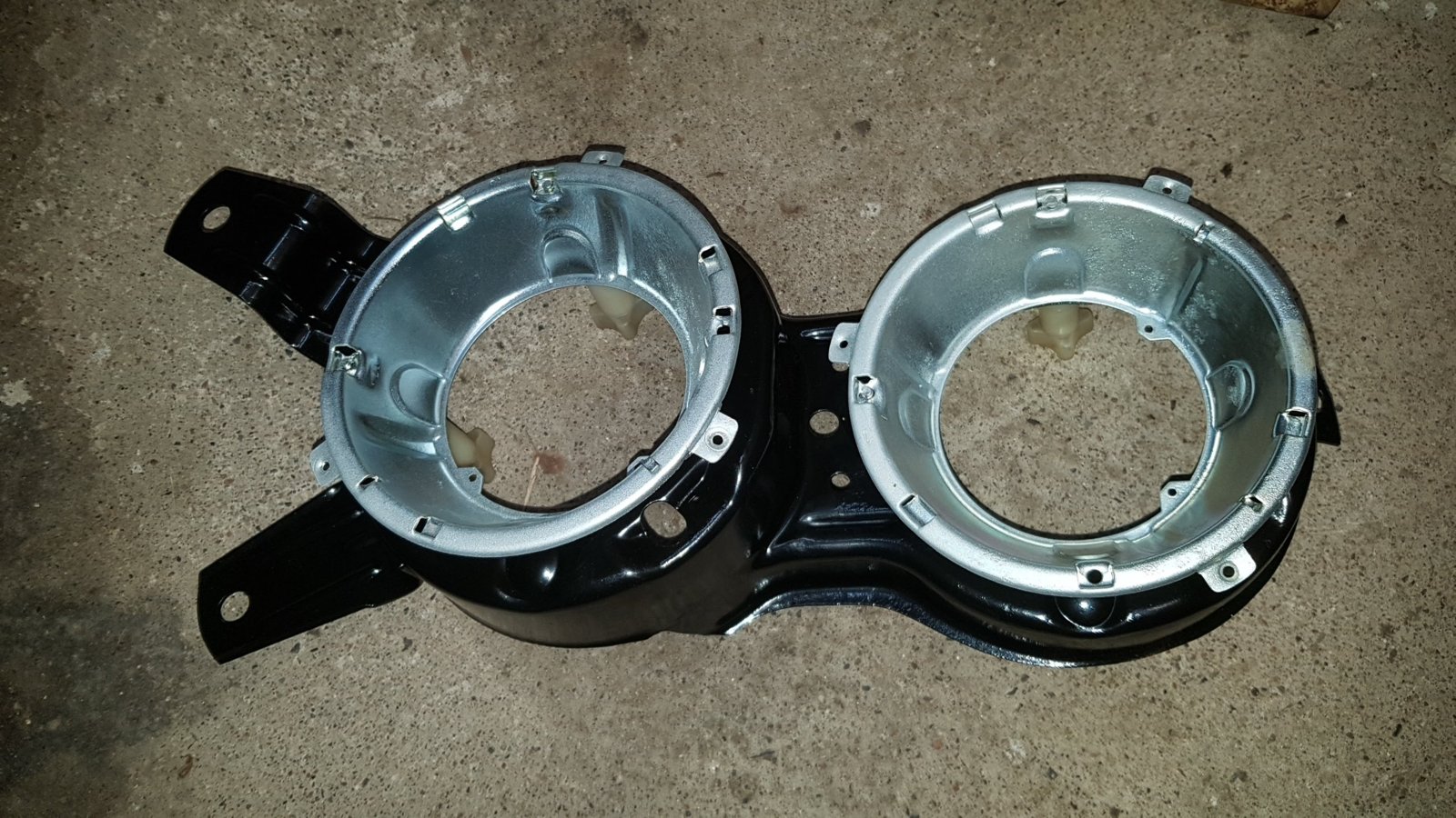

Then primed and painted
Not quite finished yet, but moving in the right direction.

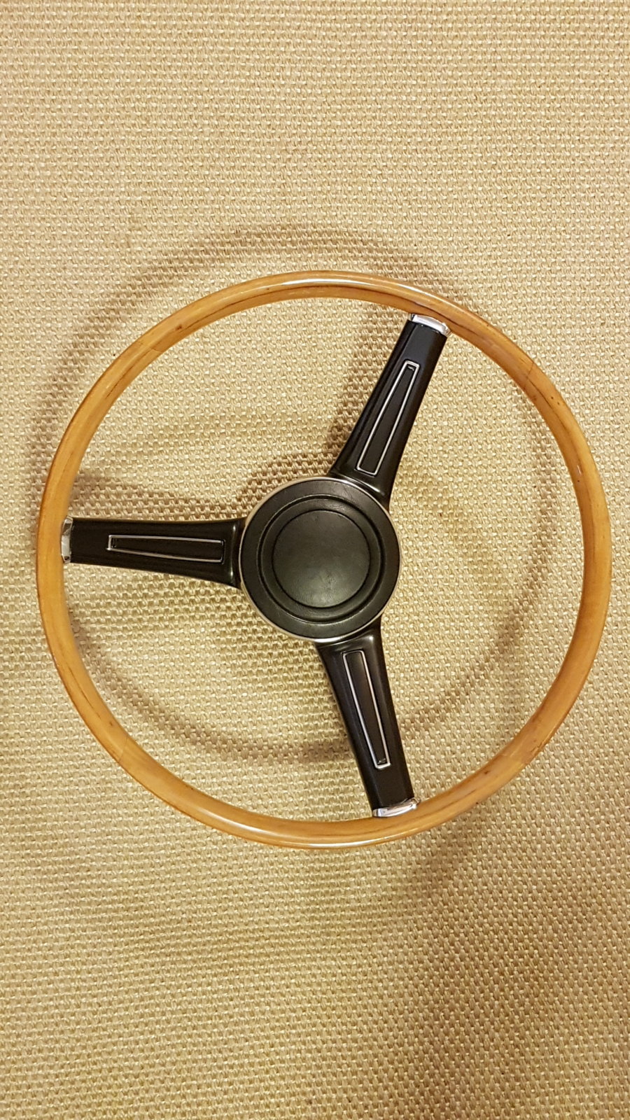

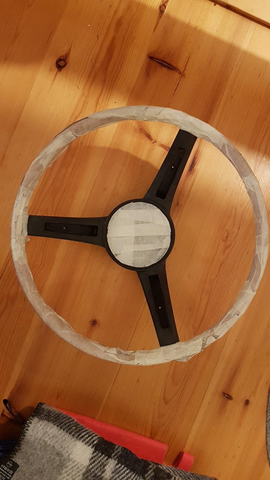

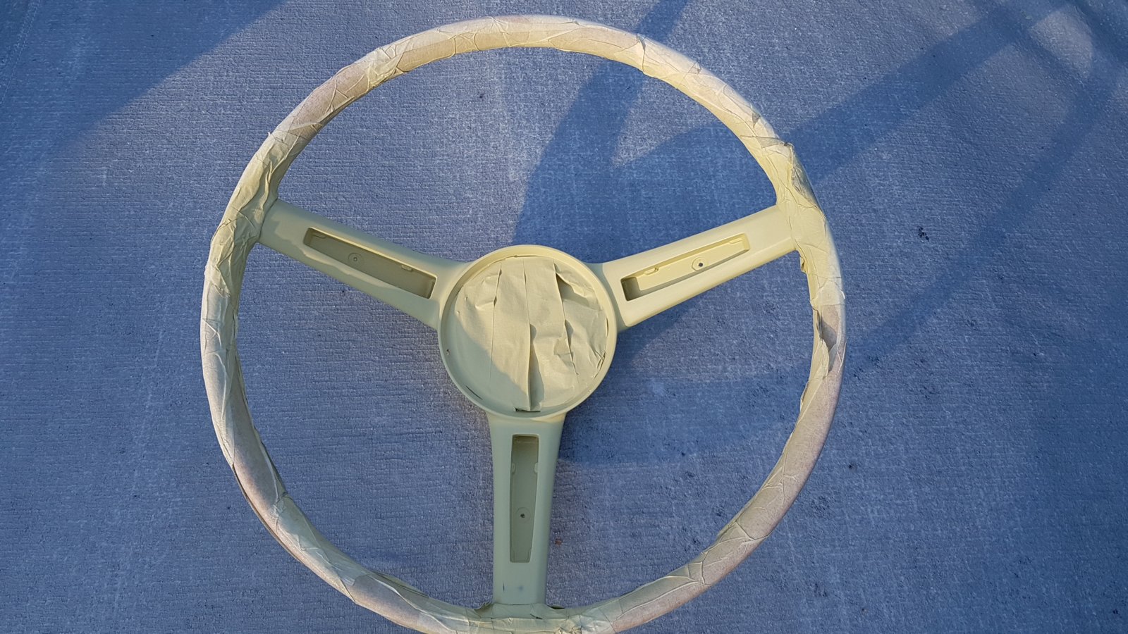

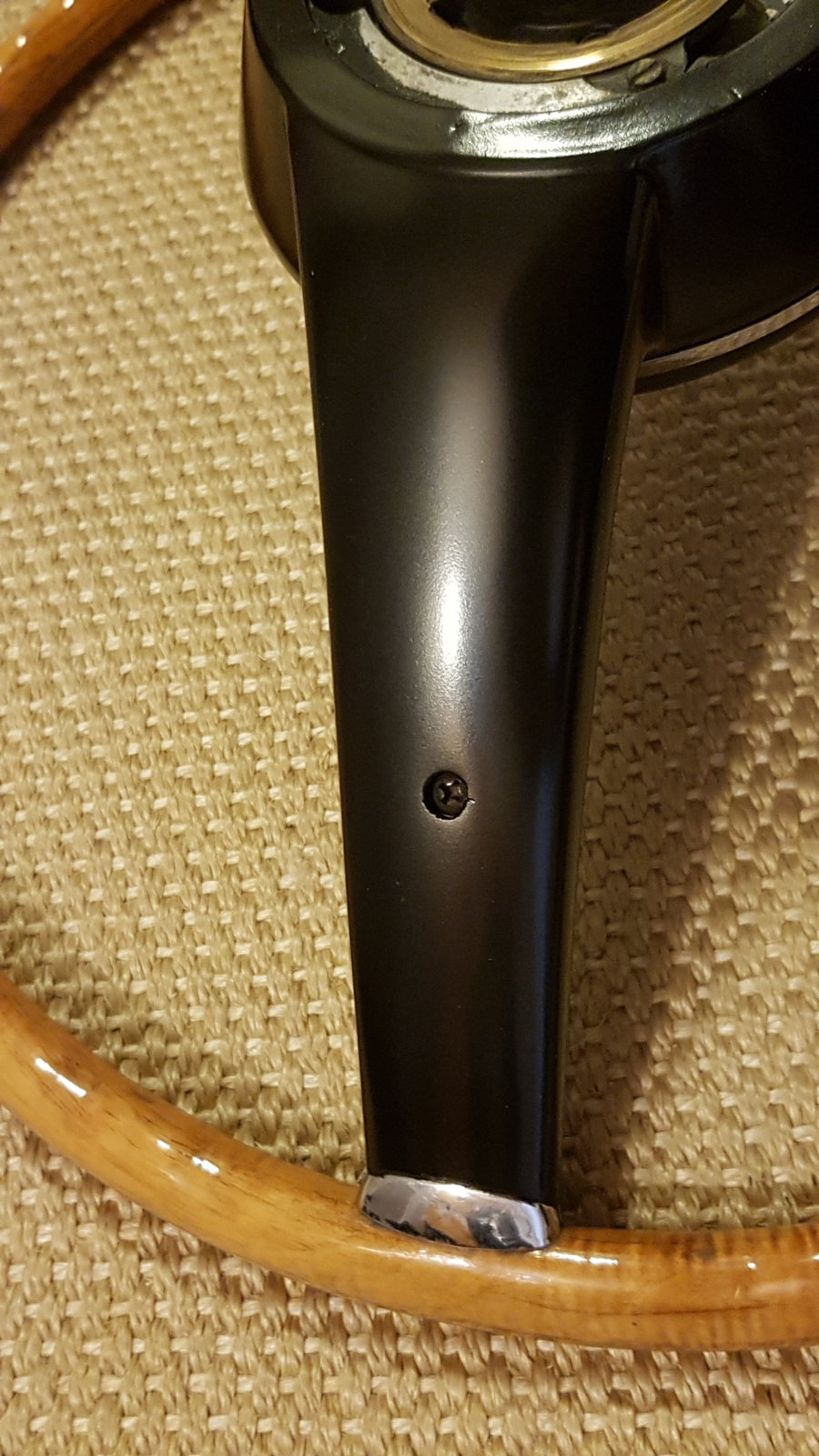

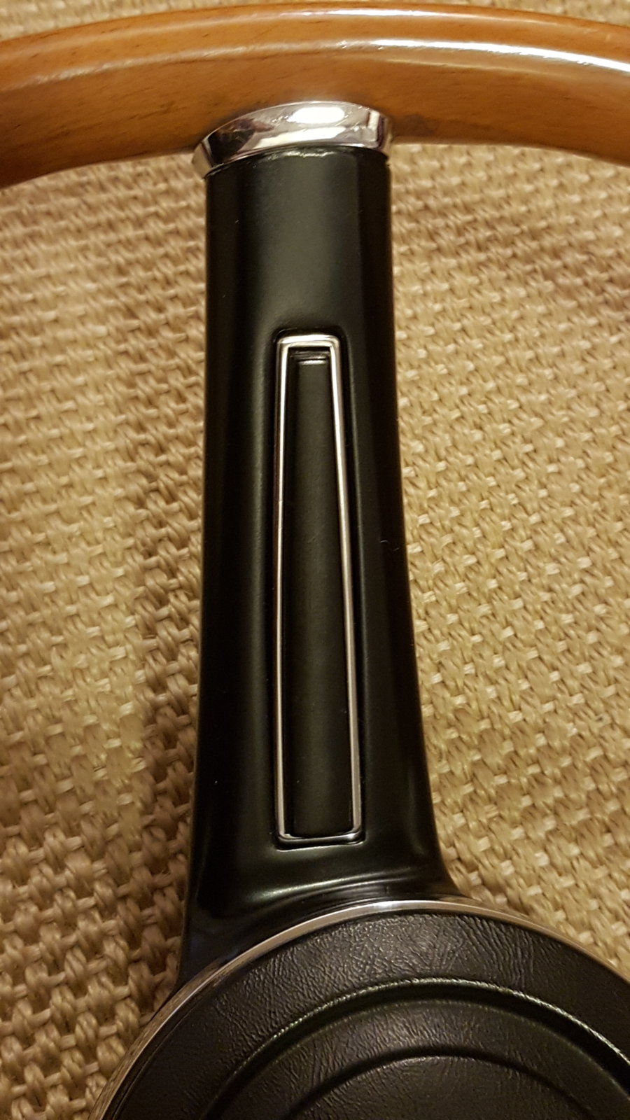

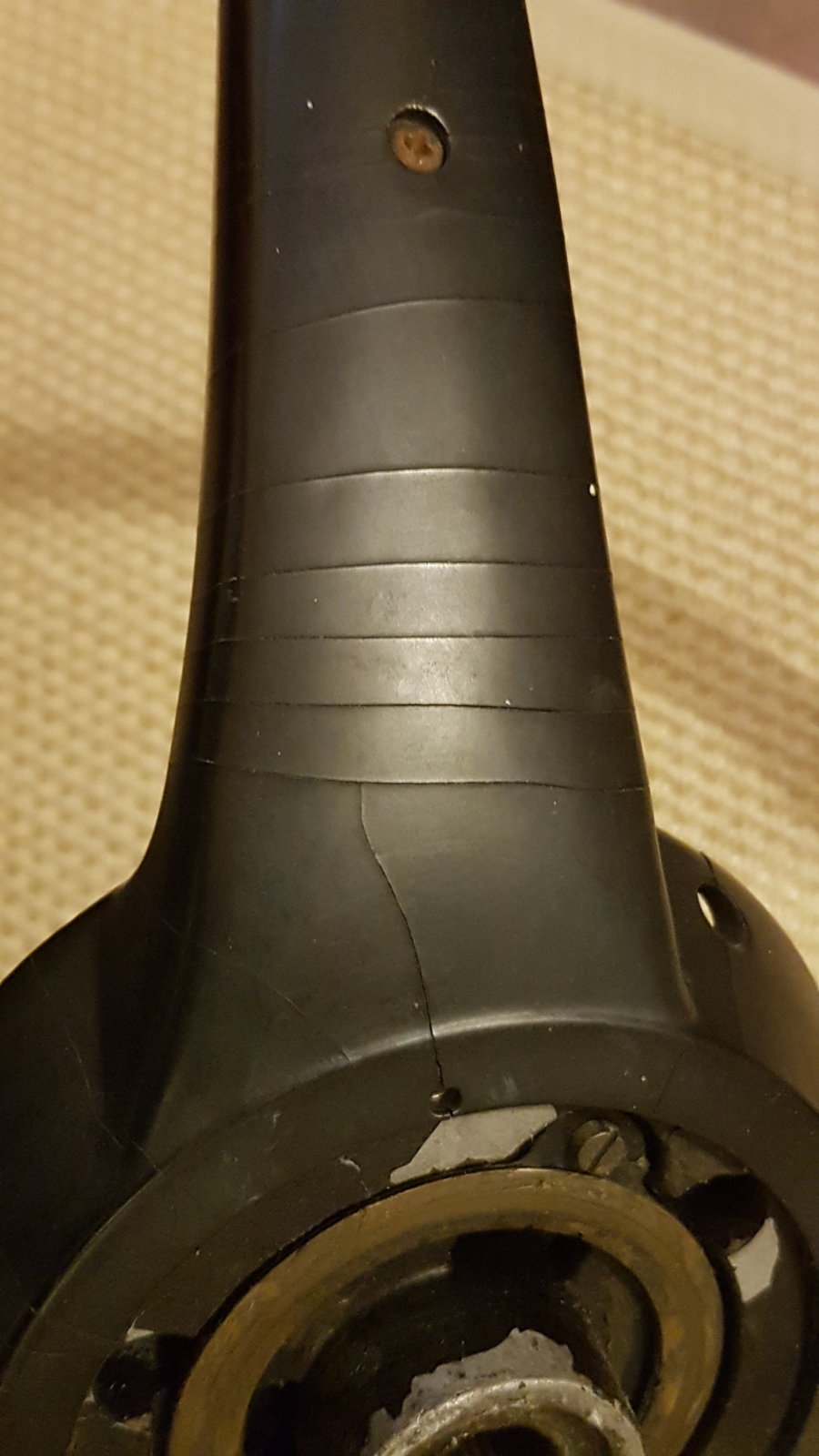

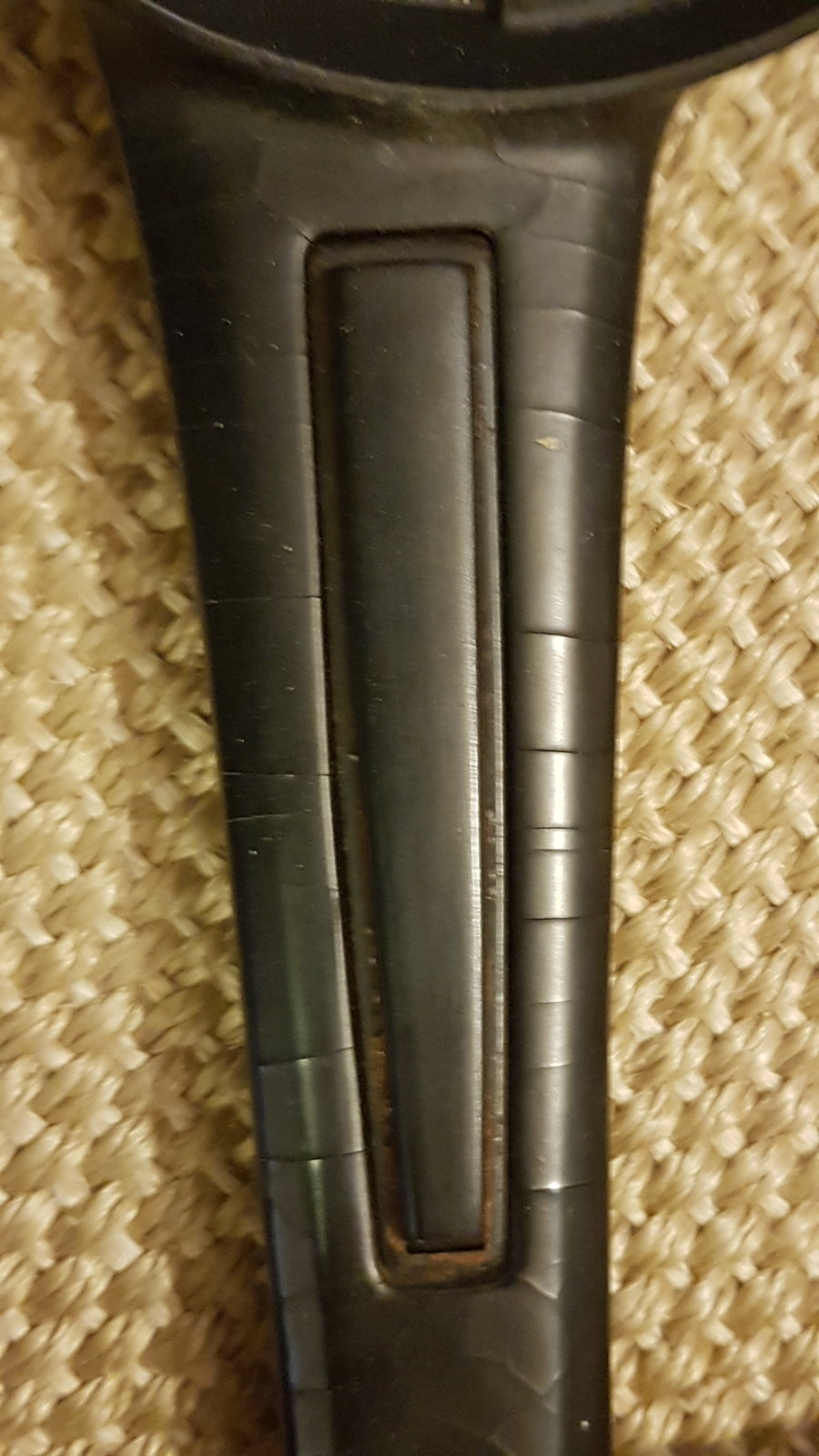

I have also started to restore a wood steering wheel. The spokes were quite badly cracked, so I have chosen to dismantle the horn buttons, fill the cracks and paint the spokes.
This is how it looks after sanding the spokes.

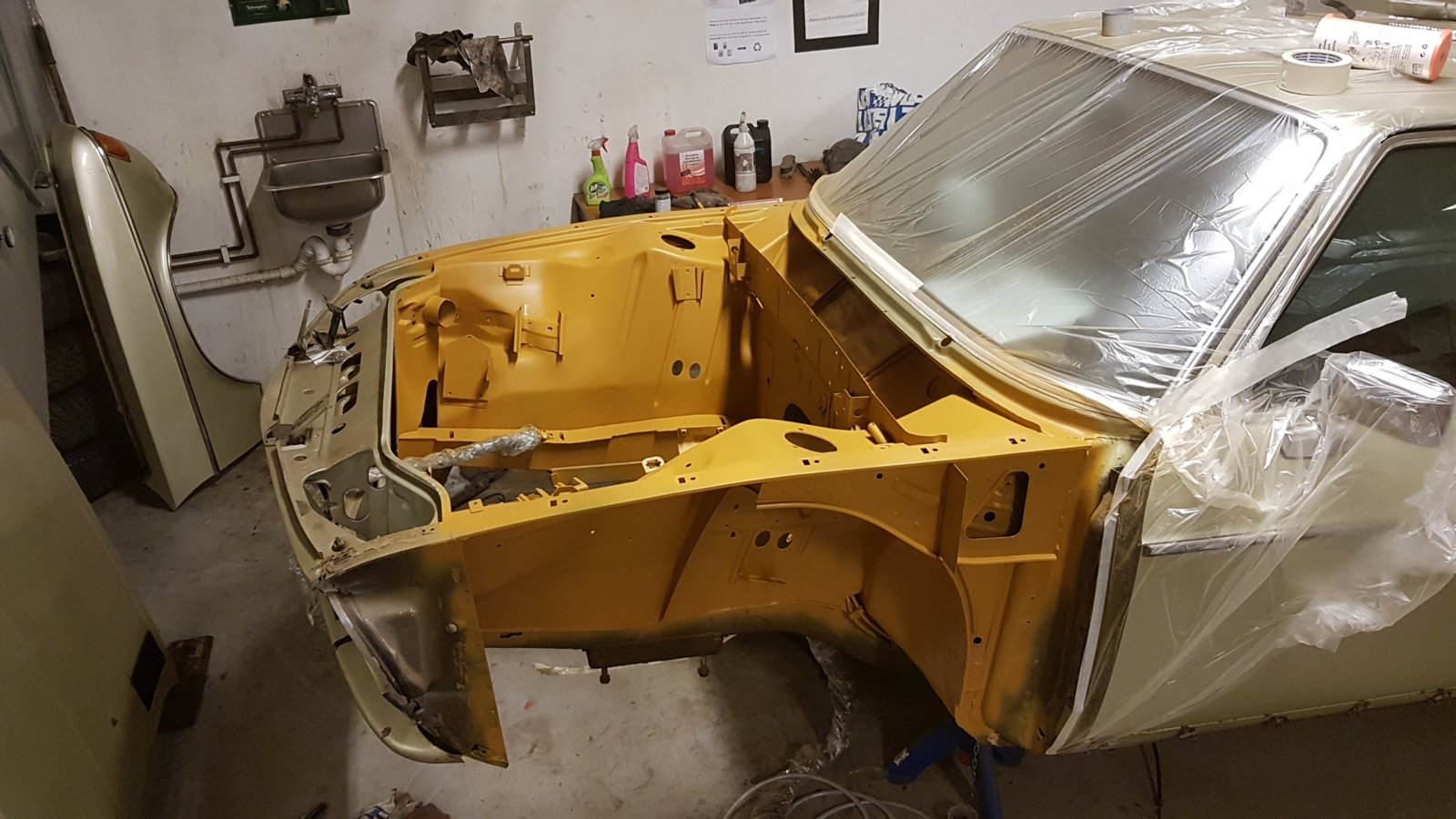

Did you do the body work on your shock towers? I'm assuming you used some filler in the welded areas? Looks fantastic.
20200819_233634-jpg.100995
Thanks for the nice comments. Yes I did the bodywork. Not so much body filler. New steel panels. The old ones were rusted and deformed so I welded in new ones.
