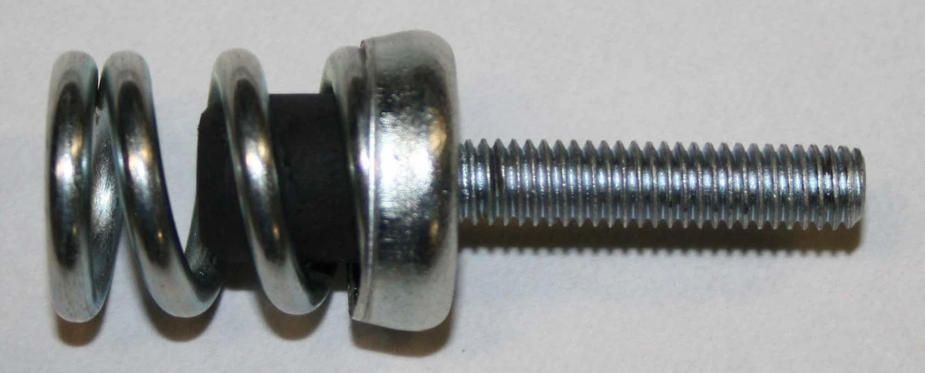

Yes i have sardines now installed and it will be great to make them new gears and new stoppers..., guys please are these bumps with springs usable? bezause it looks there is no much room for that rubber and that spring is too big i think.
