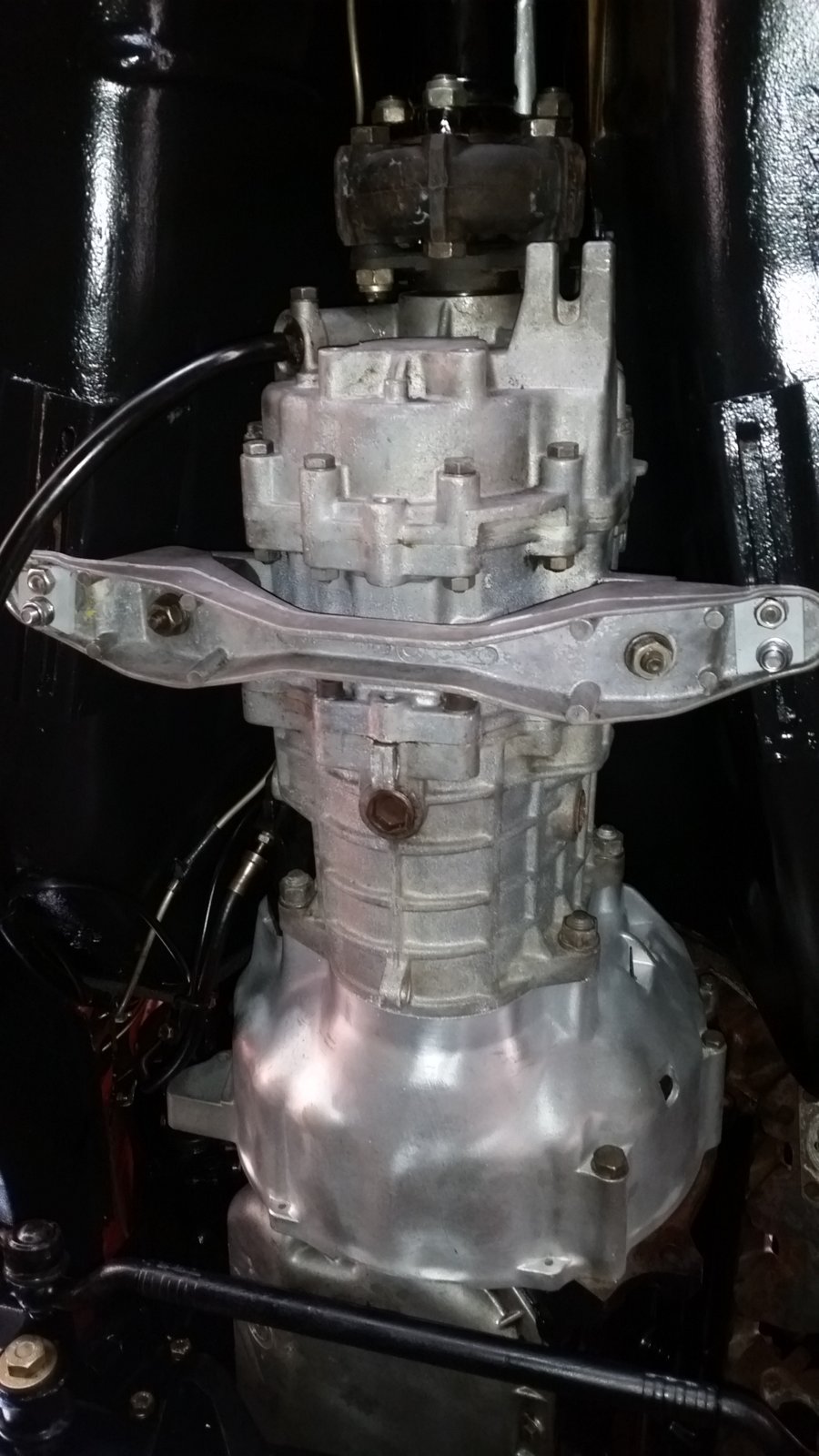

I'm gathering parts for the install of my Getrag 265/6 in my 2800CS and I may have ordered the wrong part for the transmission support. I now have the aluminum support, 23-71-1-175-731 instead of the stamped steel one 23-71-1-175-314.
I believe I read that the steel one is stronger. I'm keeping the stock 2.8L engine and I don't plan to do any sort of racing about. Will this part work for me (fit) and is there any reason to believe that it won't be suitable for day to day driving?
Ian
Ian - I have that part installed in my car now, primarily because I was midstream into my swap when I learned that the stamped steel part is preferable. It has not caused me any trouble, but I have not run my car a lot since the swap. Also, the nuts that hold it to the underside of the car are very close to the slots that allow them to be turned sideways and removed from the vehicle.
Because the stamped steel part is stronger and because of the way the aluminum part is installed, I plan to switch to a stamped steel support after I get her running again.

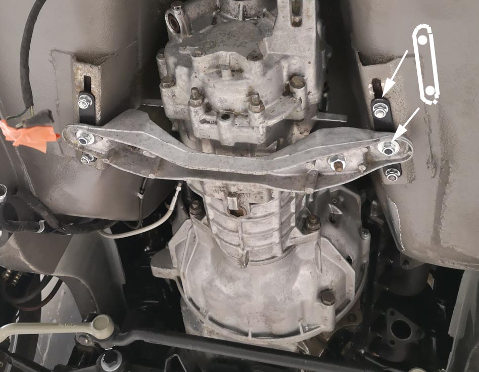

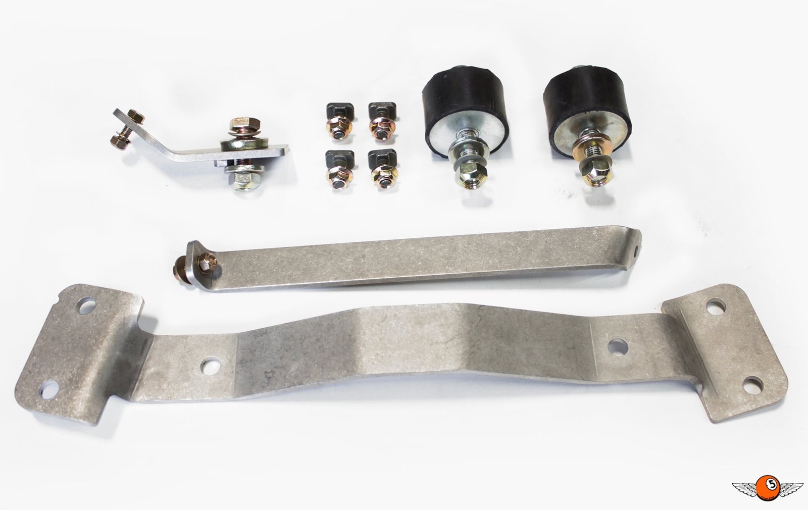

And since this thread has been revived, I'll update my comment on the transmission mount. I tried both the aluminum and steel mounts in my car. In both cases, I thought the the nuts that hold the mount (and hence the transmission) to the underside of the car are too close to the slots that allow them to be turned sideways and removed. I changed to the Coupe King mount, which is much better.
If anyone wants to go down the path of trying the inferior aluminum and/or steel mounts in their cars, you can have the ones I pulled from my car for the cost of postage. Just start a conversation.
Update Feb 9, 2022: Well, that was fast - my inventory of mounts is gone!
I fully agree that the CK mount is a way better and nicer product.
But for anyone looking to cheap out like me, another solution is to make your own mounts/adapters out of a piece of flat bar.
First weld a threaded rod/bolt without the head to the flatbar for the transmission mount (drill a hole in the flat bar, use a countersink drillbit to make room for a proper weld, then weld from the top side), then drill two holes at each end of the bar, that way you can have two bolts in the slot, far away from the opening in the slot.

If I understand your photo correctly, couldn't you accomplish the same thing by added a "washer" that secures with two bolts, one in the standard position and the other to keep it from moving. Like yours but without the extra bolt/hole.
In my case the transmission mount bolt was too close to the opening in the slot, so that didn't feel safe enough for me, but as with most things on these cars YMMV.
If the transmission mount bolt is a bit offset to the opening, a "washer" solution would be neater.

this is very nice if I knew this I wouldn't spend $350 on stainless steel bracket
sorry the price was $365 plus shipping from Coupking check the pix
