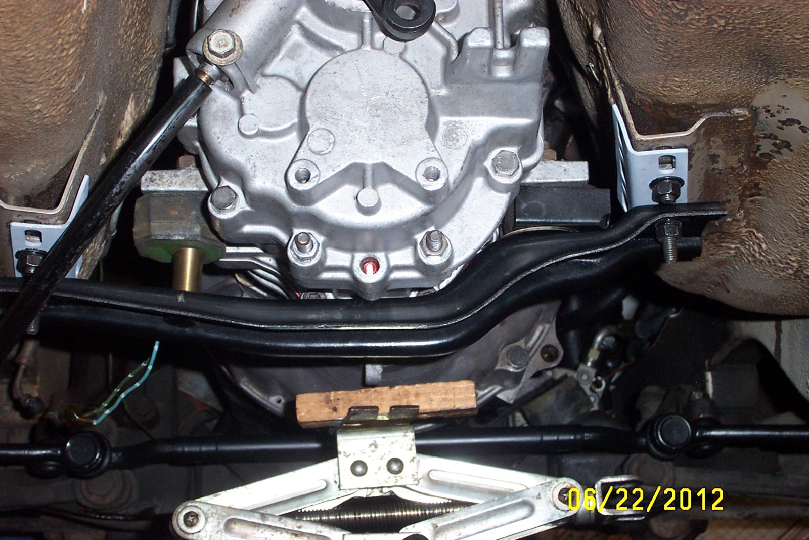

this is what I am using on my 2800cs on 5 speed gearbox I am working on it I have been told this is the best ever.
Several people have given the Coupe King transmission mount terrific reviews. It's well constructed and seems to fit better than either the stock aluminum or older preferred steel BMW mounts. It's also quite beefy.
