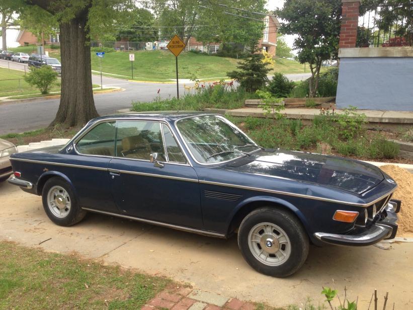

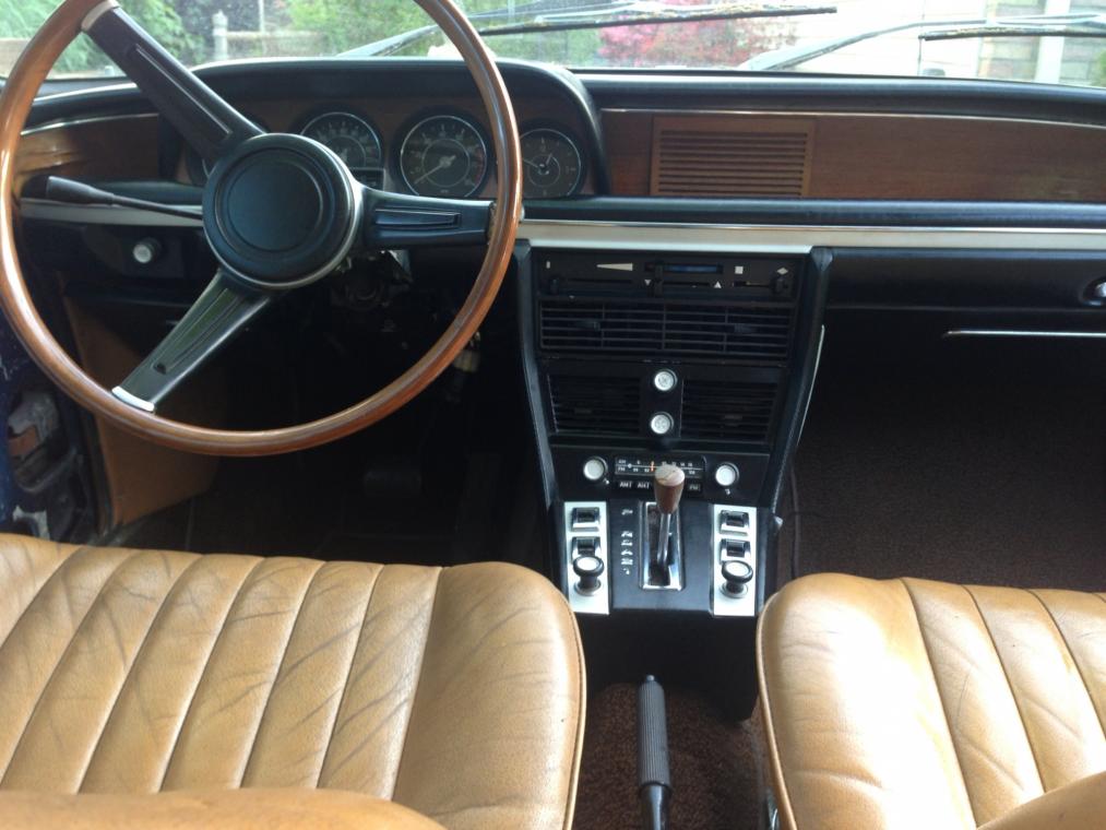

I am a current owner of a 1971 2800 CS with an automatic transmission. I am thinking of converting it to a 4 or 5 speed manual. I have always had a thing for manual transmission. I also beleive, perhaps incorrectly, that it is not really a sports car if it's not manual.
1 Would this lower the value of the car?
2 What's the big difference between the 4 and 5 speed. Pros and Cons?
3 How complicated is this undertaking?
4 Where can I buy a manual transmission for my E9 and how much will it cost?
Any help would be appreciated.

Thank you. I could use the exact location on that article. Who would be a good vendor to go to for a manual transmission for my E9 and how much would it cost. Again thank you.
