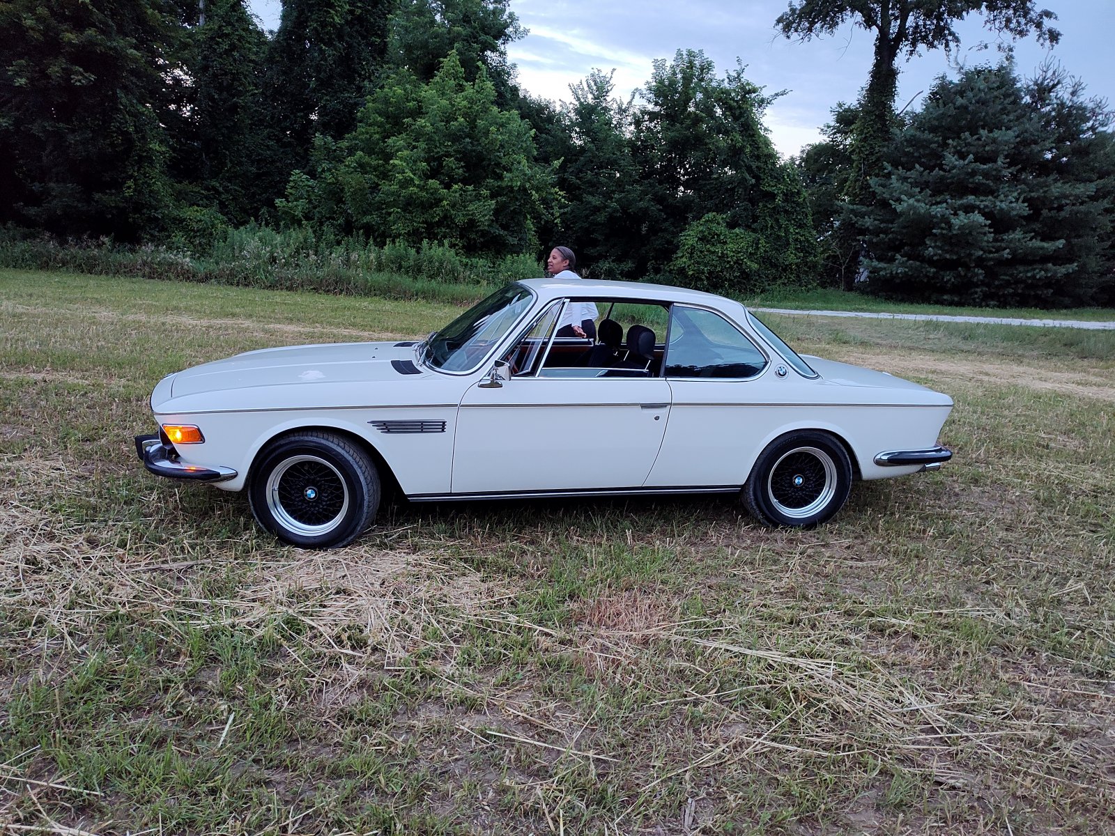

I own a 1972 3.0csi - VIN# 2260863 - It has the factory 4 speed manual.
What 5 speed is best fit... I've been told the 245 - 1980-1982 320i
Any sage advice is most welcome. My winter upgrade project.

Nice car, looks like one side mirror was installed in Europe and the other in the US when it was repainted...

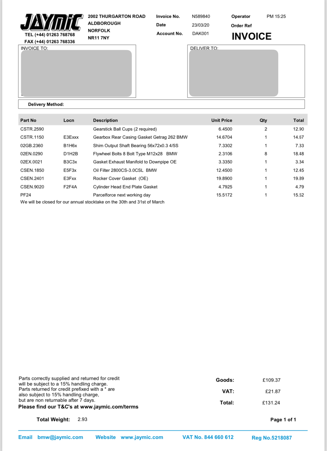

Here are some notes from my installation a couple of years back.
NB Jaymic are in the U.K. Just posting the invoice here to give you an idea of the bits you need
What you need:
Getrag 265 gearbox with speedo gear (and the bell housing!) - you will need the speedo drive from your existing 262
Invoice from Jaymic
See attached file - these bits were all needed!
