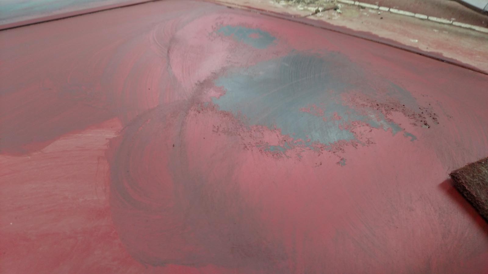

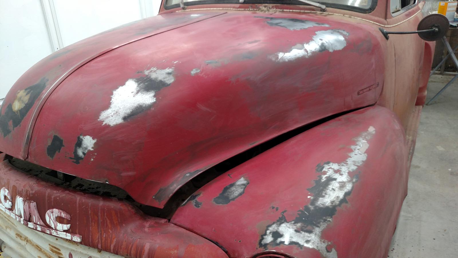

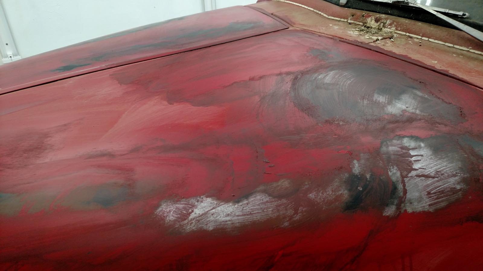

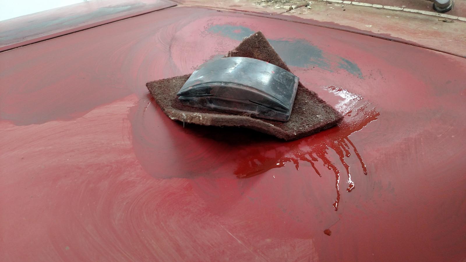

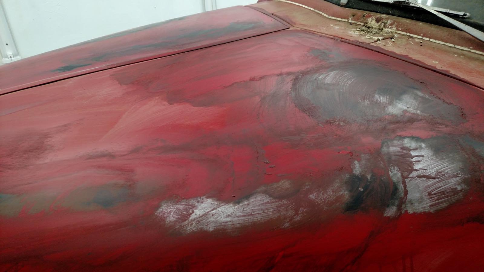

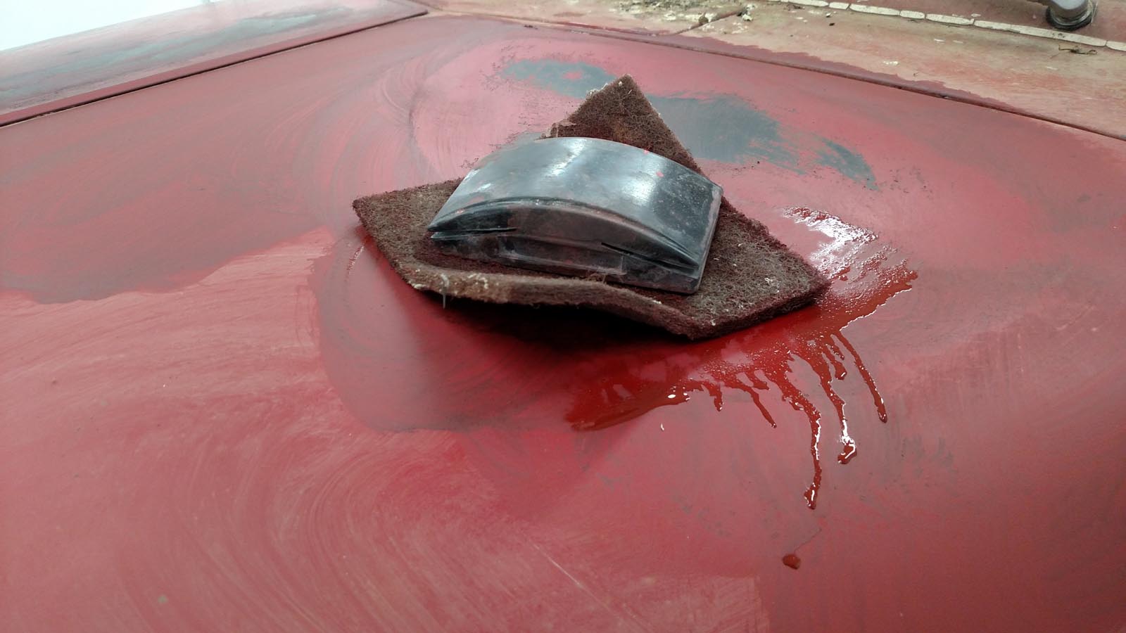

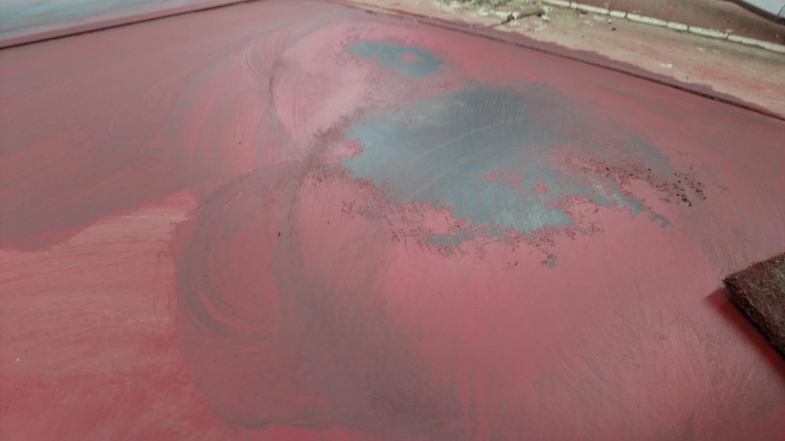

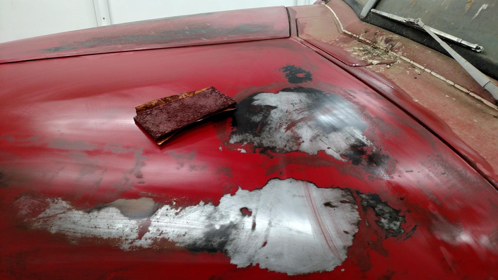

I started creating the "patina" on the truck over the weekend. I'm going for a worn look versus a rusty truck-found-in-a-field look. The paint on the truck is old and not very good paint, like one step above rattle can paint, but this made for an easier process of creating the worn out look. After trying a few things I ended up using Acetone with a scratch pad. If I rubbed it I could get layers of paint to come off and make a two-tone effect with the color underneath, or take it down to metal. I would also let the wet pad sit for 10-15 seconds in one spot and it would loosen up the paint in a rough pattern, then go lightly to keep the roughness. Here's how it turned out on the hood and fender. I still need to figure out the "rusting" process since the ones I've tried so far are not great.

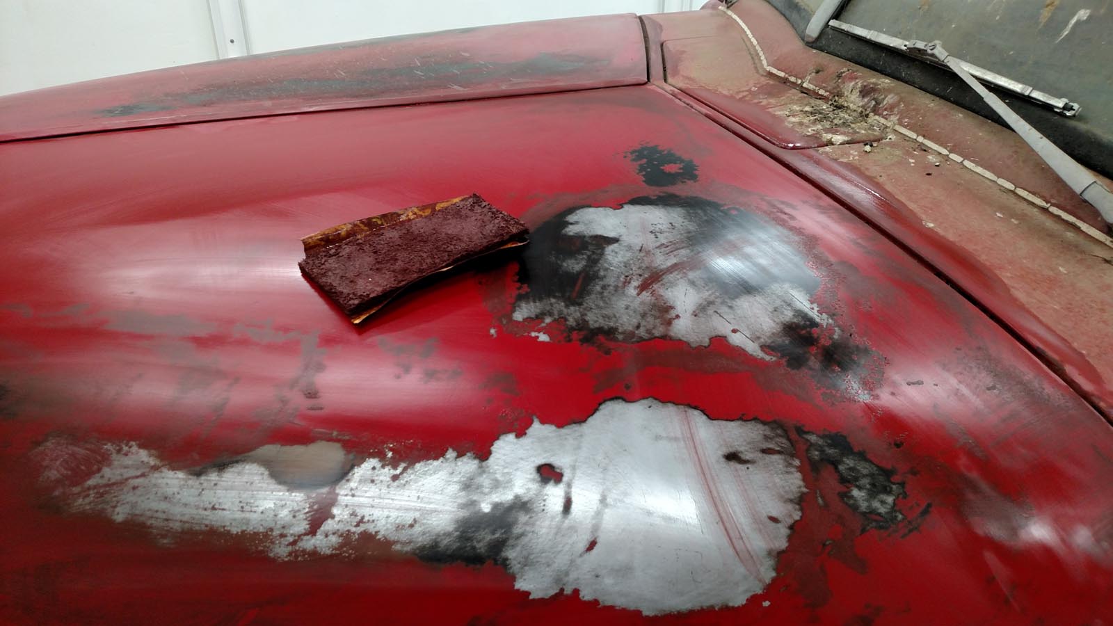

Sanding with 400 grit.

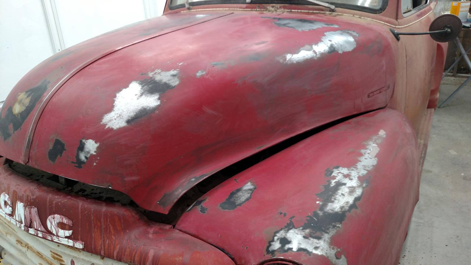

Wiped down. Will need to get the bare metal to rust, sand for paint prep and put a clear coat on.
