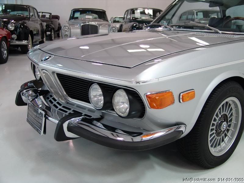

Here's my old 73 with the same guards in question so they appear to be correct on the eBay car.
picture.php
Now I am no expert but either all of the other E9s on this site have their guards on wrong or the car offered for sale is wrong...
as I said, this is correct for '73... they were "upside down" in '73. Or, all the others years were upside down- I guess it depends on if you own a '73 or not.
Question- was it just US '73's? Anyone know?
Yes, this was unique to the 73 US 3.0CS only!

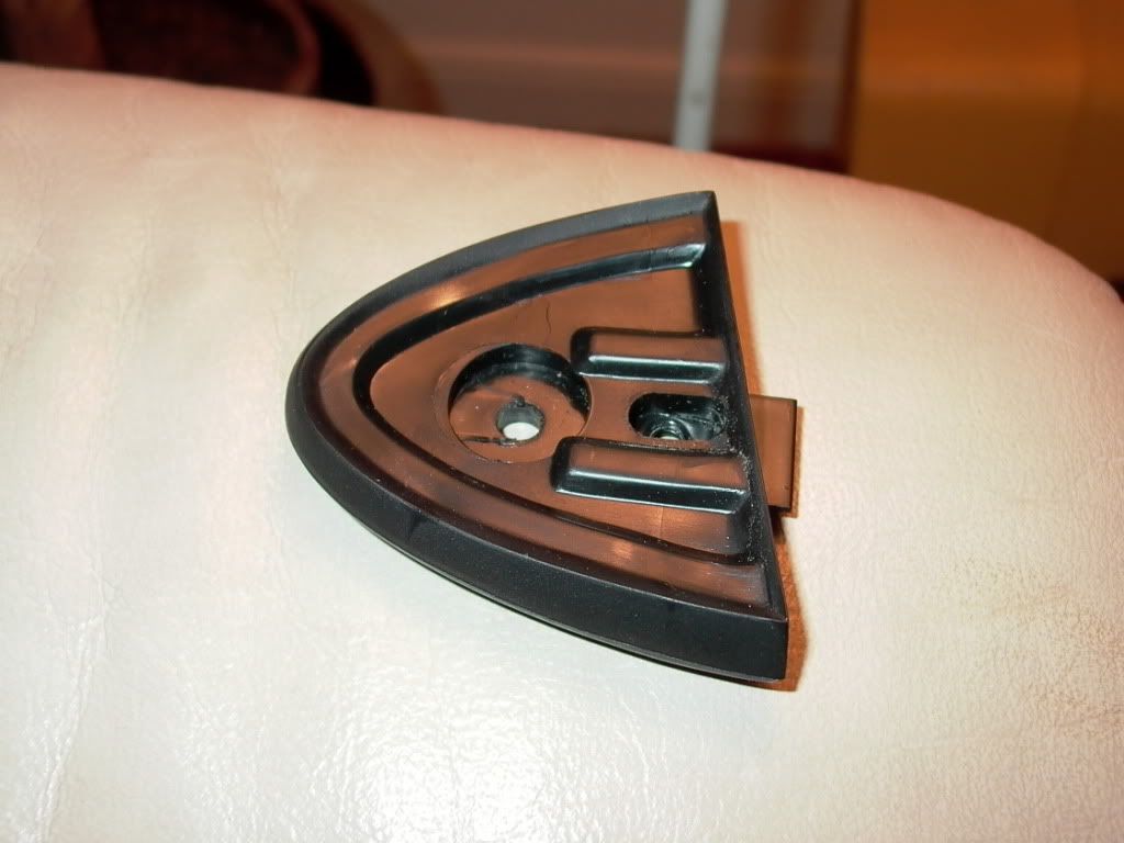

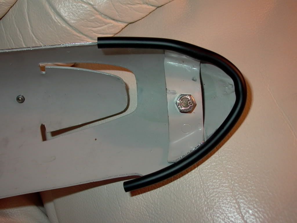

If you look closely, the profile of the rubber on the overriders is completely different than the pre 73 coupes. There are several differences as well. The 2 mounting bars in the middle of bumper that attach to the front subframe are of different construction. Pre 72 bars are straight with a few bends where they are mounted to bumper. 73 bars were slightly longer and have a Y construction where they are mated to bumper. The extra length was needed to meet the new DOT bumper regulations. Due to the fact the front bumper was pulled out a few inches, the bumper mounting points on both sides of the front fenders were also pushed forward, hence new thicker plastic spacers were fitted. Pre 72 bumper ends were fitted with strips of plastic only.
As previously stated, the rear bumper was probably fitted with a pre 72 version or the original 73 bumper, but deleted the 2 oval metal loops that extended the bumper

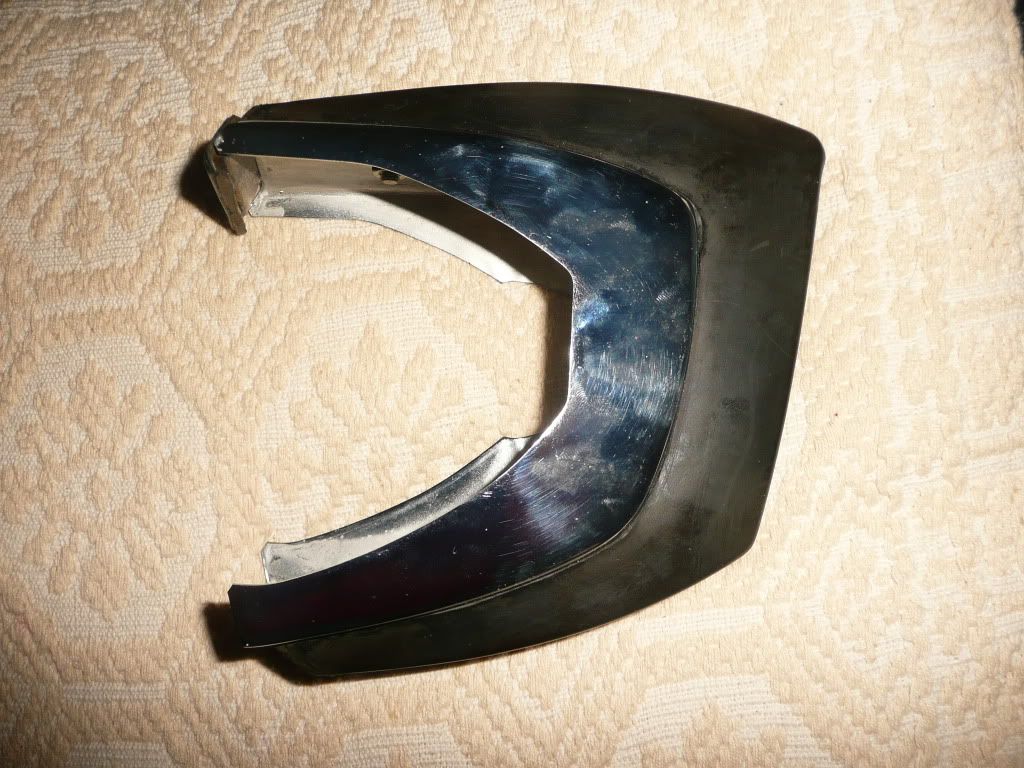

As stated several times now, the North American `73 coupes had a unique inverted rubber guard, the chrome guard is however identical. If you flip over a pre-`73 rubber guard it doesn't look anywhere near the same, the earlier guards are more square. BMW also did this to the `73 e3 and `73 2002 (not upside down though). It is a 2 1/2 MPH bumper and it `74 it became the 5 MPH bumper solution per the DOT.
The rear bumper looks original as well, it has plastic covers for the license lamp holes because these were mounted to the tail panel beginning in `73.

These pics ought to show the different contours of the 2 bumper overrider rubber inserts currently discussed.
Spacer for 73 bumper ends...needed to fill gap between fender and bumper due to new fender mounting hole locations.
Rubber strip mounting for pre 73 bumper ends.

Though currently "coupeless", I had a '73 Polaris coupe for a number of years and have seen various '73 coupes with the pointy part of the bumper guard on the top and the pointy part on the bottom, like the subject car. Perhaps there was a switch over at some point in the '73 production run where the front bumper guards changed? Most '73 coupes I have seen have the pointy part on the top.
The switchover was the "start" of `73 production for North America, this is confirmed in the original orange parts books. When bumpers were repaired/replaced only the earlier guard rubber was available.

Cars built for 73 model year US market requirements were pointy side down. Period.
It is naive to assume if you saw something different 20 or 30 or more years after the car was built that that is how it came from the factory

while everyone was discussing the bumper over riders didn't anyone notice that the bumper ends are not level and square to the grill opening?!
