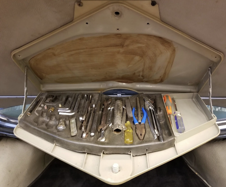

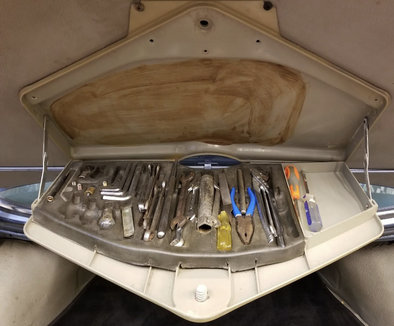

I’m surprised this car isn’t getting much reaction. I’m intrigued so let me stir the pot. I’ve never seen a toolkit quite like this one.

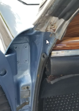

cracked rubber lip (meaning that it is likely an original rubber version, and not Repro)
missing the rubber part in the dooropening (L and R). And sagging fuse box lid. and horizontal rubber missing on dash rail

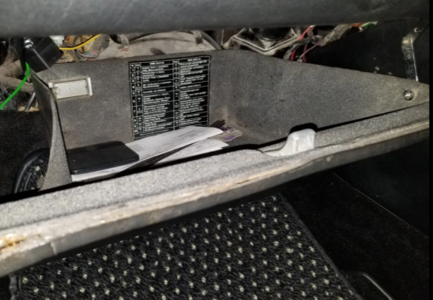

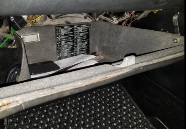

fuse label in glovebox, never seen that before (?):

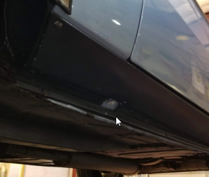

missign front left and right jack point, and a screw in the top left corner of the sill cover which doesn't belong there, and just invites rust....

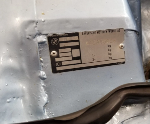

Rudimentary welded fender, with iffy ID plate:
When looking over the glove box pics I stared with confusion for a good two minutes. Why is the defrost duct to the right of the glovebox?
Then I remembered it is a RHD car. :D I suspect that the fuse label is in the glovebox because fuse box is immediately adjacent.
I can't get past the body lines. The ridge on the doors is too sharp and the ridges on the fender and quarters are not straight and/or not consistent. Not a huge deal but always throws a red flag for quality of body work.
Then I remembered it is a RHD car. I suspect that the fuse label is in the glovebox because fuse box is immediately adjacent.
It’s funny because when I read Erik’s message I thought he was joking and I thought to myself where else would it be! :)
