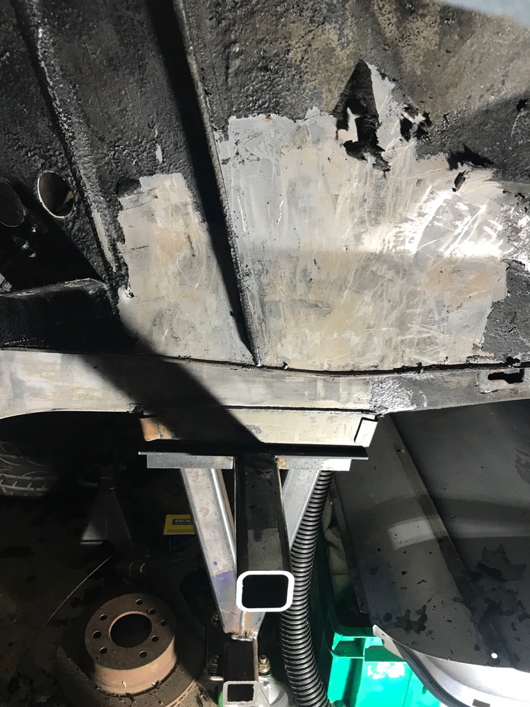

'73 3.0CS frame off resto update
Another update on the Jasco product
It more commonly known as dimethylchlorate.
It is extremely caustic and it poses an inhalant risk.
I'm stopping for now until I can get a charcoal respirator.
Despite my care it has made skin contact in two spots and it burns. A quick generous spray with a water bottle I have on hand for this very reason immediately provides relief and averts injury.
The force required to scrape off the undercoating is inconsistent because the thickness is inconsistent.
Areas where the coat was thinner respond well and minimal force is required but areas like corners or compound curves which have thicker coat need second and third applications of the chemical and much more mechanical force.
The risk of further burns and the inconsistent reduction in scraping force needed is making me reconsider this approach.
I will do more research and circle back.

Propane torch and a scraper. Then wipe with lacquer thinner
I will give that a try but I tried a heat gun and scraper already which did work well enough I suppose.
My primary fear with the torch is warping a panel.
Or do you mean that I heat the scraper then use it like a hot knife?

Update on the abrading before applying method I tried with the aerosol form and it made only a slight improvement in effort required.
I also tried the torch method which worked well but I'm still afraid of over heating the panels.
A heat gun and scraper certainly work well also.
Since this stuff is stuck on so well; I'm beginning to question the wisdom in removing it as extensively as I am trying to.
I will give some spray on liner folks a call tomorrow to see if I can just spray over what's there after scuffing it.
The difficulty of this effort is compounded by the fact that the shell is not on a rotisserie.
I'm looking for a good used one locally but deals are few and far in between on Craigslist.
The Rust-Oleum product is the same chemical as the Jasco product so I'll hold off on buying it for now.
To sum up:
1. Chemical means of removal are ineffective regardless of surface prep (probably a good thing when it was first sprayed on)
2. Heat combined with mechanical means seem to work well but I should limit removal to damaged areas of the undercoat
A. The rear floor pans
B. The passenger side front wheel-well
C. The spare tire well and trunk floor under the parcel shelf
I will work with my sand blaster to avoid removing the remainder of the undercoating as it is in decent shape
Note: a fine wire cup brush on my angle grinder does a good job of removing the undercoat with very light pressure and leaves a good surface to prime but heat buildup in the affected panel remains a concern.

I’m with teahead (rob). Propane torch and scraper. Only panels you need to worry about warping are inner side of front fenders. All other panels should not warp...and they are on the bottom of the car mostly, so....
I did the entire undercarriage of the bav and it turned out just fine. Do wear a respirator because the cooking/burning undercoat is probably not intended to be inhaled.
Scrape it off and sweep it up. Keep some water or fire extinguisher handy and make sure there is nothing flammable on the other side where you are applying heat.
I’m with teahead (rob). I did the entire undercarriage of the bav and it turned out just fine. Do wear a respirator because the cooking/burning undercoat is probably not intended to be inhaled. Scrape it off and sweep it up. Keep some water or fire extinguisher handy and make sure there is nothing flammable on the other side where you are applying heat.
