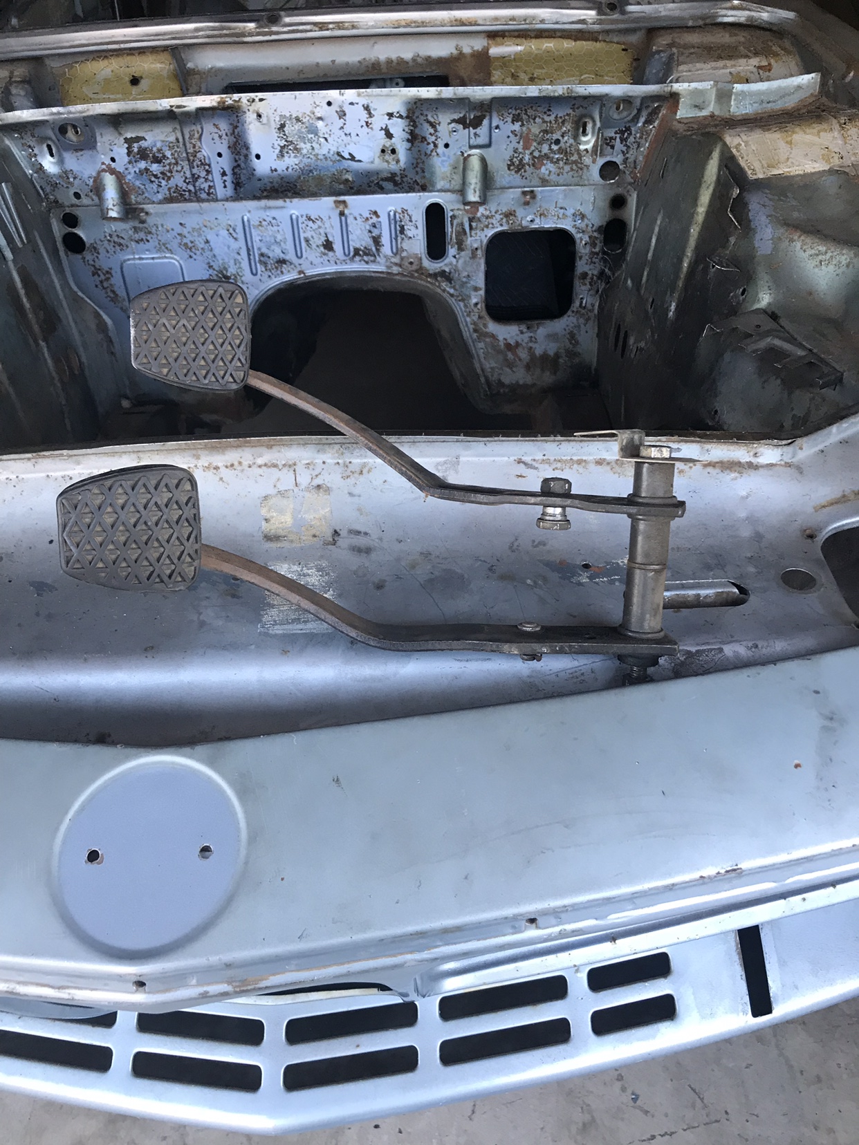

In other great news the 72 Bavaria I bought yielded some treats this clutch pedal among several other things

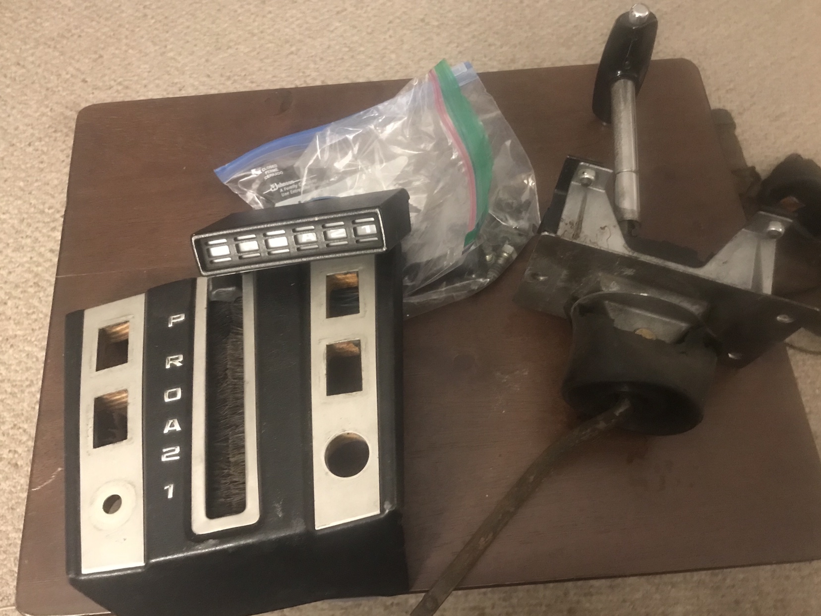

Is anyone on here restoring an automatic and needs some of the specific parts?
